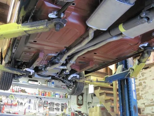

These are actual original Tri-Y's on a 66 GT350H. Looks to me like the right side does come inward more than the left.
