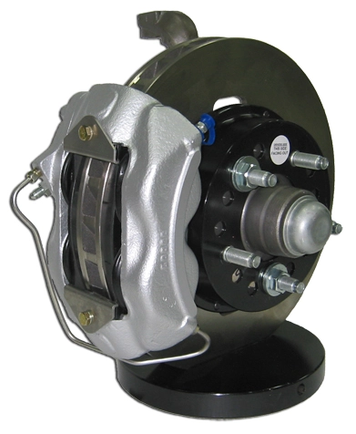

I like that kit. So much so I build my own:
Shaun66,very nice. so this setup is the exact oem spec as the 11" stockers, except they are 12" rotors and big calipers?
Bill
Nothing like it. 12x1.25" directionally vented 2 piece rotors with aluminum hats, seperate hub, big KH calipers finished in high temp, chemical resistant finish, Porterfield R4-S and/or R4 pads. Serious performance boost over stock, Granada and pretty much anything else that will fit inside a 15" wheel.
