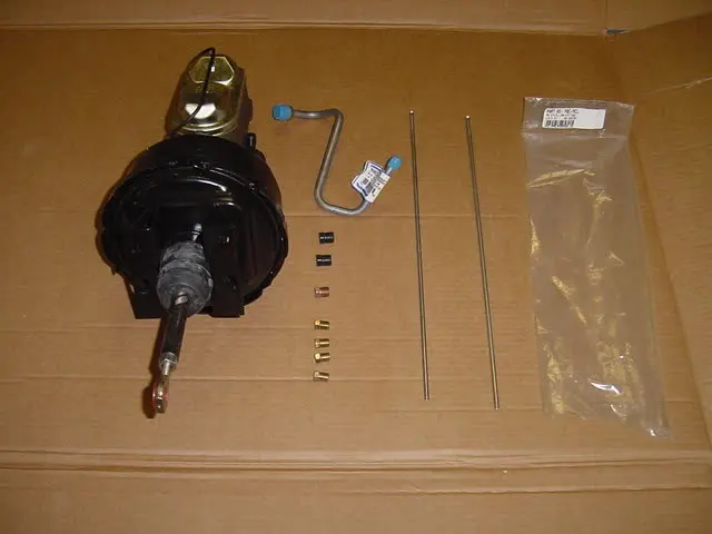

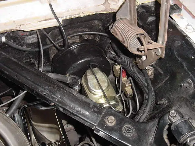

Here's what I bought for mine from Mustang Depot:
http://www.mustangdepot.com/OnLineCatalog/Brakes/power_brake_parts.htm
They now sell the Stainless Steel Brakes Corp. Units
I bought mine 5 years ago, and am not sure who makes it:
It bolted in, but did require some line rerouting and I added a combination valve.
