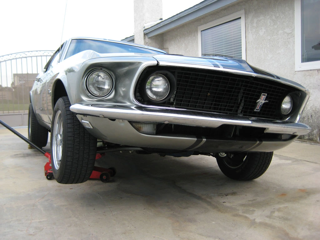

In my opinion, Maier Racing has the best subframe connectors. They connect each side at 4 places instead of 2. With these connectors, I can place a jack under the front frame rail, just behind the wheel, and lift the whole side of the car up. Check out the pics. Im sure other connectors can do similar things, but i was really amazed when I saw the rear wheel come off the ground when I was just trying to lift the front up.
