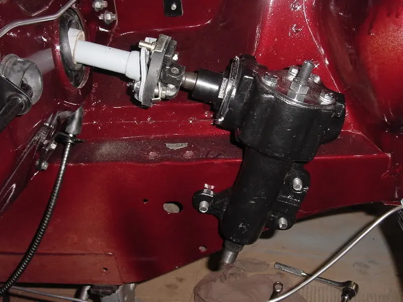

You're right, the steering is all one piece. Just imagine that steel shaft pointing at your chest & head, in a head on collision. As long as he needs a new box, look into converting it to a collapsible column too. Ford used the 1 pc steering box til mid 67, then switched to a 2 pc with a rag joint just above the box.

I just did this conversion. It's a lot of work and modification in the cramped area under the dash. You will also have to change out the signal light switch and do some wiring. I had the engine out and couldn't imagine trying to do it with the engine still in there.
The long shaft type can get rebuilt. It can be removed by lifting the engine a couple inches. I would suggest doing a search and call or email a couple places to see what they say.

In case you change your mind..
http://www.mustangandfords.com/howto/30247_collapsible_steering_column/photo_02.html
