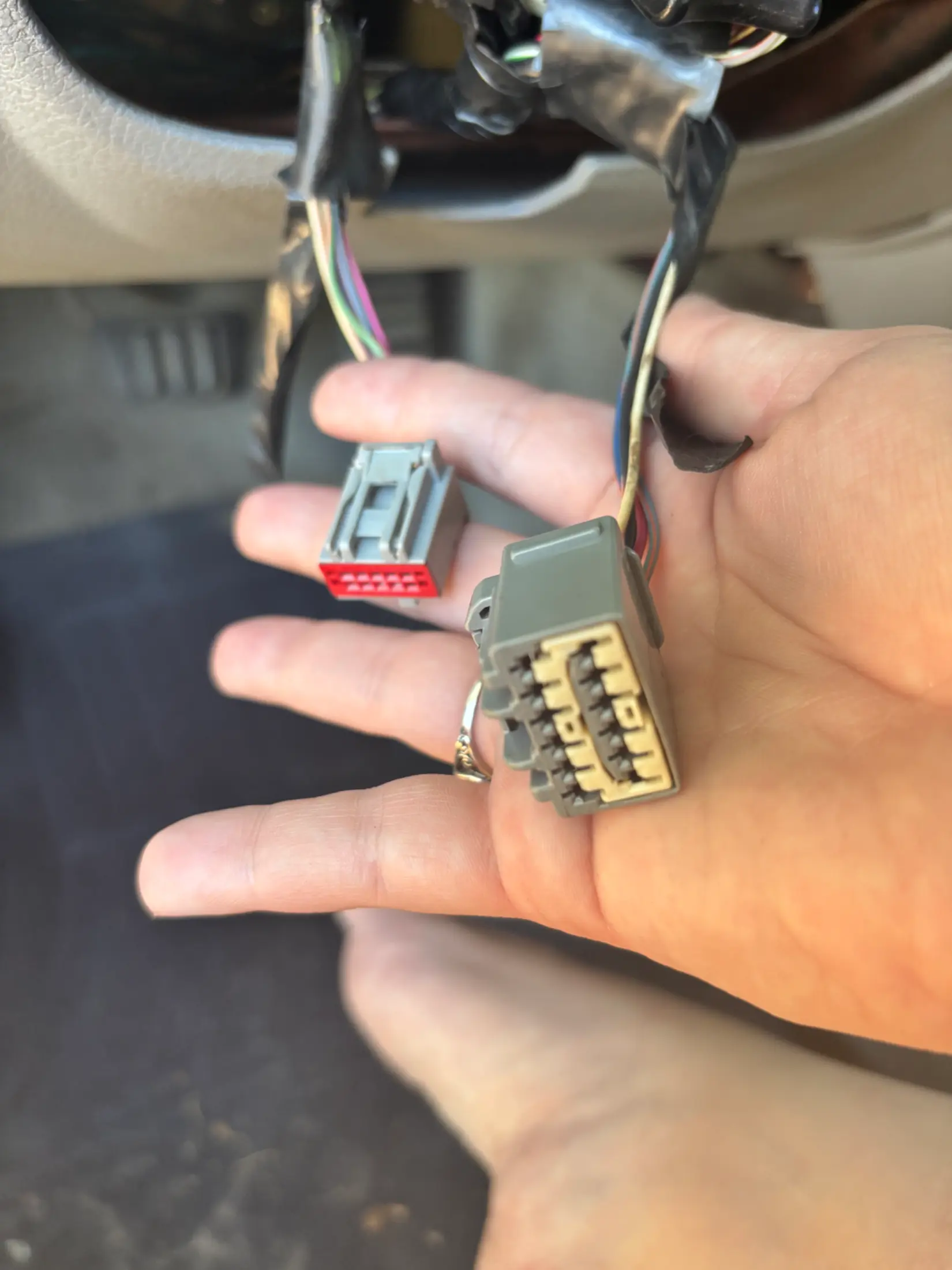

I just recently purchased a 2005 Mustang, and my blinkers don’t work. However, my hazards do. I can’t seem to locate where the new turn signal relay goes? I was told by someone it is under my steering column, but I still am lost. I also have these two strange wires hanging down from my steering column, I’m not sure if those are the problem or not. Any help is much appreciated, I would like to solve this problem myself if possible.
