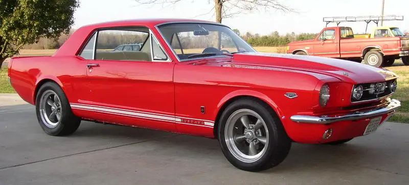

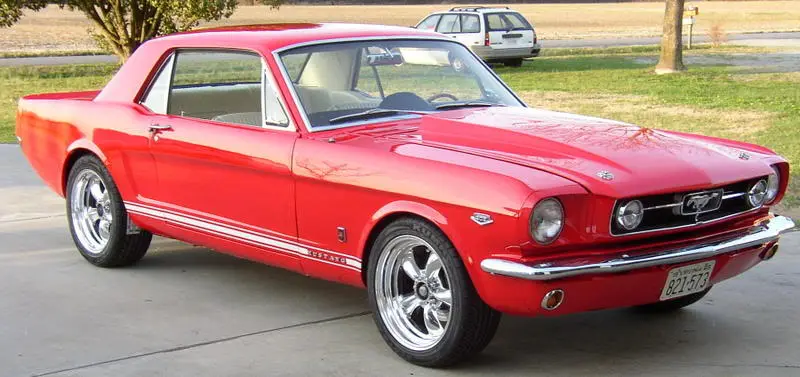

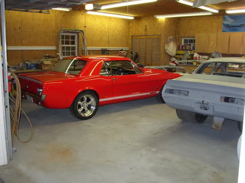

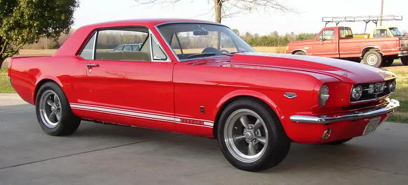

Here are pics of my car in its current state.

I plan on keeping the tires and wheels that are currently on the car. I may want to go back to the "period" look in the future. Even though there 16's they still have the 60's look.
I finished building my car around '99. Had those wheels since the mid nineties. When I bought them the 16's were considered large for a 65.
If I were building my car today there are allot of things I would do differently.
Only things I have changed from the time I first built the car is changed the rear tires, painted the wheel centers and added a spoilered decklid.
Figured I would do a few changes to the car to freshen it up a bit.

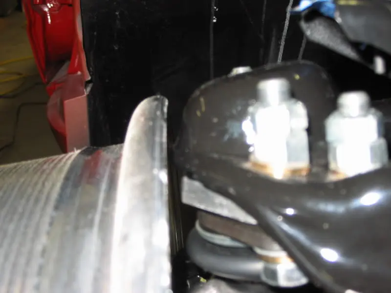

Would like to caution people with negative wedge kits on the front on running a 17 x 8 w/4.75" (wheel weights mounted to inside lip). Ended up trimming a pretty fair amount off the upper control arms to get clearance throughout the entire range of suspension and steering travel. Essentially the entire flange on the ball joint end of the upper arm had to come off.

Without a doubt that is a safer route. My clearance issues on the front had little to do with tire width. It was all a rim backspacing issue. With my negative wedge spacer on the upper control arm I am extremely tight. Had to grind a signigicant amount of material off to gain clearance.

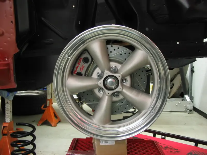

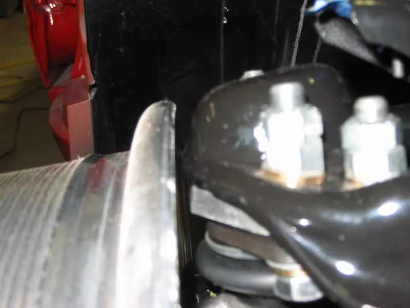

Bloverby, I ran into the same problem this weekend. I have a 65 w/a neg wedge kit and I custom ordered Vintage V45's 17x8 4.75 bs. I have .195" between the rim (no tire yet) and the control arm. I'll attach a picture. Also, I mocked up the rear tonight and found out that my custom 9" is 1/2" wider than stock. (this is after I told the machinist to compensate for the custom axle flange and the disc rotor thickness). I may try to change the standoff of the axle and bearing to make that 1/2" up.
Yep, mine is at 1 3/4" I even got the bright idea to do pro-motorsports vario ecentric kit on the lower control arm. I figured that I would be removing about 1/2" of alignment shims....well then my upper arms near the shaft nuts hit the shock tower. aaarrrggghhhh! Should I worry about the wider rear?
