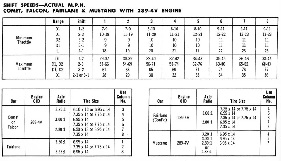

OK, first question I always ask is what is he using for "Drive"?
The 64-66 shift pattern is:
P
R
N
O
L
If he's using the "•", that's rain & snow, eliminating 1st gear. The normal drive position is O.
As for trans function:
