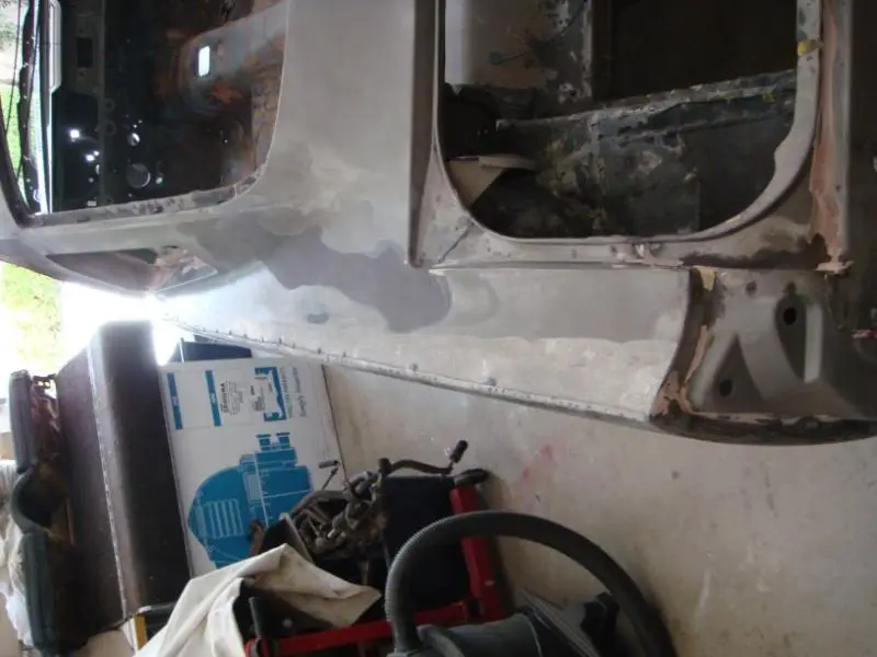

65 went for a spin w/ a stripper have pic's

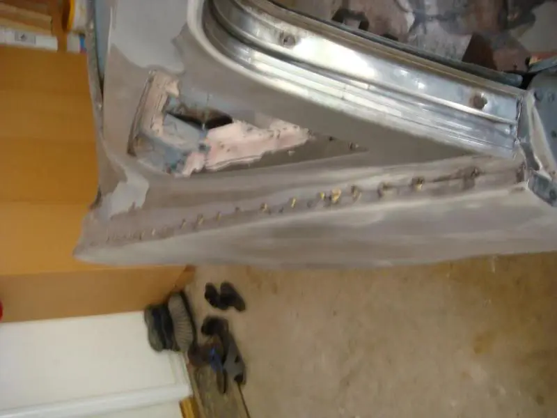

I found out that both my rear quarter panels where replaces with skins, and who ever put them on decided to over lap then weld, instead of butting the pieces up and putting a long bead weld. Needless to say, they slapped on a lot of bondo... Ill get some pics up later, its pretty bad looking i think...
Its pretty gross....
