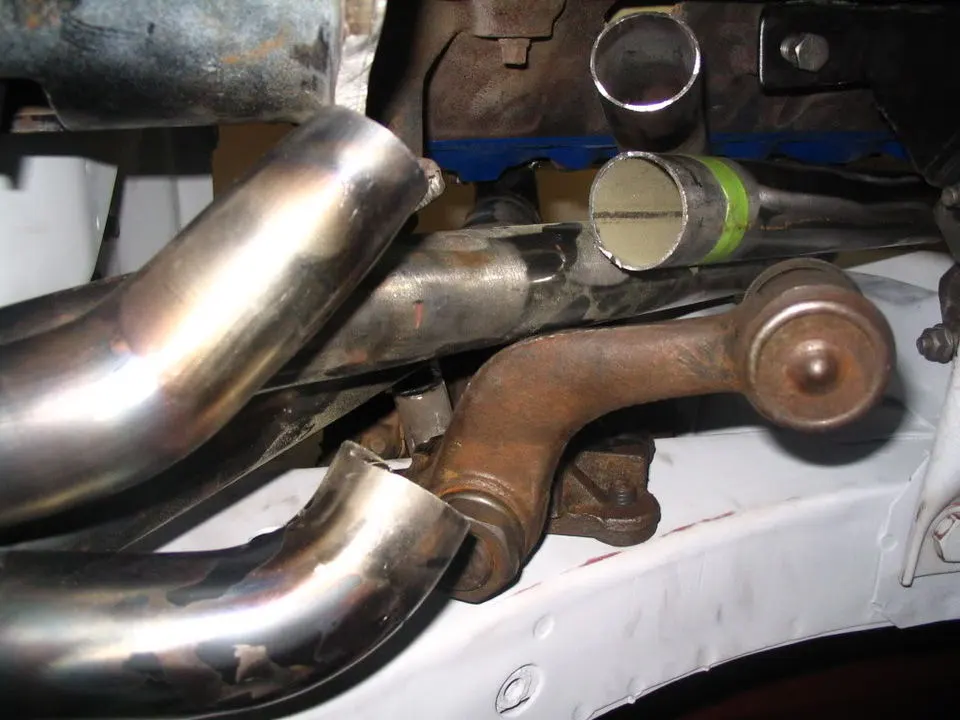

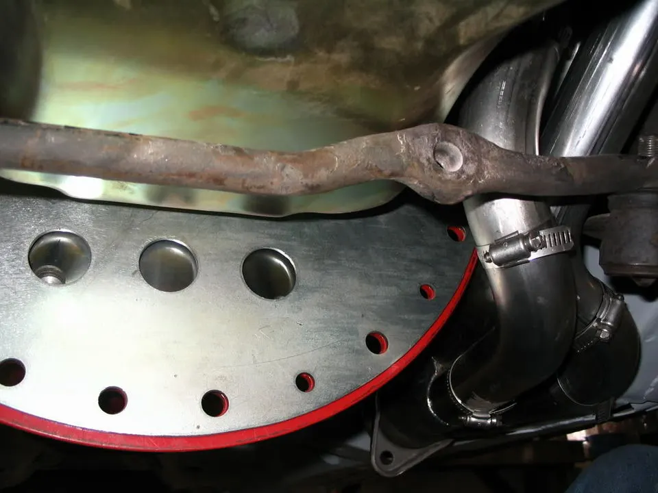

I have a McCleod scattershield that will accommodate either a 157 or 164t flywheel as well. I think I had to "adjust" one of the headers(regular Hooker Comps) to clear the flange around the outside, but it wasn't too bad. That was six years ago, so I'll have to look again to see exactly what I did.
did you have to do something like this?
