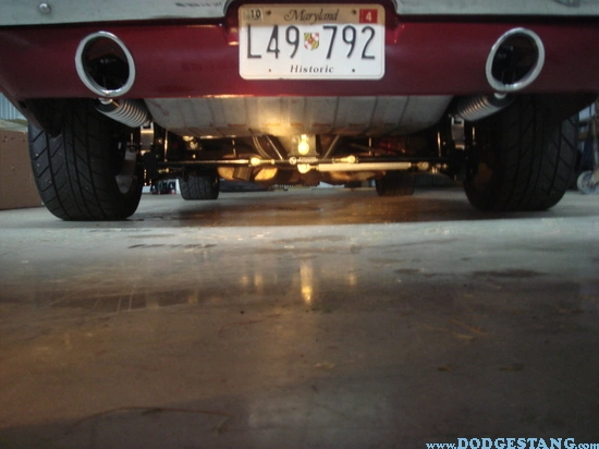

Don't this look good?
This looks better....but then again...I'm biased
