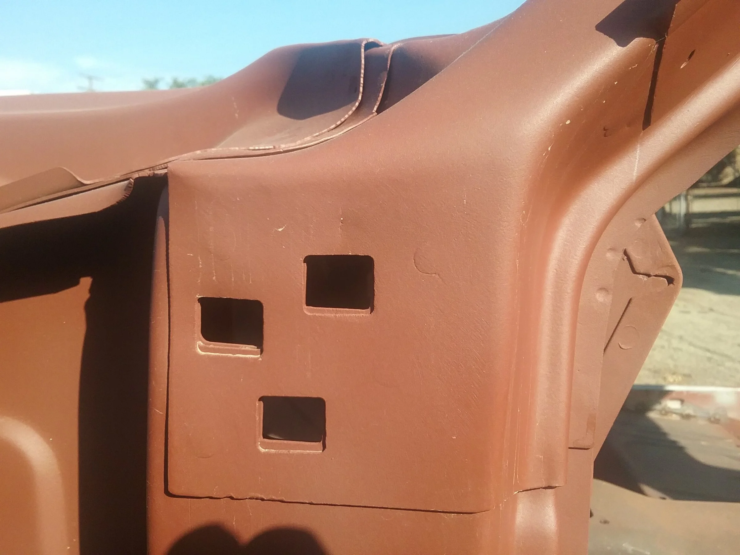

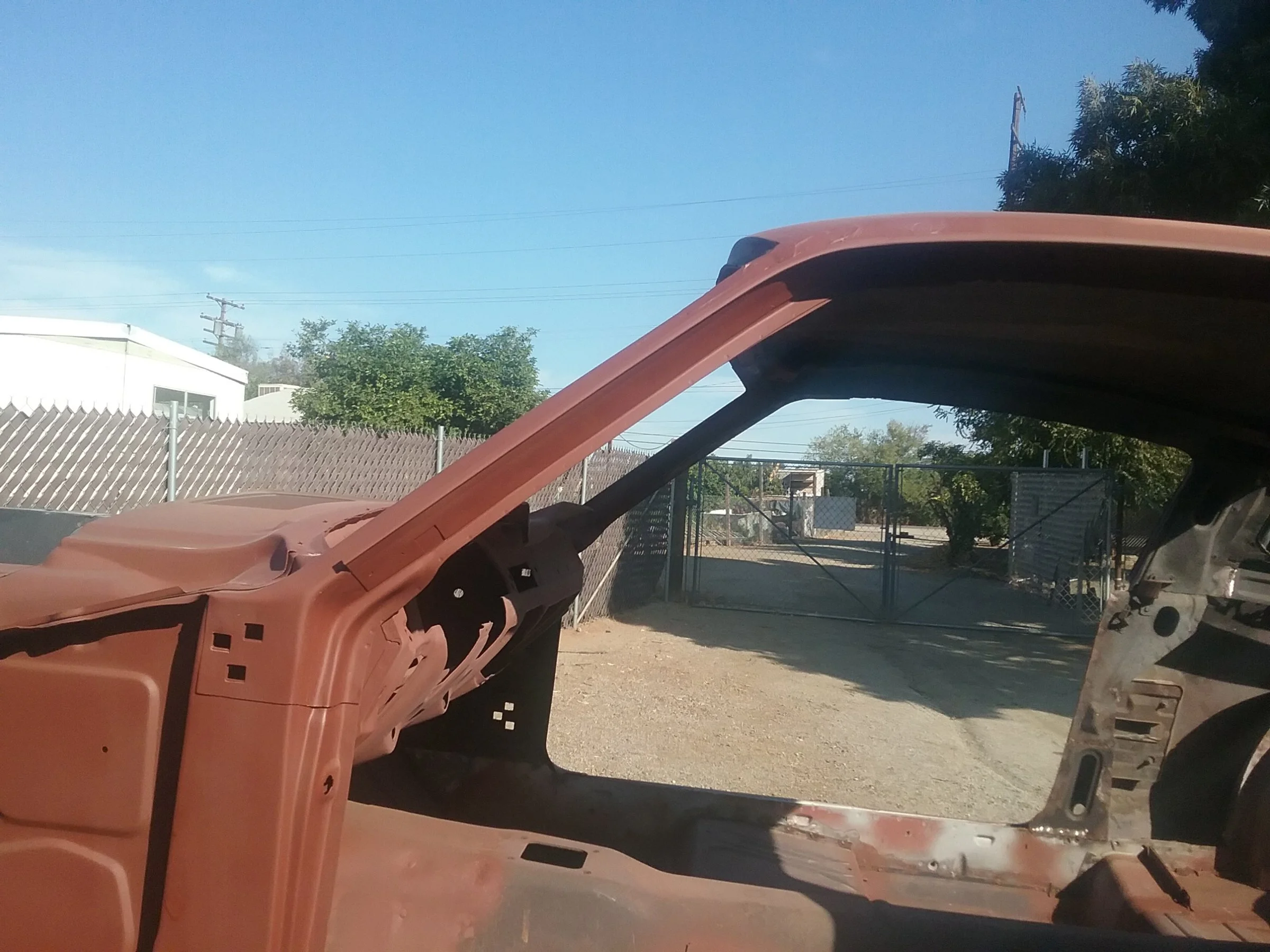

They make them for 67 -68 but not for 65-66 you can modify a 67 68 fairly easily ,the only difference is the holes for the upper door hinge. If yours is rotted above the replacement post it is rotted into the roof panel ,the new posts are full length ,same as the original

I did this 67 fastback a couple of months ago .The posts go all the way into the roof structure ,i thought i had another set but this must have been my last ones .
