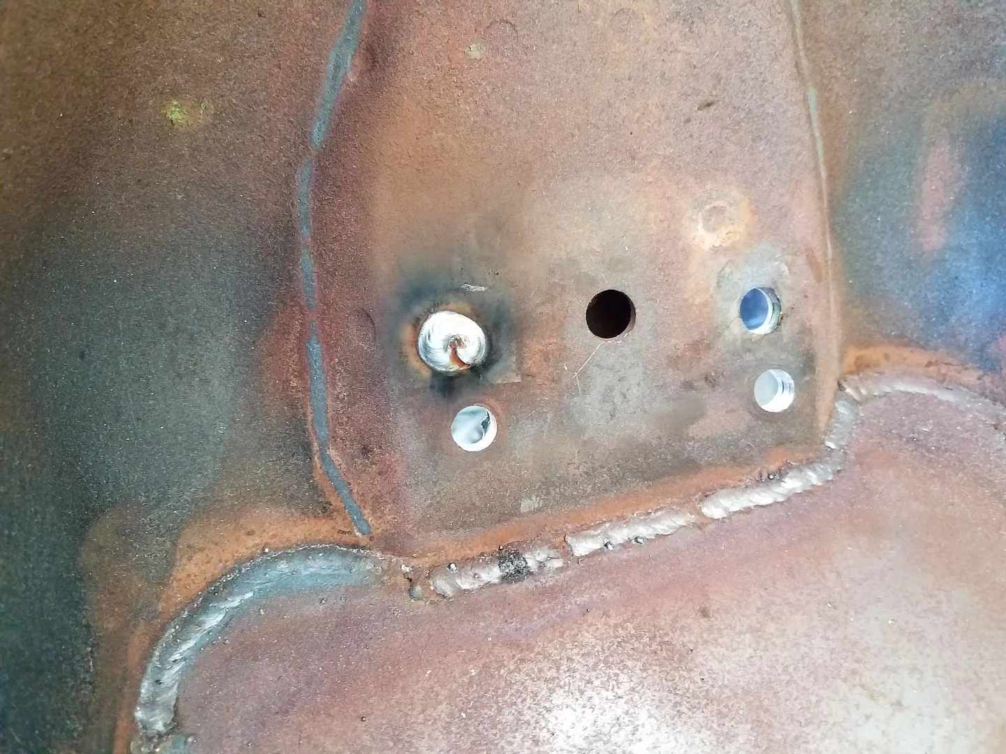

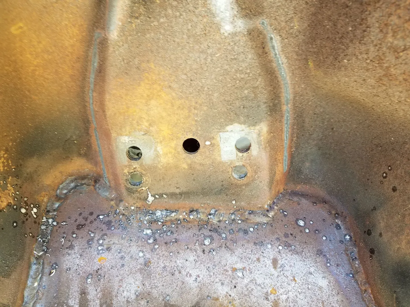

So I looked carefully at the drop and where the control arm nuts will end up. Looks to me like the rear bolts will be very close to a tab? I have all the parts on hand and the template so I was going to do it tonight. Anything I should know? Drivers side looks harder to get to the bolts than the passenger side.
They say a picture is worth a thousand words....so there is 4000 for you. Welding the old holes up is purely optional....and mine I installed shock tower reinforcement plates in(and welded the shock towers similar to the trans-am racing mods back in the day) so it may look slightly different

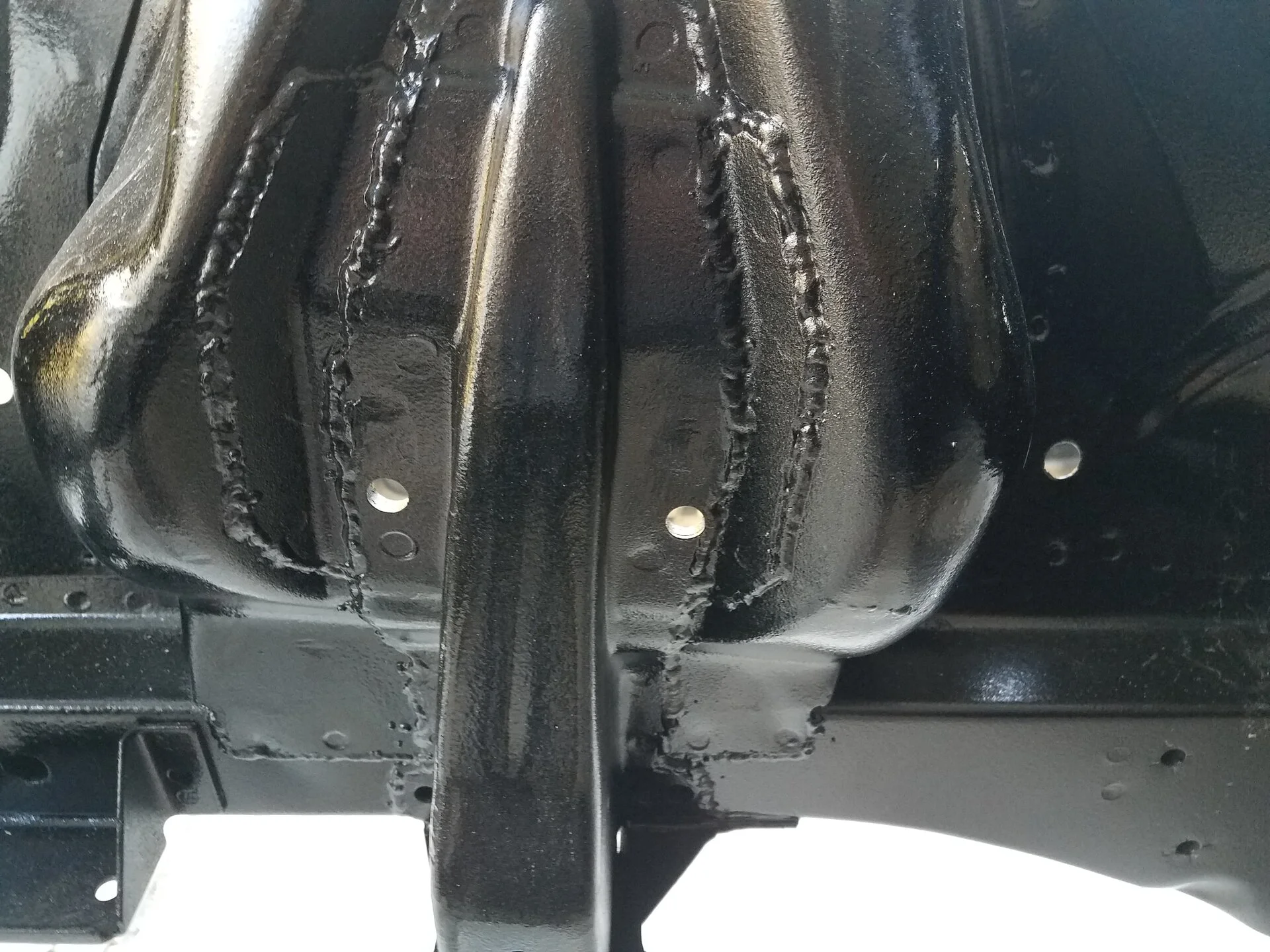

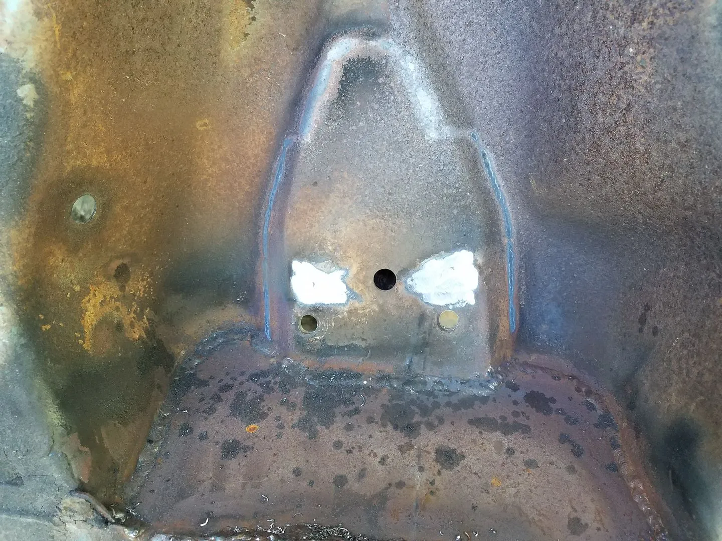

Naw, the area below the holes was fine...I welded in the reinforcement plates to help prevent shock tower cracking if I ever decide to track the car....and also to seal it off so it wouldn't collect a ton of grabage like leaves and dirt that I had to clean out.
Took a current one of the inside for you...ignore the less-than-pretty welds. I think you might be concerned about where there was a lip? some people use a cut down washer to space it on this side...ot just grind the lip away...in my case that was smoothed down when I welded the shock towers.
I got the drop done. It would be 1000 times easier without an engine in the way. It's 1 flat at a time in places, might have been able to use a 3/4 ratcheting box head wrench but I didn't have one. Took 3.5 hours Saturday night on the drivers side then only about 2 hours on the passenger side Sunday afternoon once I had tools and techniques figured out. To deal with the aforementioned lips, I took a long pipe and hit them with a hammer until they were out of the way. Another item that the engine is in the way of. The drop template makes it easy. I had 2 versions; 1 with bottom (new) holes at 1/4" to get a nice start and then one with bottom holes full size. Using a 1/2" drill it did not take too long to complete. I did 4 steps sizes. I replaced the control arm shaft with a Moog part while it was out. Wish I had left them alone as both sides were still snug, but I had already bought them. The bolts didn't turn in them. The new ones are nice but bolts started turning in all 4 spots. I don't understand why; i pressed them in with a hydraulic press just like they should be and tightened by hand with a combination wrench. The alignment shop will not like me. Drove up the street and back, need to adjust the toe. Its going to the exhaust shop today.
