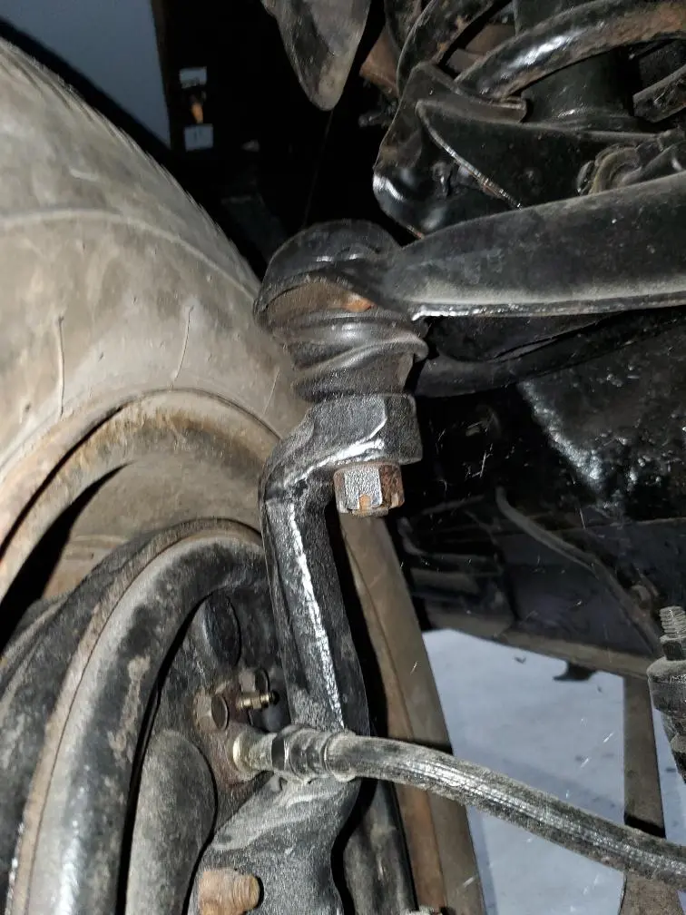

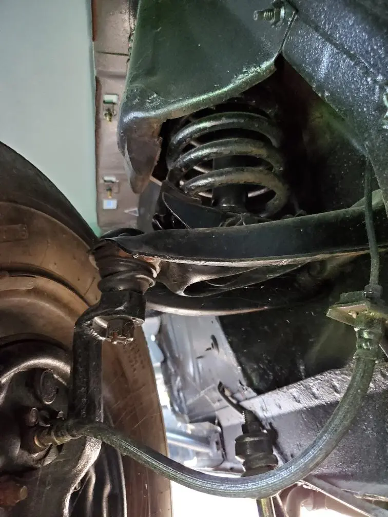

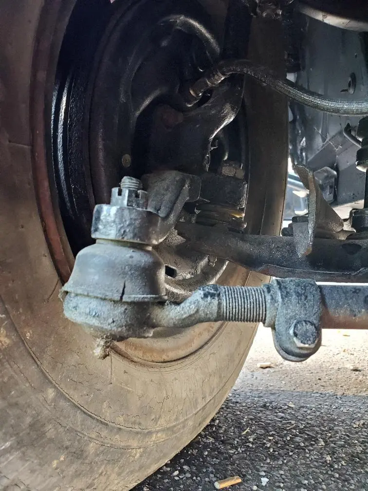

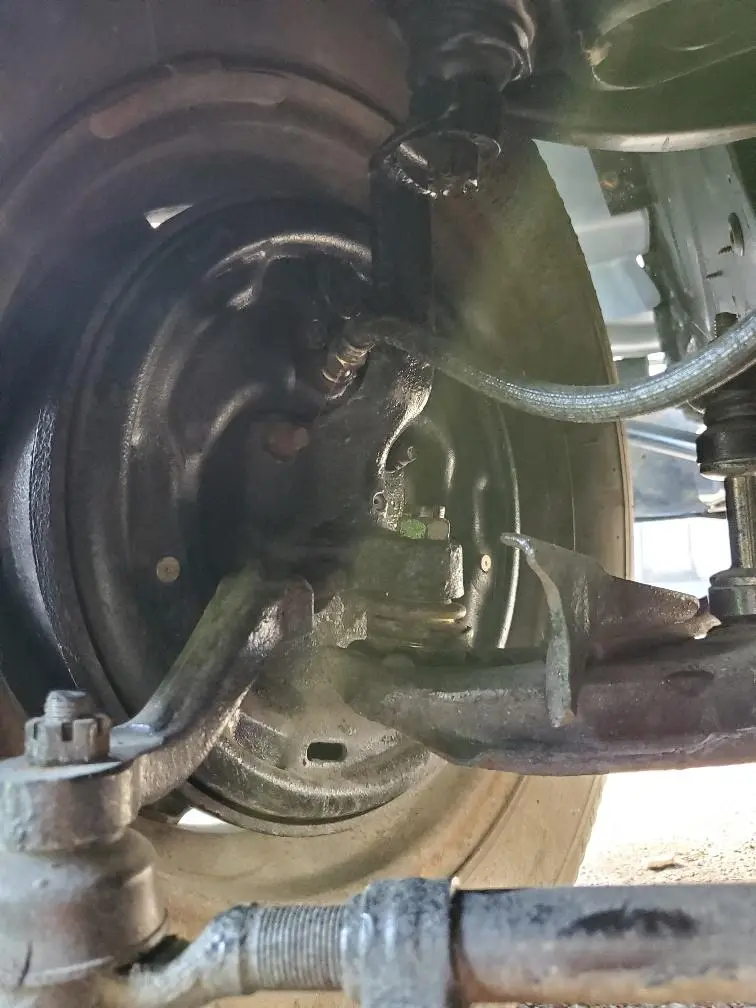

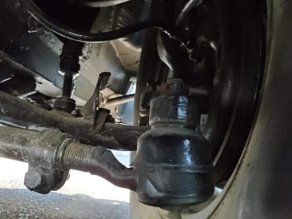

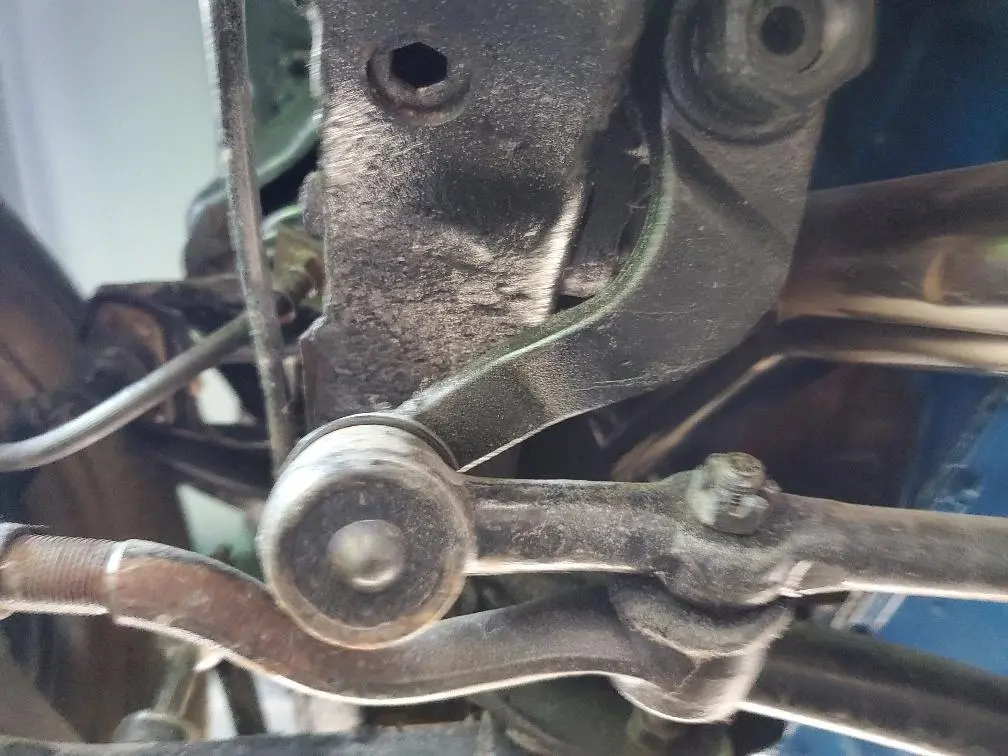

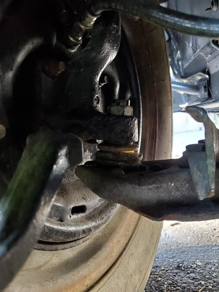

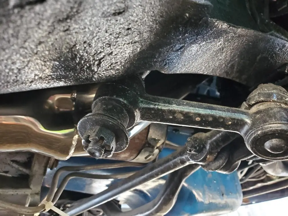

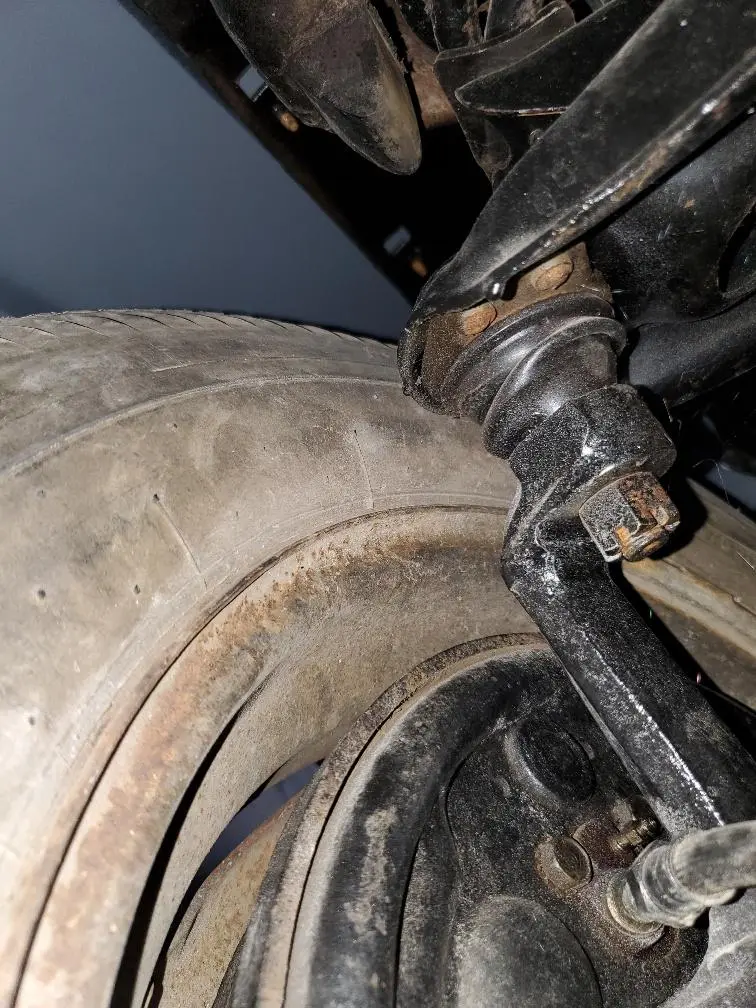

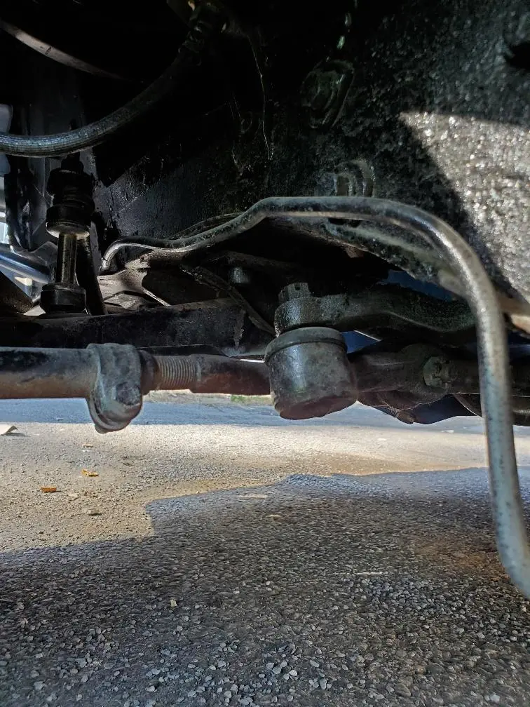

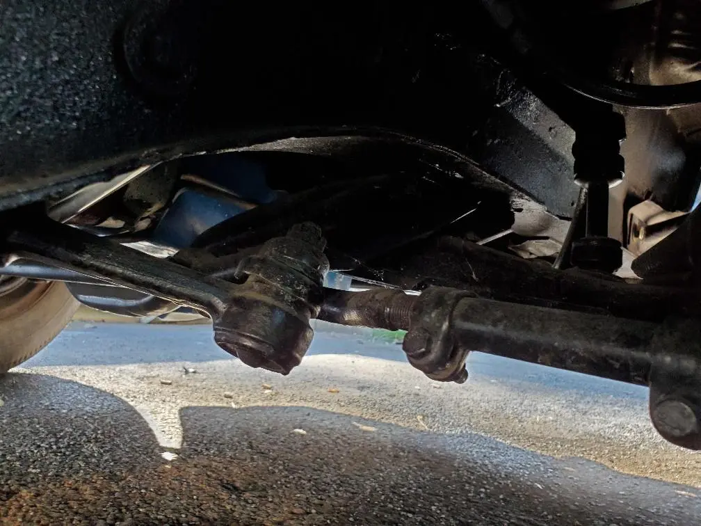

I purchased the car with the front suspension just "bolted together", no cotter pins etc. It has all the correct V8 parts (originally an I6 car). I sent the car off to the body shop last week, but made sure I did a decent review of the suspension and steering to see what was needing to be fixed/updated. The lower ball joints' boots are shot, but the joint looked good. (I really cant confirm this any further than the attached photos until i get the car back). The idler arm bushing looks to need repair along with tie rod ends. So I figured, now would be the time to get some parts ordered and on the shelf for when she gets back.

1. Upper Ball Joints (I'm unsure of it's condition until disassembly. Visual inspection looks okay, and I'm not feeling any rocking in the tire. But if I'm in there, why not. Should i just buy the MOOG K8036 joints and rehab the entire upper arm? I read an article about properly centering the mount in the arm and welding the caps to the arm after "centering". Are there any rubber bushings in the upper control arm at all? Should I just buy a complete new control arm? The uppers at Opentracker are a bit outta my price range with the needed parts noted above. (Unless I've lost my mind and started buying too many parts already)
2. Spring Perches look to be new on the car. But I've heard great things that come from an upgrade here. I may be able to swing the roller perches at opentracker, but I'm looking at the CJ Classic Performance spring perches to keep costs down? What's your thoughts?
3. Idler Arm- John recc the roller arm, but I've heard the rubber one centers the car better when driving.

Driving yes, street driving-NO. They guy had just loosely bolted everything together to sell it. (Which I was aware of).
I did drive it (about a mile) to the paint shop a week ago. There was decent amount of slop in the steering wheel, but that could be a multitude of things. I figured it would be best to get it back from paint and tear it down inspecting as I go before I order a ton of parts to just sit (that potentially may not need).
I've got a decent gameplan at the moment, and after talking direct to MOOG, they do not sell an "upgraded" RK version of their upper arm. And the MOOG upper arm is not even made by MOOG and is a value driven part. I'll take my chances with the rebuild with MOOG parts on the upper arm vs buying a complete upper arm.
