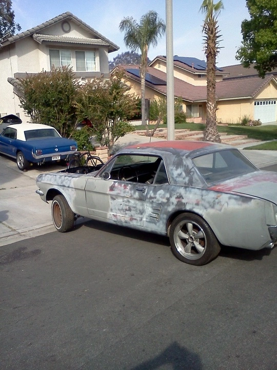

damn, front sat lower?? Here is my 66 with an explorer rear and grab a trak mid eye springs and 17's...no shocks bolted up, but shocks don't give ride height. My ass is in the weeds already, can't imagine how the front springs would look. I bought my springs slightly used though, so perhaps they've settled?
btw, no drivetrain and stock front suspension in this shot
