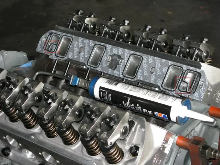

is there a problem with the intake gasket over the water jet passages (see boxed areas in red)? will gasket material get into the radiator?
