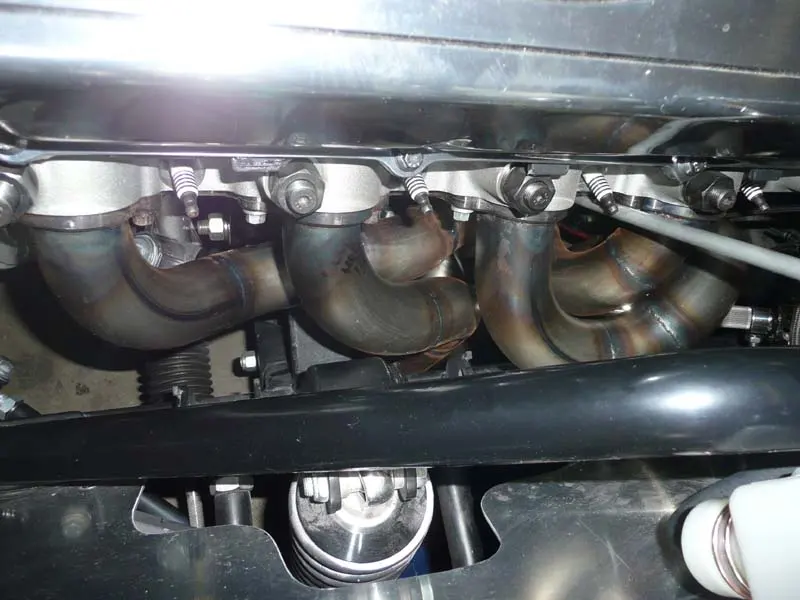

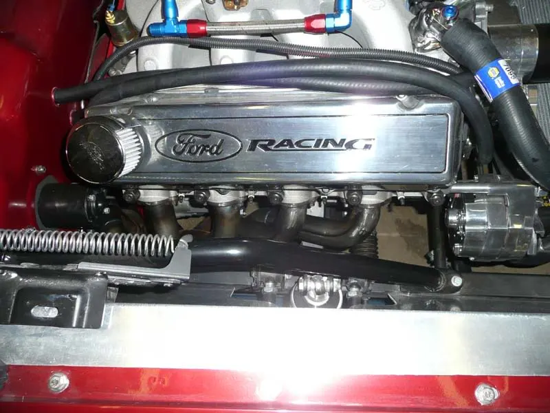

Do the Mustang II suspension work, you won't regret it. if you put the 460 in with the current setup you will have a hell of a time putting the spark plugs in, you'll have to cut some on the shocktower mount for the headers and the headers are crap. i bought some thinking i could modify them for my car but they come out of the head and go STRAIGHT down so your creating back pressure that you don't need. I can post a picture of what the header looks like if you want. I had custom ones made. I have a 460 bored and stroked to 532. I also have a flaming river rack and pinion steering. its hard to turn the car when its not moving which i am not yet used to but once you get it moving its easy. If you have any questions let me know.

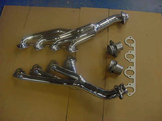

Musta got the wrong ones. FPA offers the ones below to fit a 67-70 Mustang without modifying the towers, etc.
