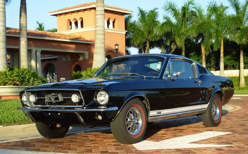

I just bought a 67 fastback GTA, I wanted to do a Shelby conversion but I seem to be catching a lot of flack from people saying it's too rare to do a conversion on. Just how rare is it? btw its a 289 4v A code. Not hipo 289 or 390.
Unless I'm mistaken, the GTA was a big block car. Did you get a Marti report on your car yet? Or run the vin and data plate through a decoder? I would start there and make sure you know what you have before planning the resto.

the GTA was just a GT with an auto tranmission, the A being for automatic. it's still a GT but for some stupid reason ford decided they wanted to differentiate automatic and standard trans GT's. it's rare but not exceedingly so, however, i would still consider restoring it back to stock if it's a numbers matching car in decent shape. that said doing some bolt on shelby peices isn't going to drastically lower the value of the car so long as you aren't cutting the car up. these days you can add just about all the shelby peices to a 67/68 fastback without cutting into the sheetmetal at all. the biggest hurdle has always been the taillight panel which required cutting huge holes in it for the shelby taillights but since Mustang Project - Discount Mustang Restoration Parts LED Tail Lights 2005 2006 2007 Mustang Parts has come out with their new bolt kits utilizing their LED light kits you no longer have to cut the crap out of the tail panel anymore.
everything else can be added with bonding adhesives that don't require even drilling any holes at all in the sheetmetal for stuff like side scoops, etc.
if it were me, though, i'd probably do a combination of stock GTA with a few shelby glass parts like just the lower side scoops, trunk lid, 67 shelby style hood for use with stock fenders and light buckets, and maybe the mustang project tail panel and lights with some California Special foglights or something and some 17" shelby 10 spokes or a set of the 17" billet "magstar" style wheels from wheel vintiques called the "Marodder".
make it different, make it yours and make it unique. heck you could even combine a shelby, a california special (yes i know it's a coupe and you have a fastback) and the Bullit car to come with something truly cool and creative and all your own.
