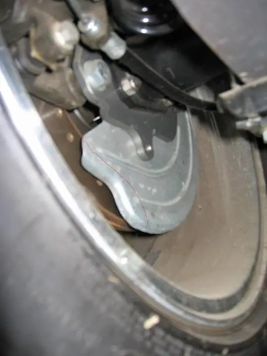

For the Fox rear end install, you don't have to trim them. On mine I "tweaked" them by hand just a bit , where it sweeps across the rotors near the caliper. You really can't even tell where I did this. The rest of the shield is larger than the rotor. Man, I forgot all about doing that.
I think it's worth it to at least try. If you get gravel up in there, it could do some serious damage.
I'll see if I can't get a picture of how mine are installed. That may help visualize what needs to be done.
Here is a picture of mine. There is a red "pencil" line I drew where I did the bending. When I showed my friend, he couldn't tell I bent them, until I showed him the line.
Sorry this picture and line aren't better. I'm photogenically challenged :D
Anyway, I hope this helps you.
