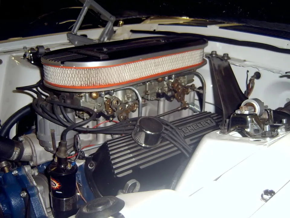

I wish. It's a plain-Jane C-code fastback that I bought from it's original owner. It was a very nice unrestored car when I bought it and I really had to think twice about making it a clone, but it's what I really wanted. Still, it really hurt to cut up the pristine taillight panel as well as drill 3" holes for the brake scoops. All the original Mustang stuff went on ebay to help finance the job and brought what I felt was insane prices. Here's a couple pics:

Thanks for the kind words, Tim. The motor is a 306 ci small block with lightly ported 351W heads, 9.5:1 compression, a Comp Cams 268XE cam, roller rockers and dyno'd at 328 hp with a single 4 barrel. I sure it makes less with the dual fours, but I love the way it looks so that's why they're on. The carbs are a pair of 390 cfm Holleys running direct linkage, so both carbs open at once. I tried to use progressive linkage so it only ran off one carb until you put your foot in it, but it was such a dog I put it back to direct. It doesn't get wonderful mileage (13 mpg or so) but the throttle response is instant wth no hiccups. All in all it's a fun car, but since it's been "kinda done" (are they ever really finished?) I feel like I don't have anything to do after work!
