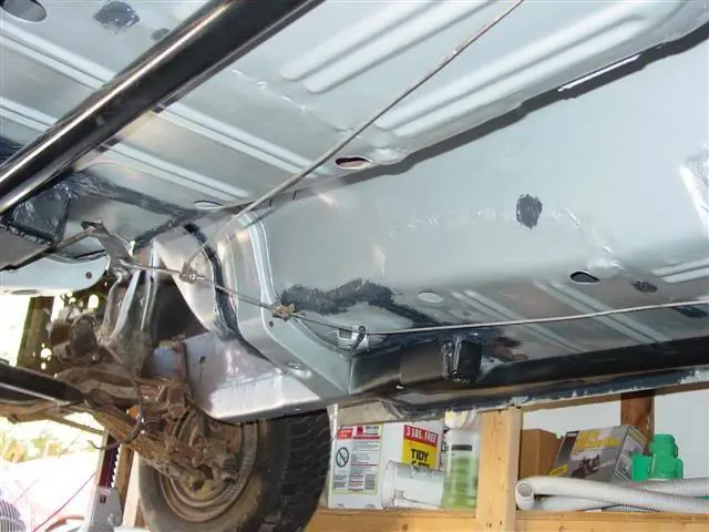

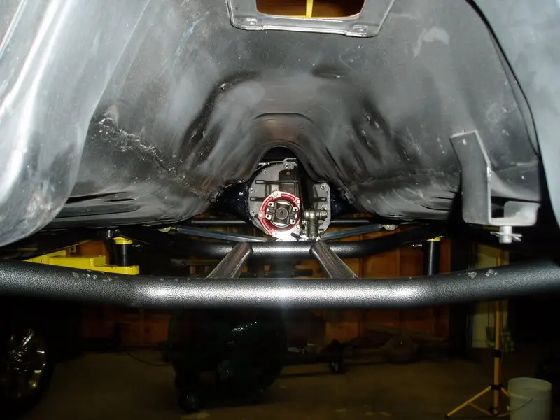

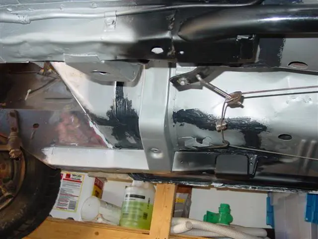

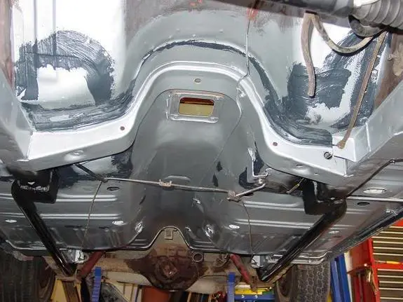

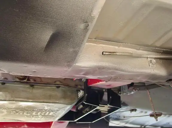

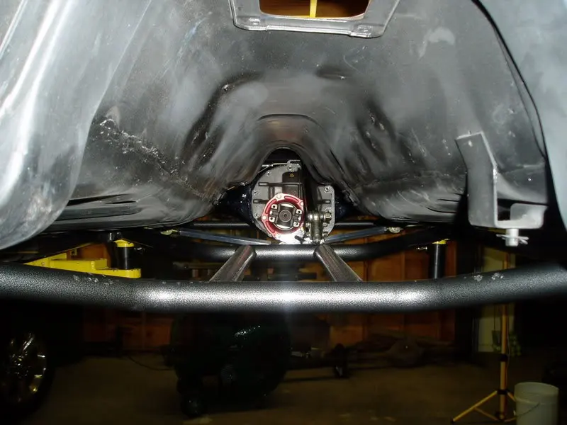

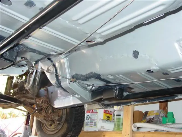

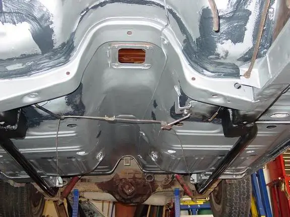

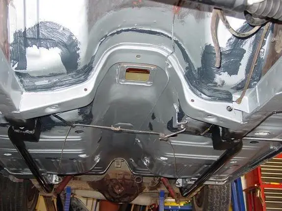

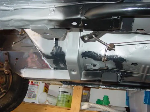

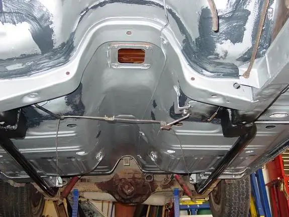

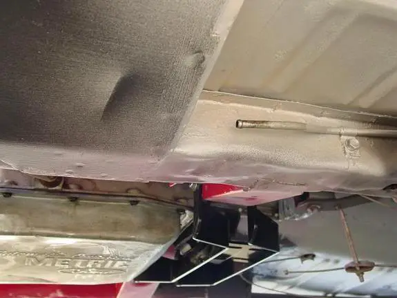

67 FB, where to mount "E" brake brkts?
I hope these help.

Mike, the pivot on mine is 3 1/2" from the left frame rail and 3 " aft of the tranny hump frame. To clarify, these measurements and the ones I previously posted are not to the actual frame, but to the frame flange that the floor pan rests on.
