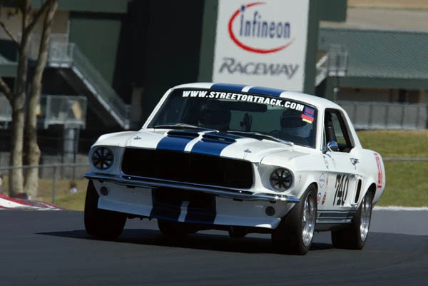

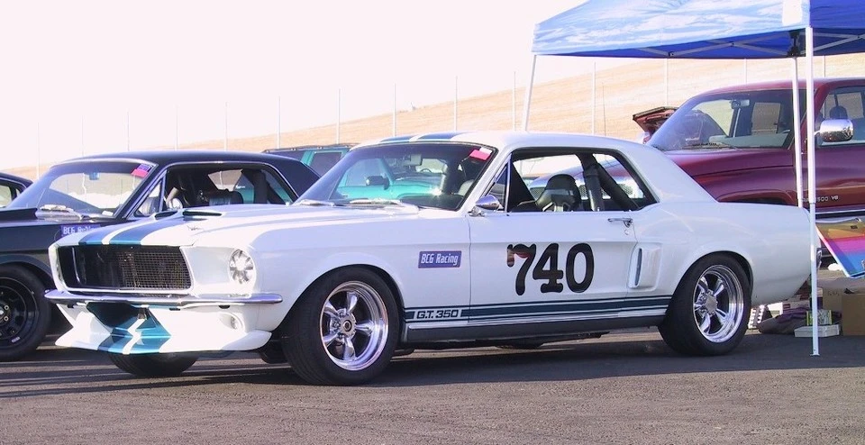

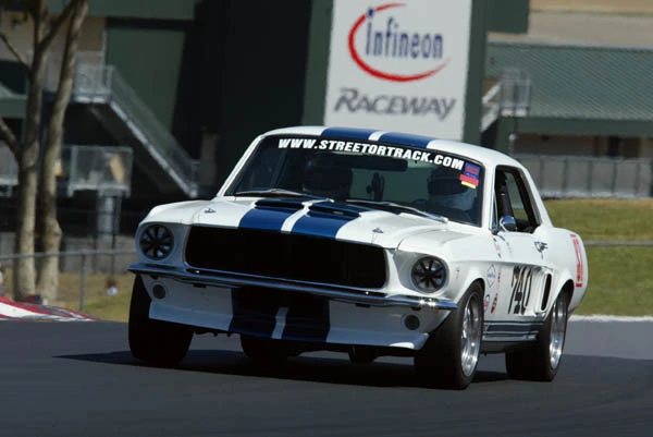

I don't have any close-ups of them, but here's a couple pics of my car from different angles:

Are you talking about the uppers (fastback only) or the lowers? I bought my lowers from Branda, uppers from Mustangs Unlimited via ebay and saved a few bucks. The quality of the uppers was very nice indeed. My fastback is aprt right now, so if you need a pic of how they're mounted, just say so and I'll snap a couple pics, they weren't too bad. Mind you, I put functional (I don't hang non-functioning decorations on my car) '67 scoops on my '68, and they took a bit of work, but overall it wasn't brain surgery and came out nicely.

Back to those scoops: working with them really isn't that difficult. You will have to drill a couple holes (I'm pretty sure it was two per side) in the correct spot (I had a body shop do it because they were repairing a dent in that spot on one side). Then I used a rasp (kind of a rough file) to get the fit close, then sanded them down to fit better. As soon as you hold them in place, you'll see what I mean about fit. I just held them up and marked with a pencil or crayon where I needed to take material from. Fiberglass is pretty easy to work with, really.
One other note: I wasn't reallly happy with the scoops until I put the rocker stripes on (too much white with nothing to really break it up). I think the stripes really changed the look of the car and I like them now.
I can dig up a picture of what it looked like without the stripes if you are interested.

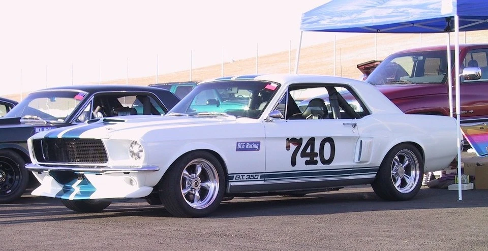

Lance, forgot to post this, but when I was building my 68 I wanted it to look exactly like yours. It ended up looking exactly like the one next to you, lol
That one next to me can spank me on the track every time (he has about 400 hp to my slightly-warmed up 289, plus he's a pretty darned good driver)! Now, to add insult to injury, he's painting it and I'm helping him add the big Maiers' flares (he'll have at least 275 cm of race rubber on the ground!).
