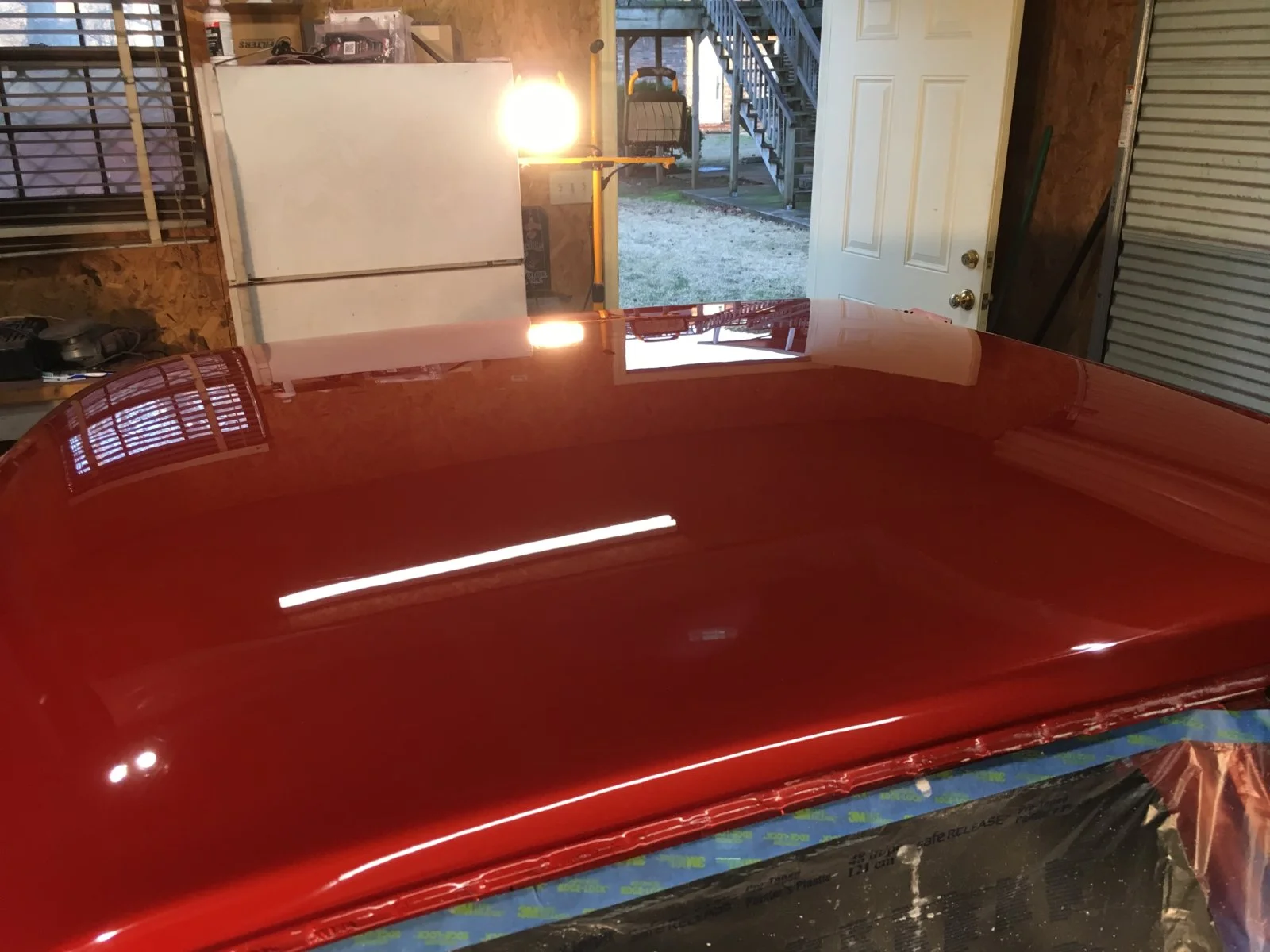

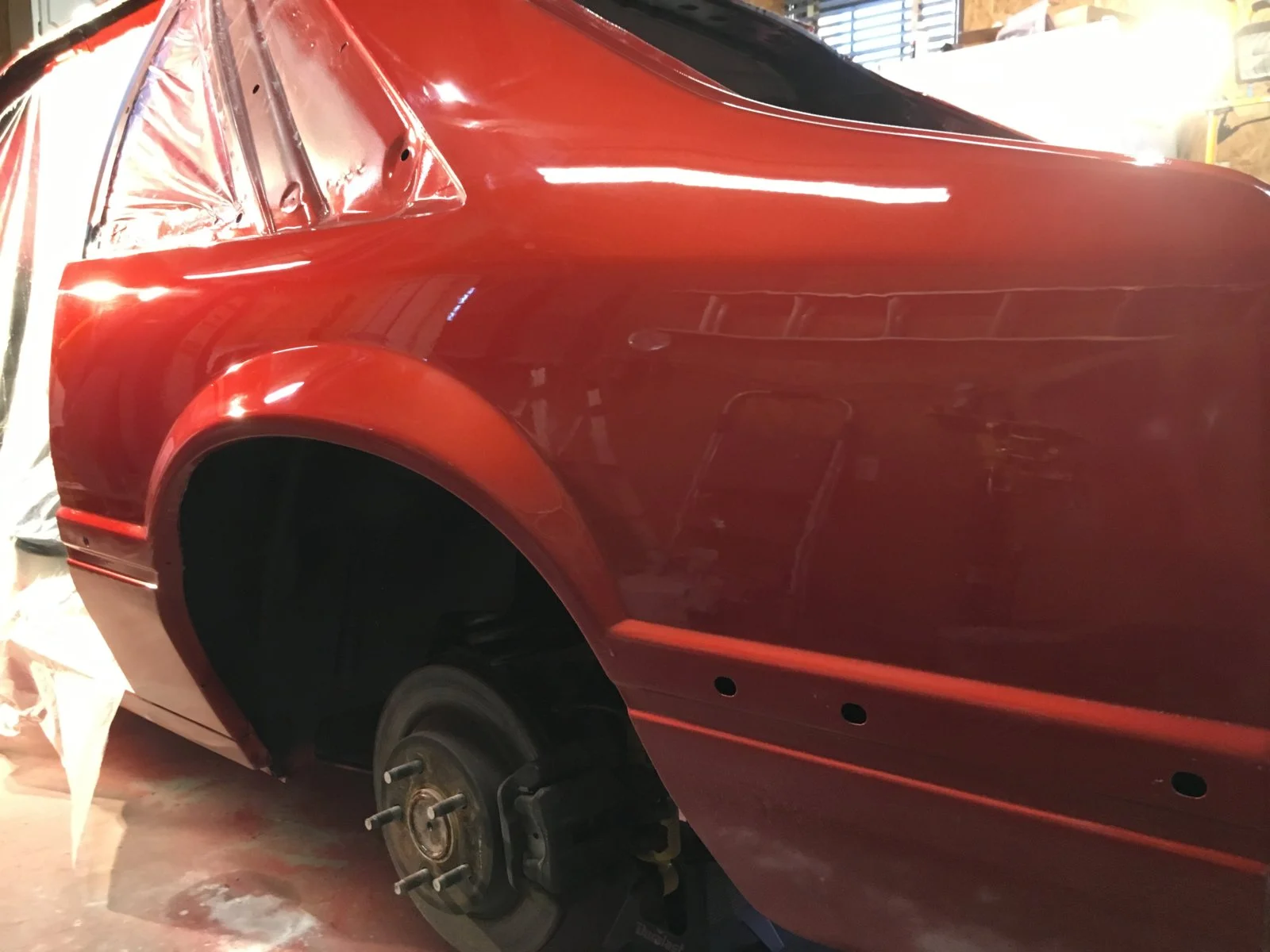

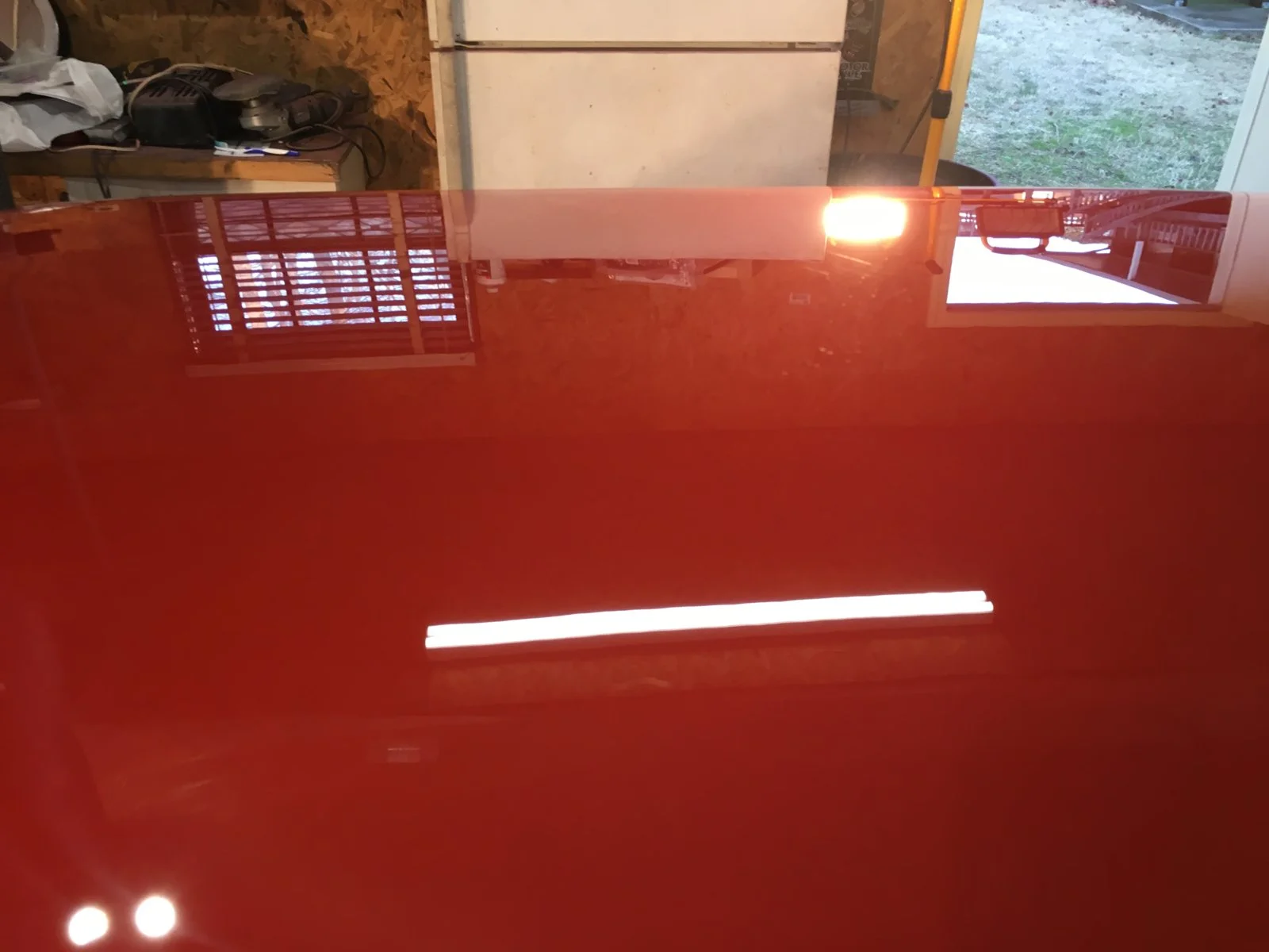

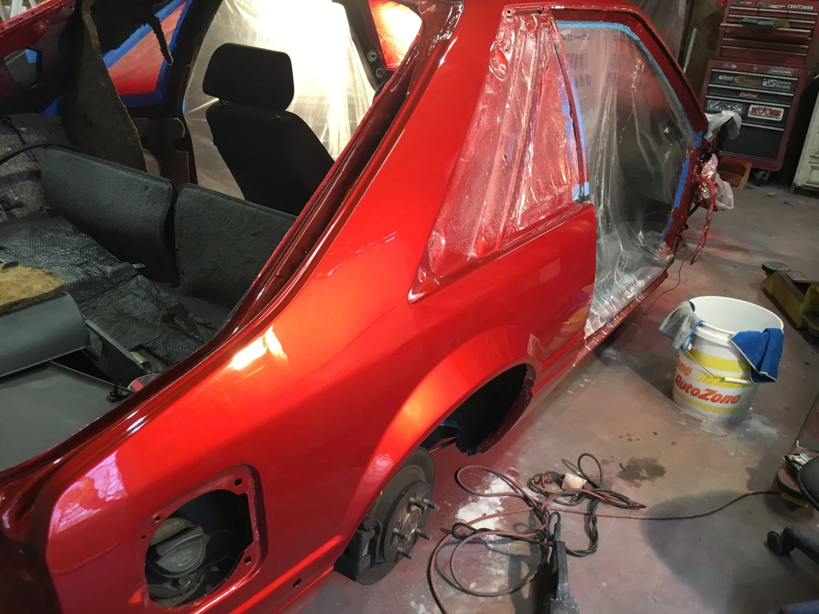

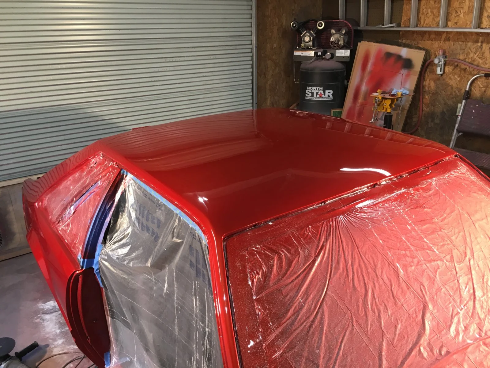

I knew the clear had some runs in it but didn’t know how bad till I started wet sanding yesterday. I put it on so thick, unbeknownst to me, that I had to basically block the whole car. What a pain!
This is my first time using Axalta (DuPont) clear. It continues to flow out after it’s on the panel. Very different than Nason’s clear. Nason kind of stays put when hits the panel.
At any rate, after 12 hours, I’m pretty damn happy with it.

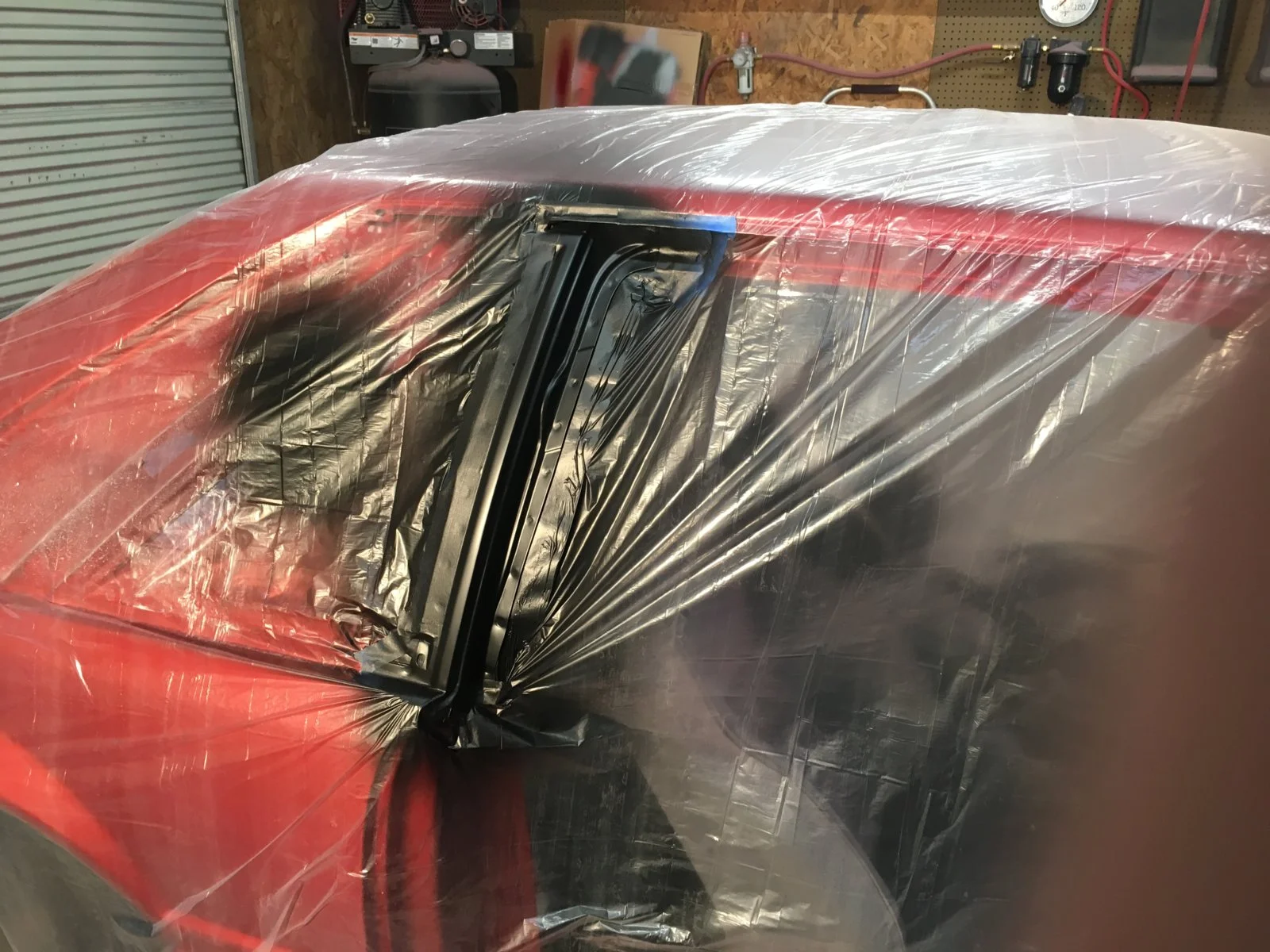

Going to paint trim black on the B pillars tomorrow. Then replace the windshield and finally work on getting the engine back in.

Got the b pillars painted today
Next up is windshield. Then put the engine bay back together.

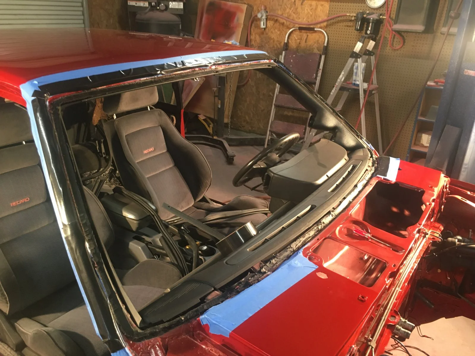

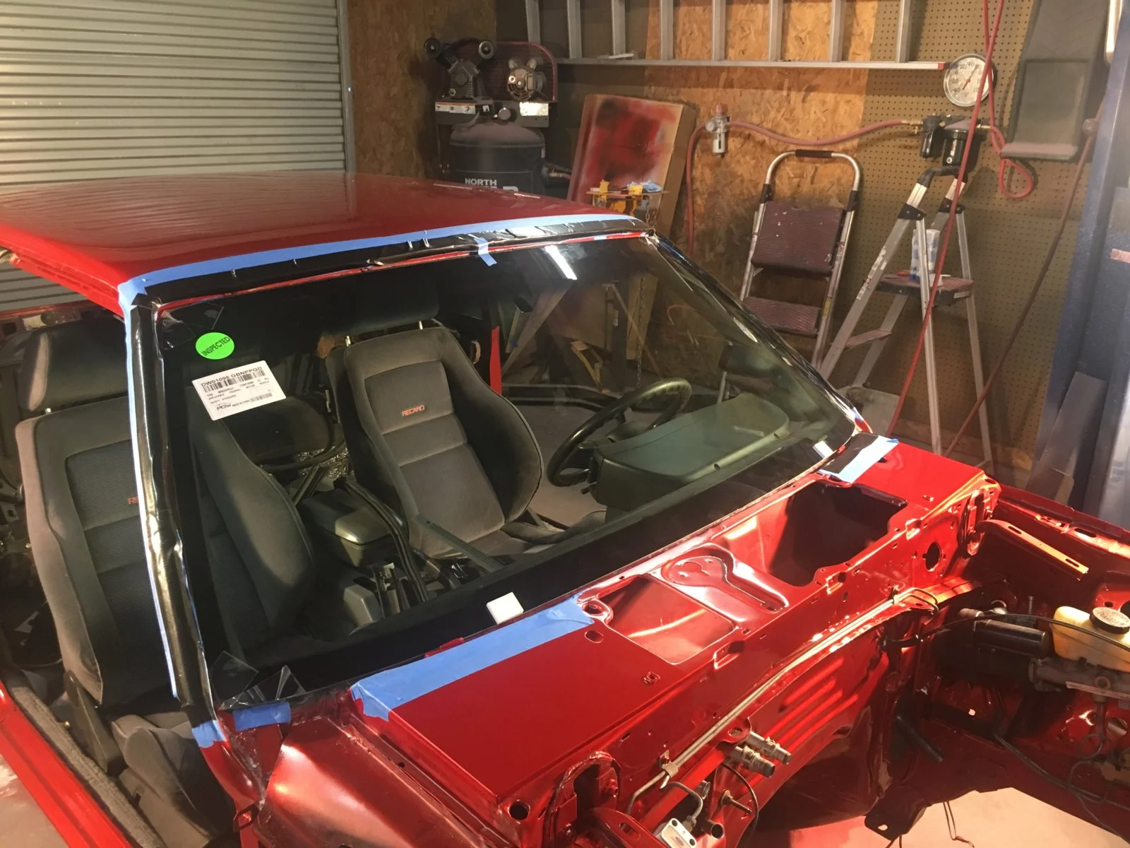

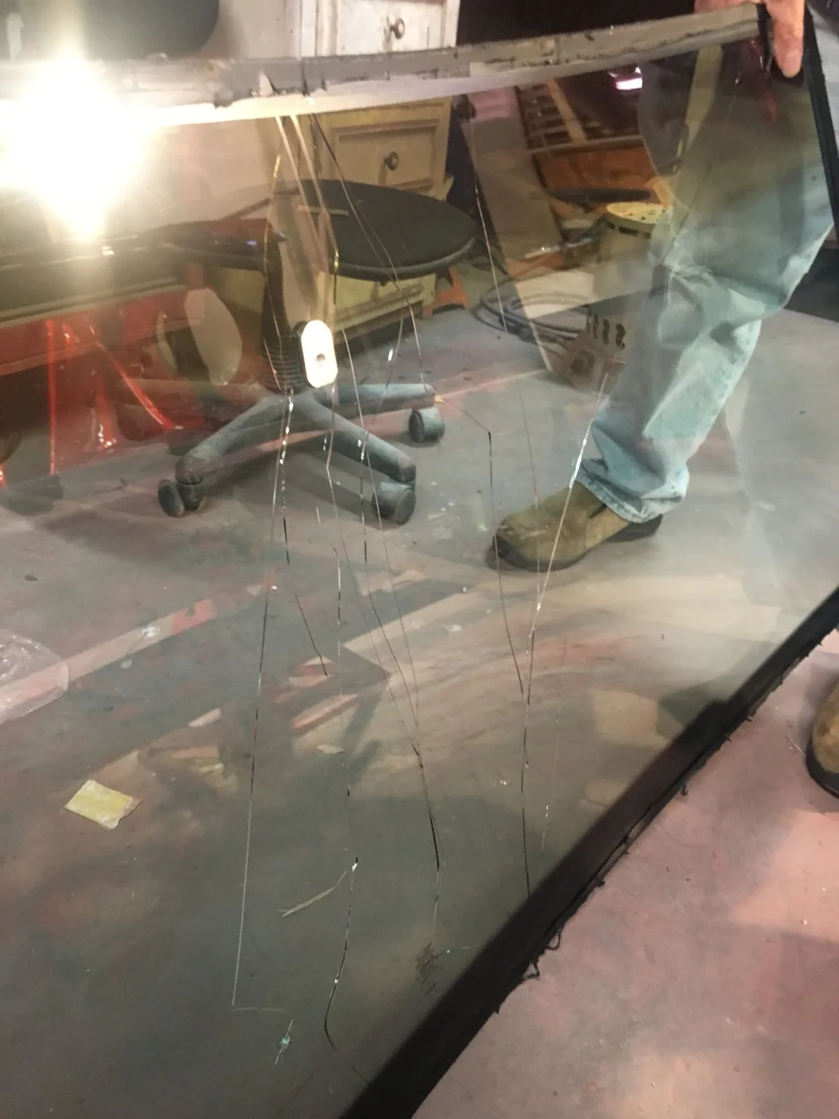

Made some significant progress. Got the the old windshield out.
Good thing I wasn’t trying to reuse it. It cracked a few times while using the removal tool.

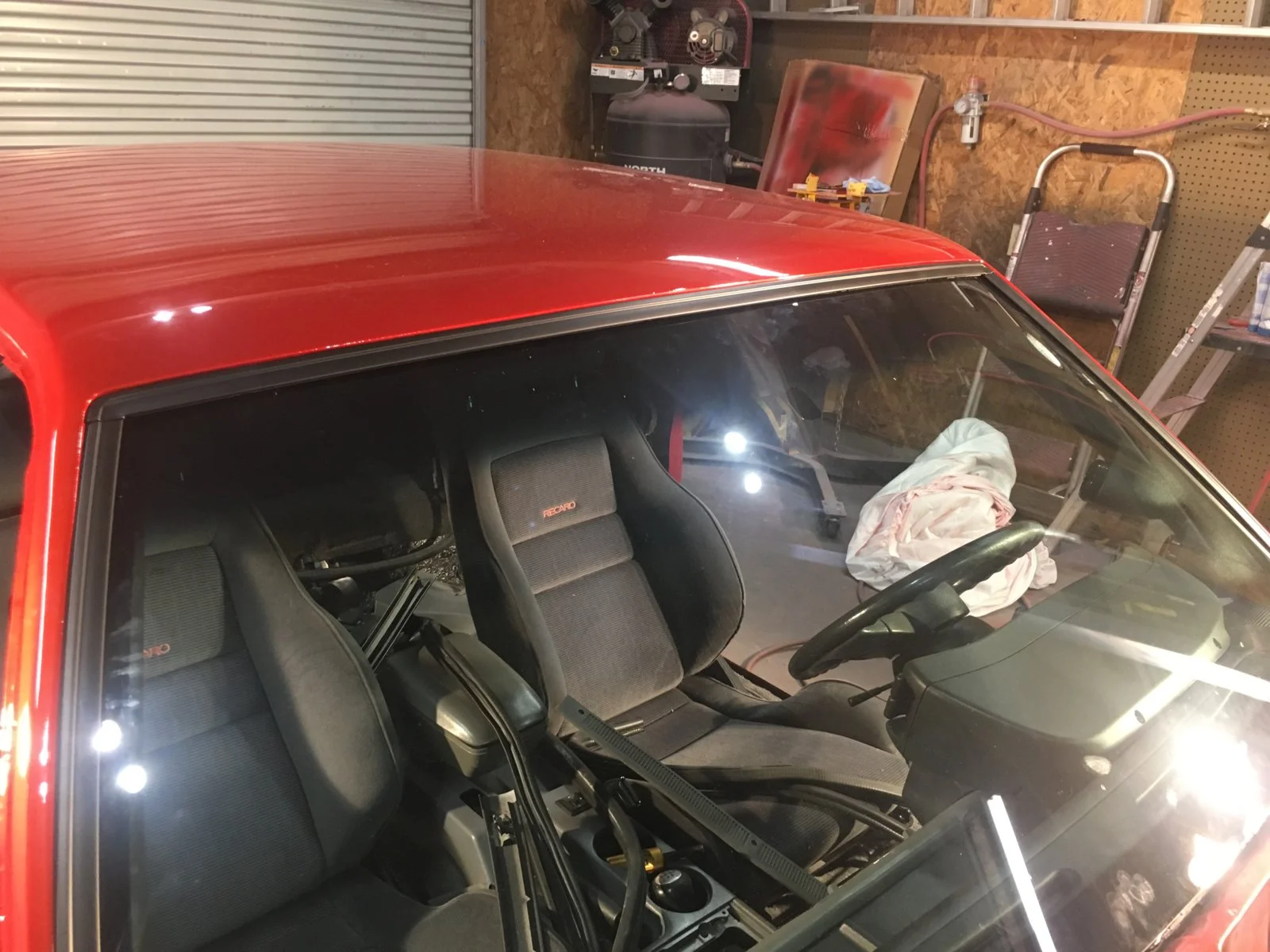

Got the pinch weld cleaned up and test fit the new glass

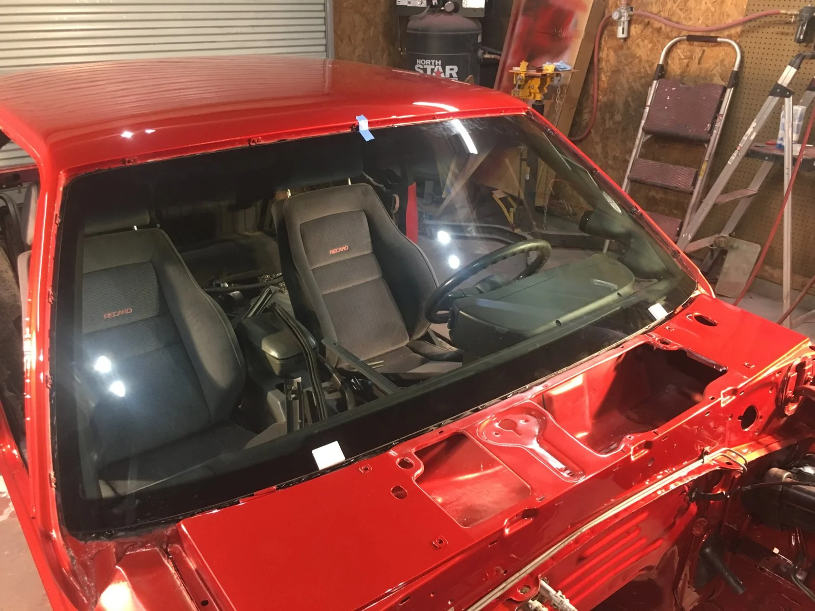

Then applied the primer and urethane adhesive and set it in place.
Then installed the top and side trim!
I’m pretty excited about the new windshield. The old one was sandblasted. Saw over 200k miles and had two large rock chips.

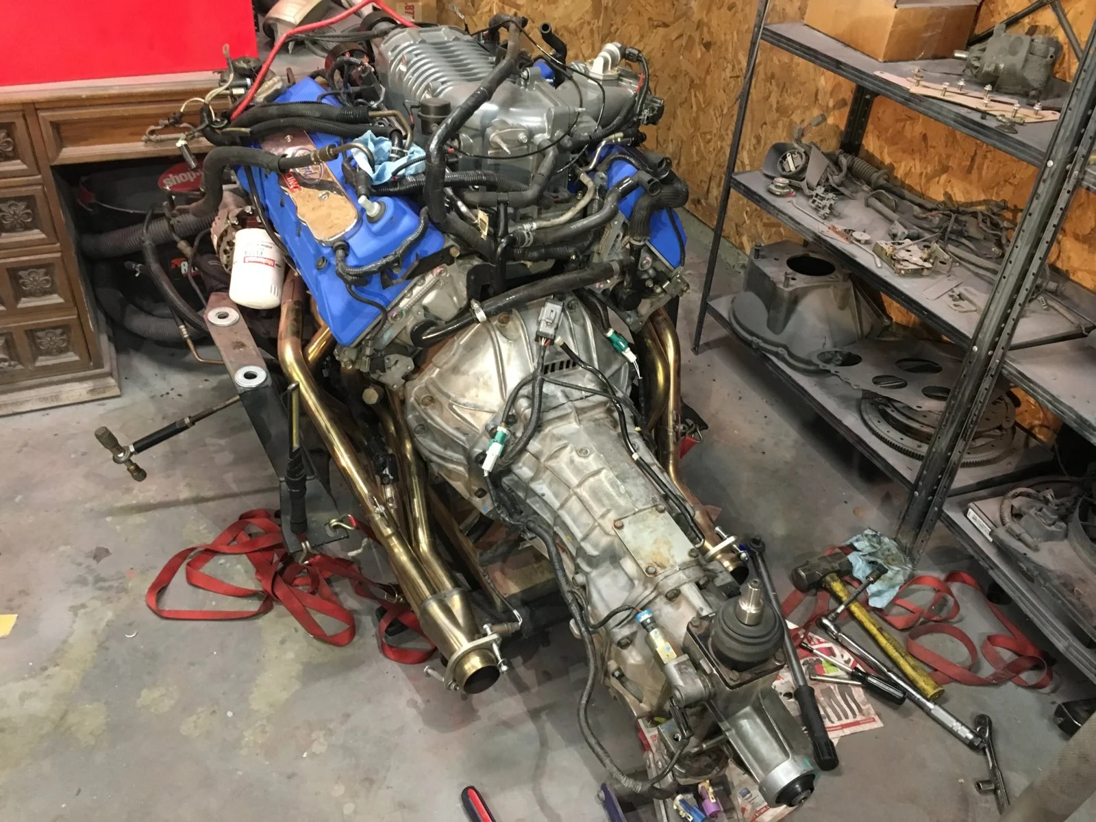

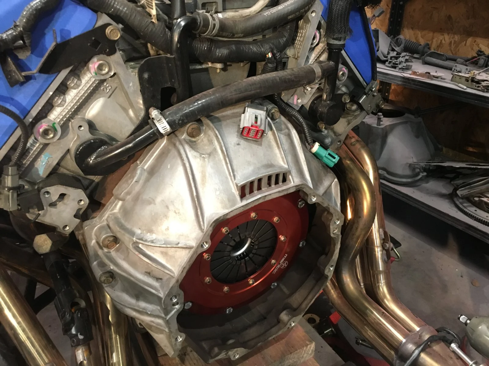

Next up is some drivetrain mods while it’s out of the car. First up was the clutch. The current clutch is a centerforce dual friction and even through it hasn’t been installed very long. It’s already slipped and smelled a few times. Since I’m adding more power with the Whipple, now was the time to address it.

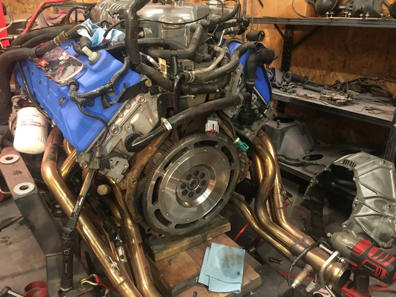

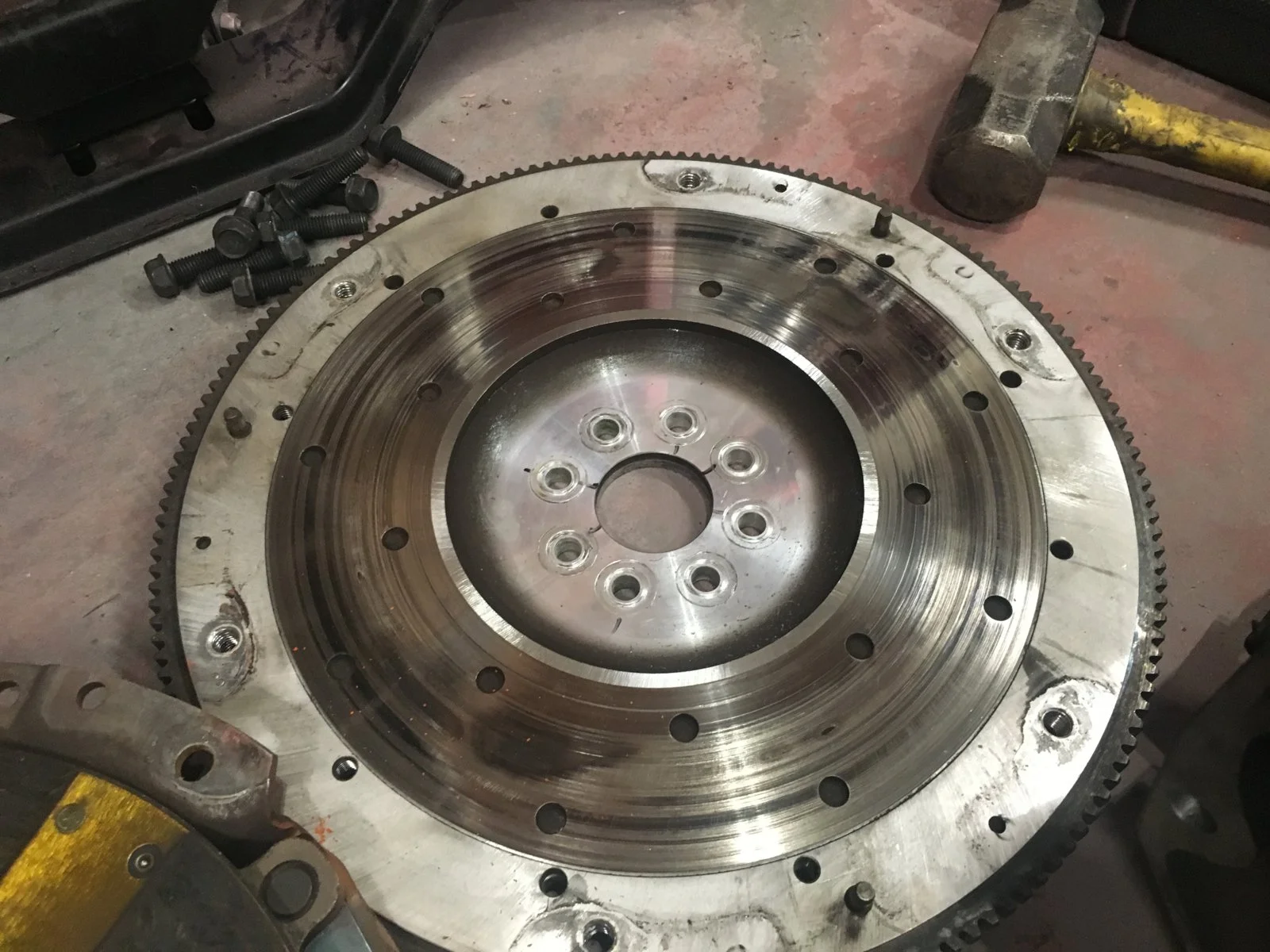

The not that old flywheel (2000 miles).
The new flywheel.

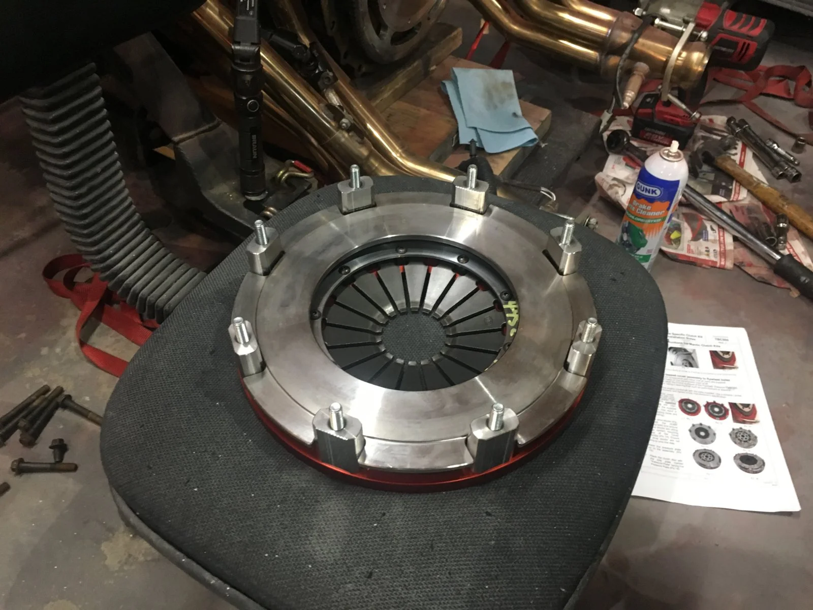

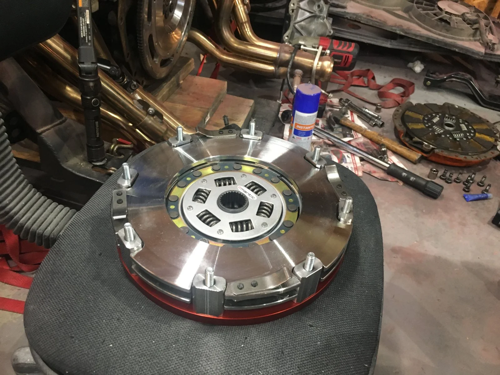

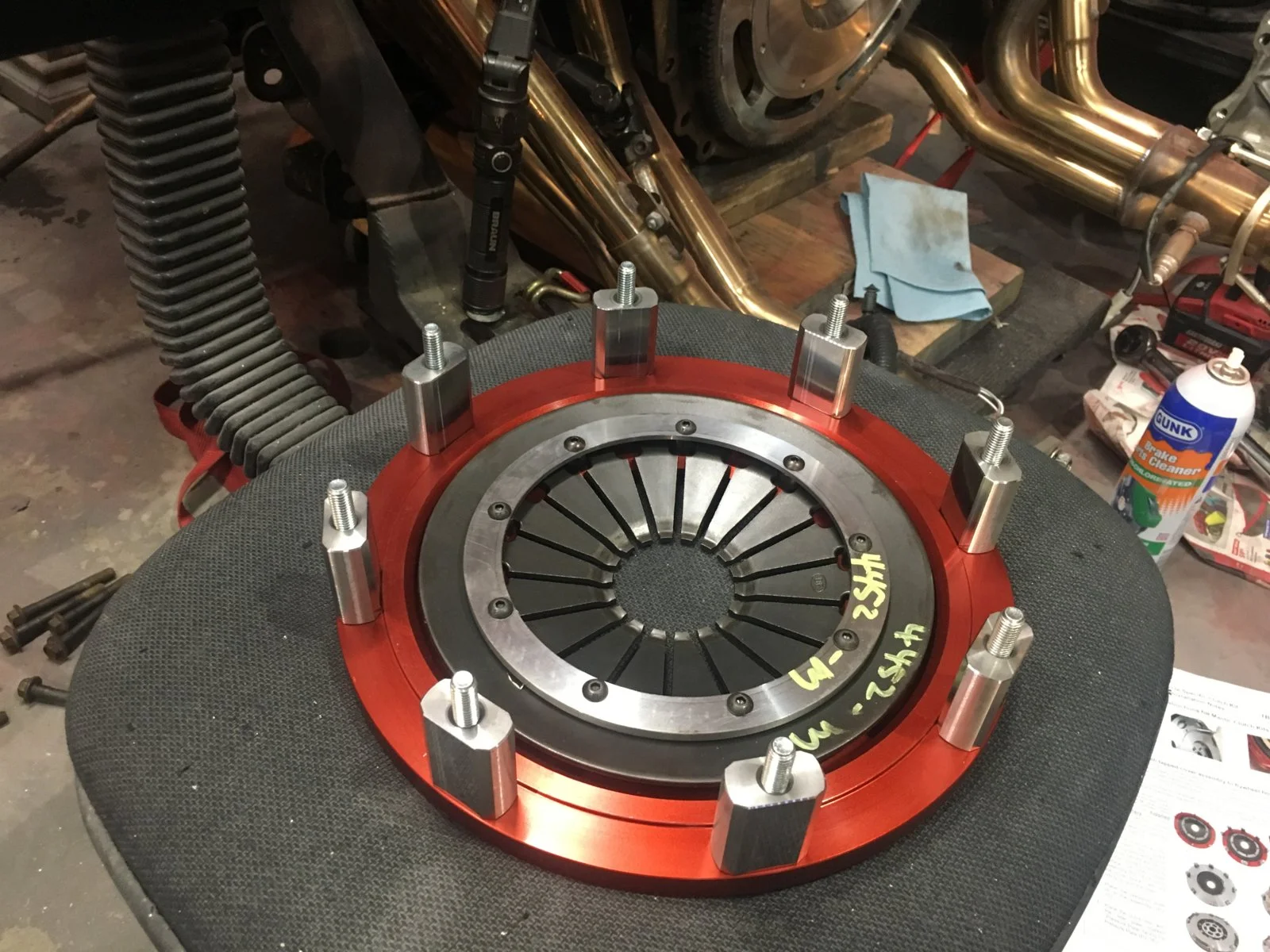

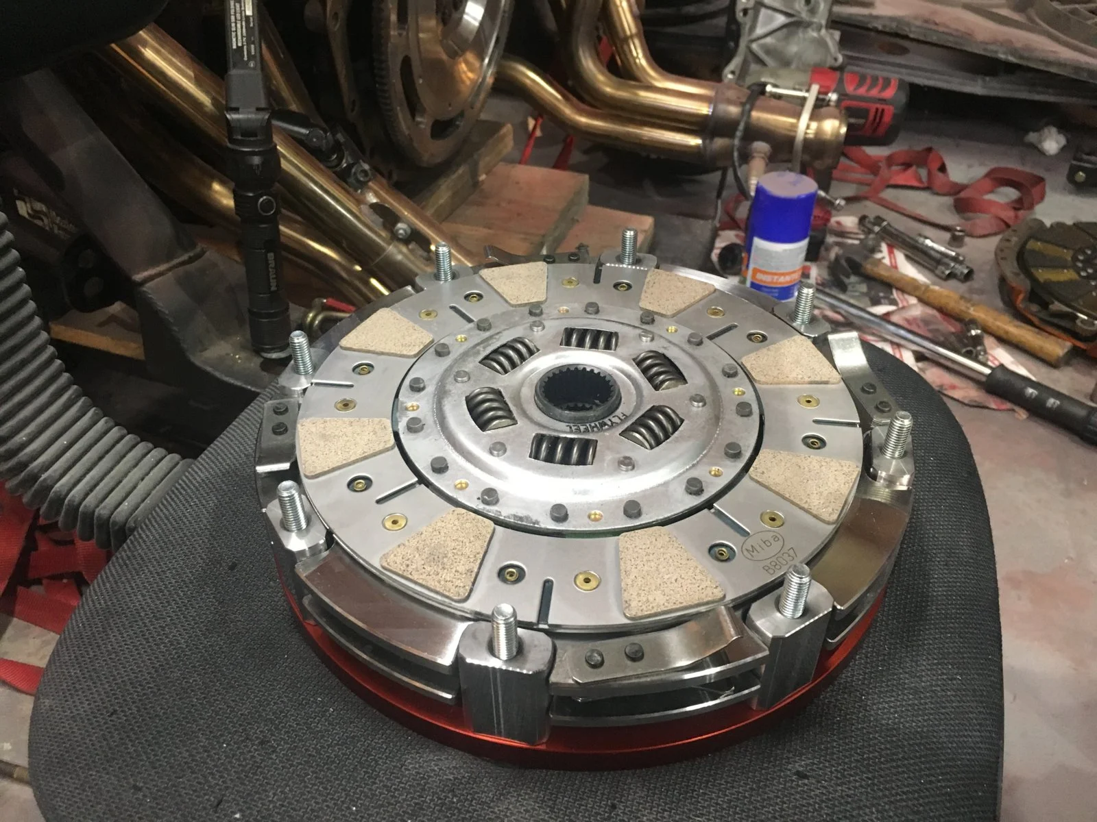

New flywheel came with a twin disc clutch setup. Here’s the build up of the clutch.
Pressure plate and top friction disc.

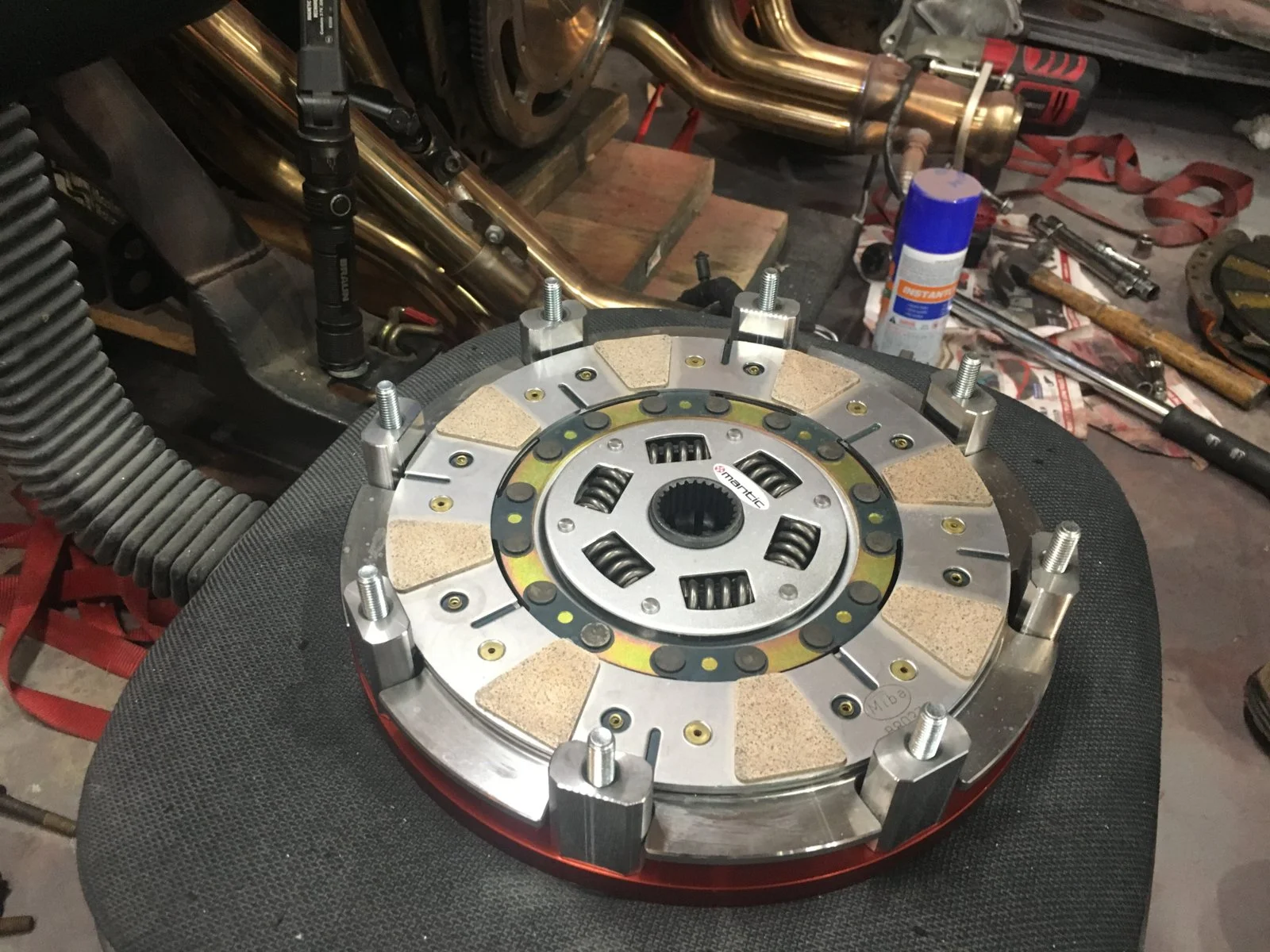

First clutch disc.
Second friction disc.
Second clutch disc.

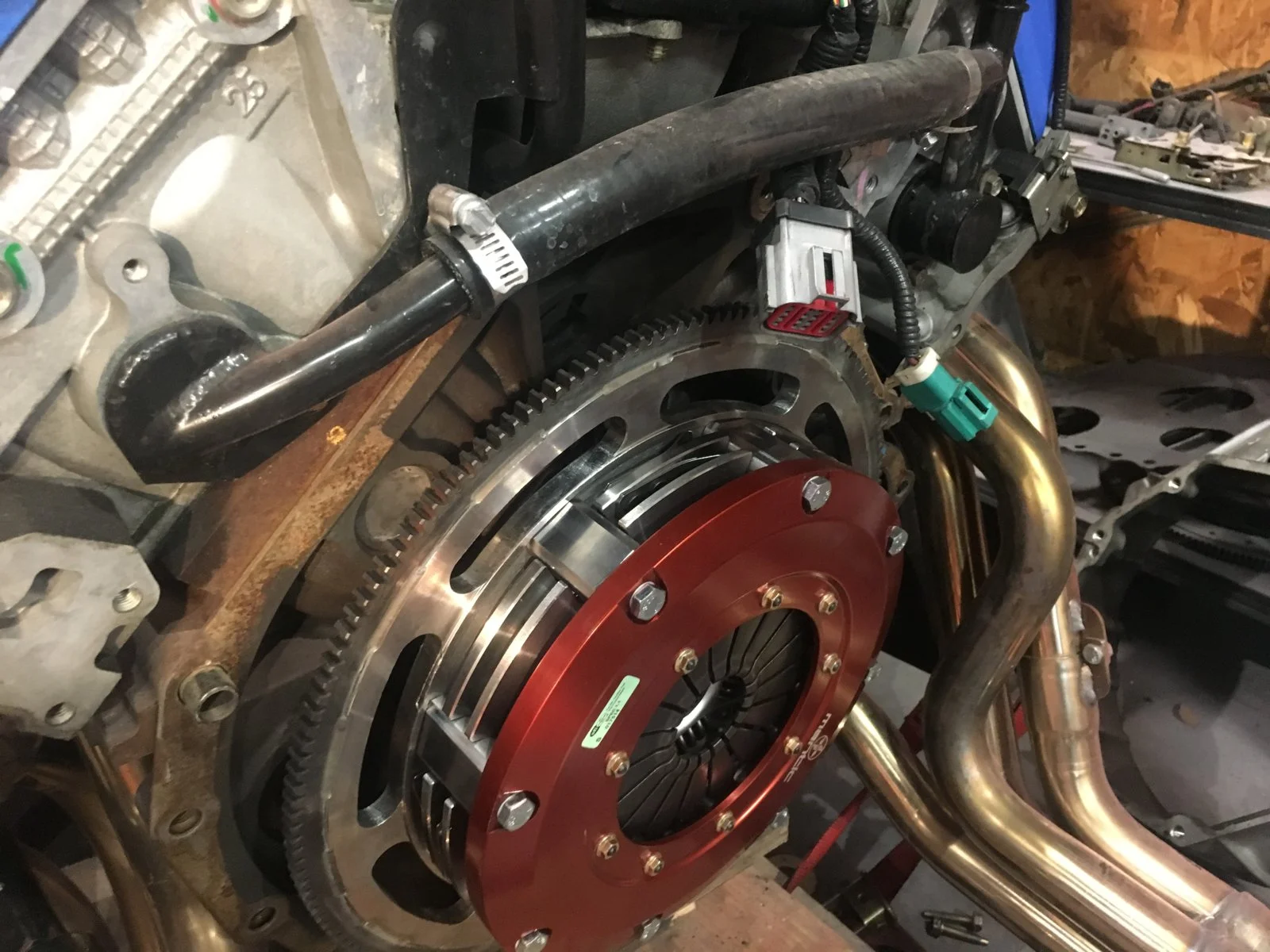

And bolted and torqued to flywheel.
Next up is re-shimming the 26 spline input shaft. It’s slowly gotten louder since I put it in a few years ago.
After that some wiring delete and start installing bits and pieces in the engine bay. Then install the whipple once the upgraded intercooler arrives.
First clutch disc.

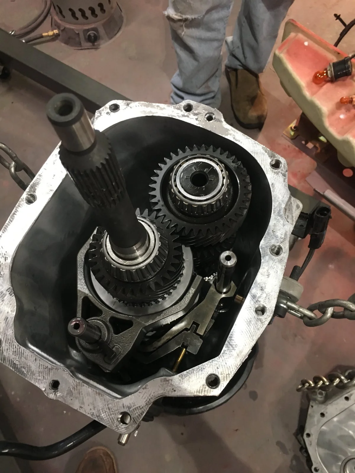

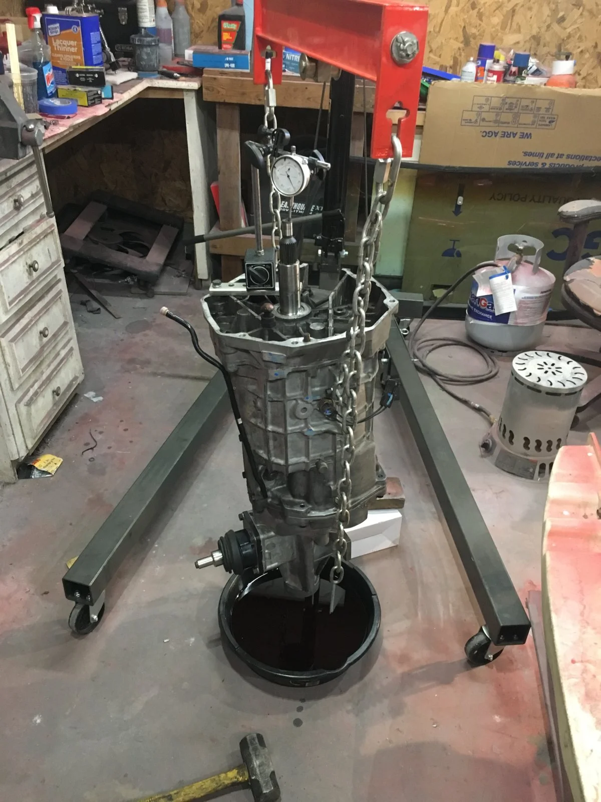

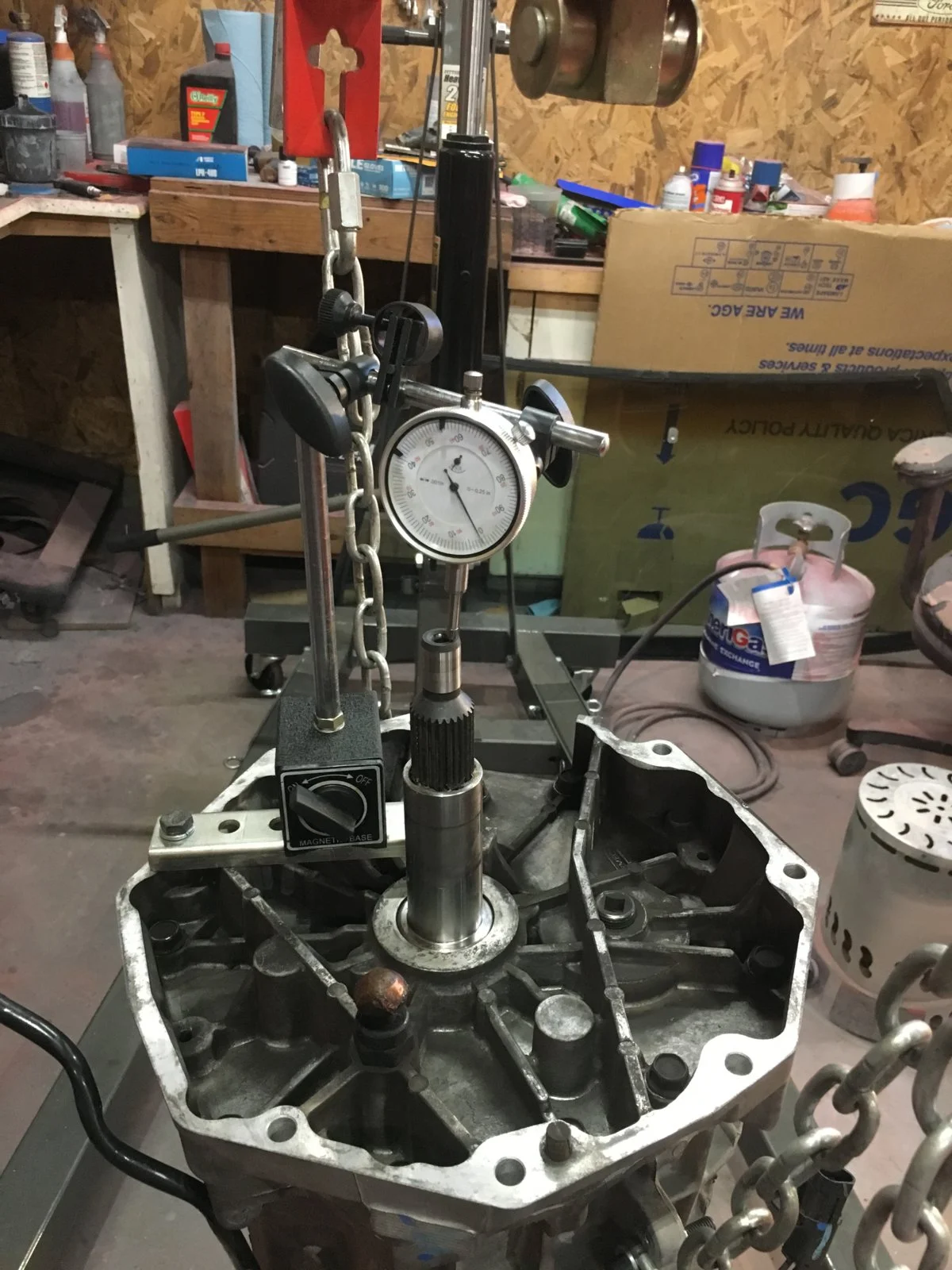

Finally got the transmission input shafted re-shimmed and installed. Turned into a pain and took most of the day.
First I had to figure out the best and easiest way to hang the transmission vertical. Some convenient tabs on the case housing allowed me to hang it from an engine hoist.
Then checked end play.
Measured btw 0.004” and 0.005”. Spec is 0.000 to 0.002”
Pulled the front of the case off.
A 0.037 shim was behind the bearing. Swapped in a 0.041. Bolted it back together and measured a very tight 0.001. Re-assembled with rtv and checked one final time. No change. Right in the middle. Good to go.
