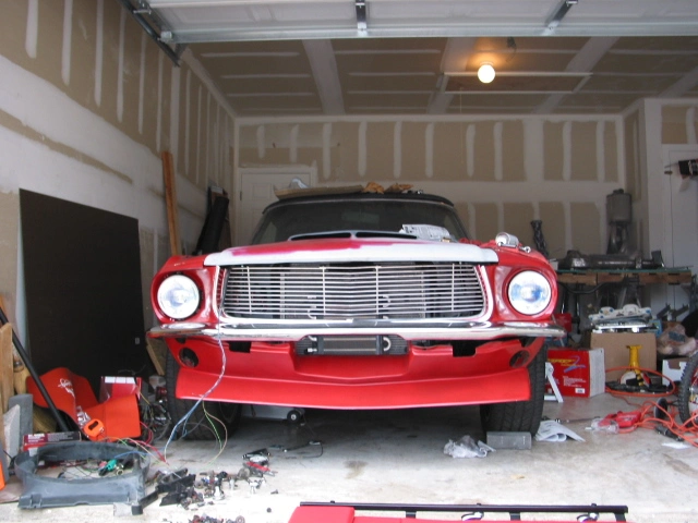

Here it is in a temporary mounting...
http://www.edbert.net/grille.htm

Hey Edbert ,, sorry, I was away a while.
After seeing all the responses and taking into account what I was going to say, well, there is no single way to do it. I made a bracket , the bracket attaches to the grille and the aftermarket radiator support I have :shrug: Pretty much like everyone else. I will take detailed photos and email them to you if it may possibly help you out. Just let me know ! :rolleyes:
