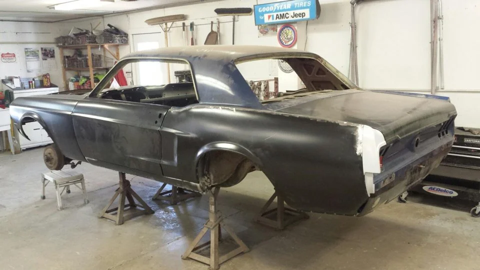

Making progress on the project. Sold both rear ends I have and in process of getting 8.8 w/ 3.73 gears & disc brakes from late 90's mustang converted to leaf springs. Body guy has convinced me to stick with 16" rims for now any way. Going with front disc brake conversion from Master Power Brakes http://www.mpbrakes.com/1968-ford-mustang-front-disc-brake-conversion-kit-legend-series?filter_name=. Looking for 16" bullitt rims now in gun metal. Anyone have advice on off-set rim dimensions? Rear end is same dimensions as 68 so assuming late 90's should fit. Thanks to everyone for their help.

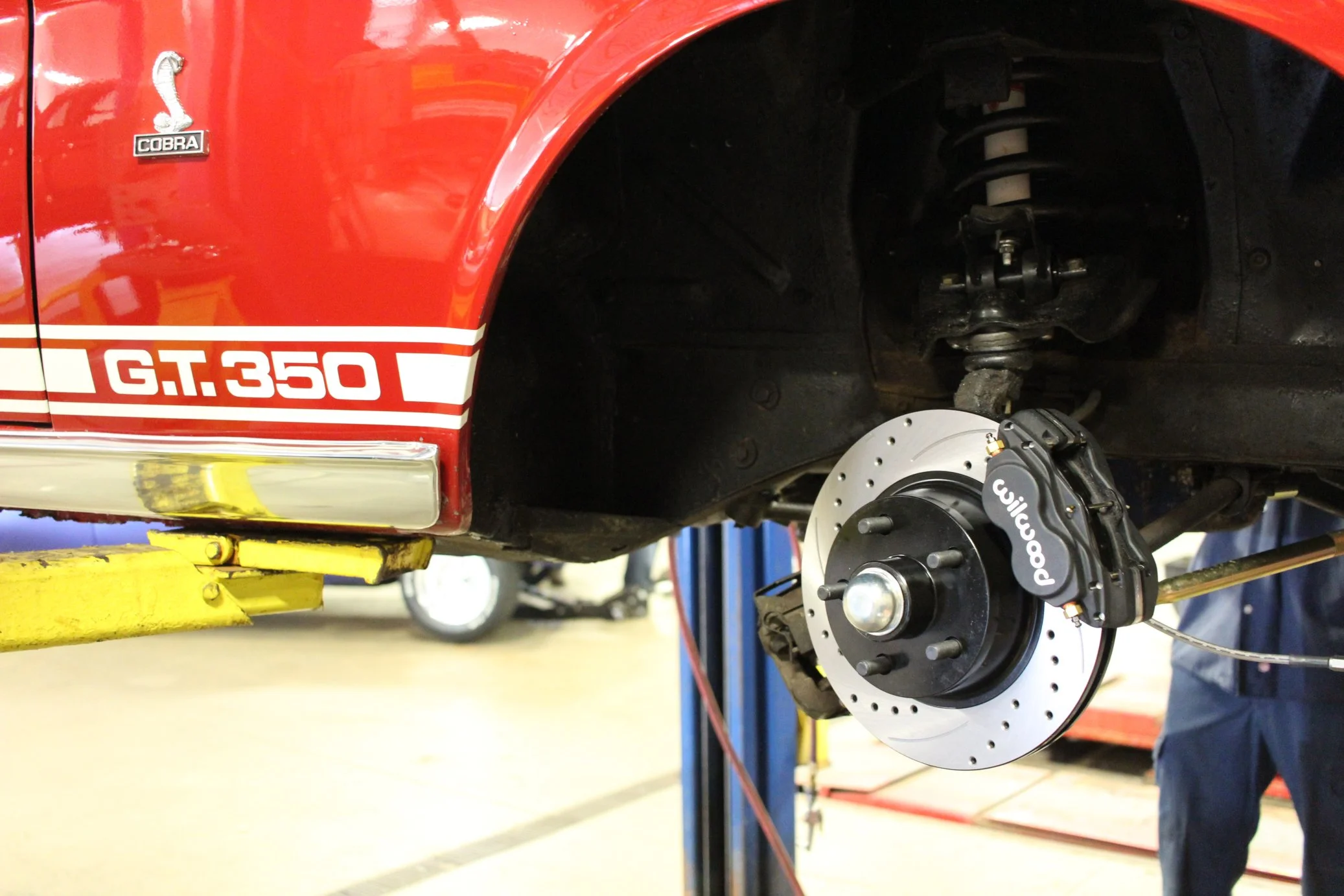

Img_0165-M.webp I just did the Wilwood 4 piston set on my 1968 Shelby GT350. It had a single piston Kelsey Hayes disc on it from Shelby American. Even though Wilwood and CJPony told me that the Wilwood was a bolt on, it was not. All those kits apparently are designed for drum brake cars. What is the difference? The holes that the Disc brake Caliper bolts into on the spindle are much smaller. In fact I was a bit shocked to realize how small they were. The Wilwood came with 3/8 inch bolts. We drilled out the wheel spindles and tapped new threads for the 3/8. Then it was a bolt on deal. The other good news was this Wilwood classic disc brake set up was actually more compact than the existing Kelsey Hayes, so they fit my 15" 10 spoke Shelby rims better with more clearance. By the way the Wilwood kit was a bit cheaper at CJPony than directly from Wilwood. Go figure that. And cheaper than the Kelsey Hayes knock offs. The shop I had do the brake work had a drum brake 66 Fastback at their shop before I brought my car in. That owner got a kit from SSBC. That Mustang was still setting there when I pulled my Mustang out of their shop. The kit was also not a bolt on deal and needed to be modified to fit the car. The only good thing was he had drum spindles that didn't need drilled out. It was other parts of the kit that were a problem. I'd recommend the Wilwood's. Except for the spindles needed to be drilled this was a bolt on deal. Everything was there and fit as advertised. And I love the brakes I have on this car now. Does it make a difference? You bet. Be forced to do a panic stop and think about what the brakes are worth. We all want our Mustangs to go. But we also need them to stop.
