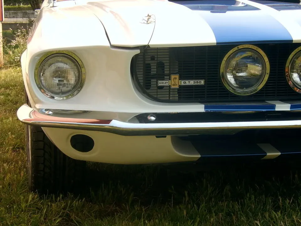

I'd have to respectfully disagree. I bought my whole front end and hood from Mustangs Plus and nothing, not even one part even came close to fitting. The hood was so narrow the fender bolts showed and the nose piece probably would've fit my '88 GT just as well as it fit my '68 fastback. But I persevered, cutting it all apart and getting it to fit. On the rear of the car, I went whole hog and bought all my stuff from Tony Branda, the self-proclaimed experts in Shelby repro parts. I paid top dollar and got stuff that fit just as bad as the Maier stuff from Mustangs Plus. My experience is it's all horrid, and it's a good way to separate who REALLY wants a Shelby clone and who THINKS they want one.

Of all the real Shelbys I've ever seen in my life, none had gaps as large as mine. When I say the bolts showed, I mean the ENTIRE bolt head showed! The hood was 9/16" narrower per side than my original steel hood. The nose was so narrow, I had to cut it into 5 separate pieces just to get it on the car. The fit was horrendous. The trunk was 1/2 inch short at the front, 1/2" short where it meets the taillight panel and 1/4" short per side. To top it off, it had a twist in it. The end caps would lay flat on the table if the studs were removed, and anyone who knows '67-'68 fastbacks knows that end of the quarters is not flat. Not only that, but they didn't have nearly enough of a compound curve on the side, nor would they bolt in place with the Shelby taillight panel in place. The Shelby taillight panel needed to have the upper mounting lip cut off, then the end lips needed to be ground to match the curve of the steel panel, then re-glassed back together. Nothing was even close to fitting and I had hundreds of hours into fitting all the fiberglass. The trash that was being sold when I built my car in '01 was so bad that more than once I wanted to return the car to stock and sell it. I helped a local shop reassemble a basket case GT500 a few years ago and I can tell you that the original Shelby 'glass was far superior to the aftermarket stuff I bought. Until you've had the opportunity of working on both, you really can't understand it, I guess.

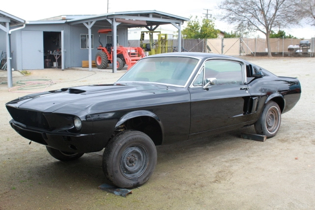

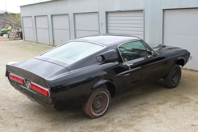

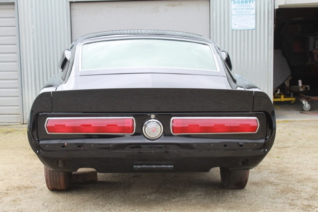

i do understand i have restored both real and replica and i agree with you, most repro fiberglass is worthless, what i am saying is the fiberglass on the origional cars is not a perfect fit, far from it ,any one thinking the origional fiberglass had the same standards as todays mustangs steel pieces or even the origional steel is in for a big let down it was bassicly what you would find on a race car. i have bought trunk lids from mustang plus the edge towards the back glass diped down about a half inch and had to cut the under brace in several places to get the right arch .it was to short and to narrow,my 67 has glass from stang-aholics i have been using them for several years now and i am very happy with them.
the end caps follow the body, the trunk lid fit very well , it has a gap at the top prety much the same as the origional glass,but wider than a metal lid but that was normal for a 67 shelby, the hood does not have a bow in it as they normaly did but it does have atleast 1/4 inch gap at the sides like an origional , the nose fit beter than an origional i had to sand the mounting flange to fit the fender but i didnt have to add any thing, no mater where you get fiber glass you will have to fit it ,no way around it,but there is some alot beter than others,some is just plain old crap. another problem i have noticed on the forrums is guys are tring to fit the nose sections with the fenders bolted in place, the nose is one piece and not adjustable so all adjustments must be made at the fenders other wise it just wont fit

thats nice and your right .people get into one with out figureing the total cost and wind up selling before they finnish . if my nephew would not have wanted the car black it would have been white with blue stripes,looks good on a 65-66 but looks great on a 67,nice job. i am still not finnished with the black one,that was my up to date pic,
speaking of fiberglass splinters ,i have one in my knuckle right now.
how long did it take you to finnish yours?
