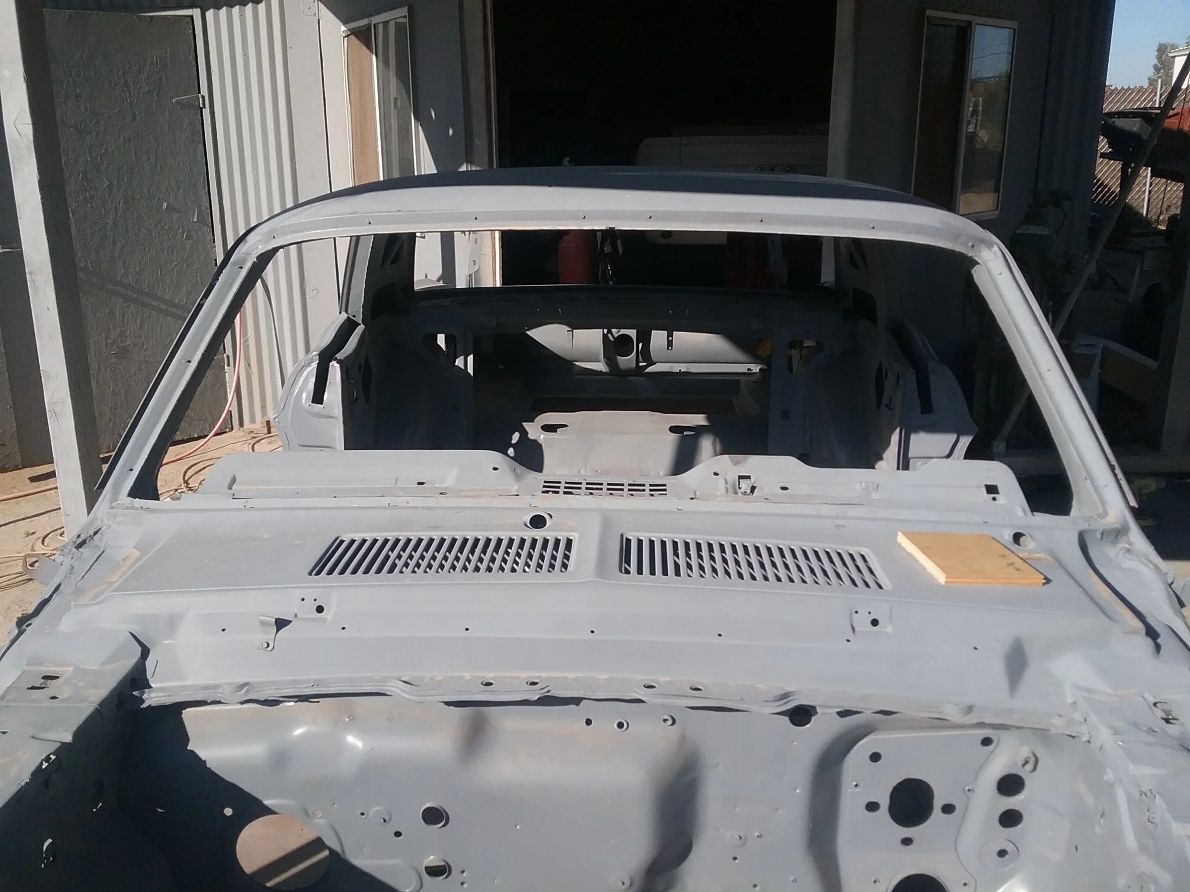

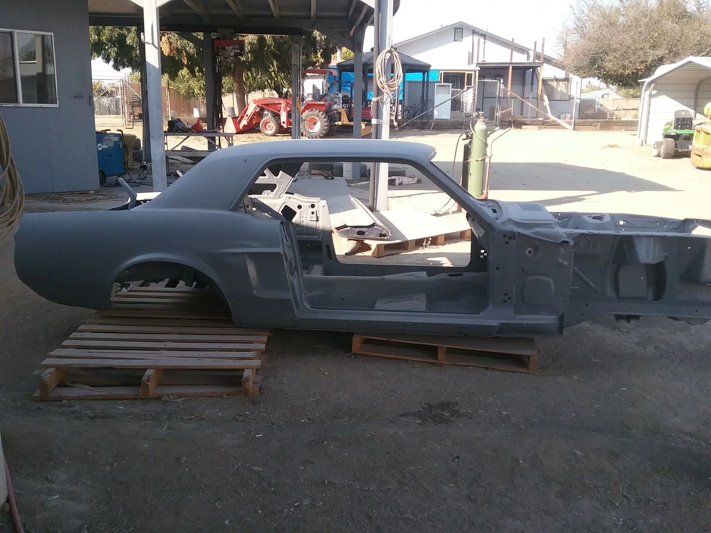

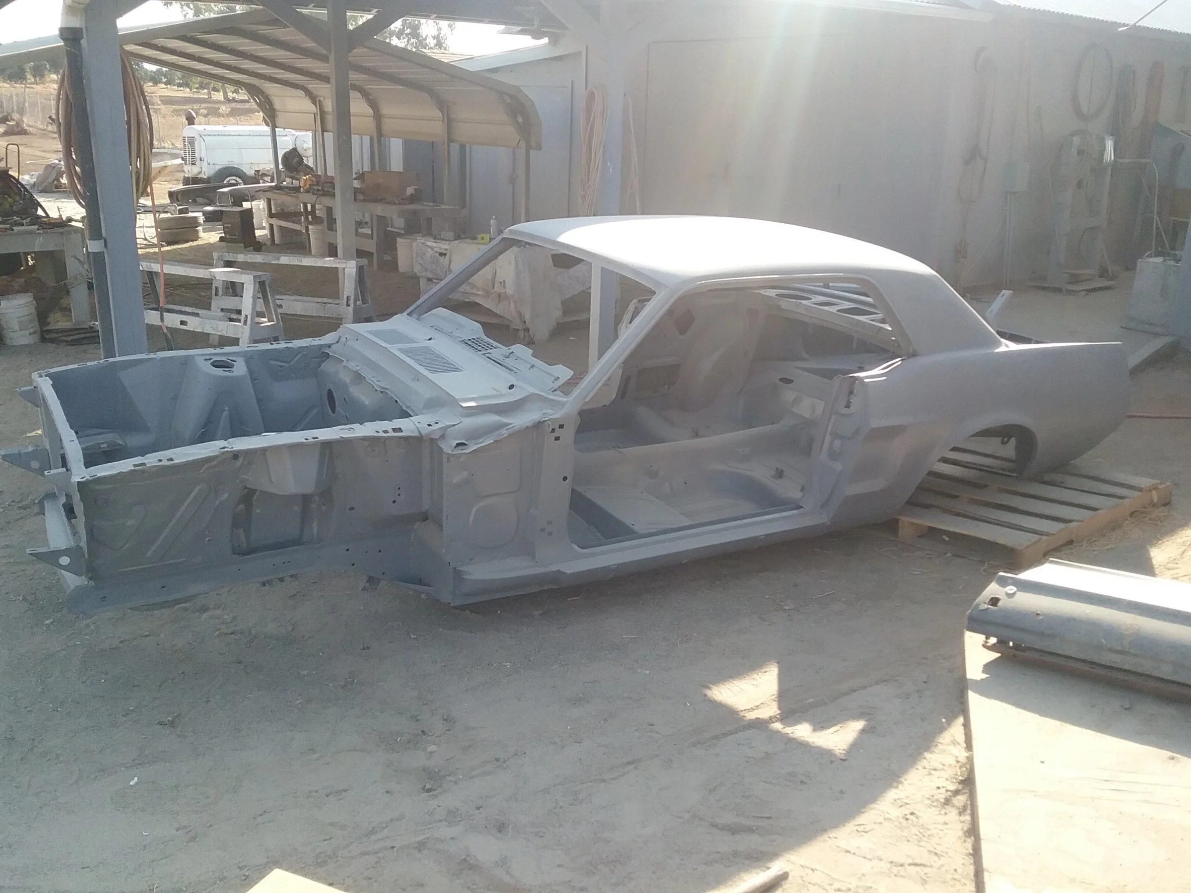

I was brought this 68 coupe needing sheet metal .It was brought in on a flat bed trailer setting on pallets,took 4 of us to lift it off the trailer .

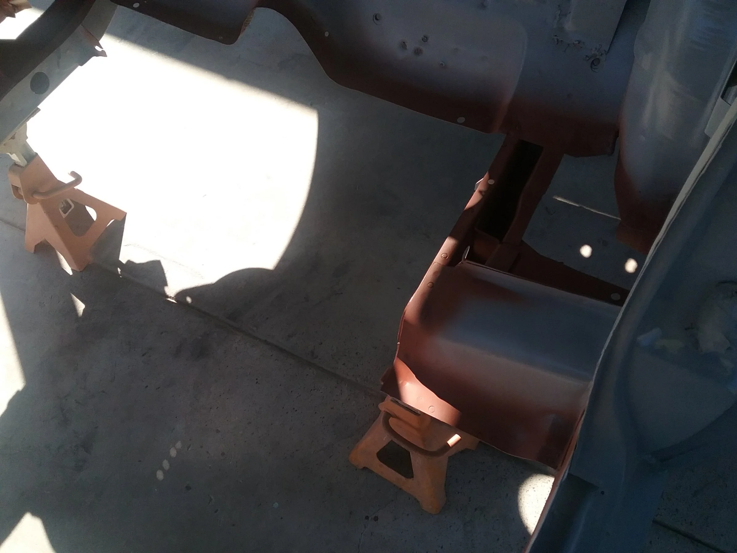

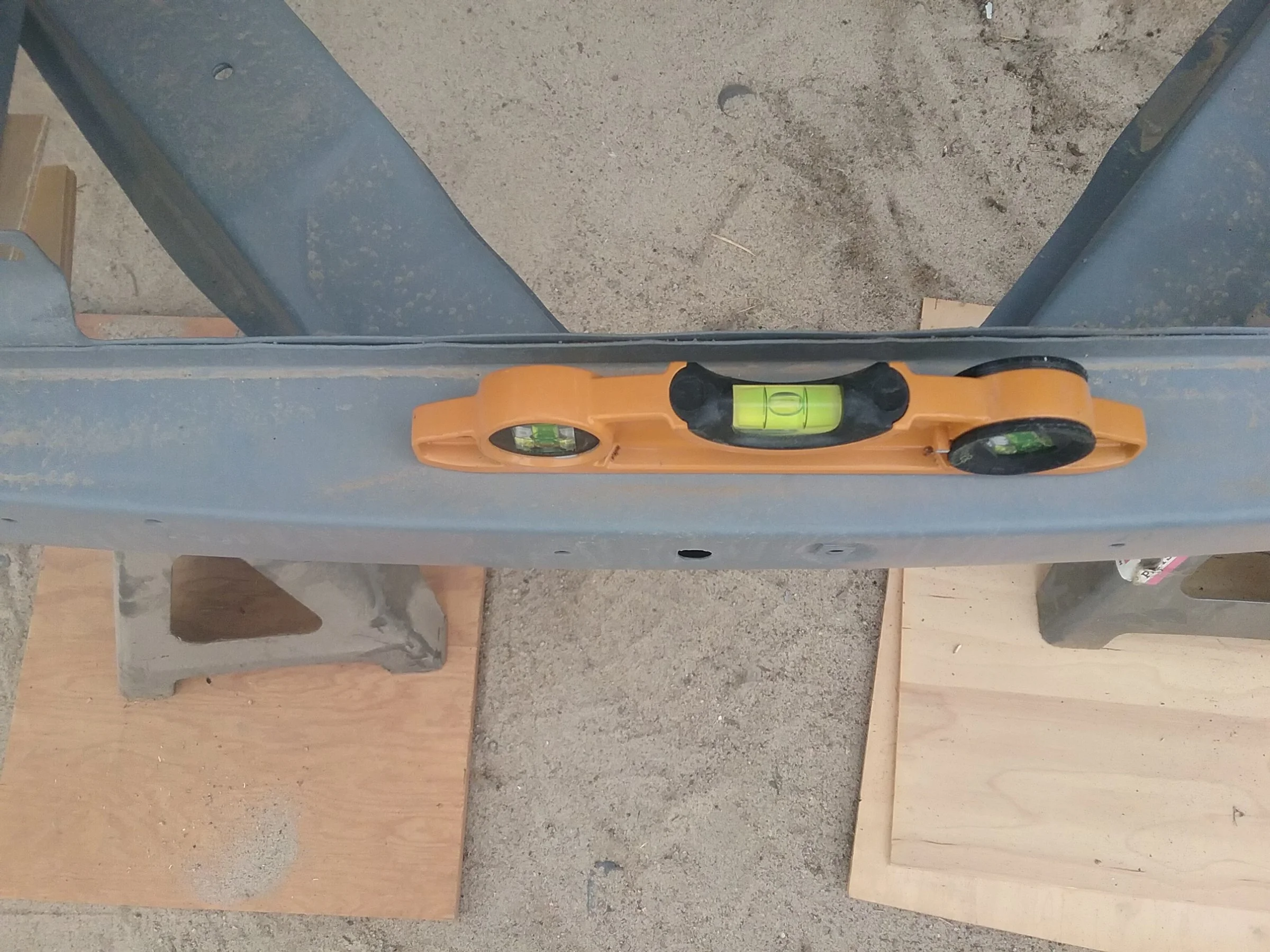

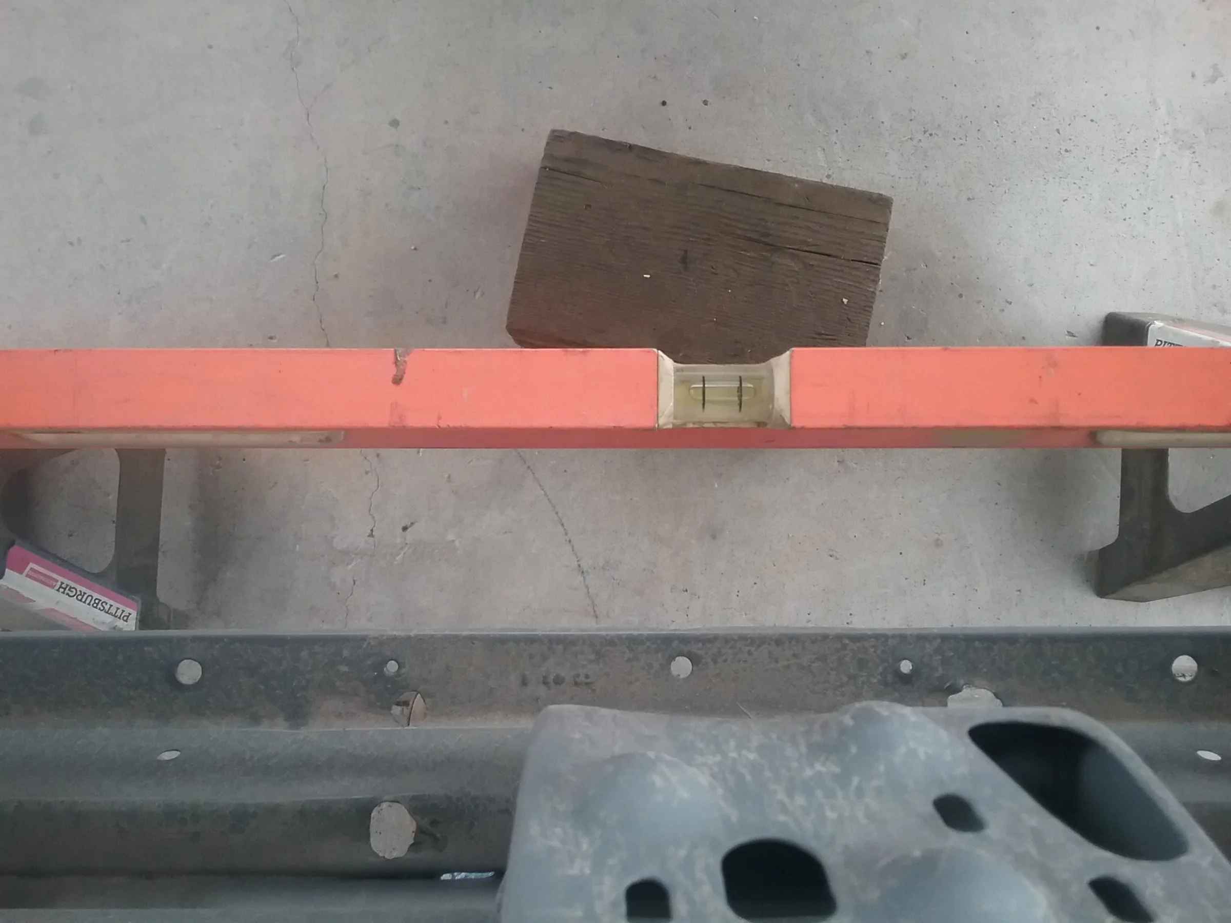

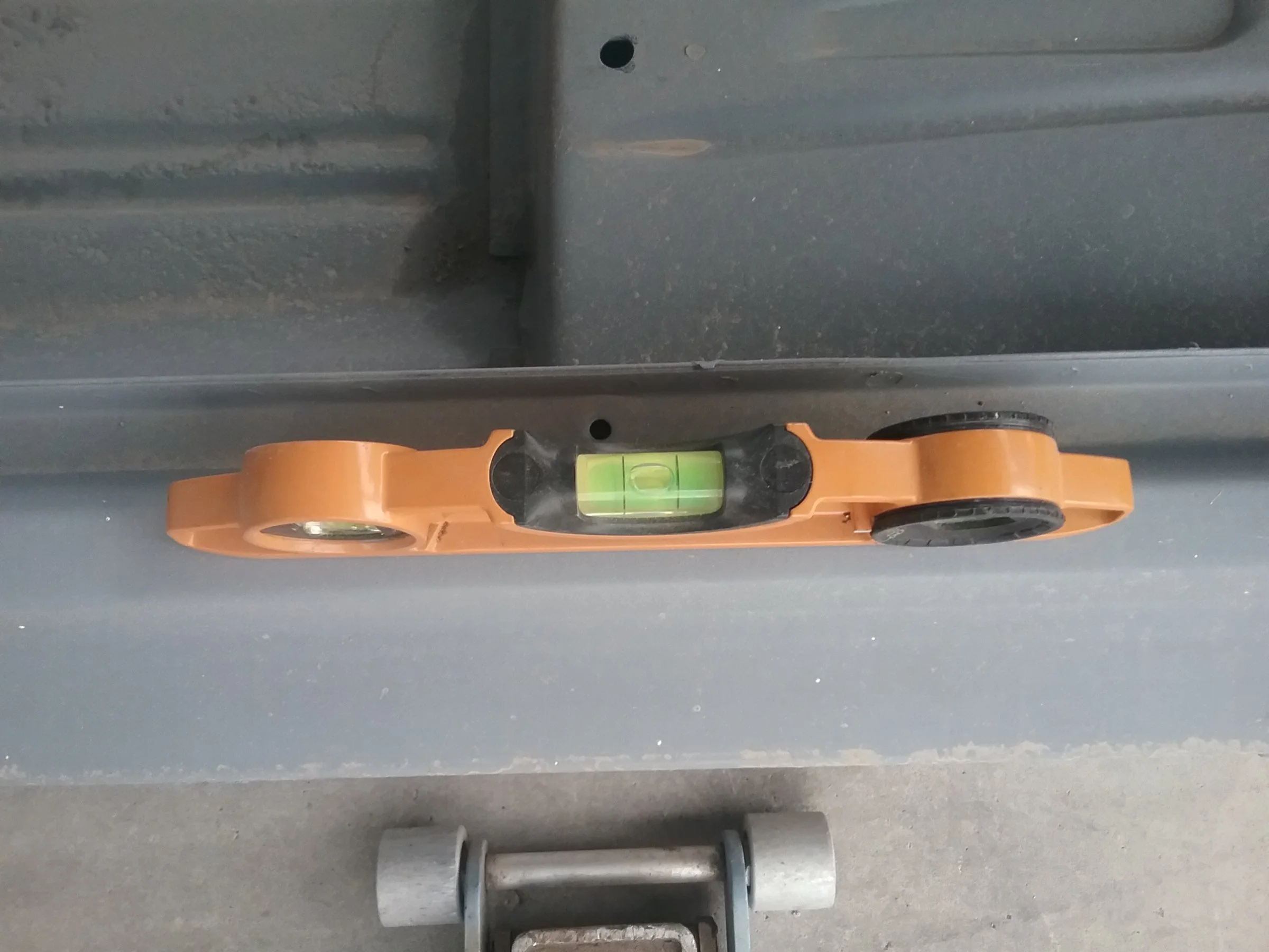

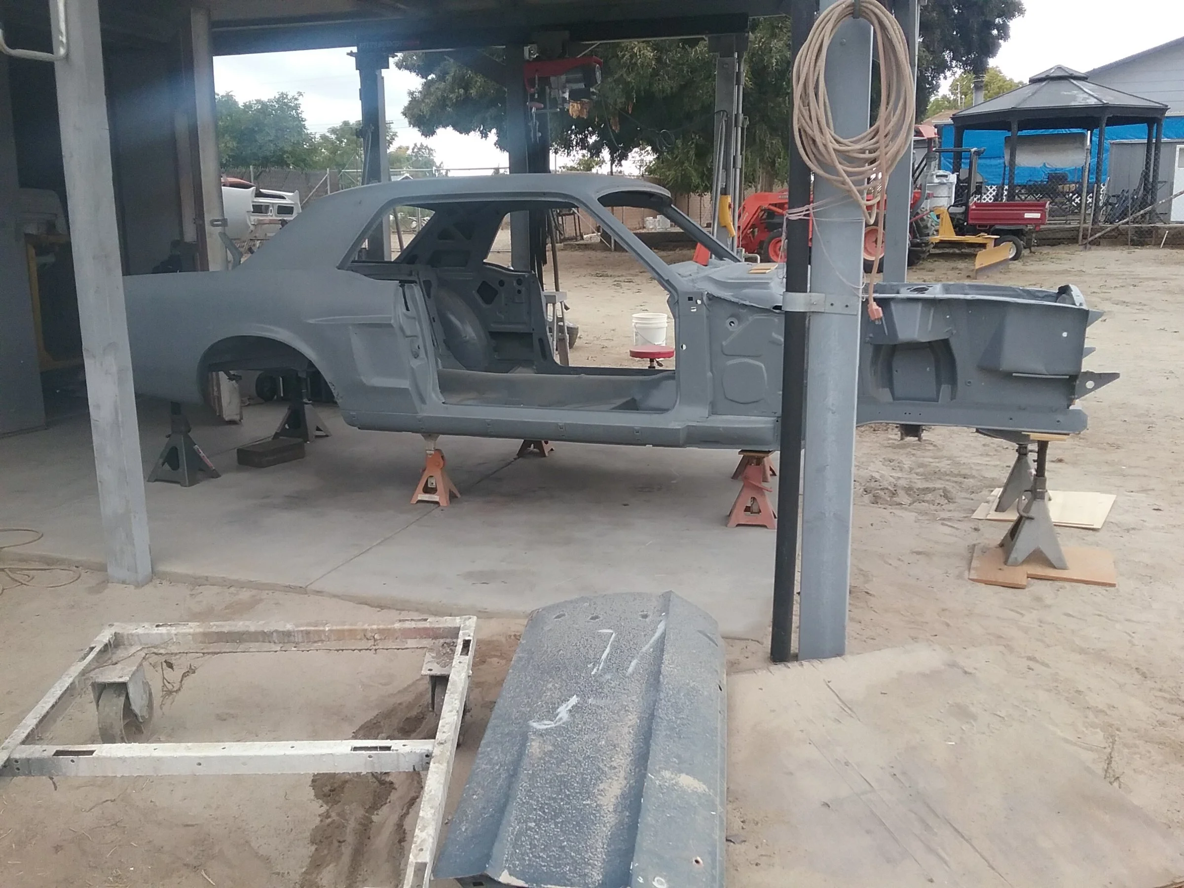

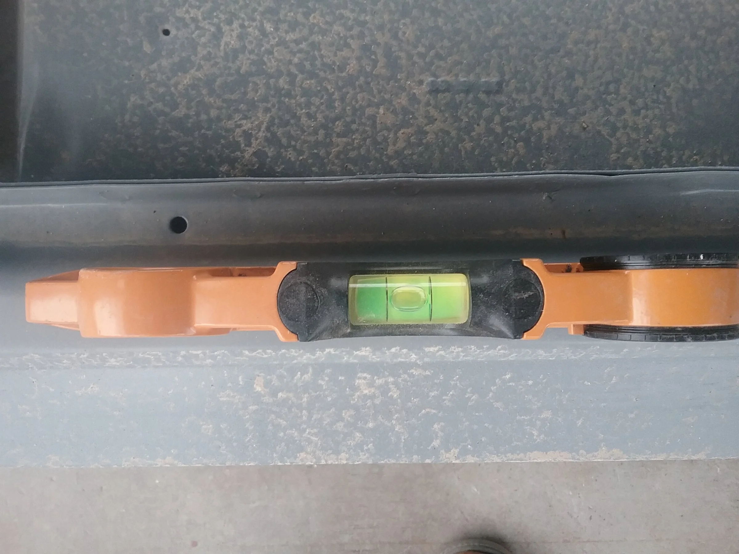

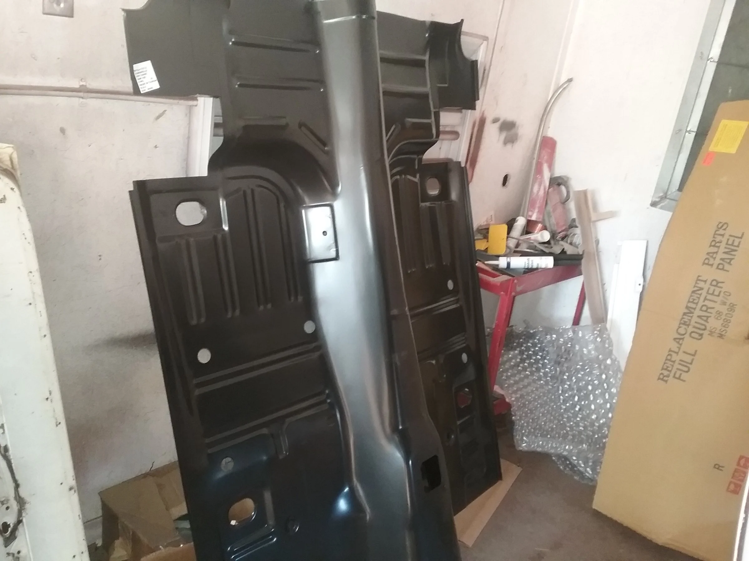

I will have to clean out a spot in my work area then level it up and start to work . It needs a full floor ,both rear quarters ,tail light panel and all the engine compartment sheet metal .I already have all the replacement Dynacorn metal so this weekend i will get it set up and ready to go

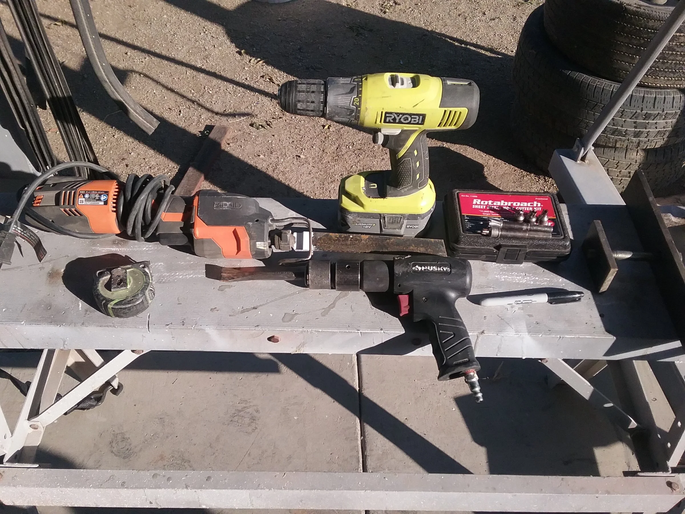

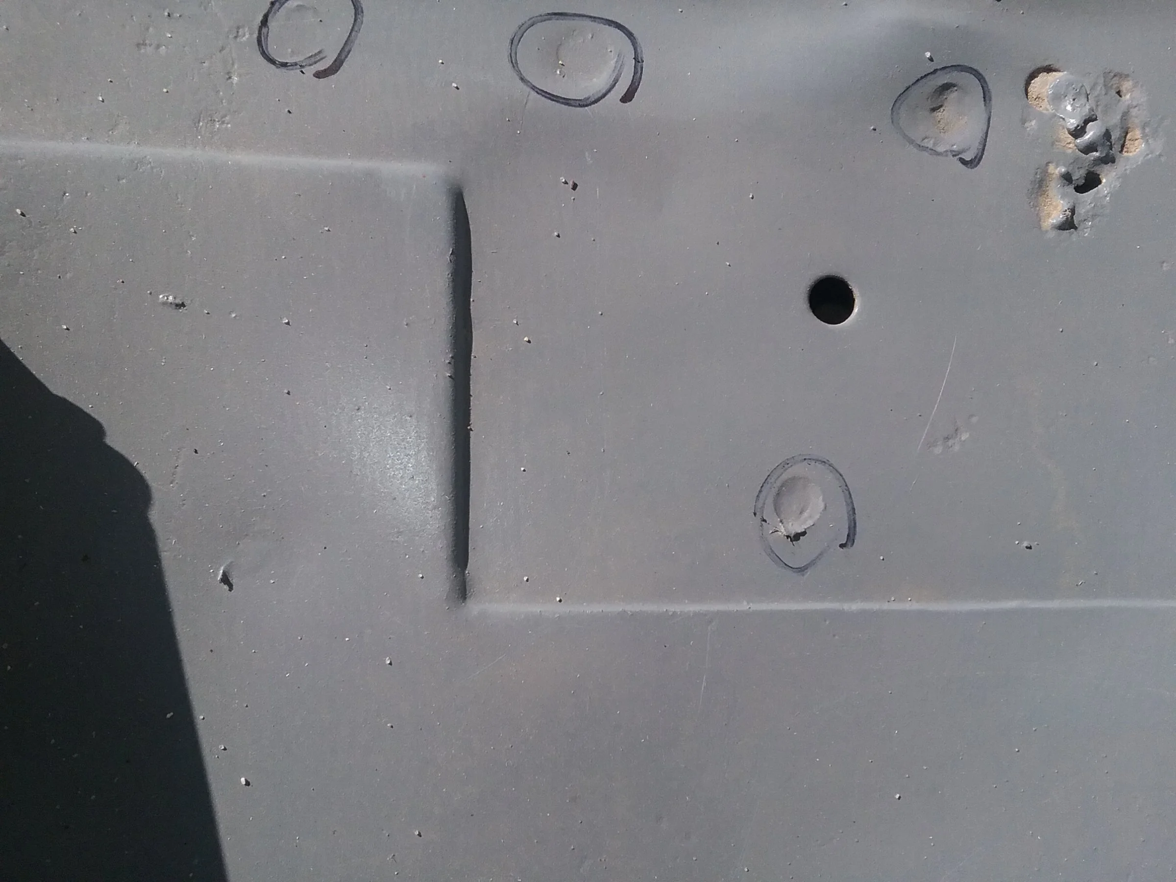

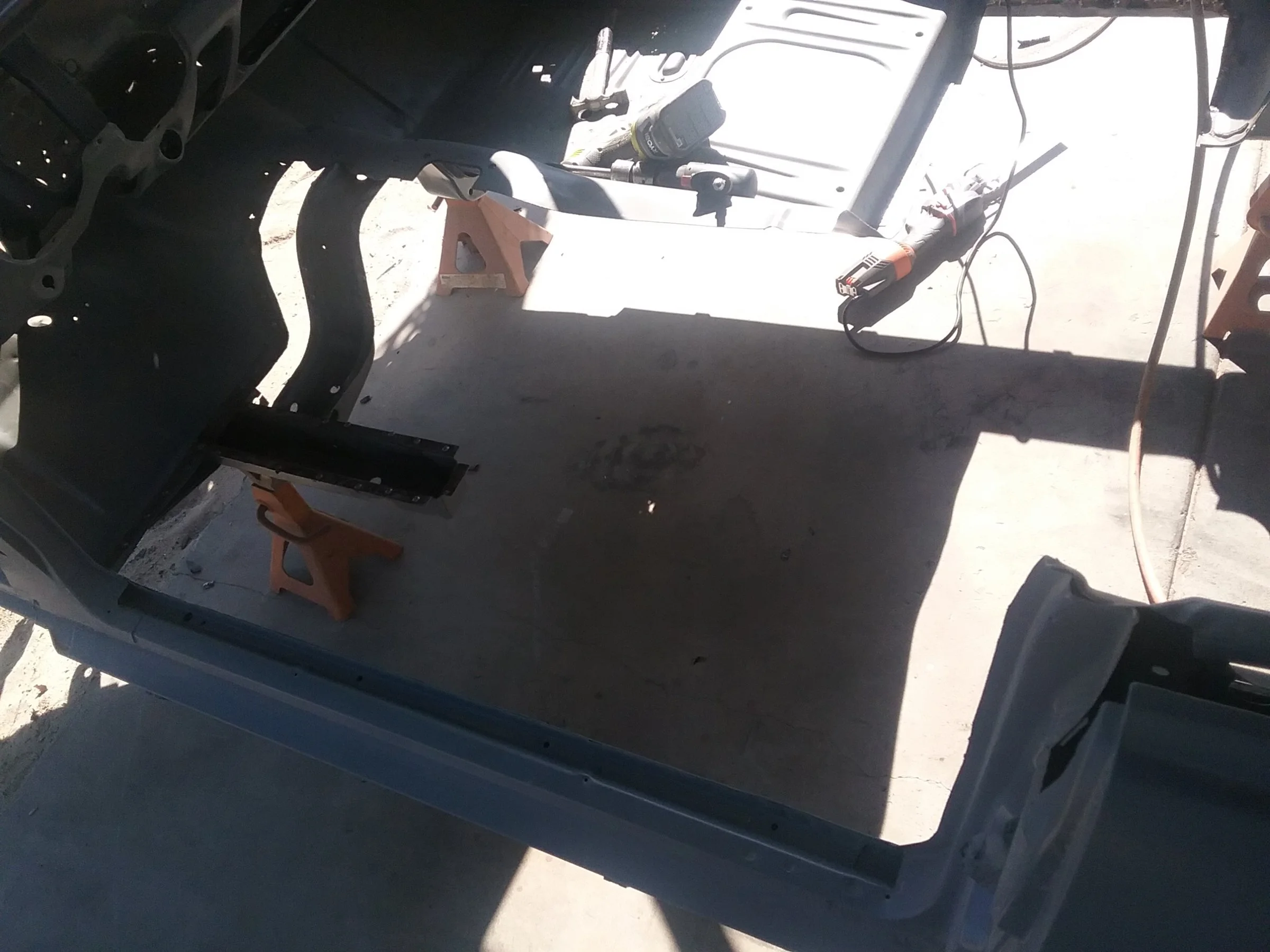

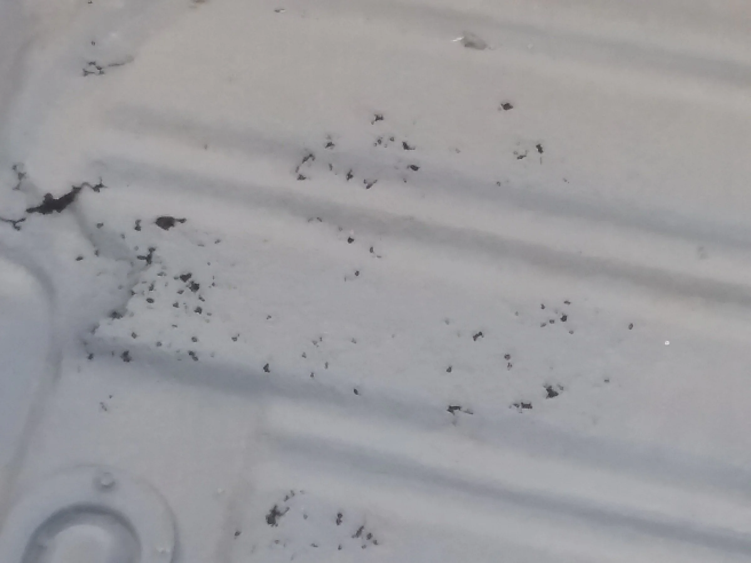

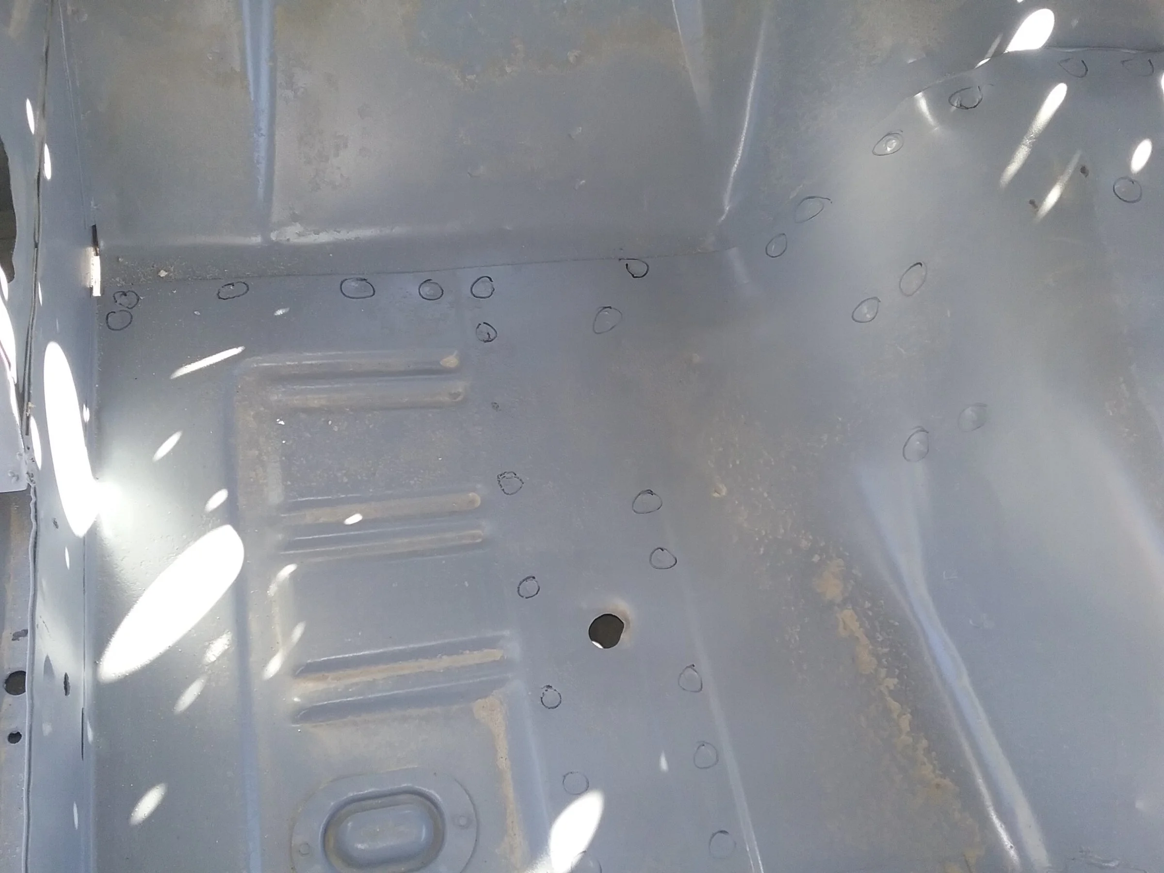

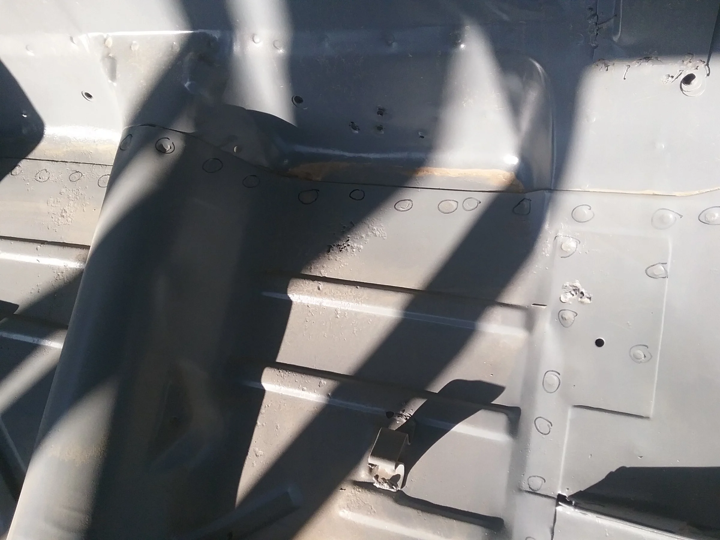

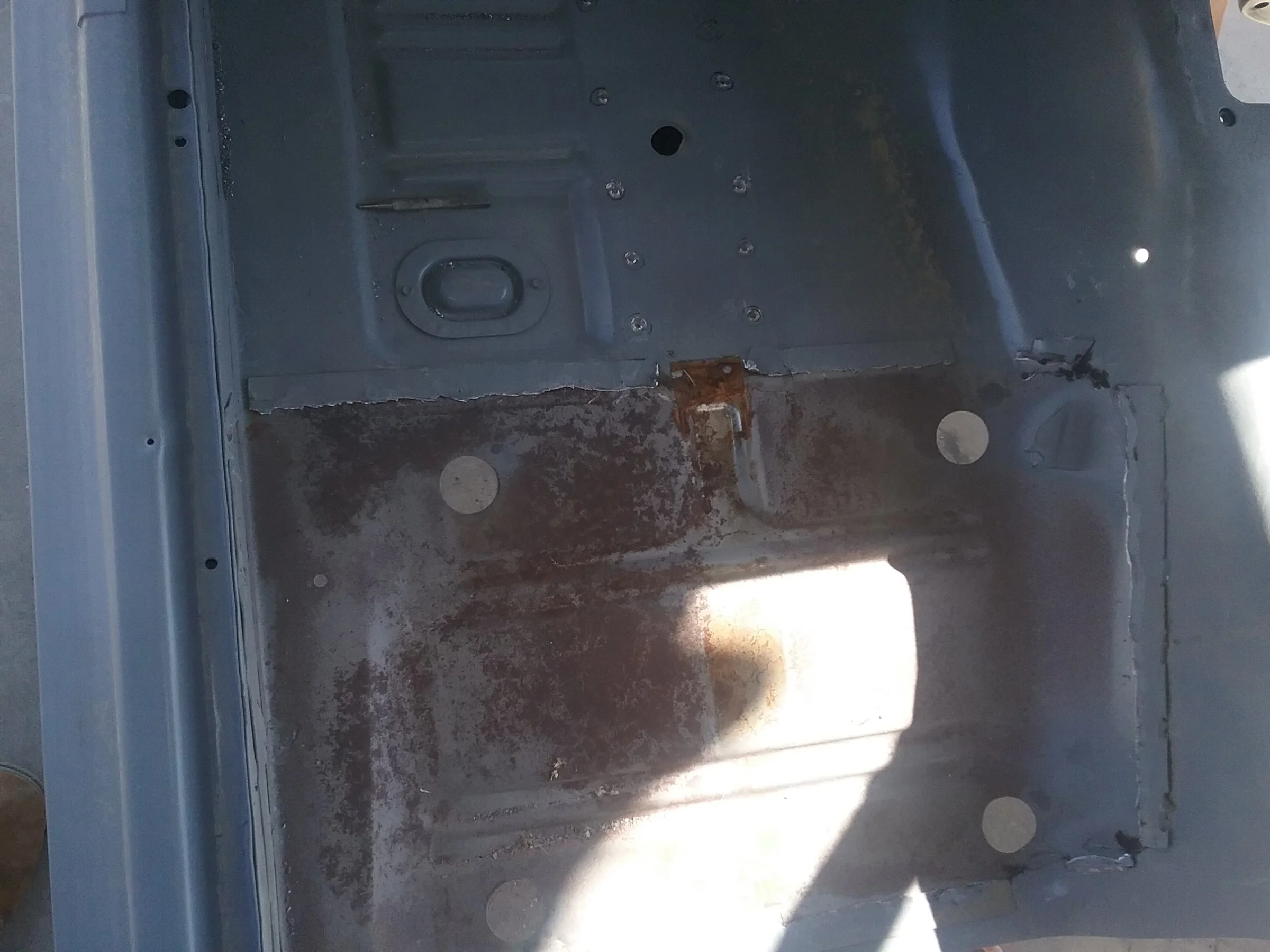

The first thing is to find all the spotwelds and center punch them for the spot weld cutter .it is fairly easy on this one because it has been sand blasted and primed and the spot welds show up easily .this is going to take a while ,there is a lot of spot welds

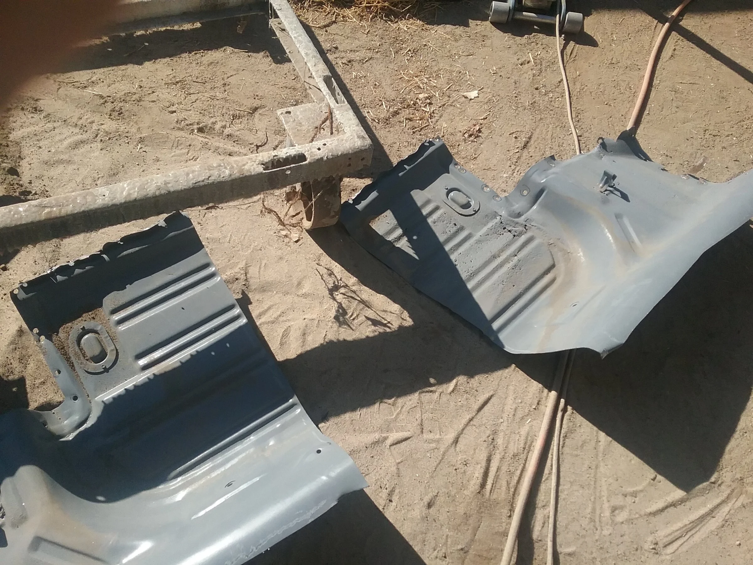

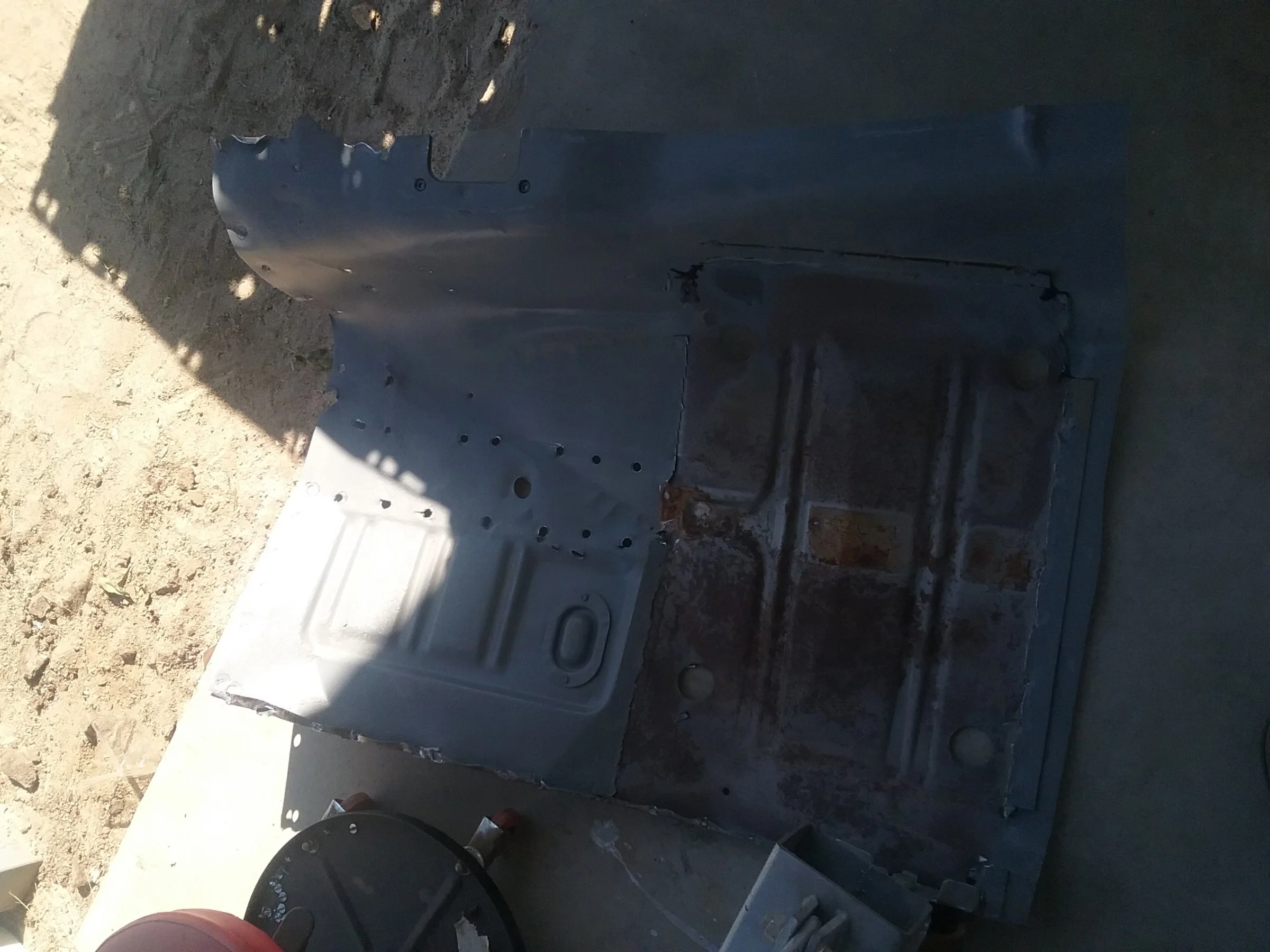

Since it is just about impossible to get the floor out in one piece ,i cut it in quarters and remove it piece at a time ,it saves a few cut fingers ,just remember there is a fuel line and brake lines under there. If you are expecting it to just fall out after you drill the spot welds think again ,this one ,The guys at ford added a few overlaped spot welds and on top of that the tack welded it also .

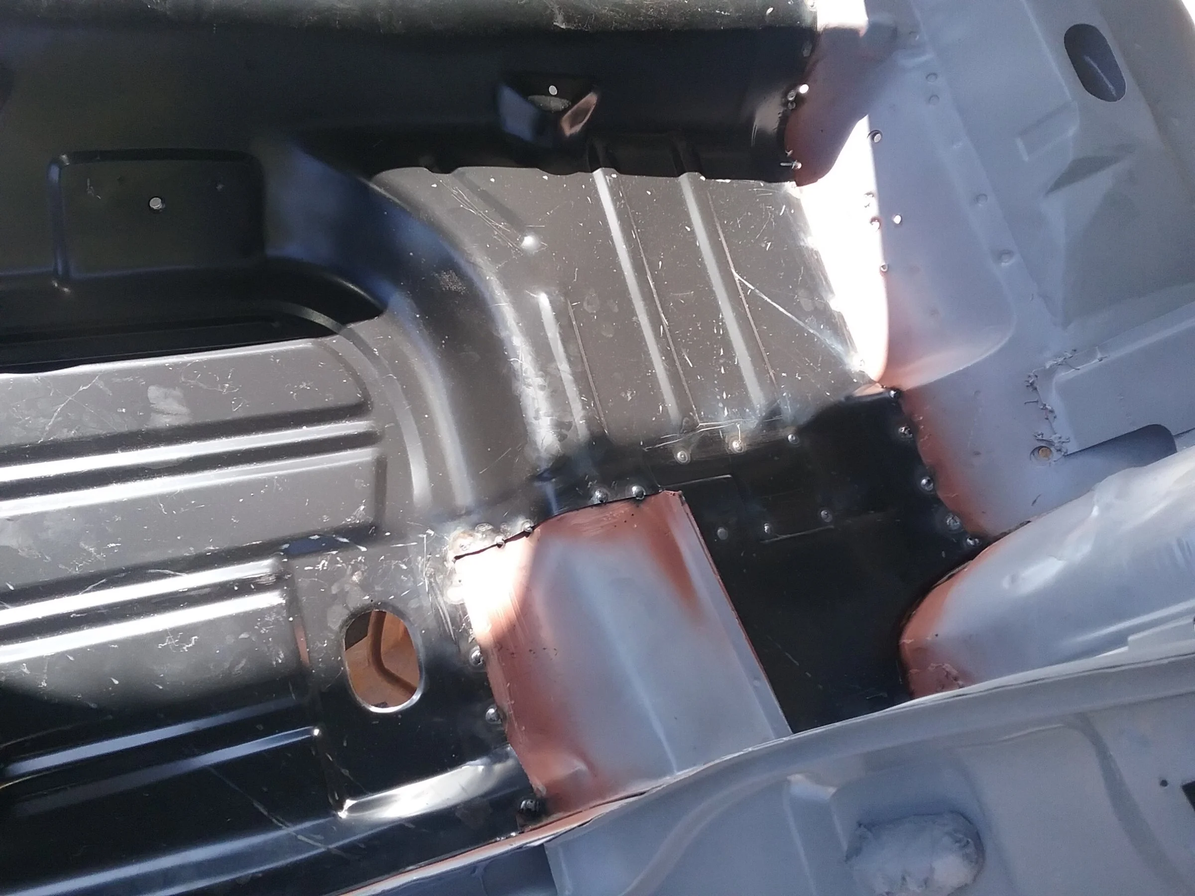

Because i have new seat boxes i just blew these off with an air hammer,they can be saved just by drilling the spot welds.

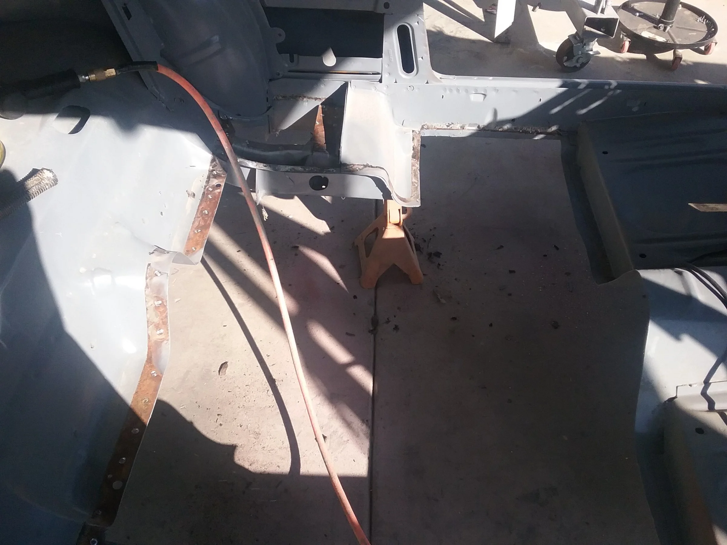

The spot welds are drilled in the driver side ,i am going to split the tunnel down the middle ...be careful not to cut through the tranny brace inside the tunnel.

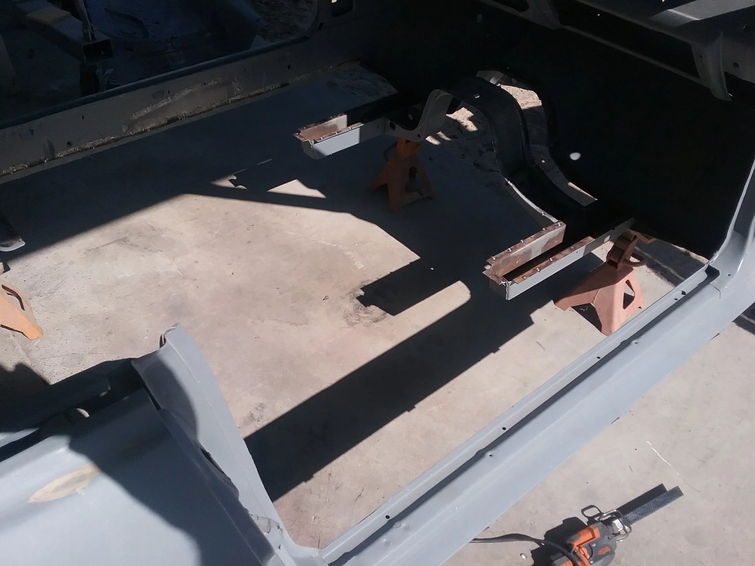

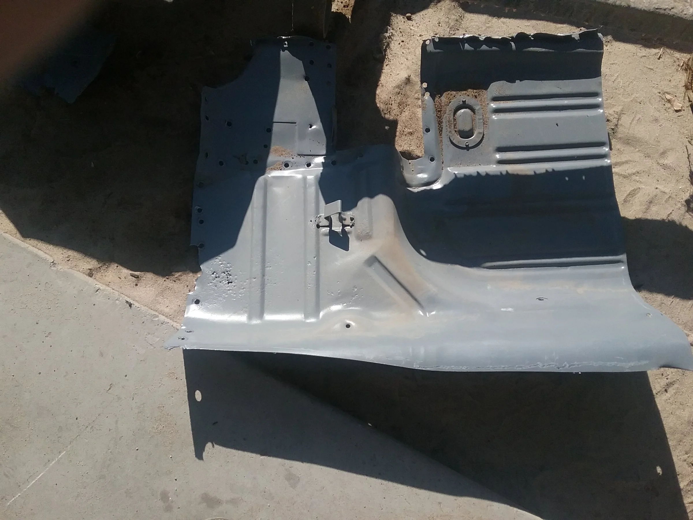

The floor is out ,i would have had it out sooner but my sister brought out some jalapeno corn bread so i had to stop,you have to try this ,it sounds odd but damn is it good .

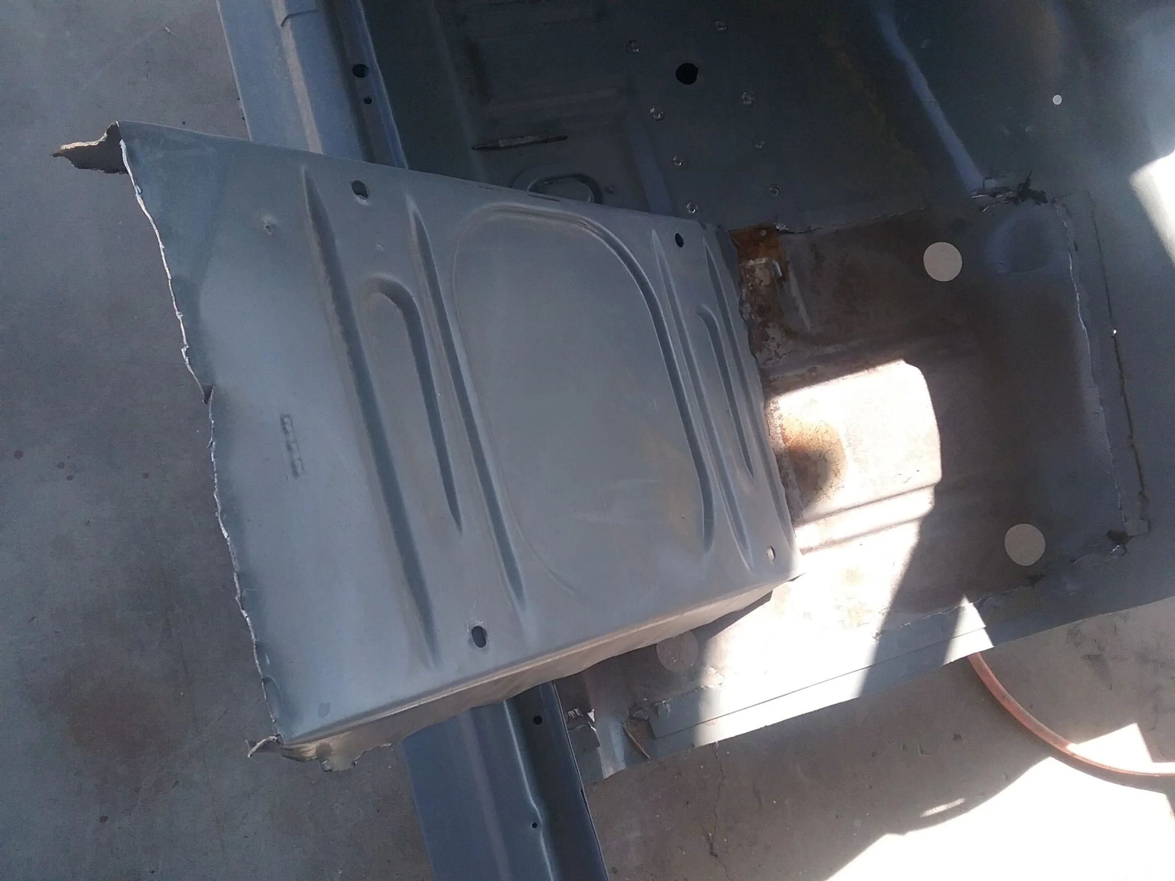

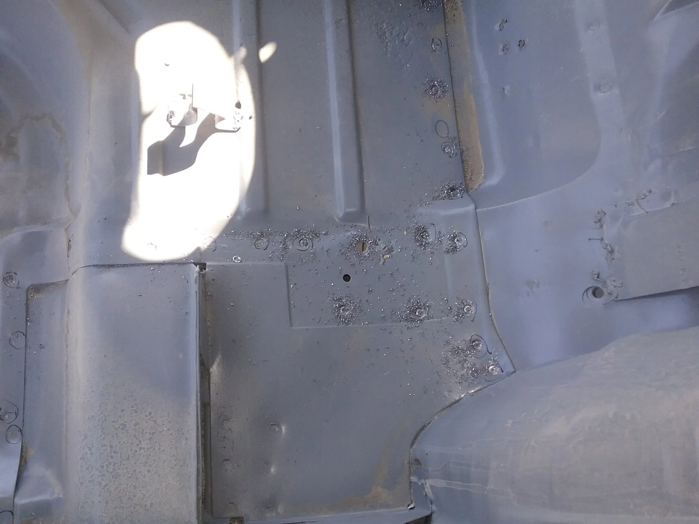

Now i have to lightly grind the spot welds that were left ,sand blast the lip around the edges and primer it before the new floor goes back in.

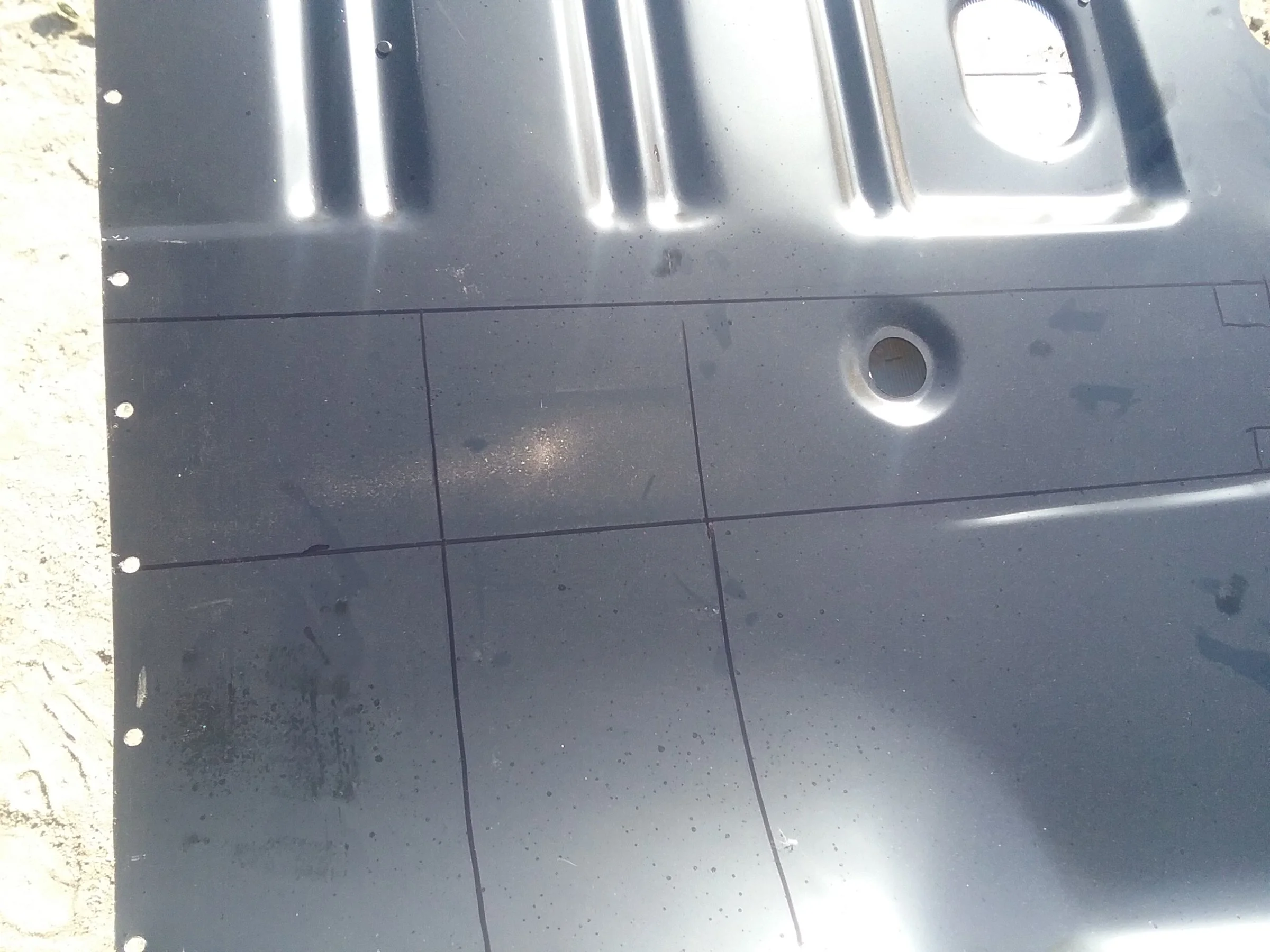

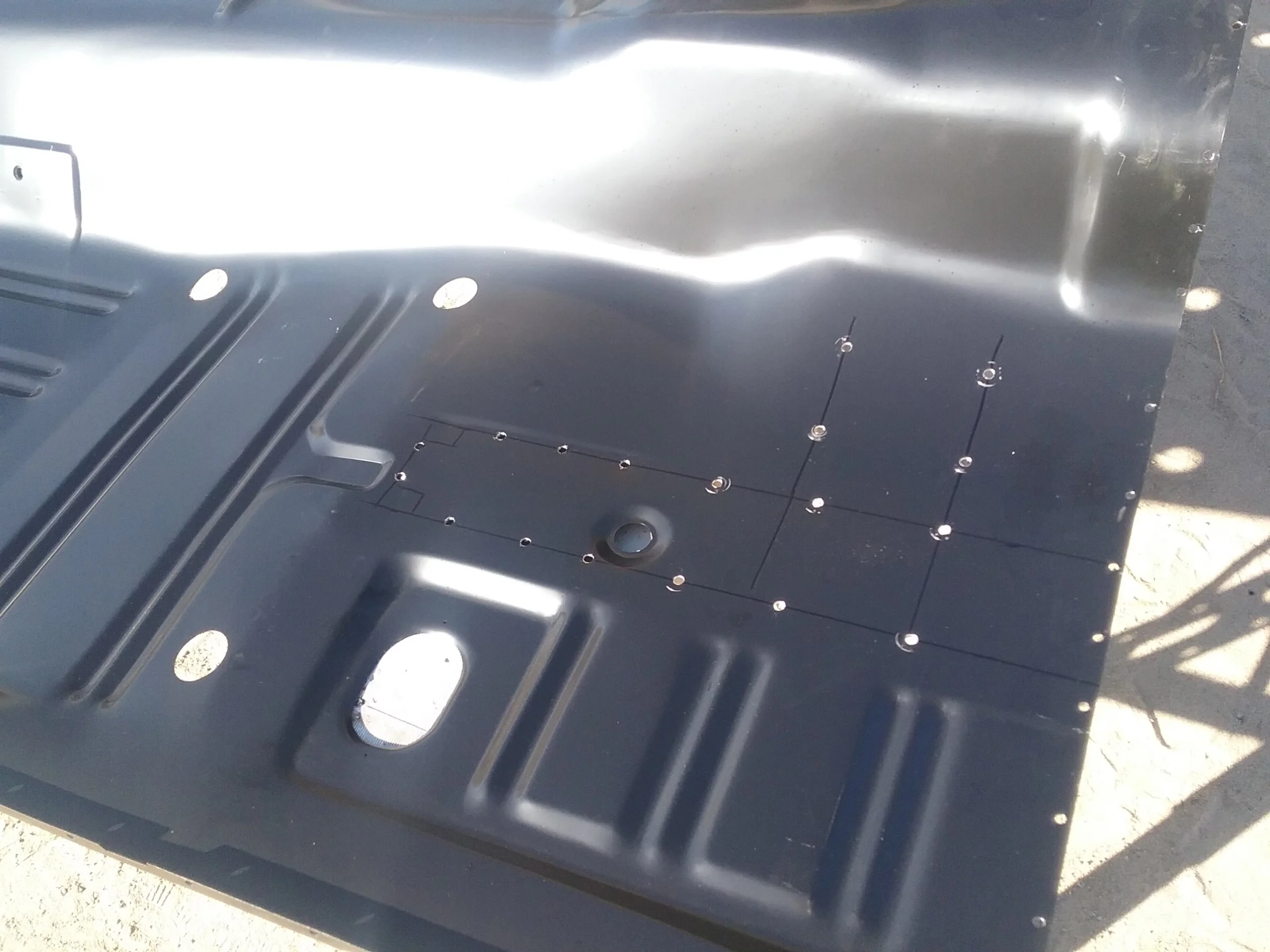

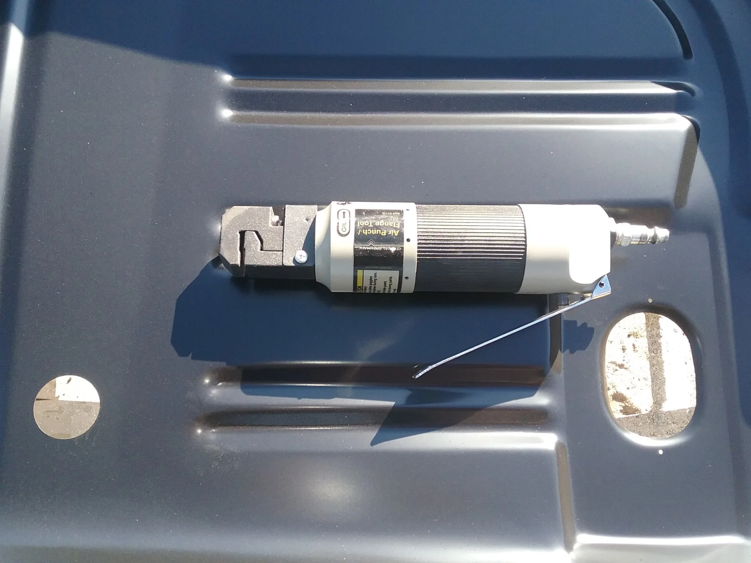

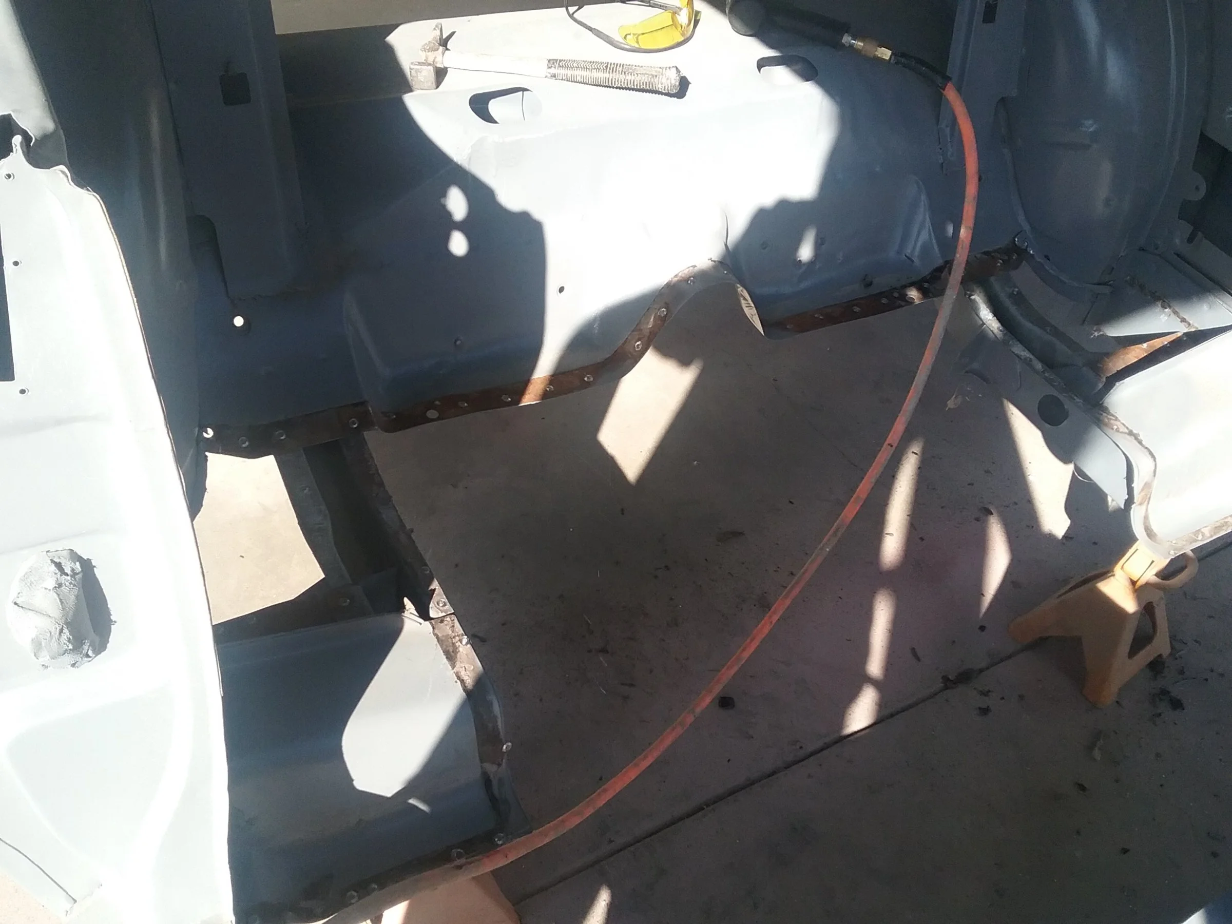

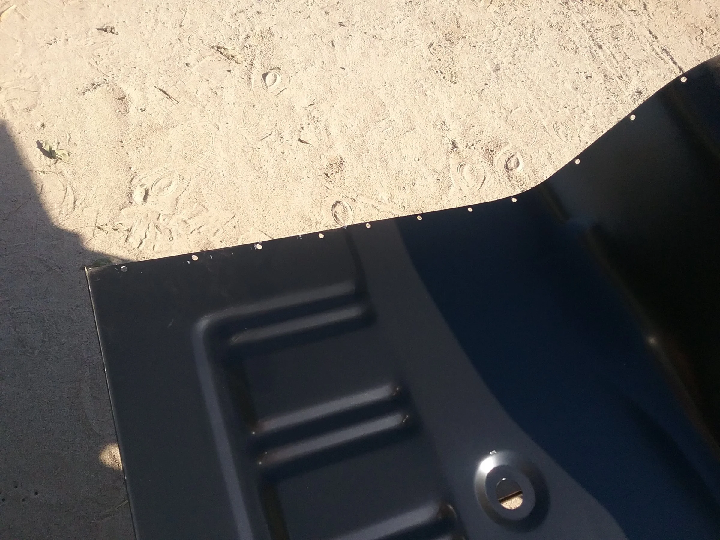

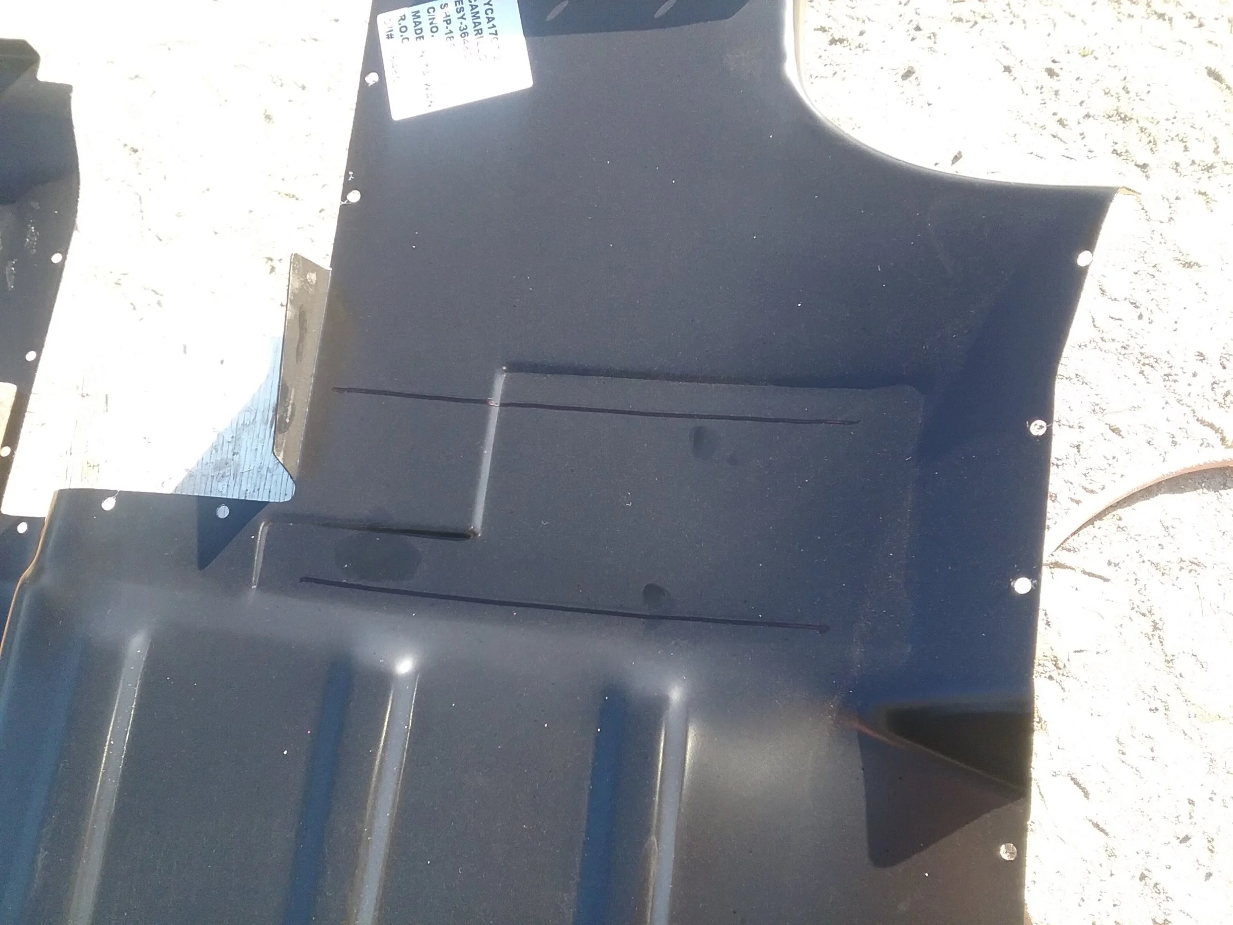

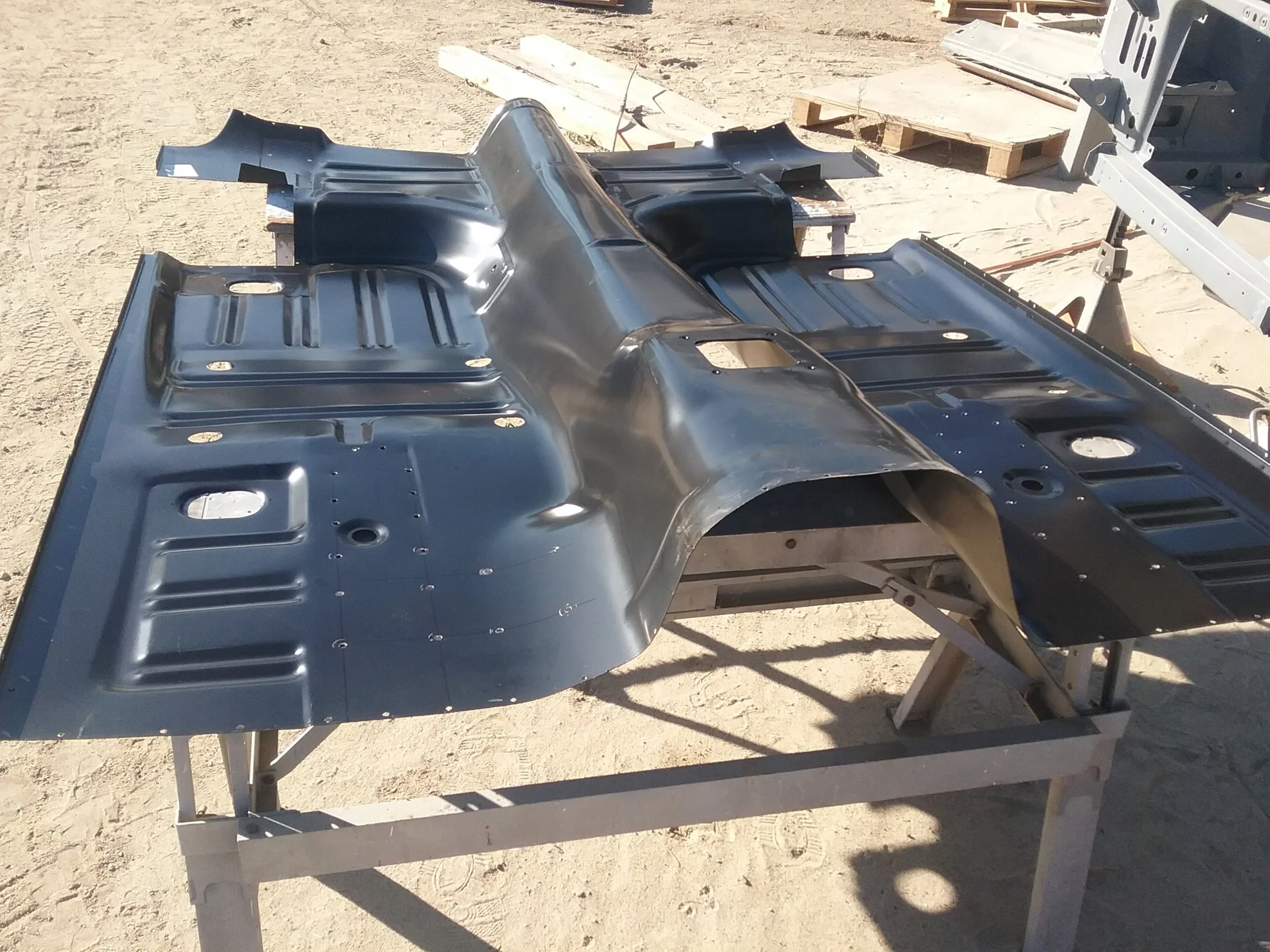

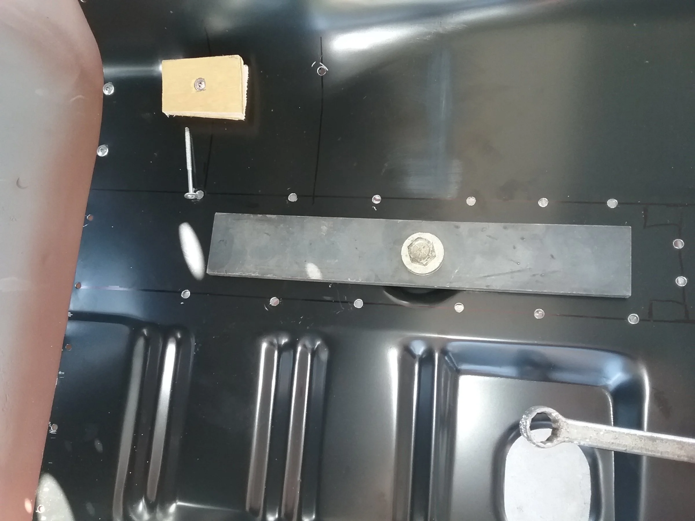

My floor is set on benches waiting prep .I bought a new 3/16 hole punch ,wore out my old one . I punched holes around the edges for plug welds .

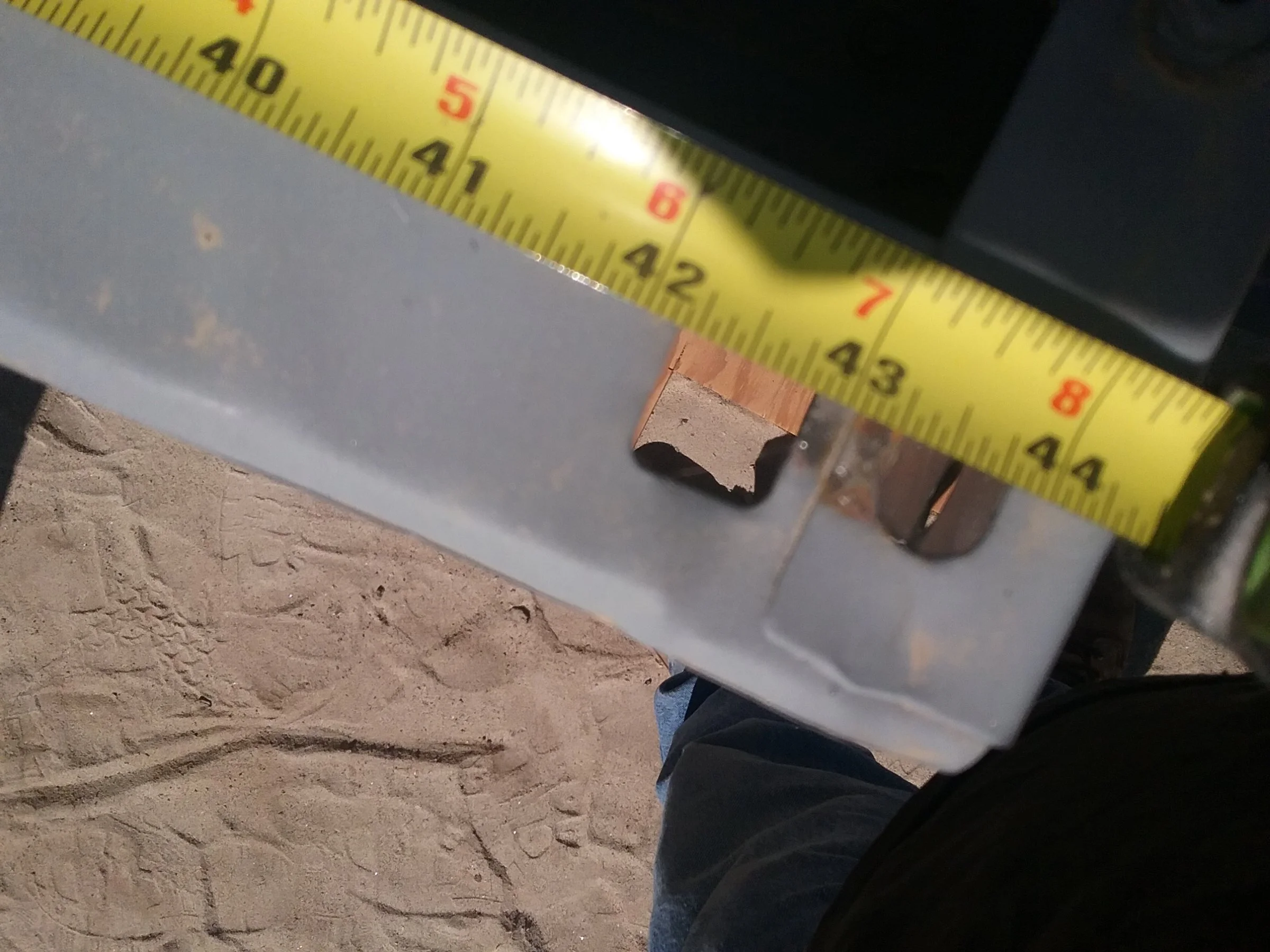

I need holes for the floor support and rear frame rail so i measured from the inside of the rockers and transfered it to the floor and drilled 1/4 inch holes for plug welds

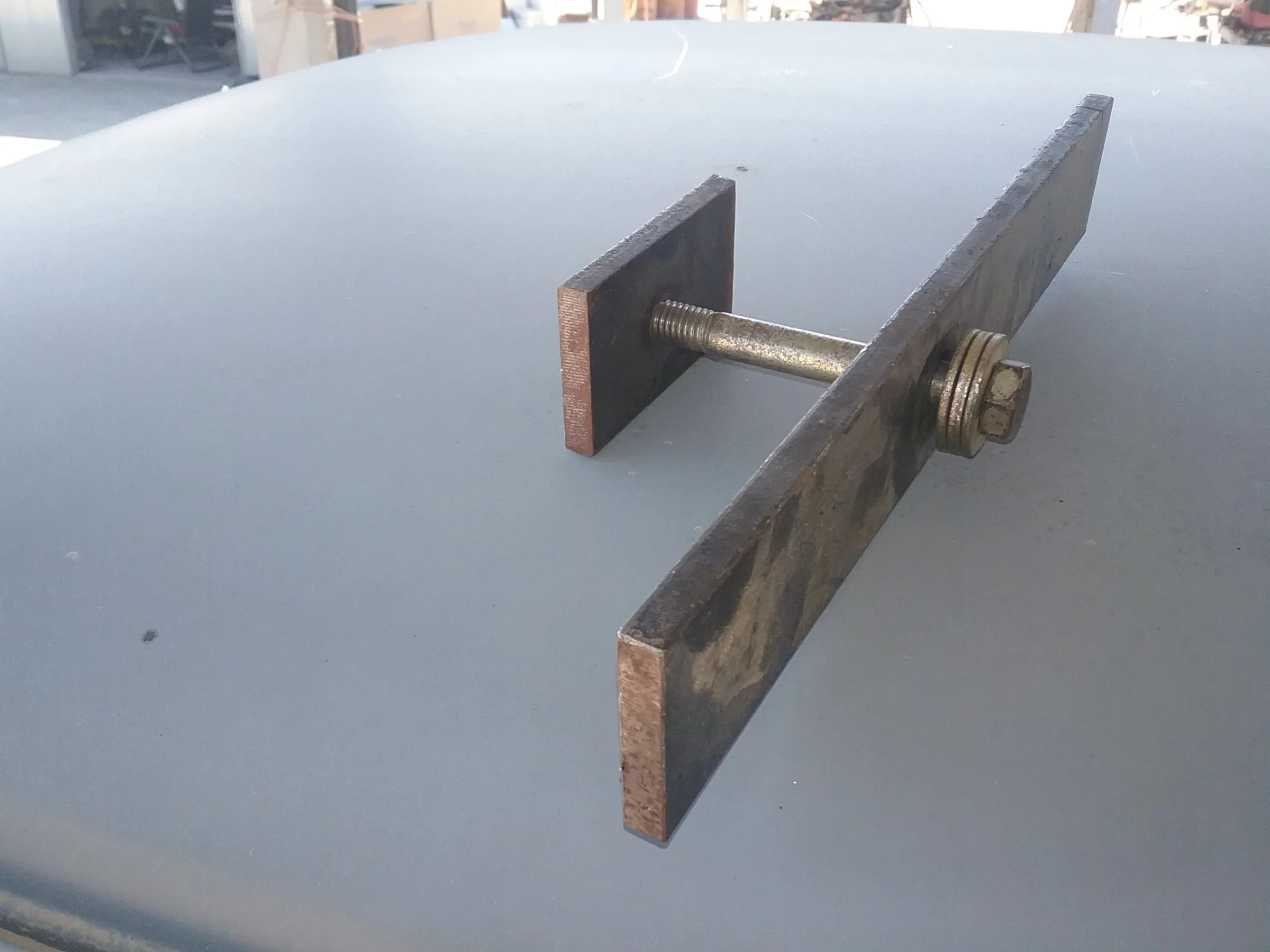

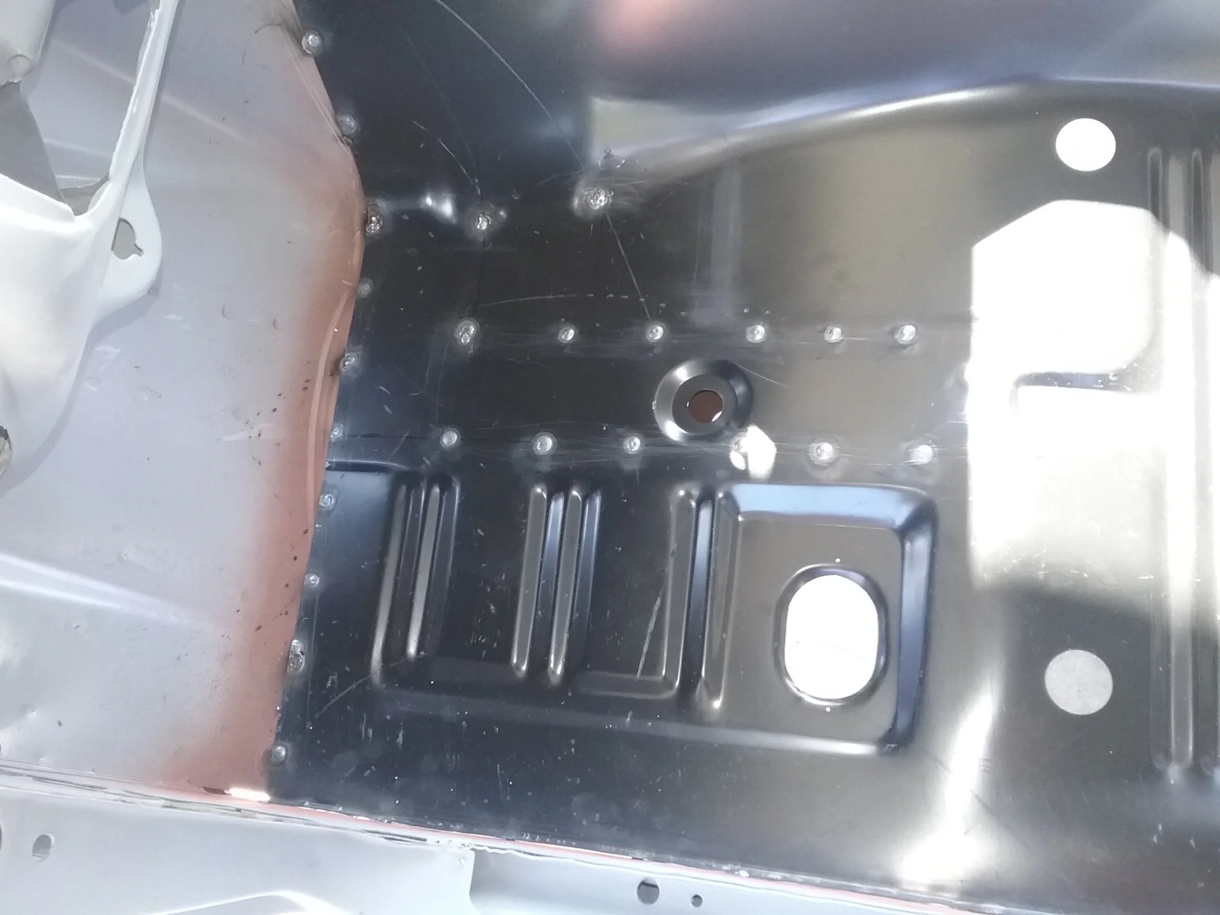

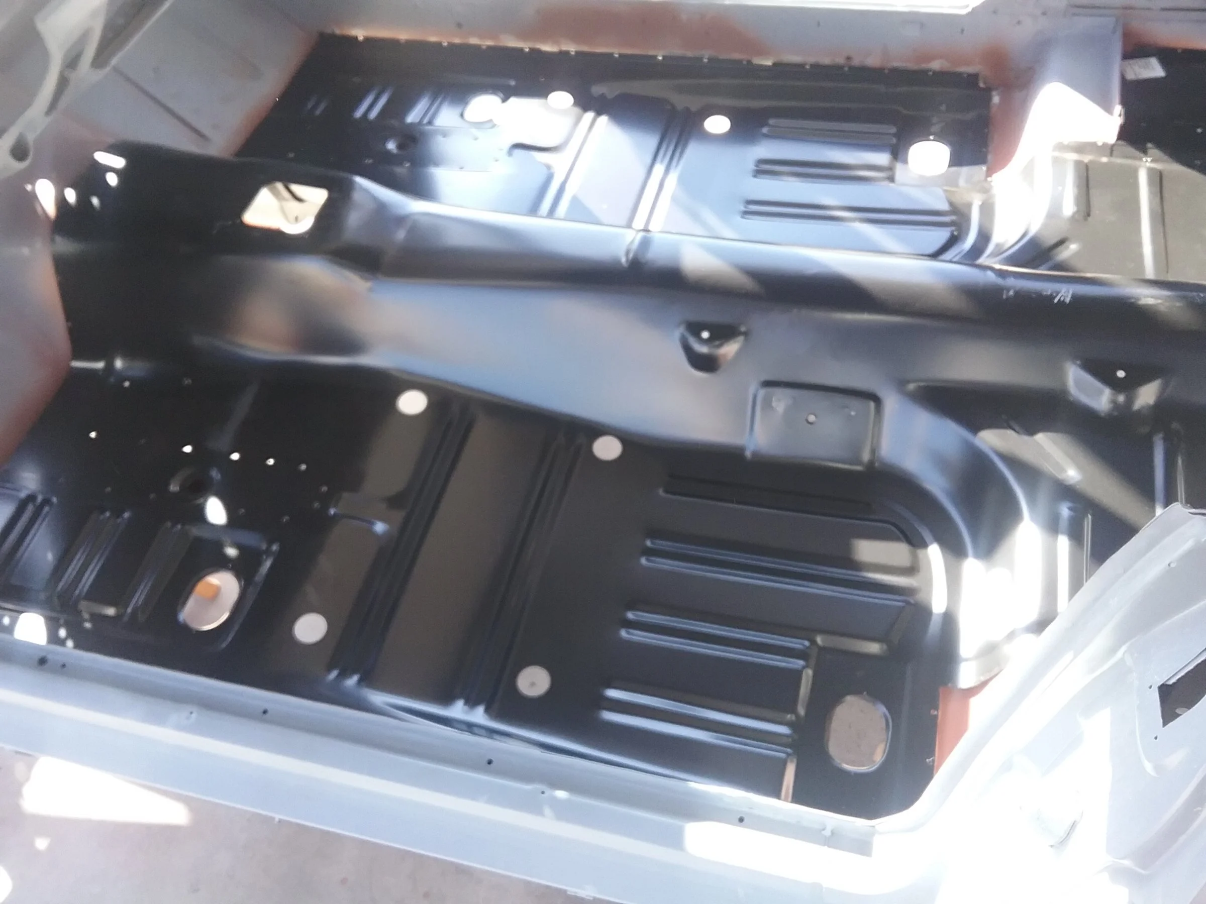

I am starting on the driver side front and moving to the passenger front . My handy dandy home made tool holds the floor tight to the floor supports ,a small block of wood because my screws were to long help hold the floor tight to the trany tunnel brace . I used a few sheet metal screws to hold the floor in place for now ,they will come out as i weld the floor in.
Now it is ready to weld .

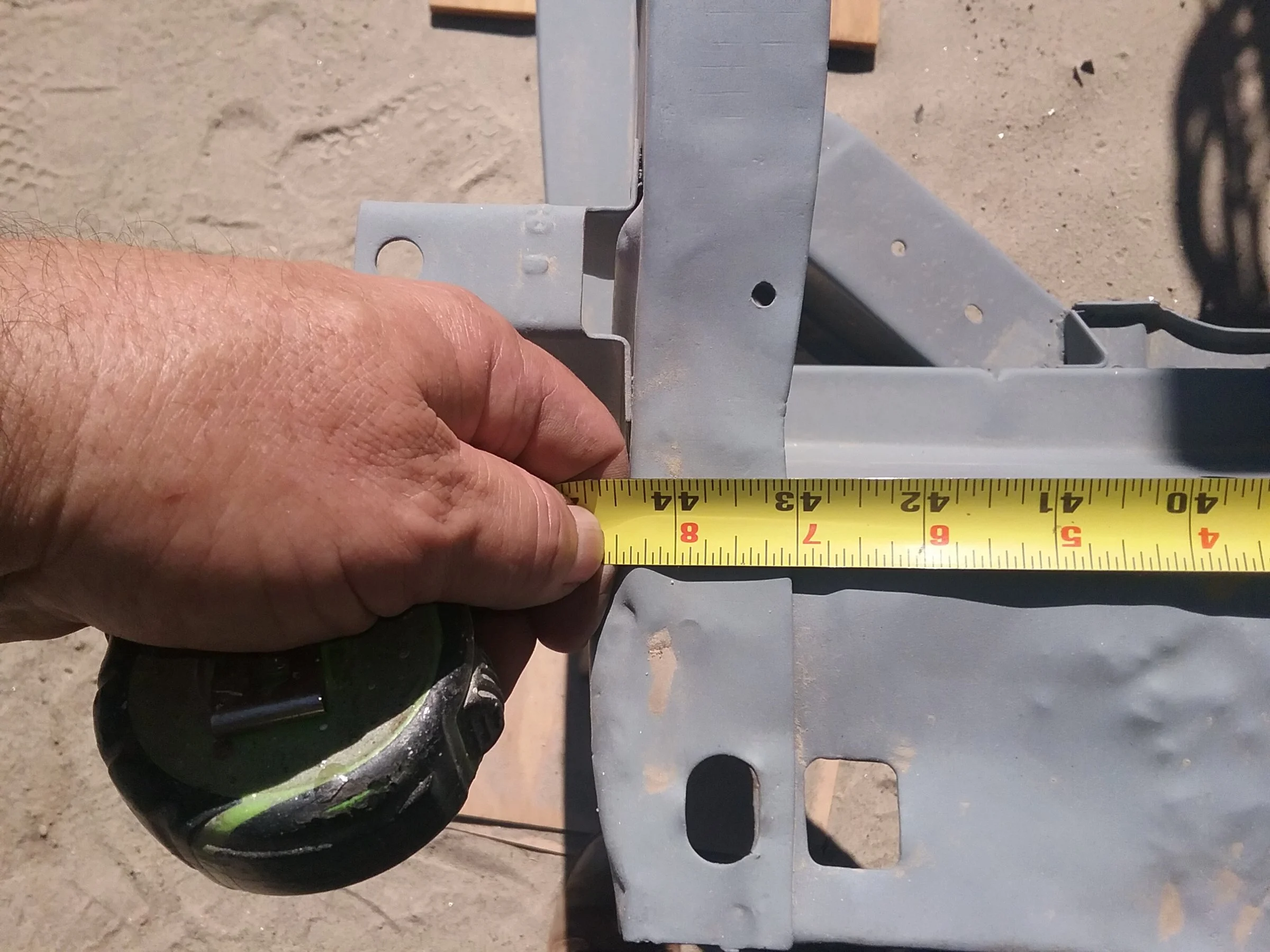

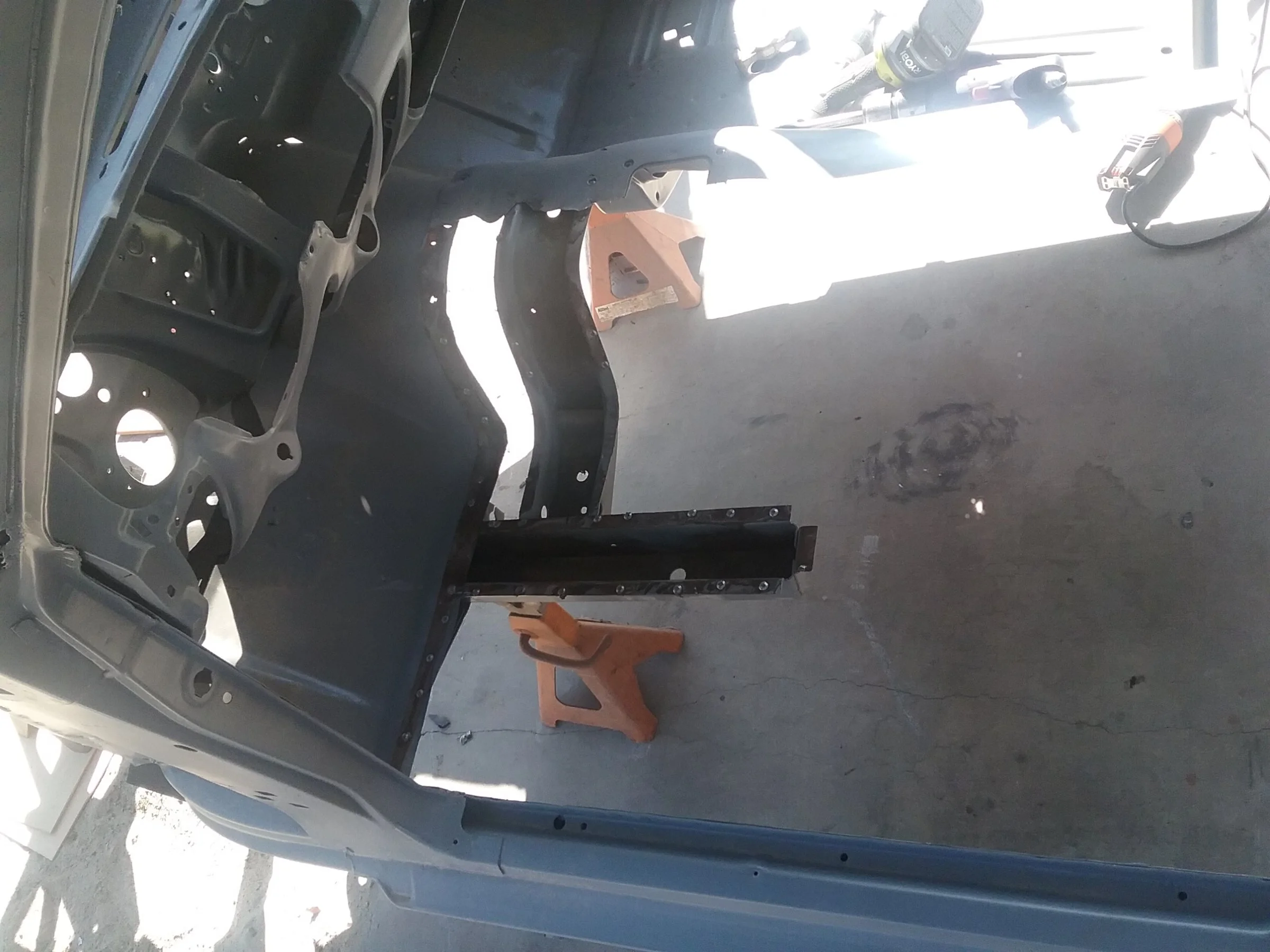

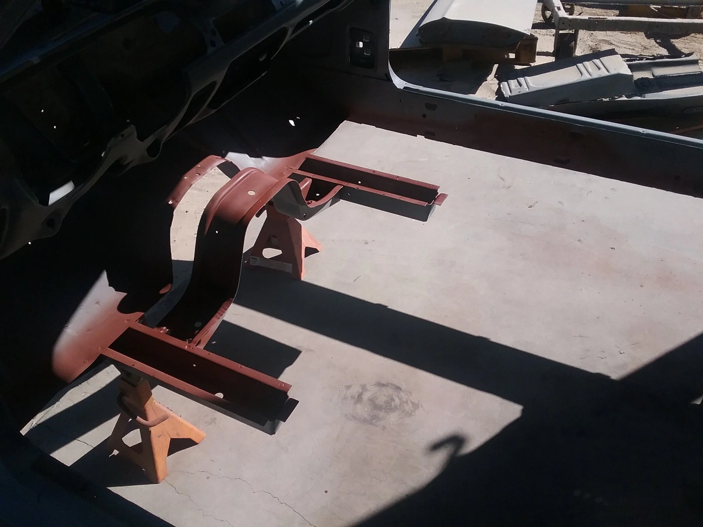

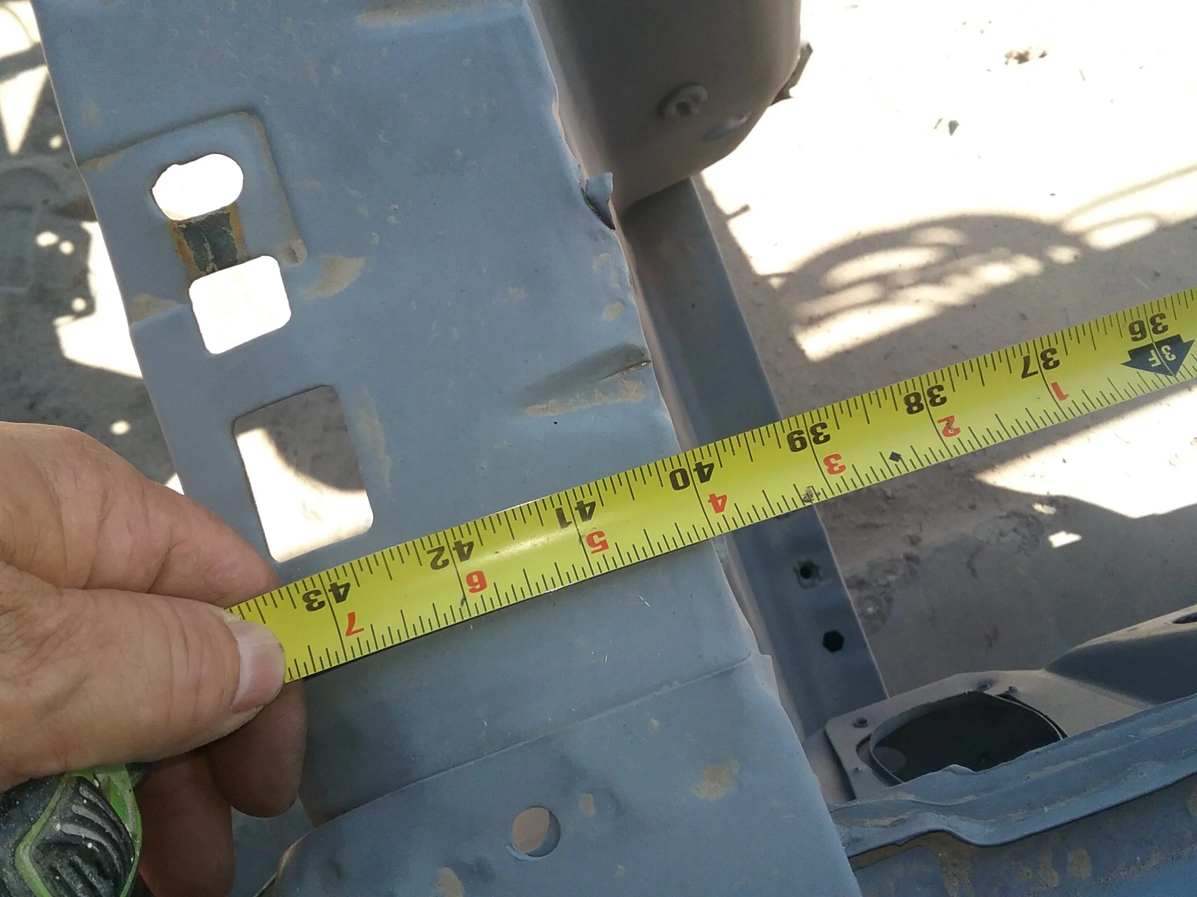

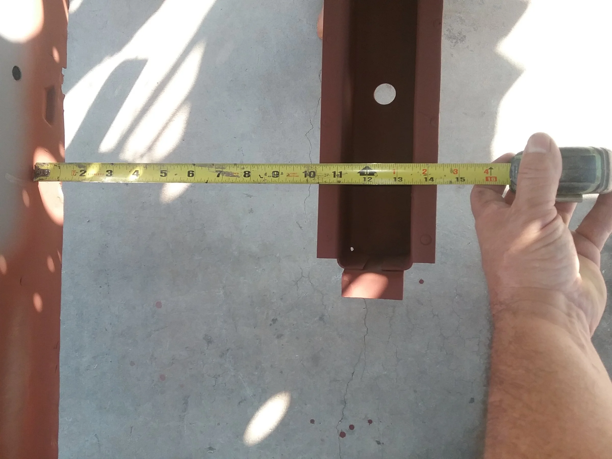

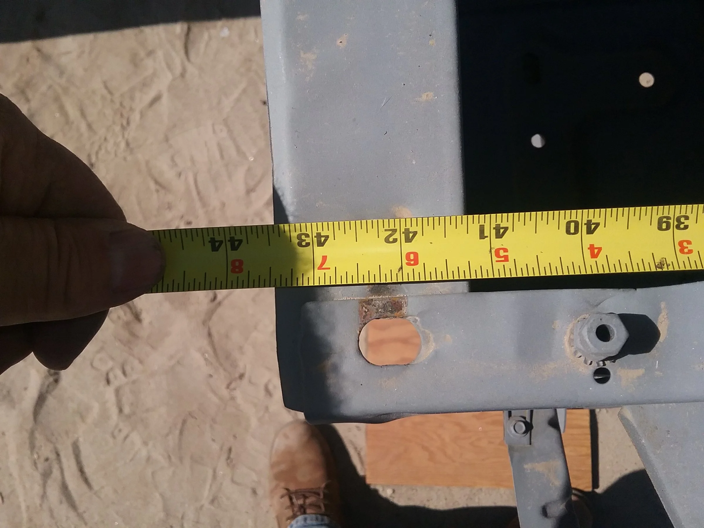

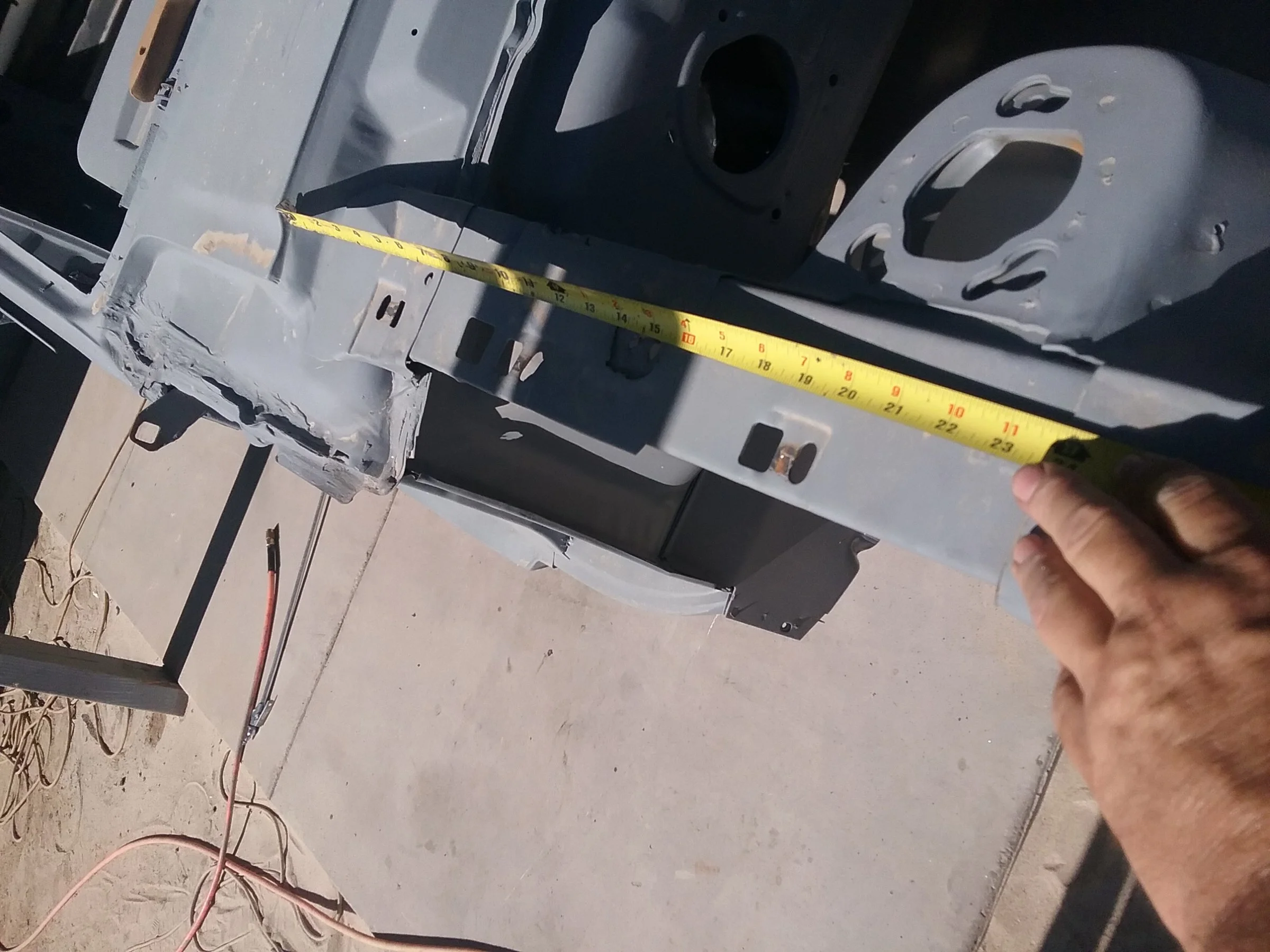

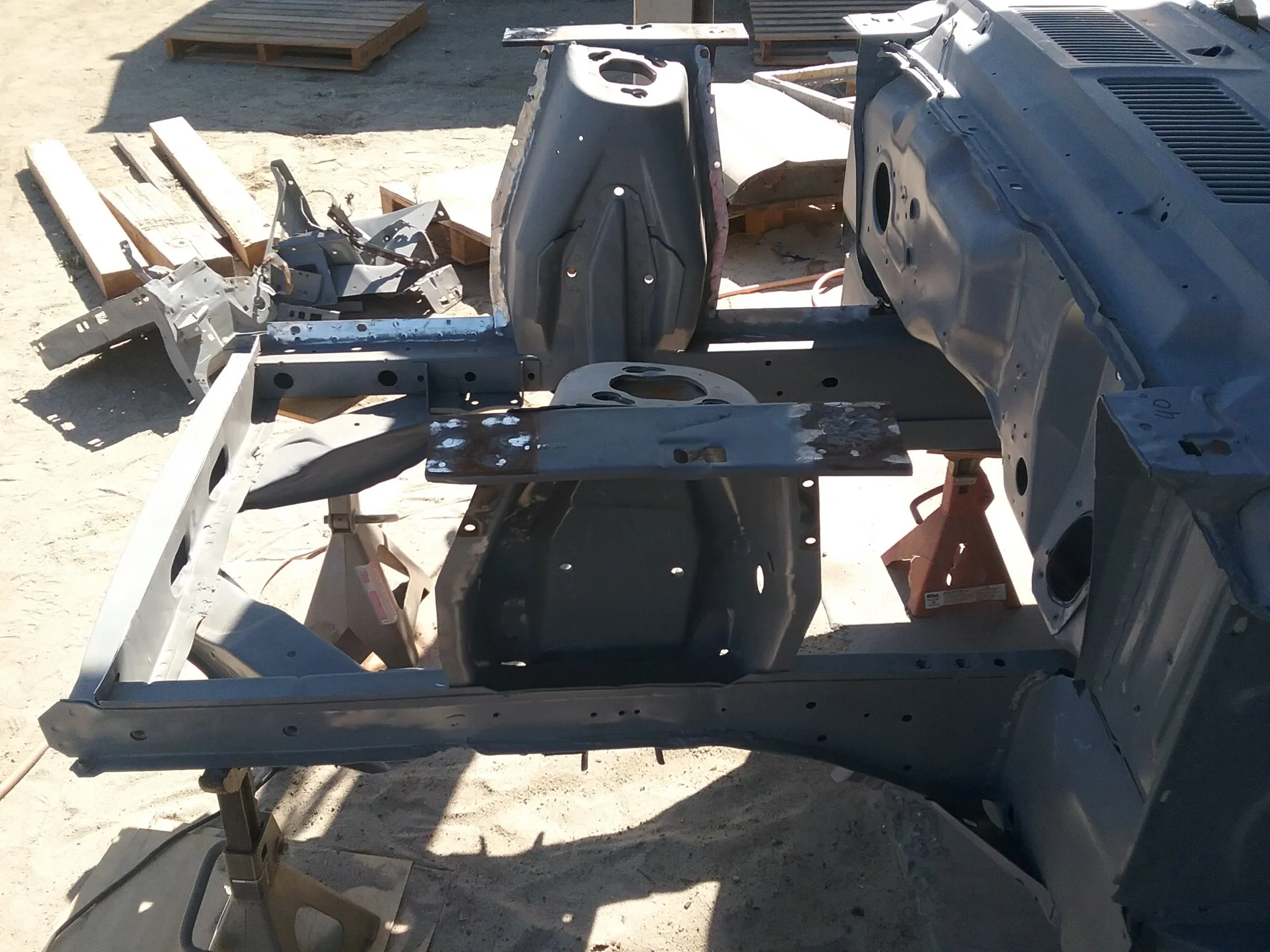

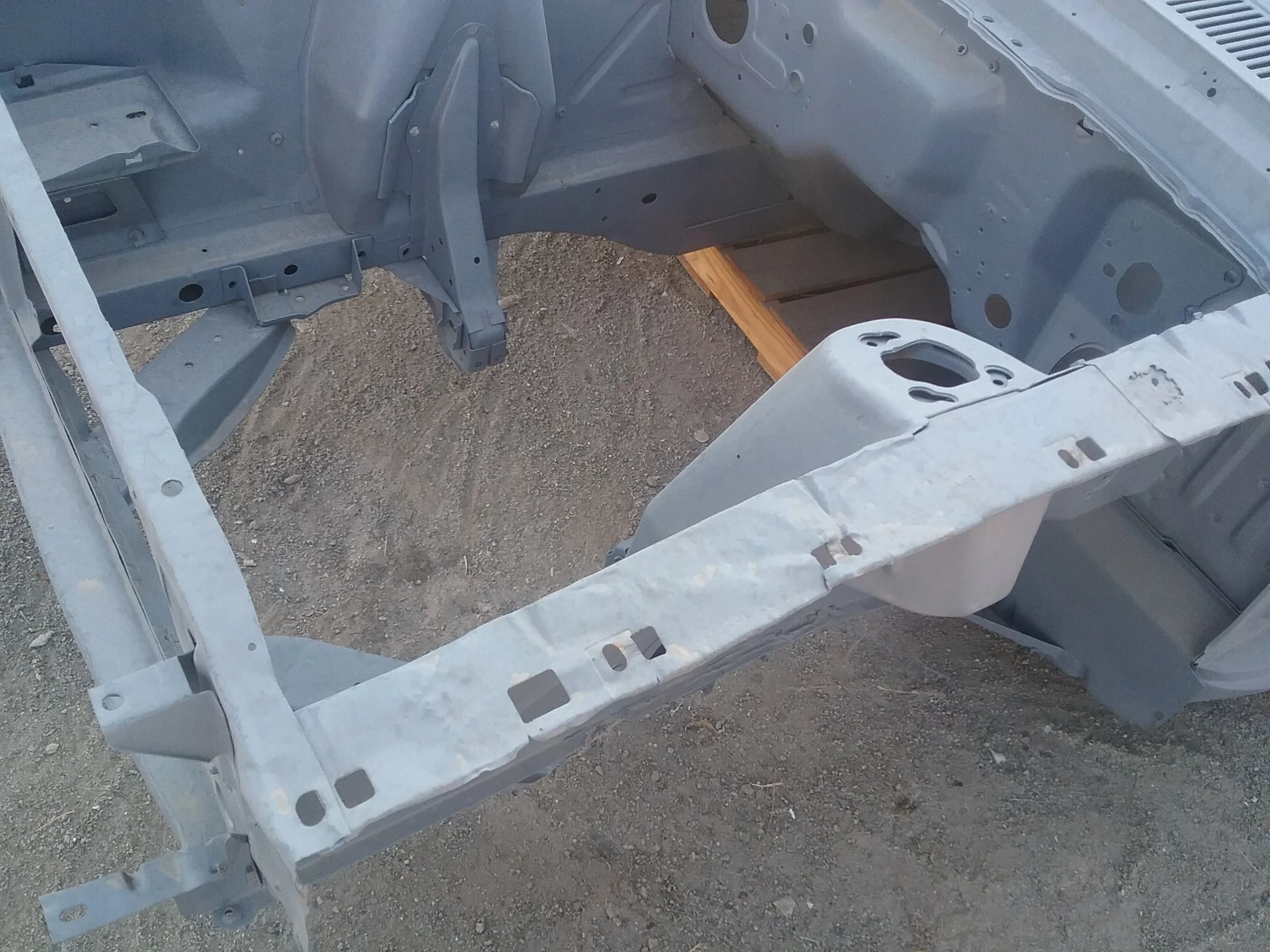

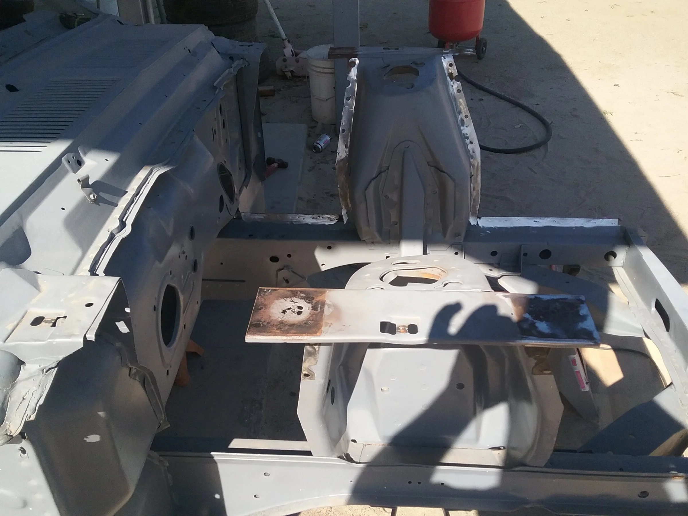

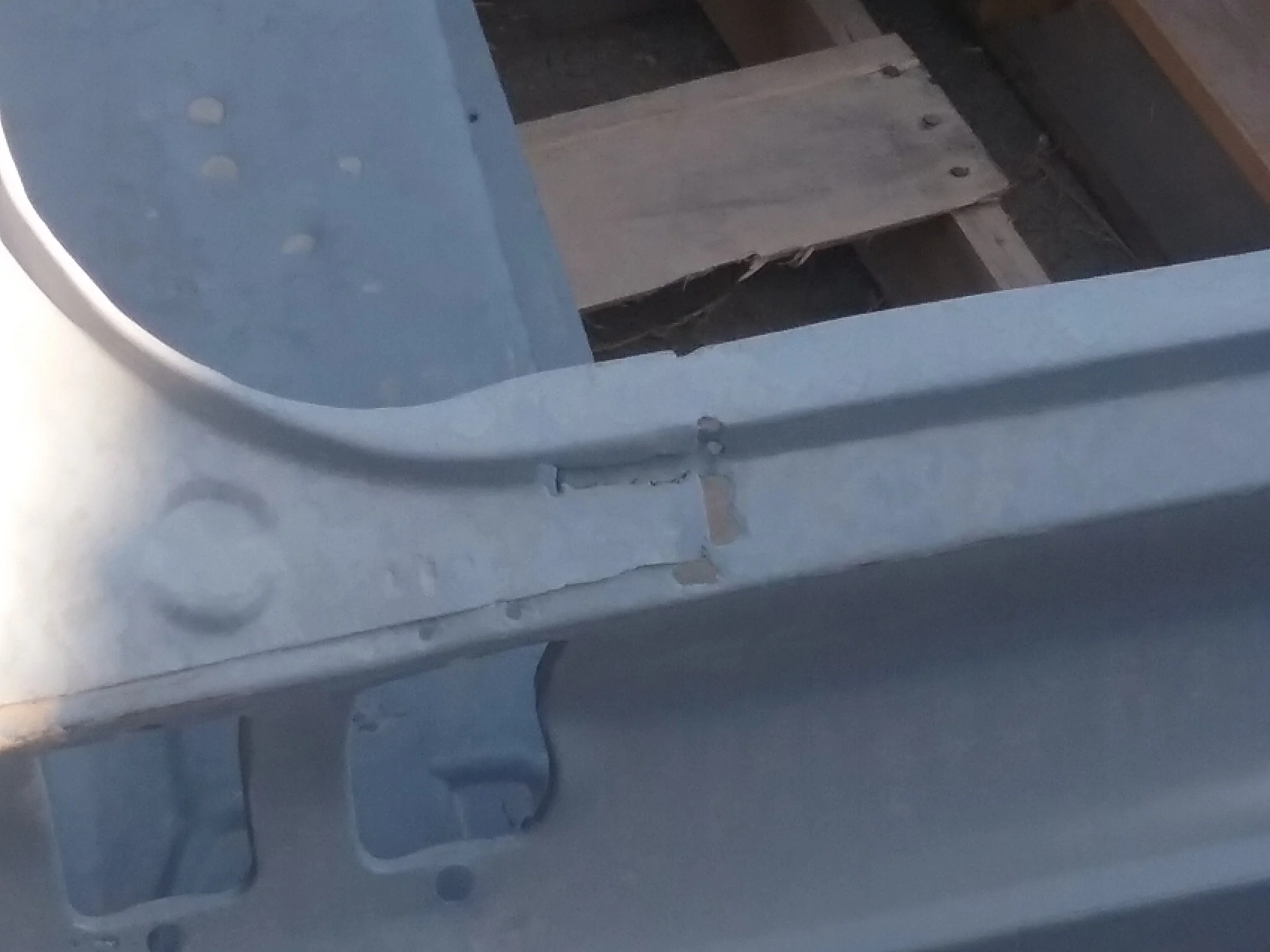

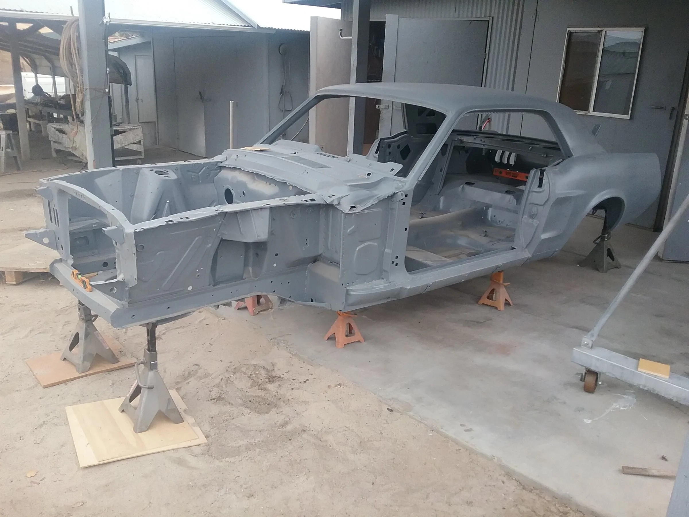

It was still to hot for welding so i cut off the inner aprons ...ALWAYS TAKE MEASUREMENTS BEFORE YOU REMOVE ANY SHEET METAL! That was the first thing i did .
I trimmed away all 4 aprons but i still need to remove the front crossmember and trim the left overs at the firewall. I also have a couple patches at the top of the towers.
