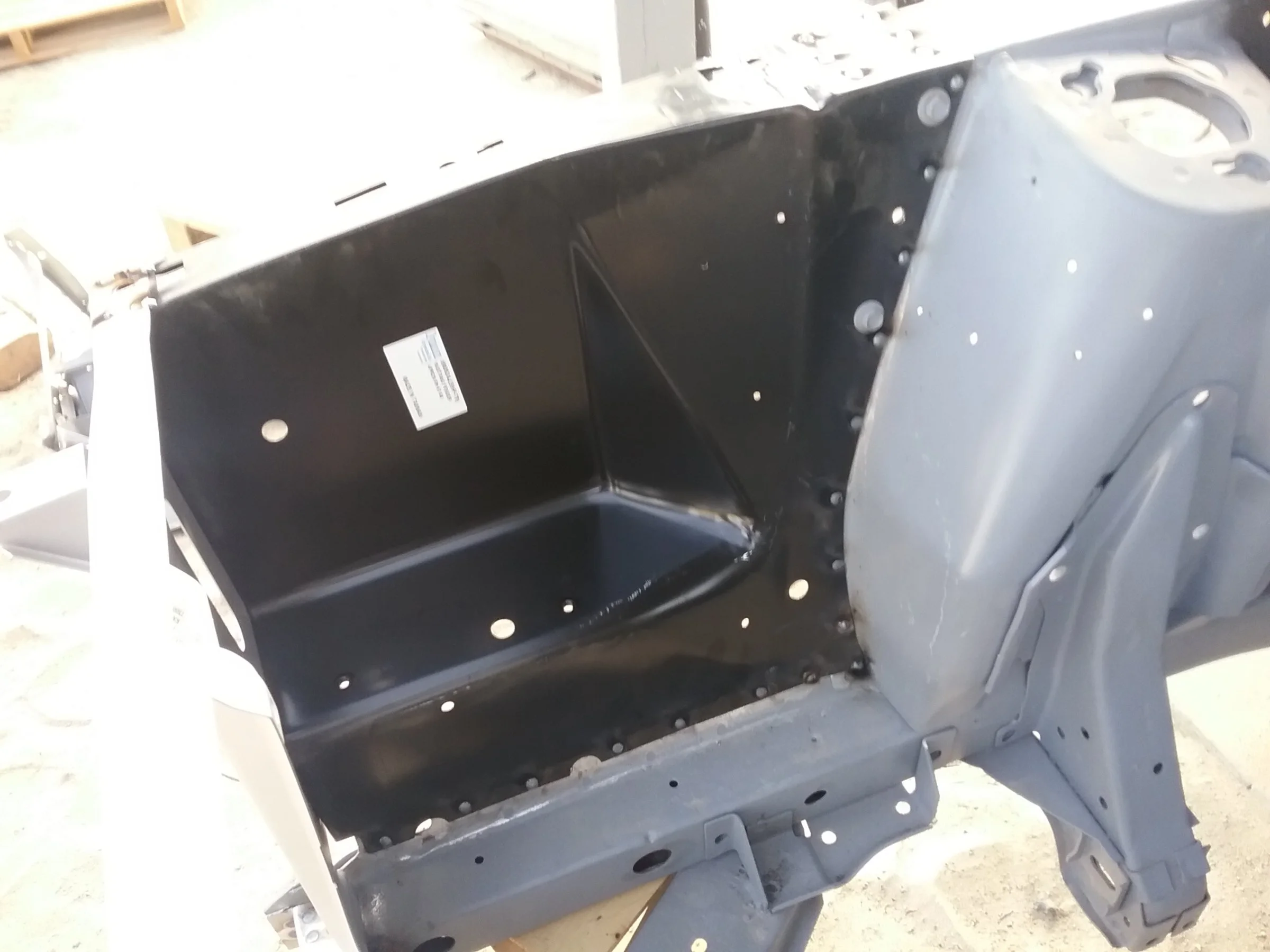

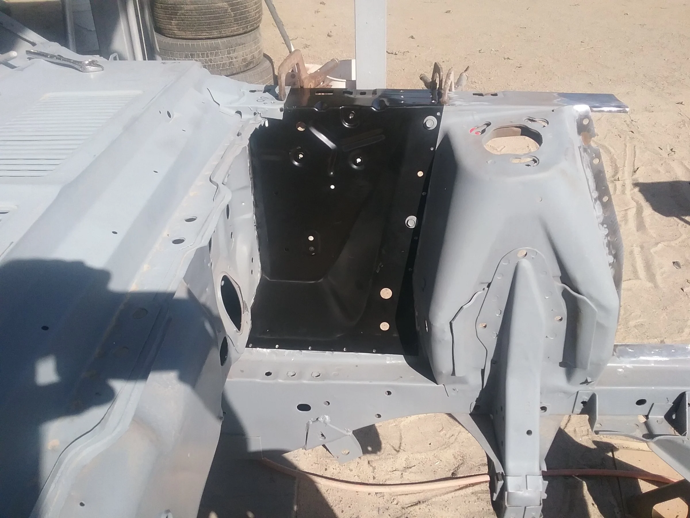

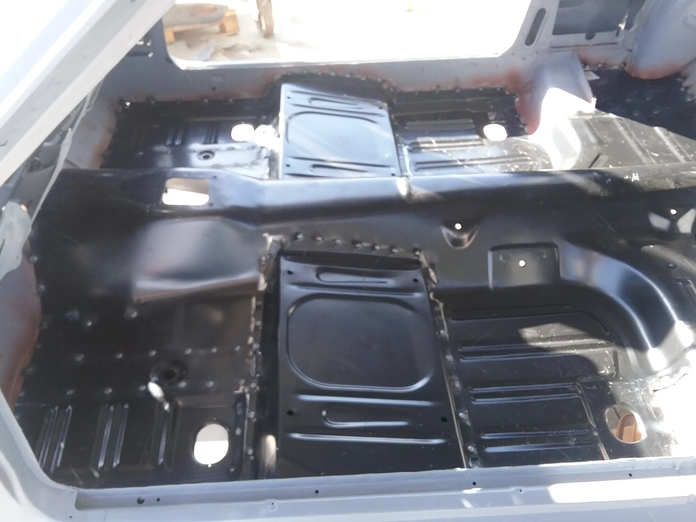

The floor and seat boxes are in ,just have to hit the welds slightly with the angle grinder. The front apron will be next on the list

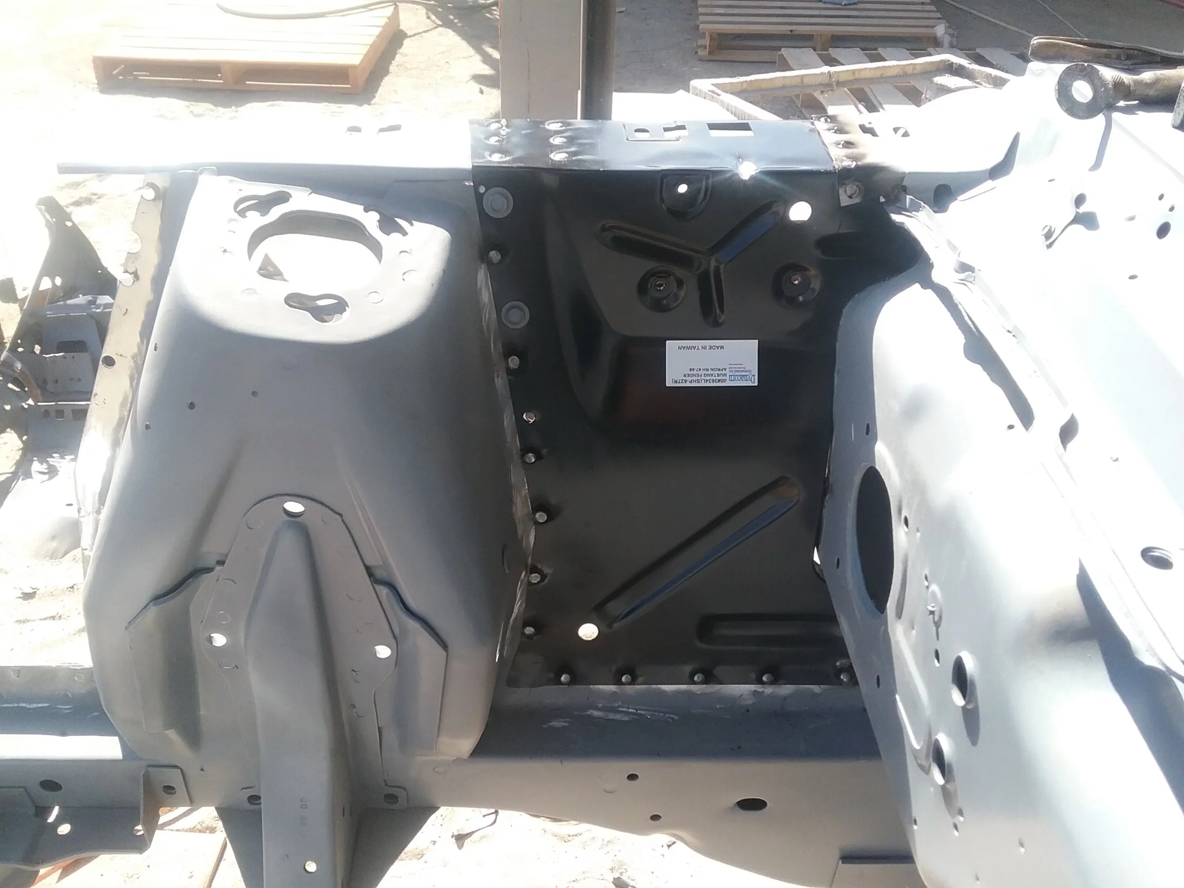

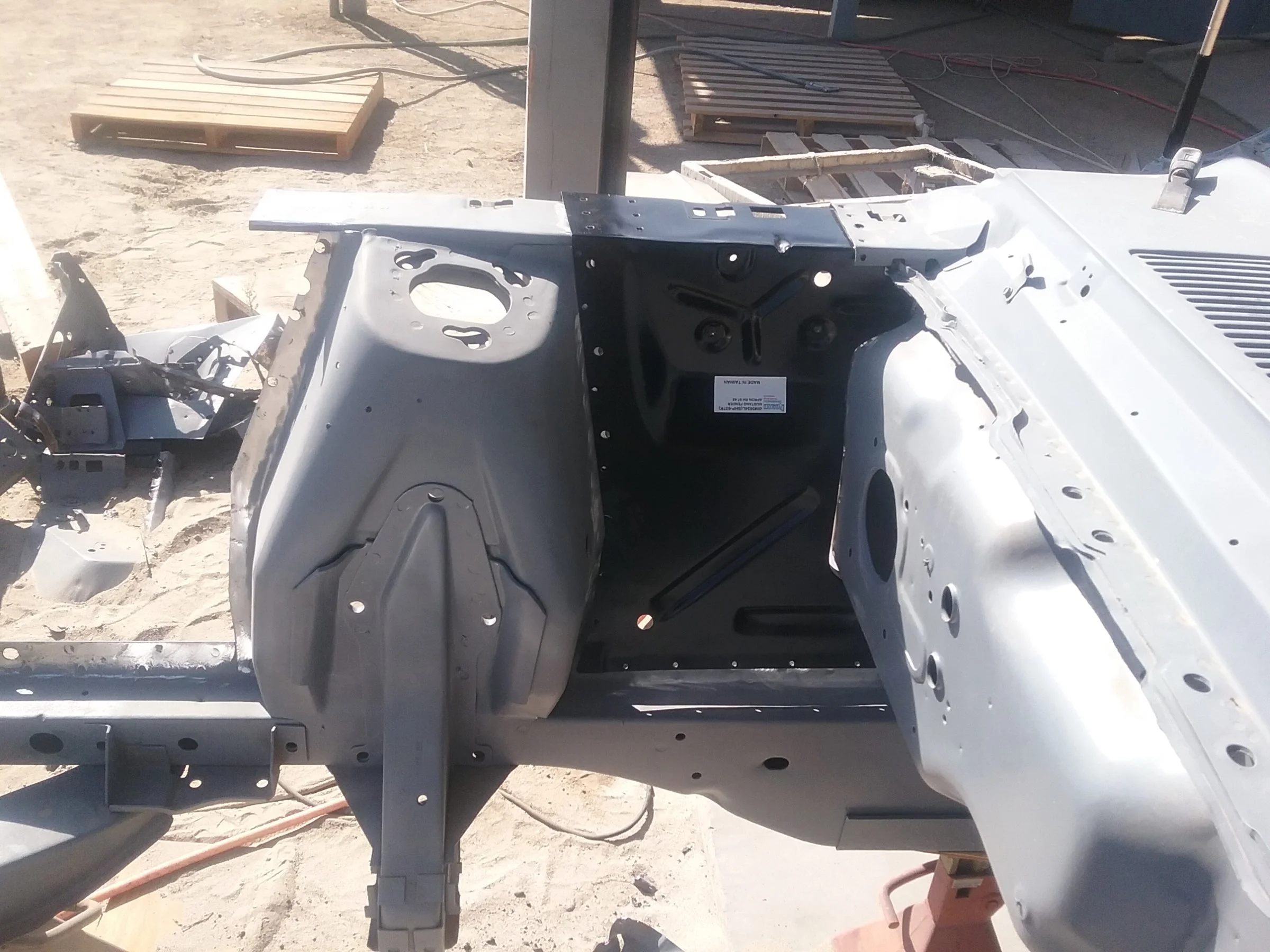

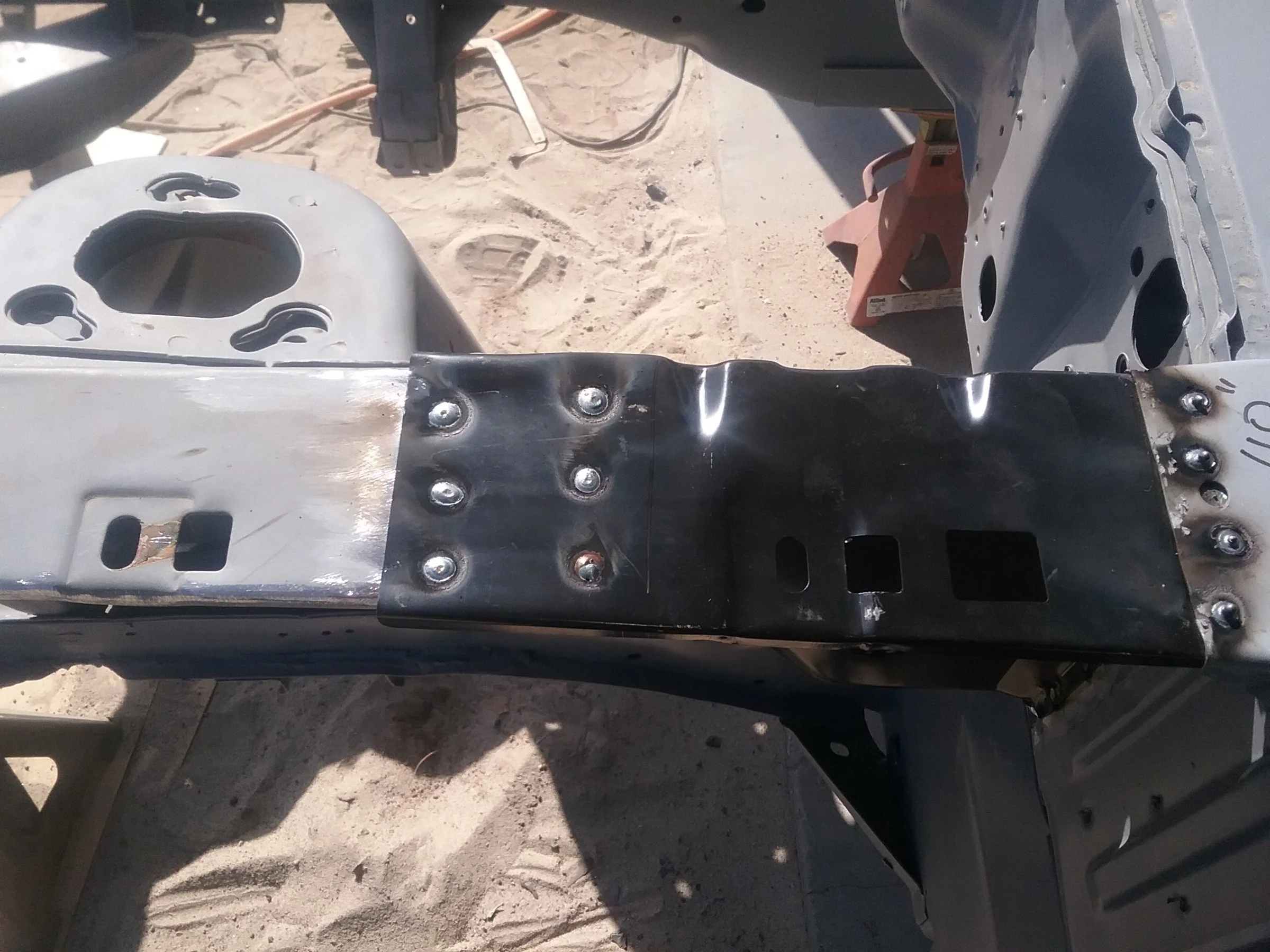

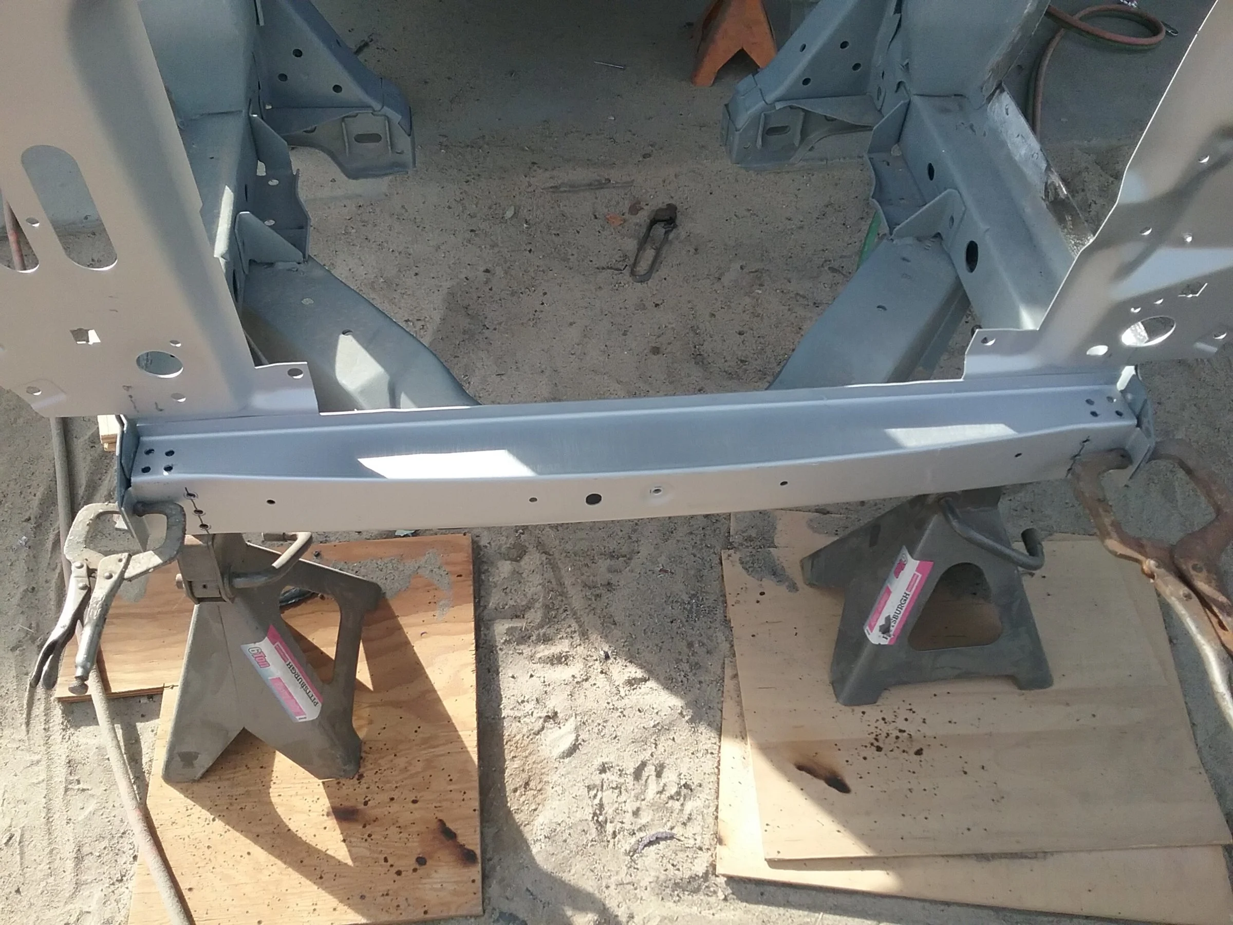

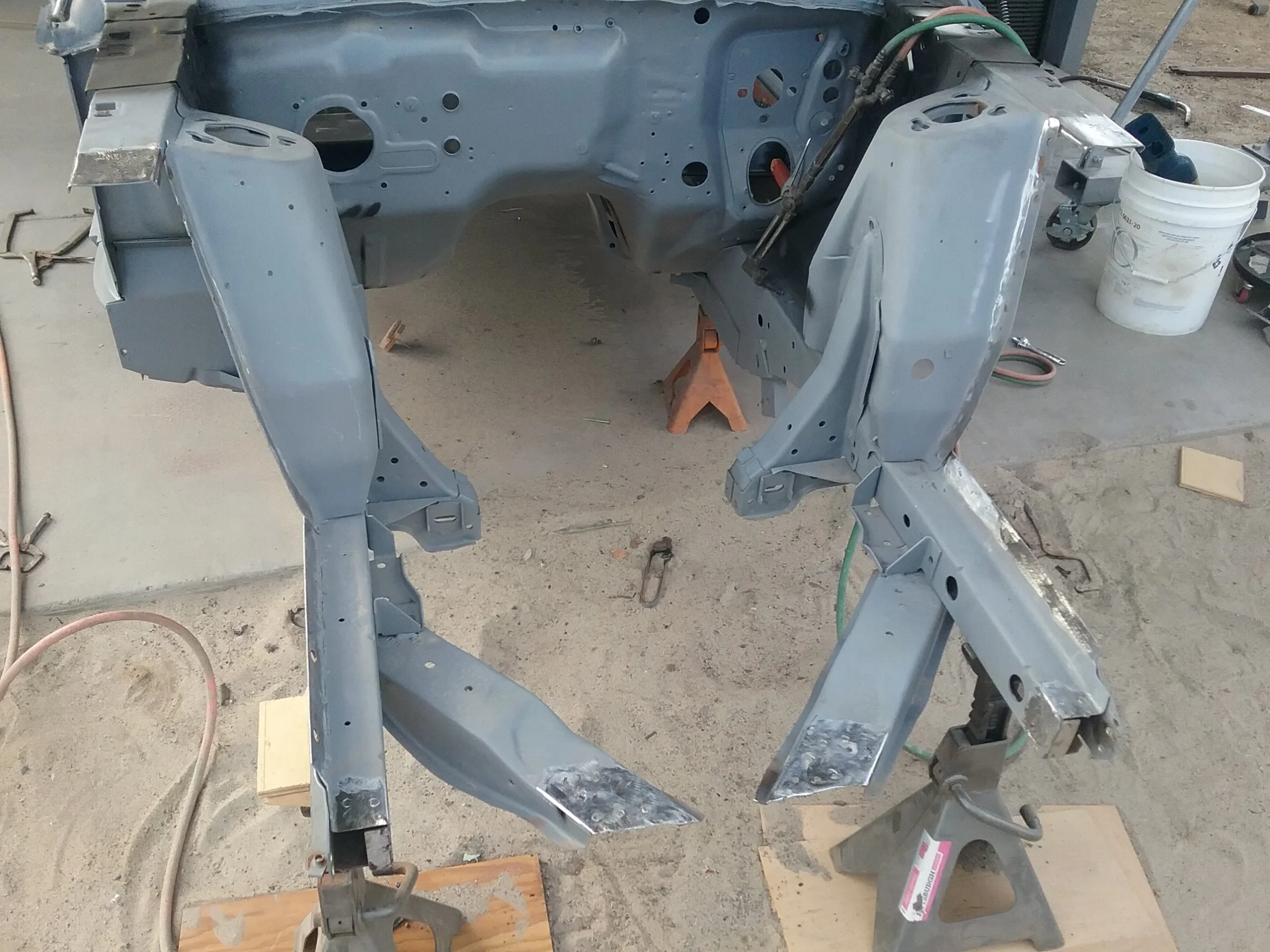

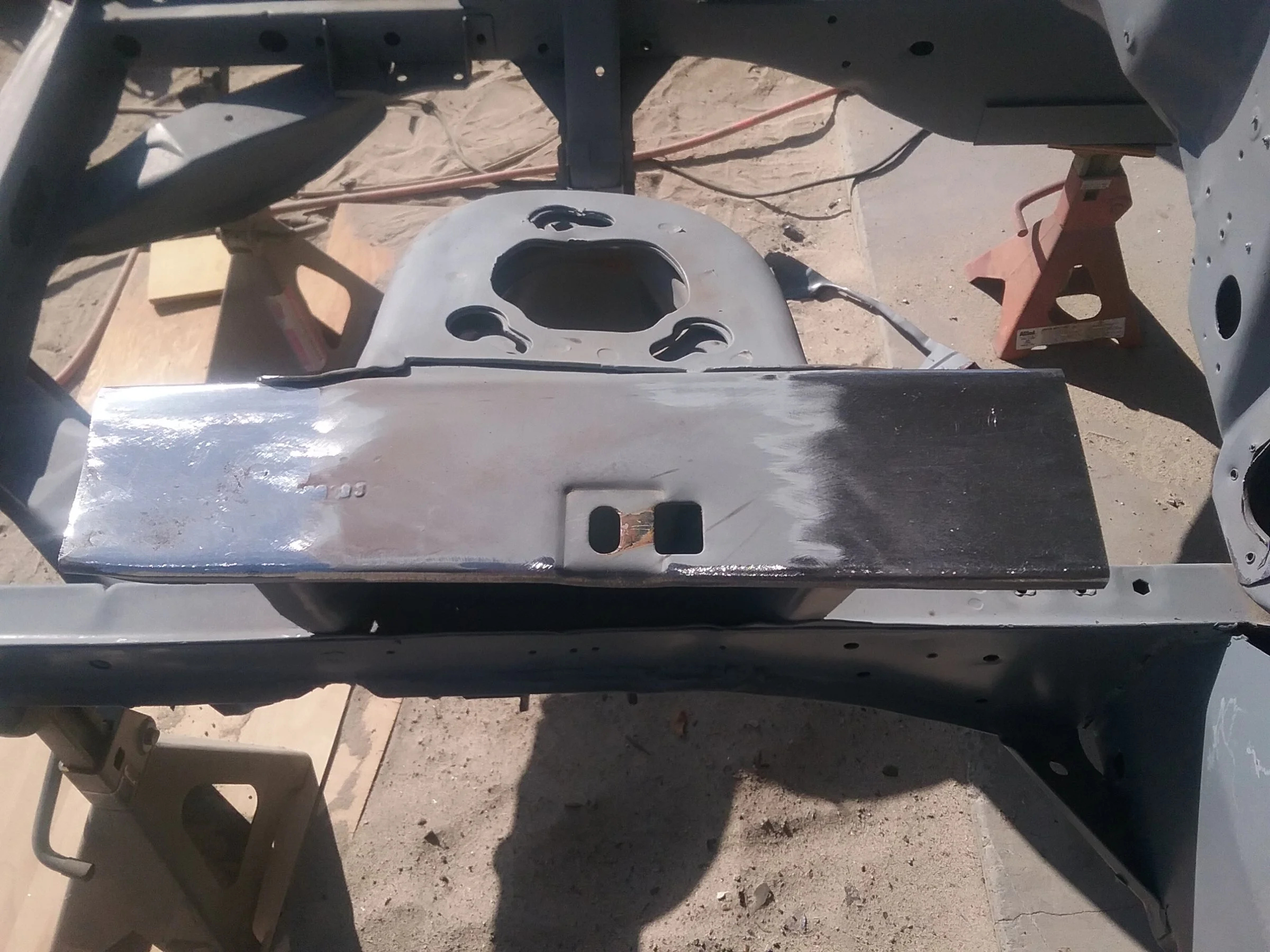

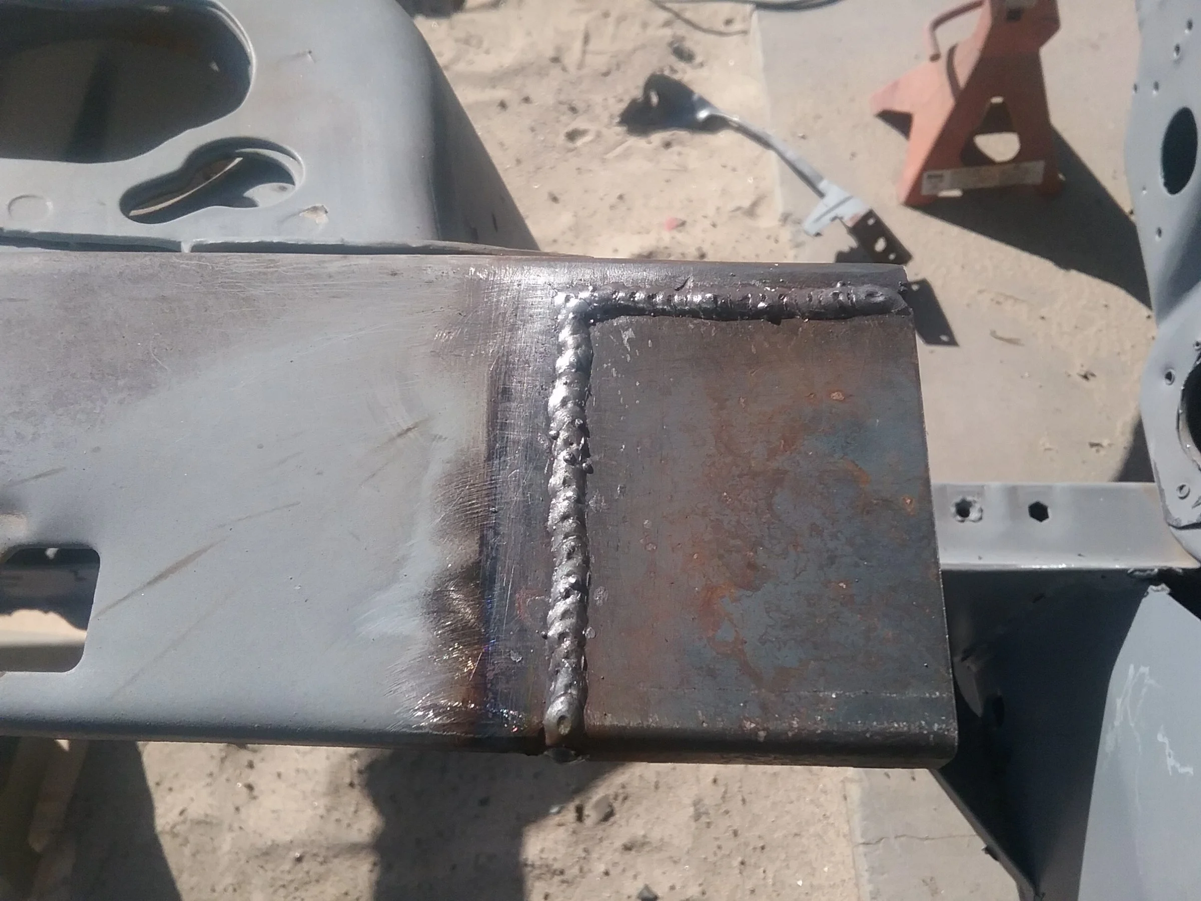

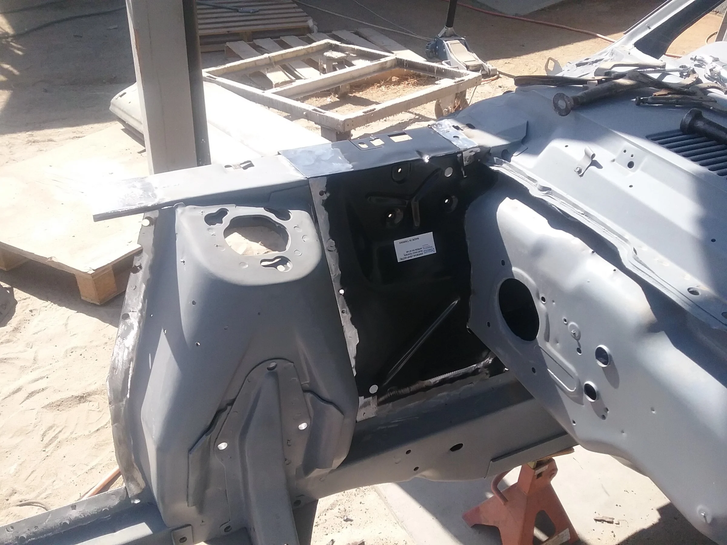

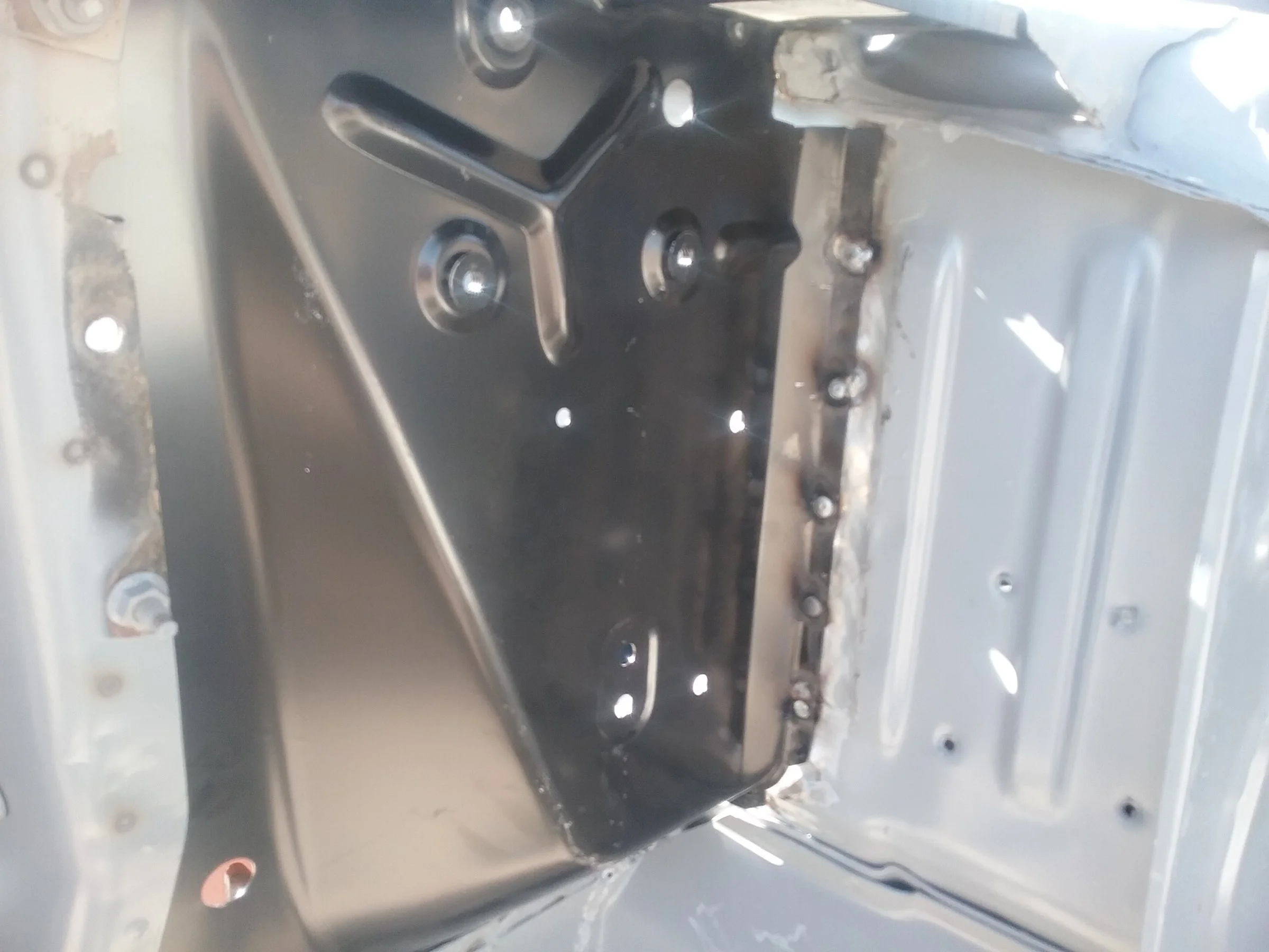

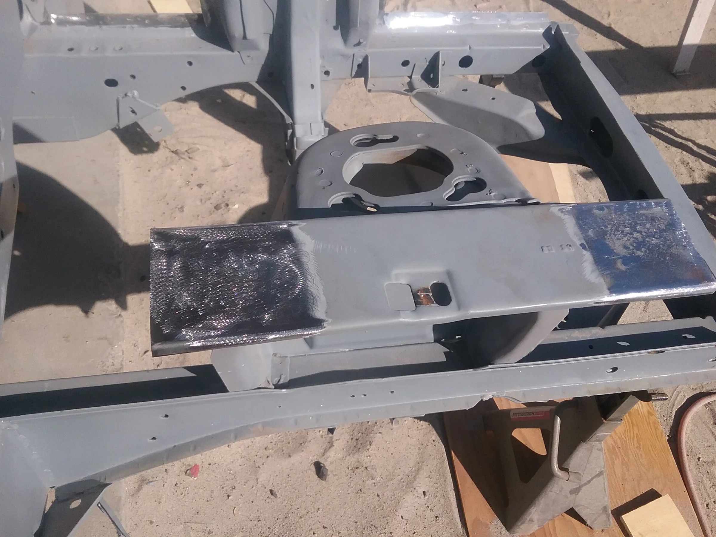

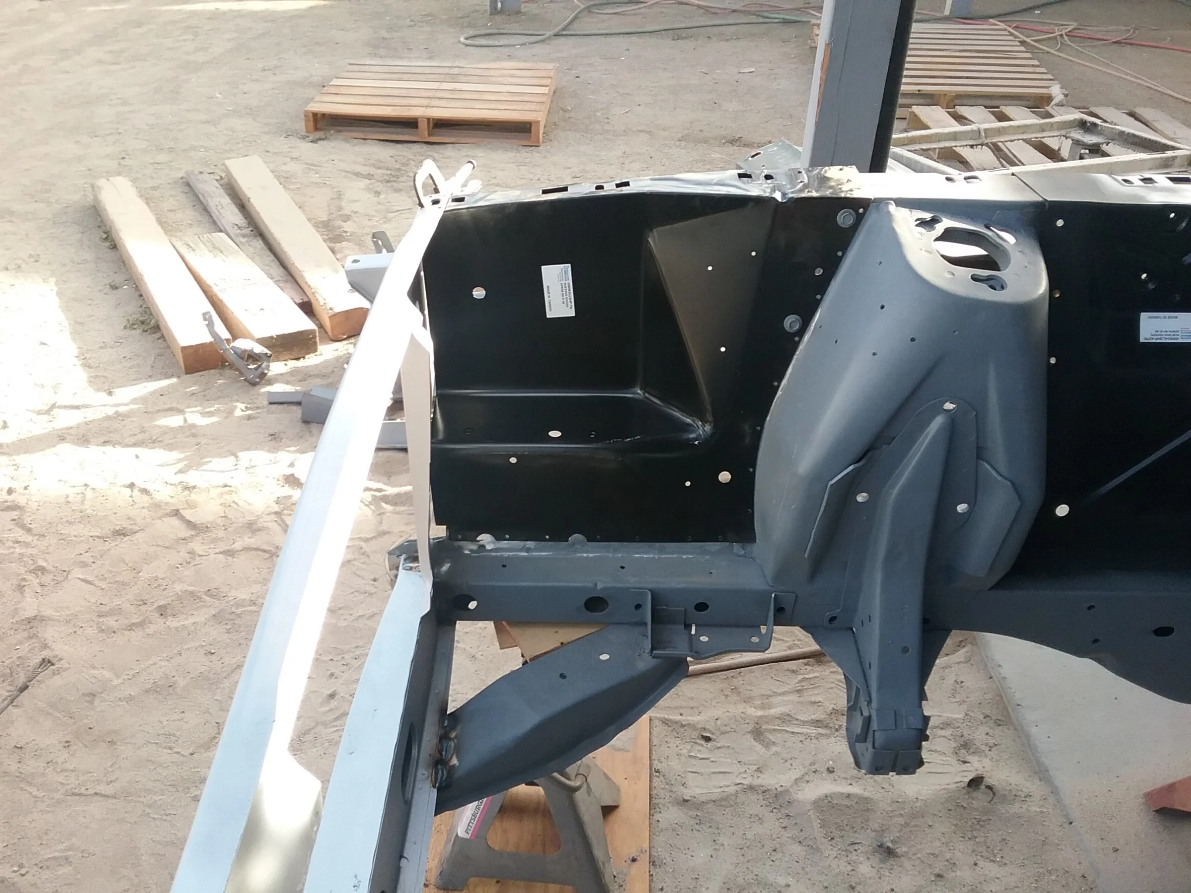

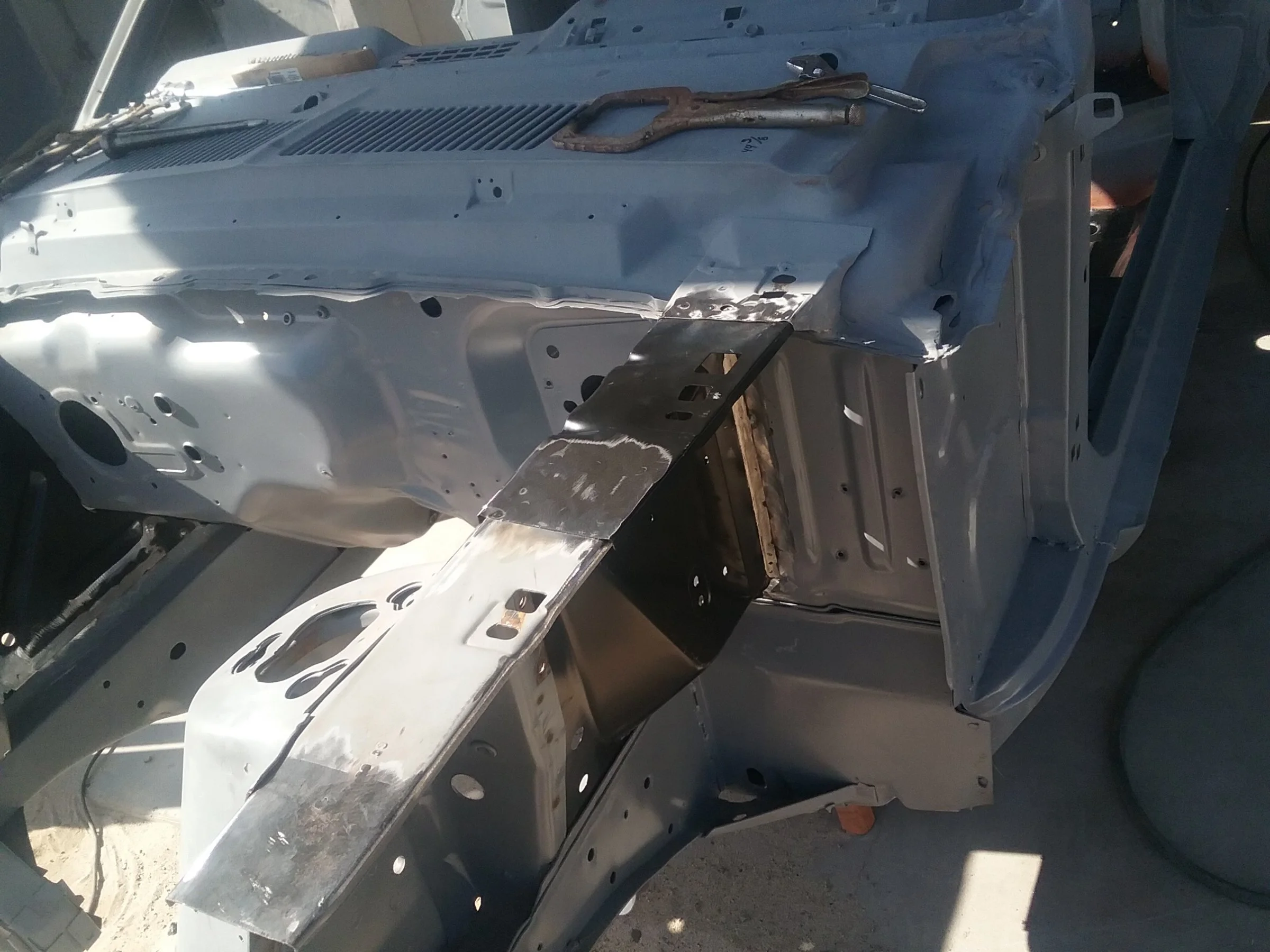

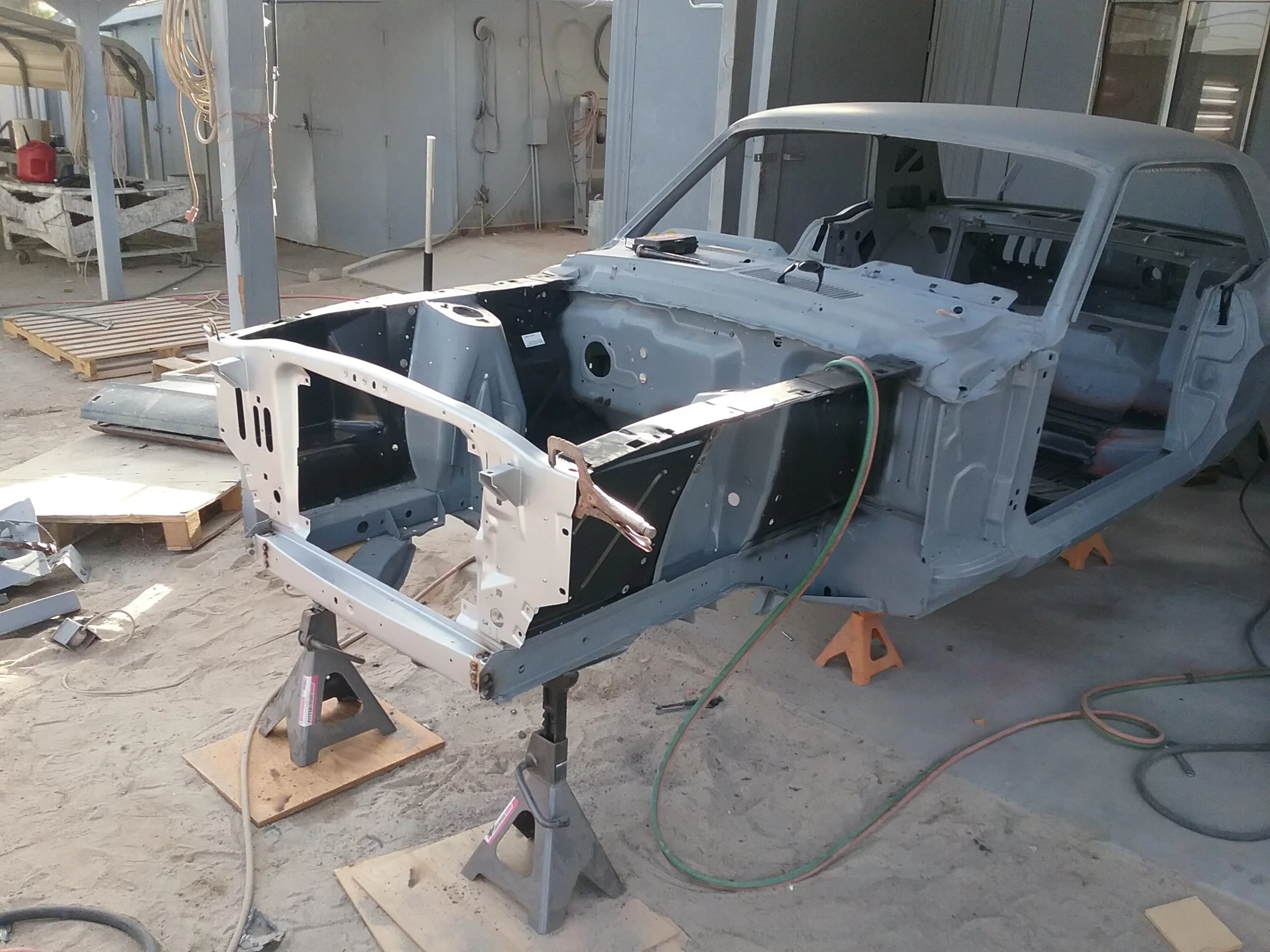

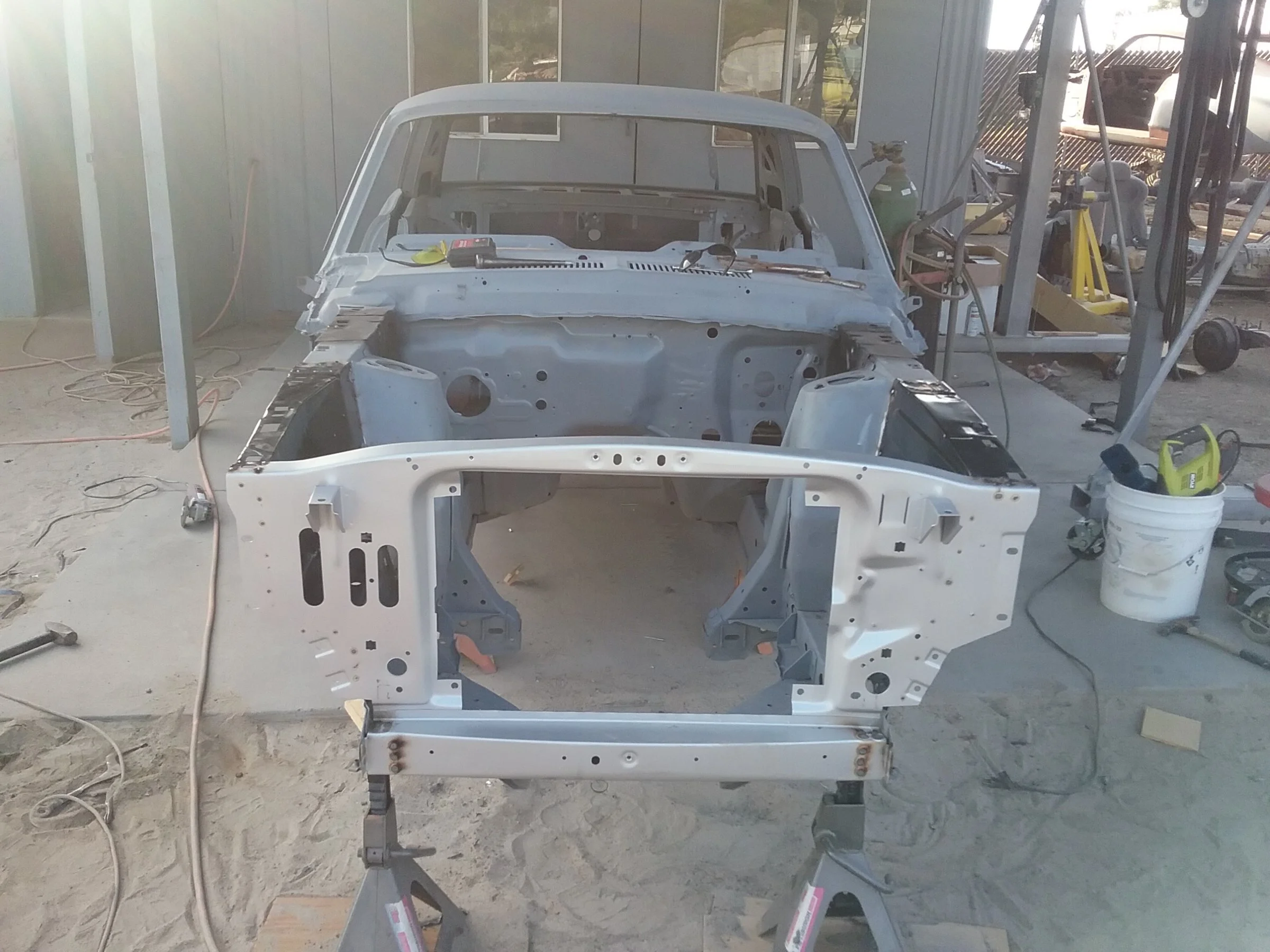

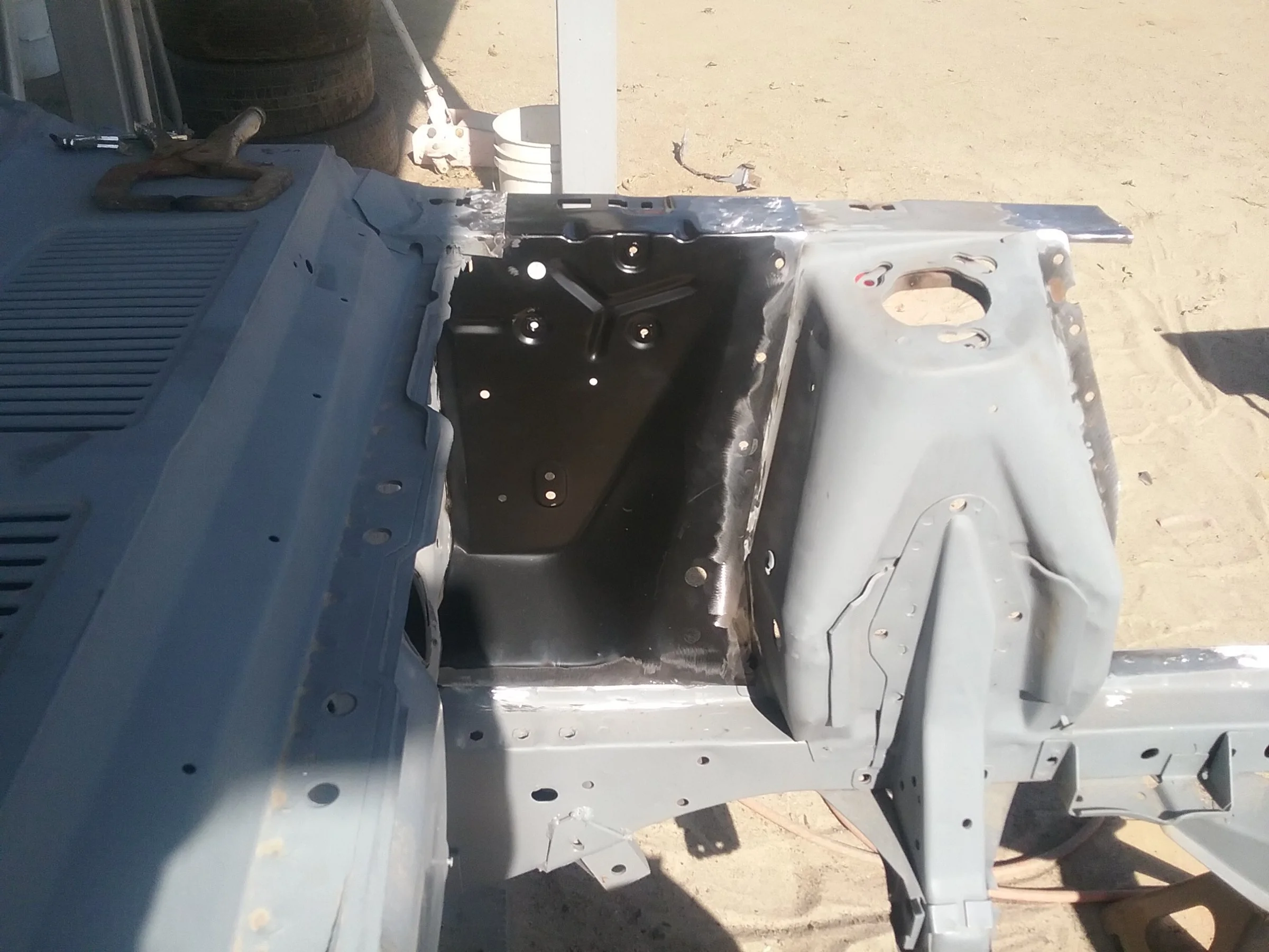

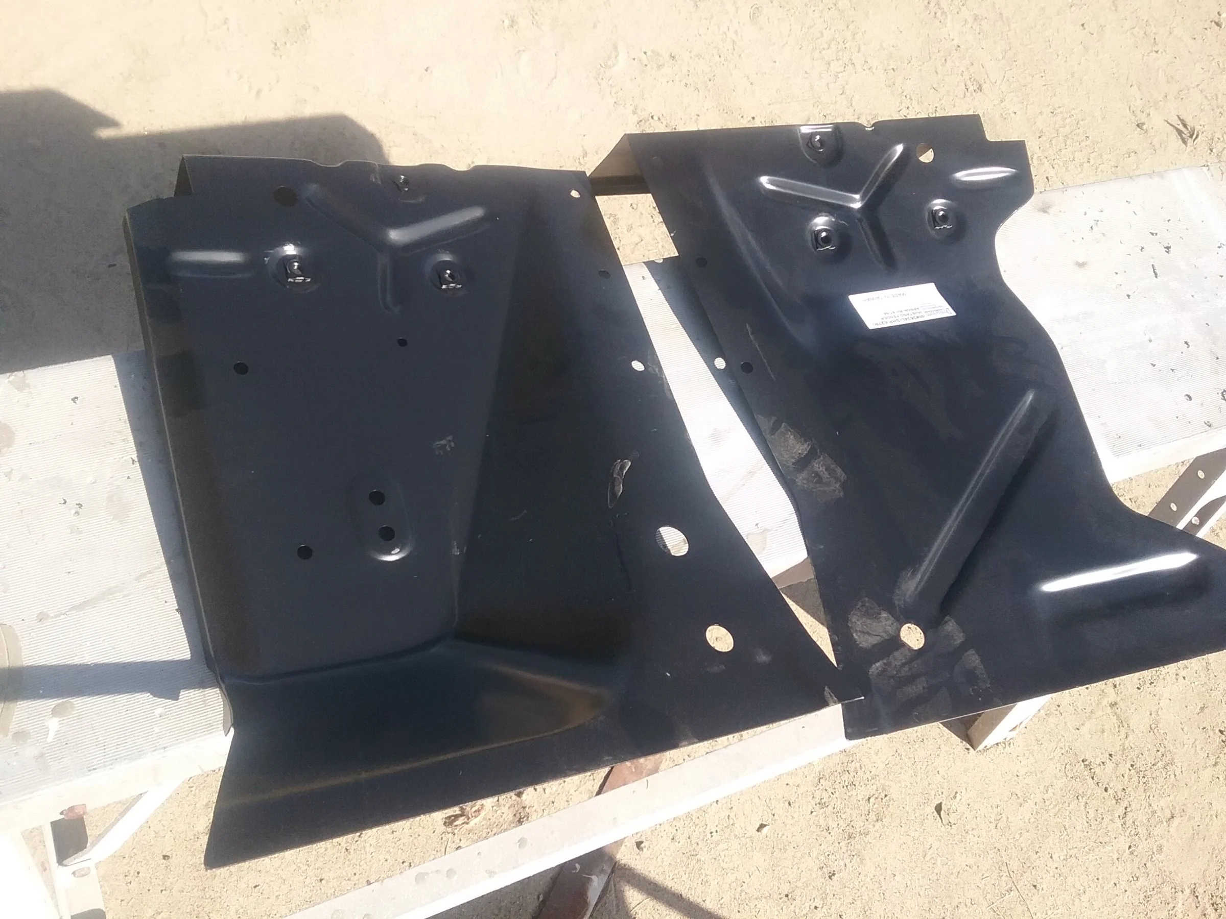

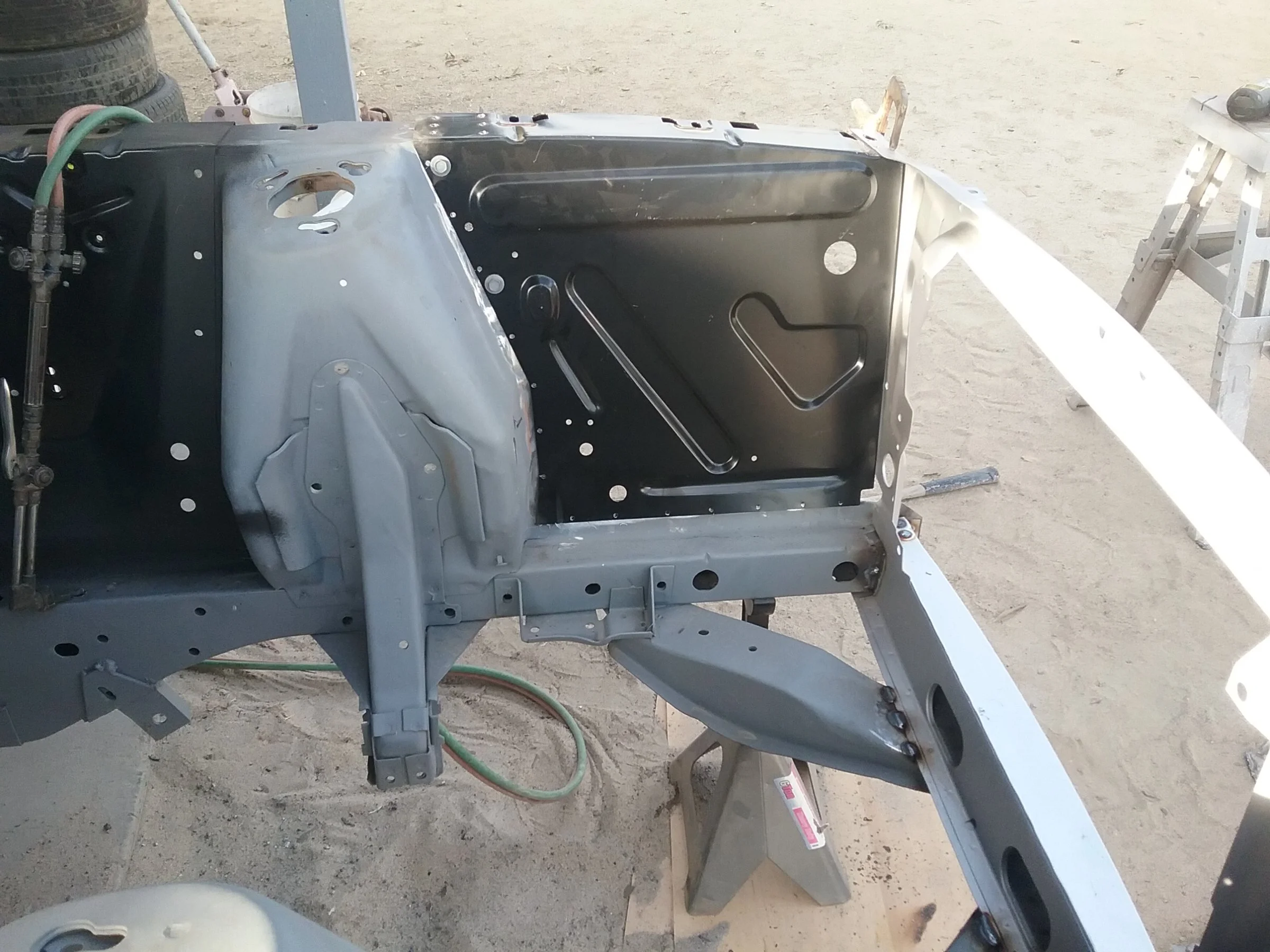

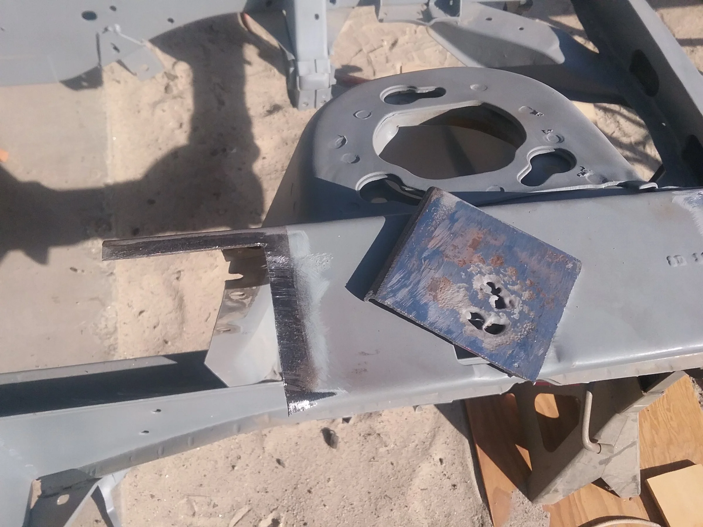

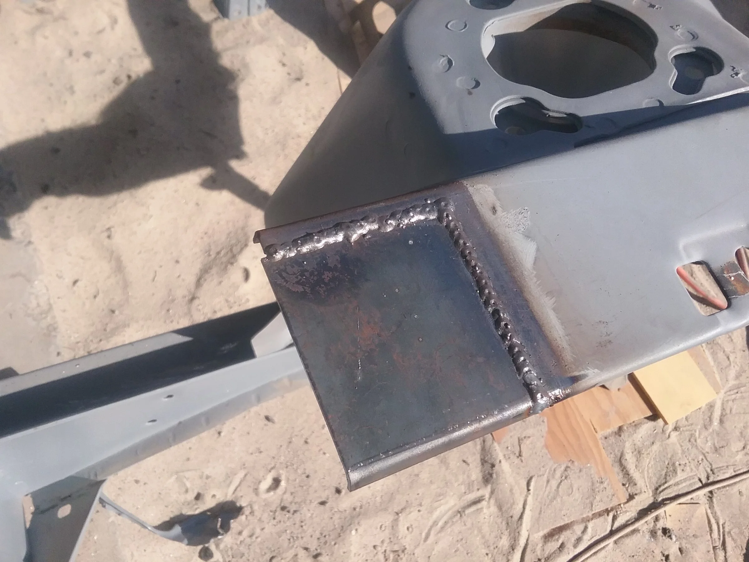

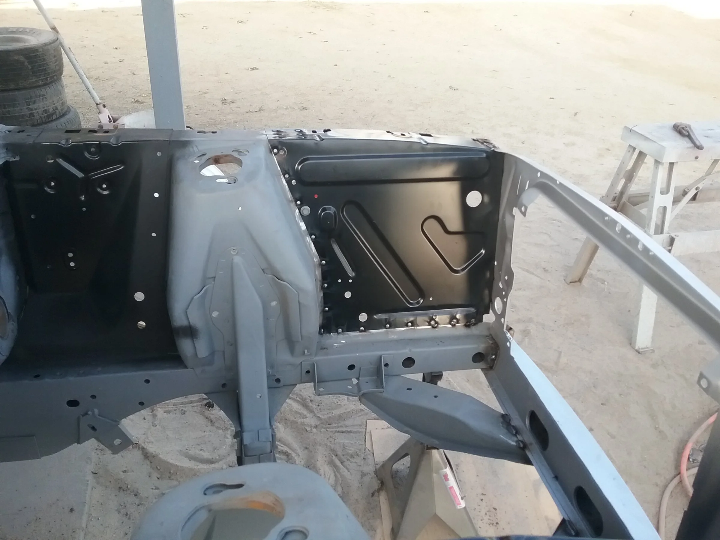

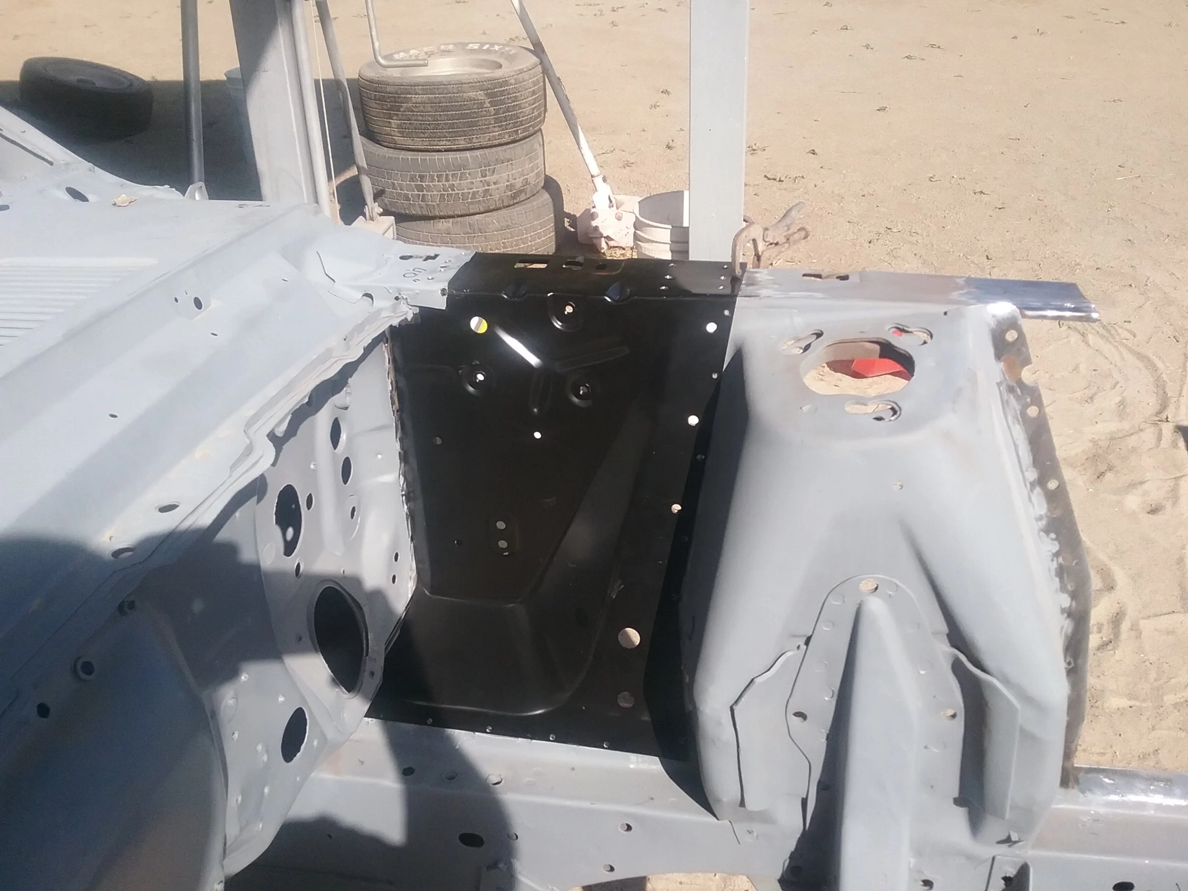

I trimmed off the front cross member and drilled plug weld holes in the radiator support ,it is the one with the cross member already attached. I clamped the radiator support in place ,you cant go wrong ,it fits tight between the frame rails and hooks over the end of the frame rails
welded the radiator support and crossmember ,my welder was showing off and made a lot of tbe welds where i will not even have to grind them ...must be tired of me cussing at it . I clamped the inner aprons in place ,pretty much cant go wrong here either ,align the front bolt holes with the radiator support and bolt through the spring tower shock cover holes and the measurements were right on ,just had to weld it all in place .the front is done ,except for grinding the plug welds

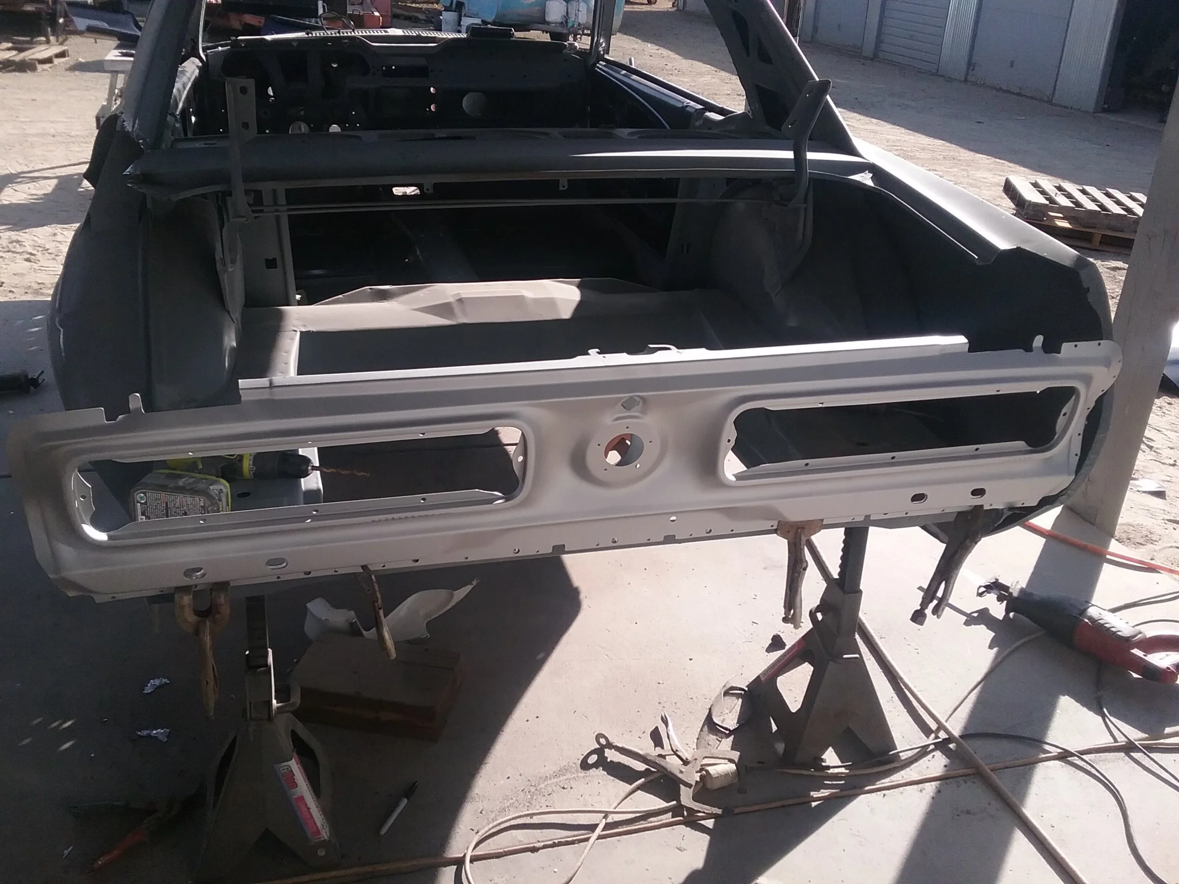

The driver side rear quarter and tail panel is next ,but first i have to fit the new doors so i have somthing to align the quarters with

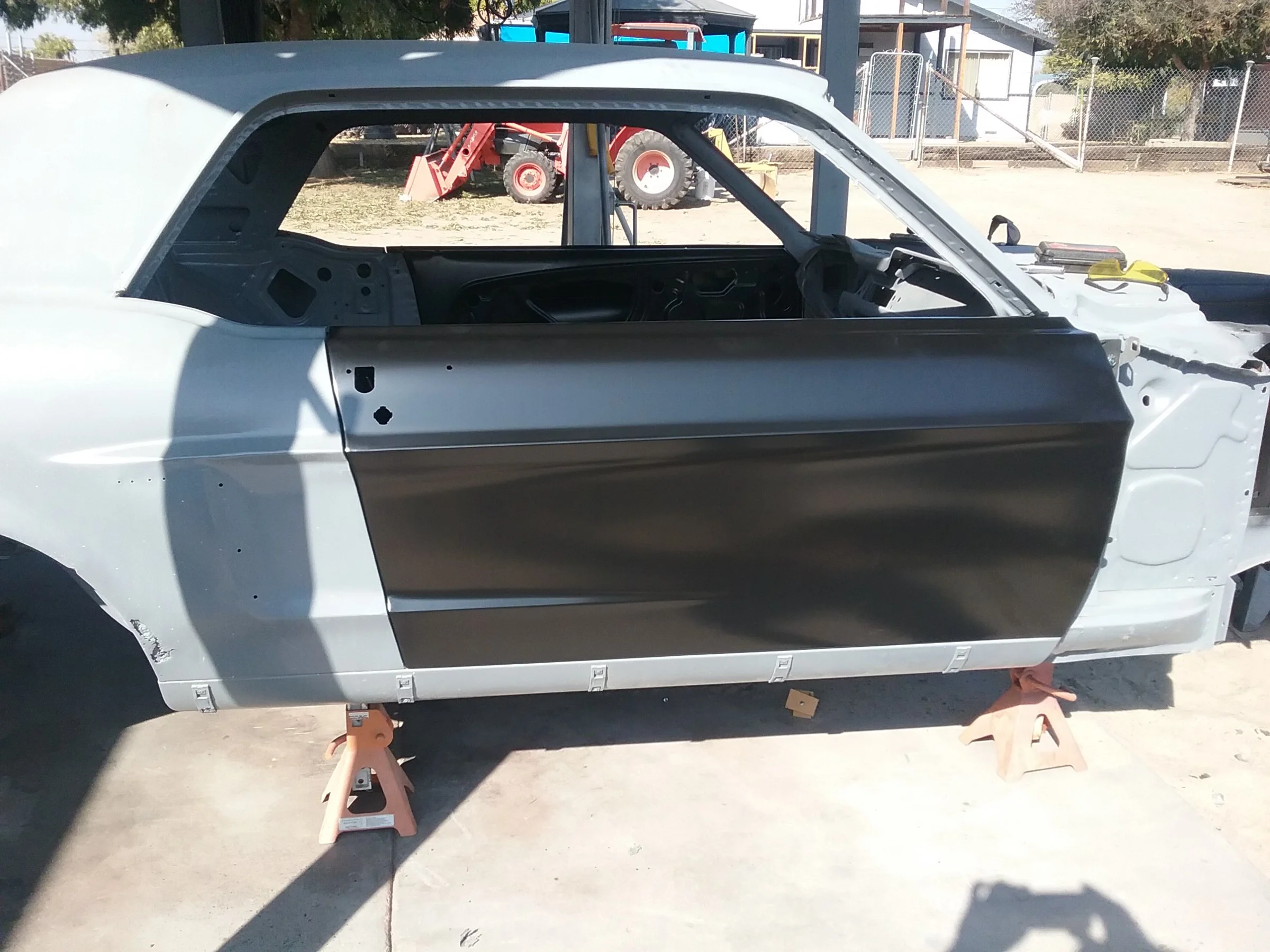

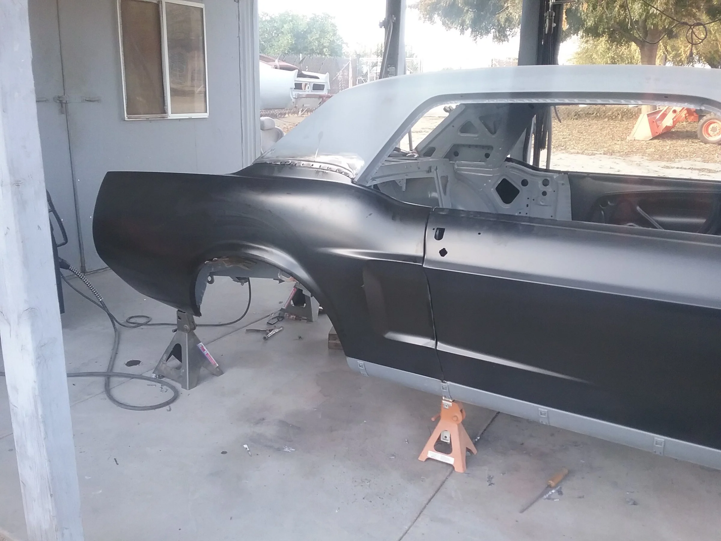

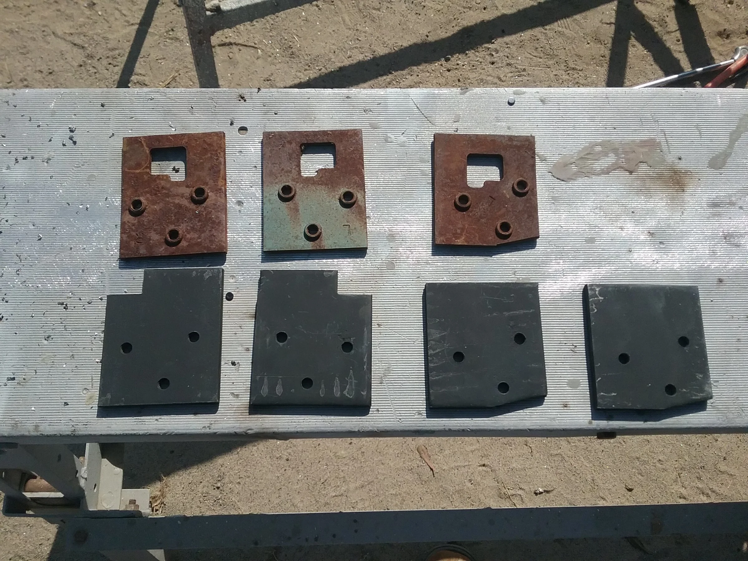

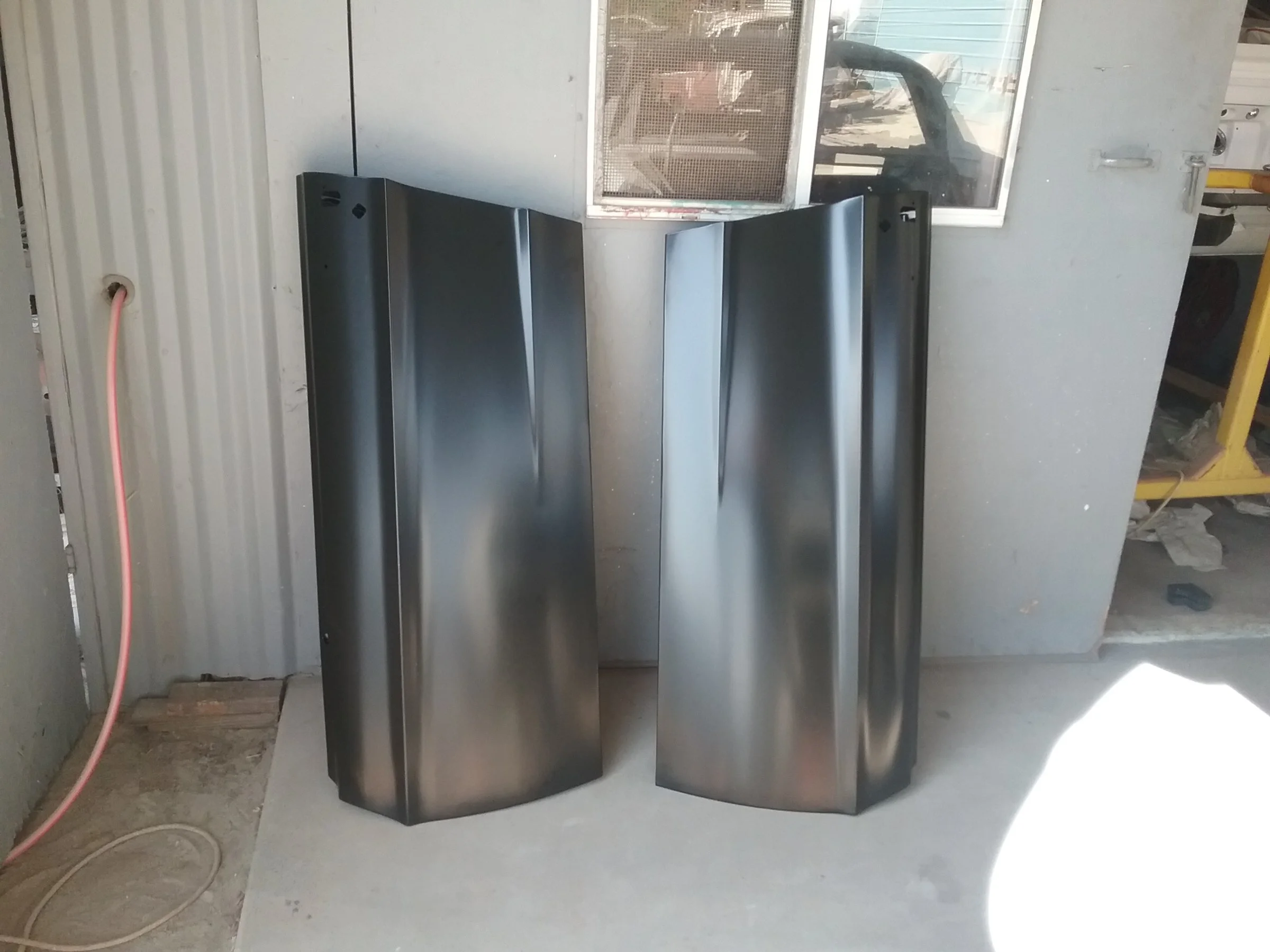

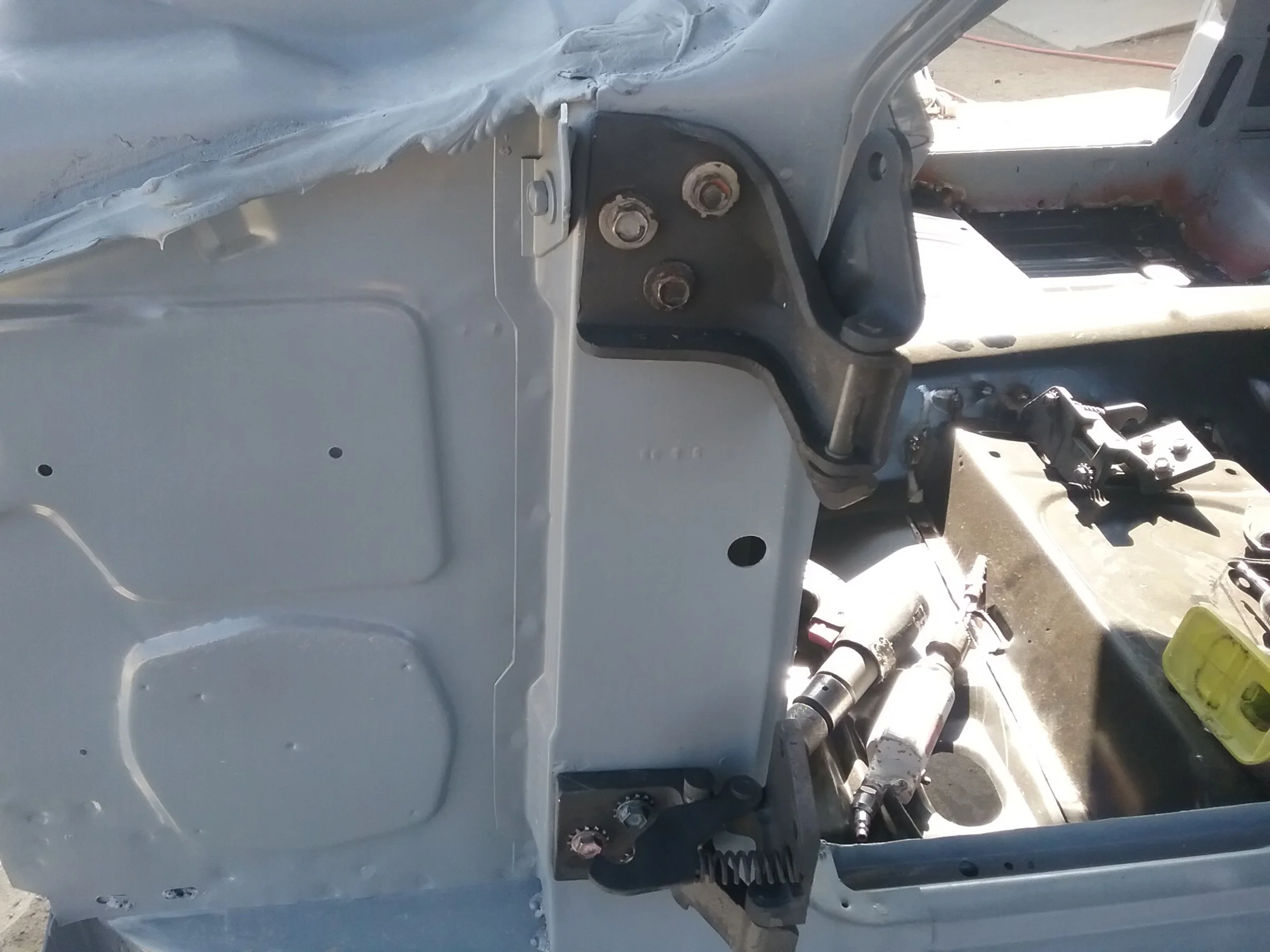

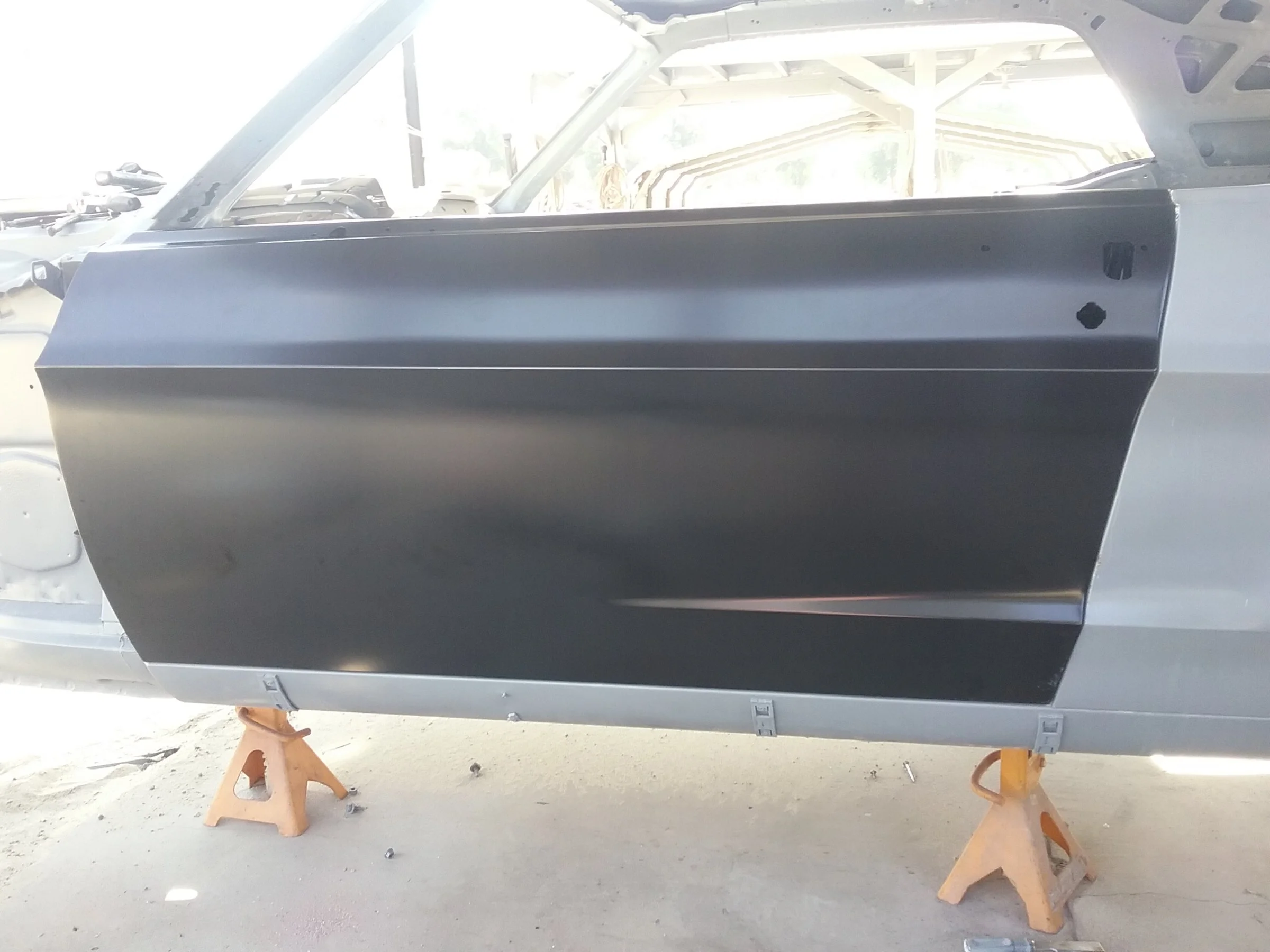

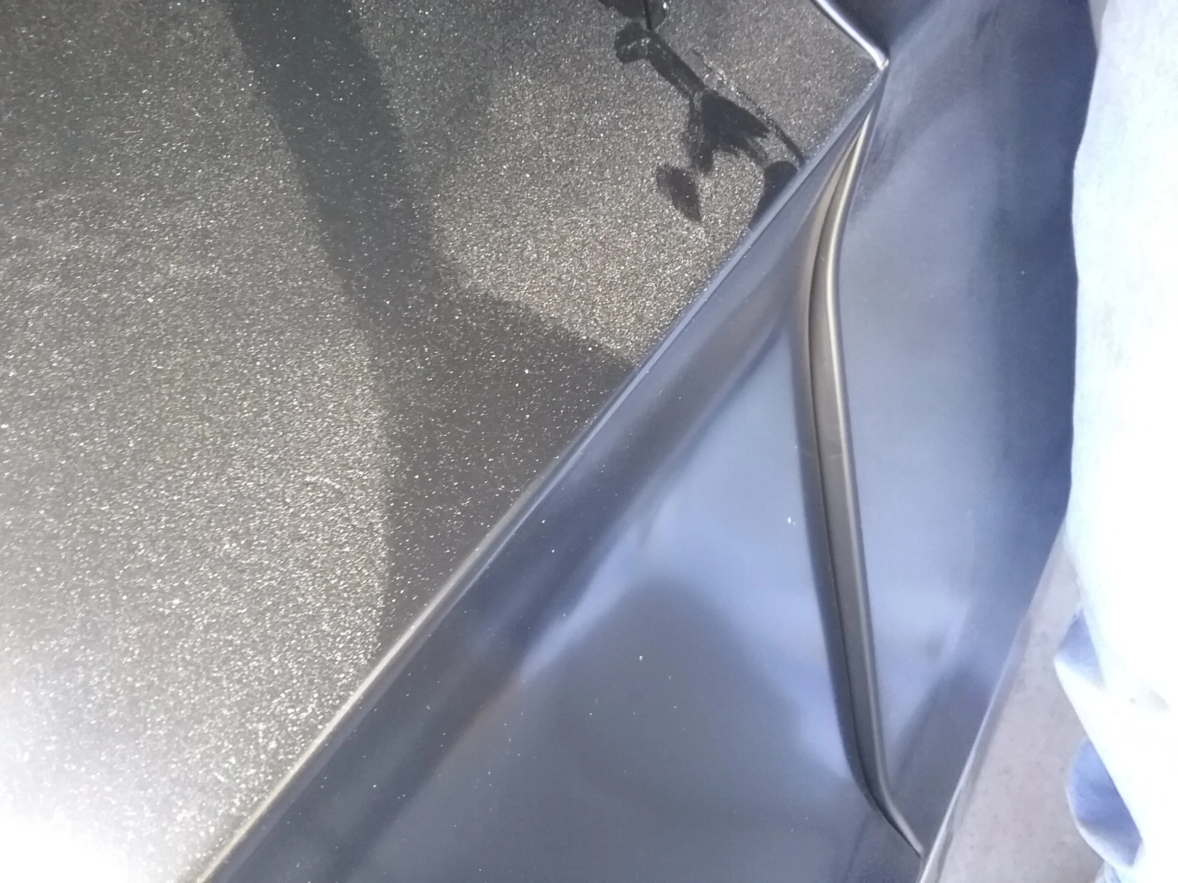

I got out my new Dynacorn doors ,and this set is nice . Did you know 67 and 68 door hinge plates are different ,they are 68s on the top and 67 will not bolt into a 68 so since i wasnt brought plates i had to dig some out
I bolted the hinges to driver side but left them loose untill i also had the door bolted snug .they fit good enough all i had to do was lift slightly on the door and tighten the hinges .i did passenger side the same way .Now i can trim off the quarters one side at at time so i have a point to measure from .

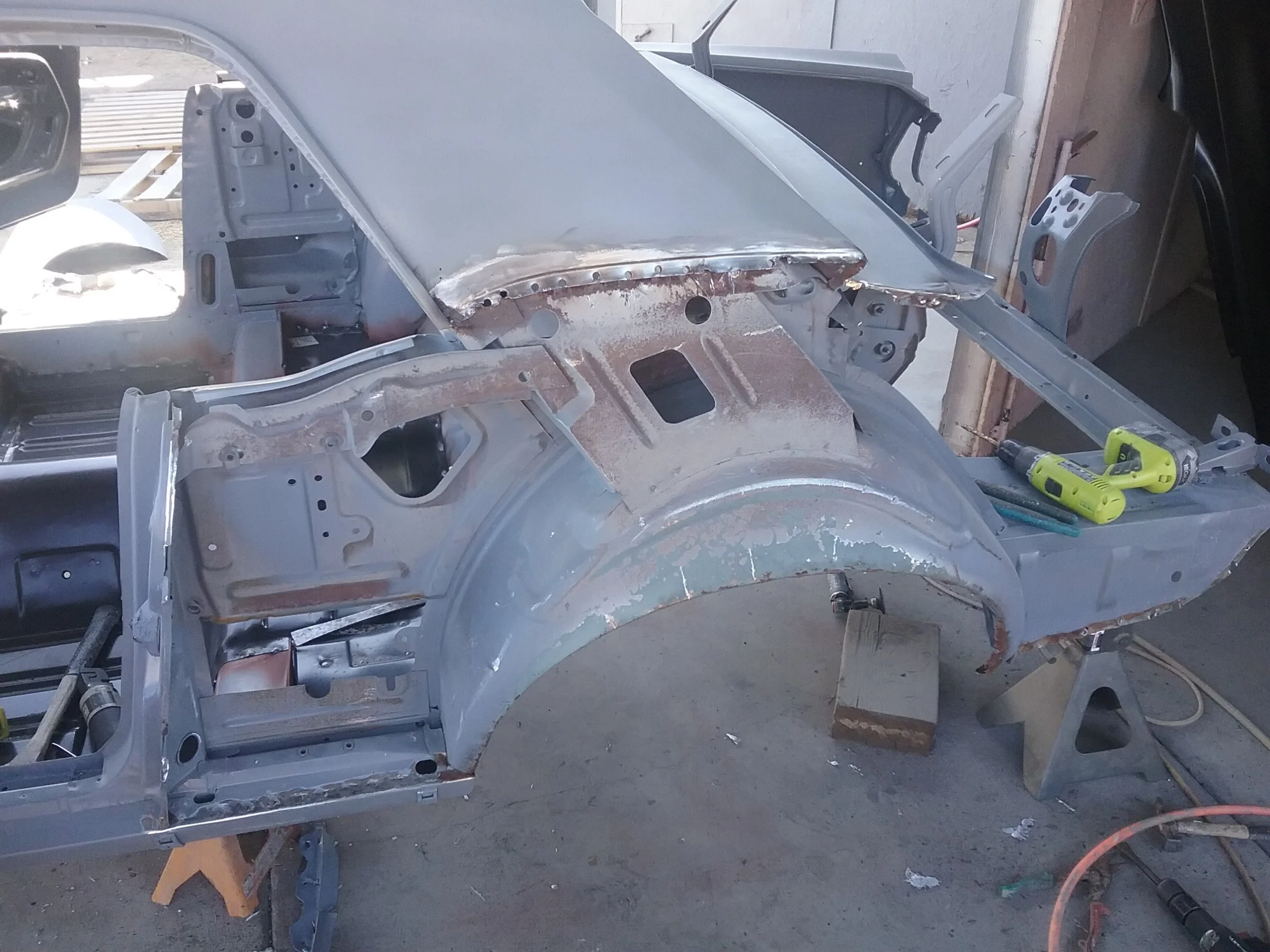

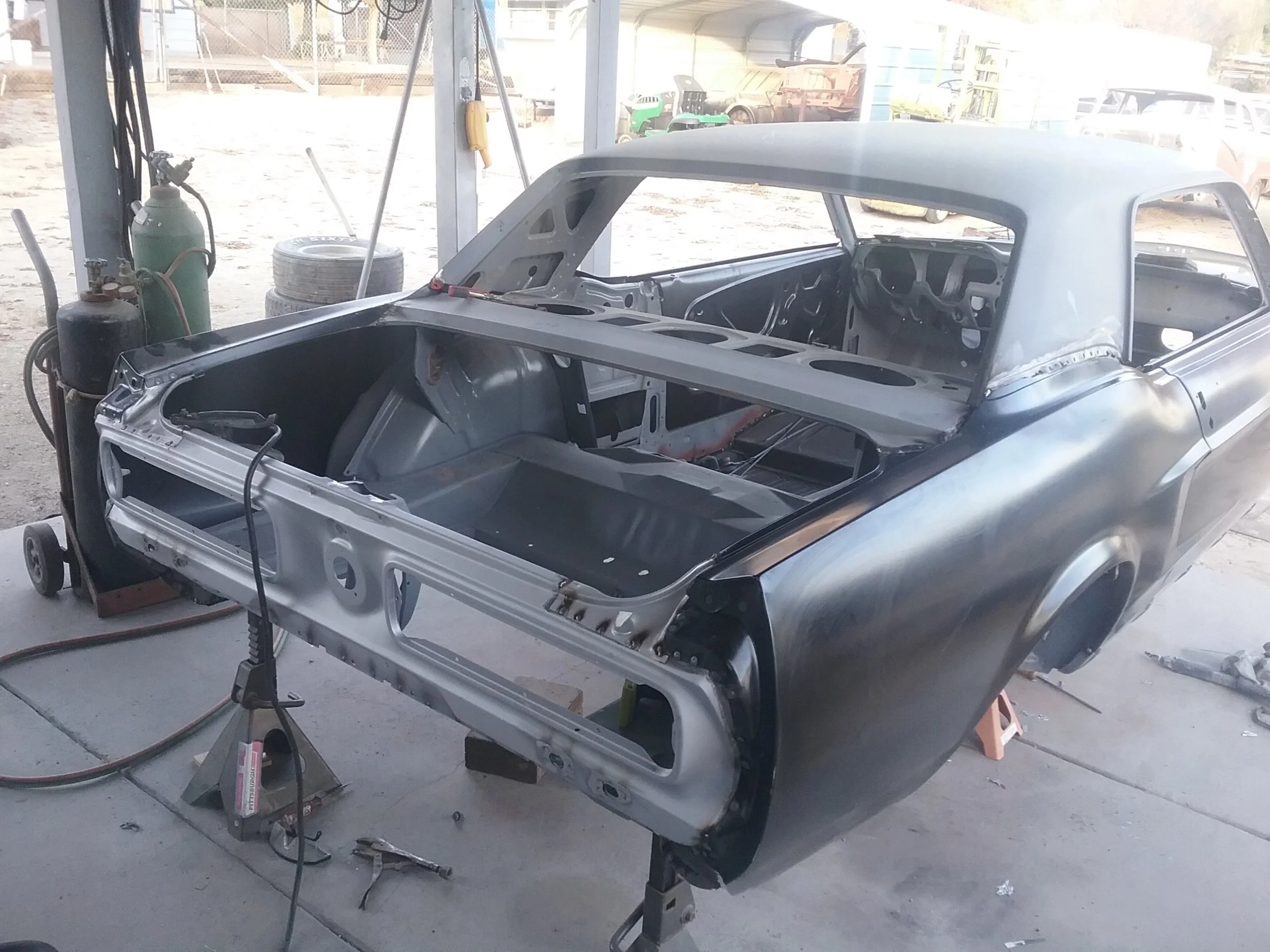

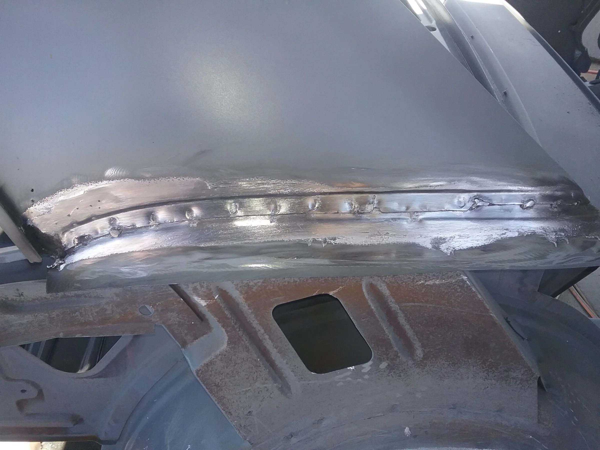

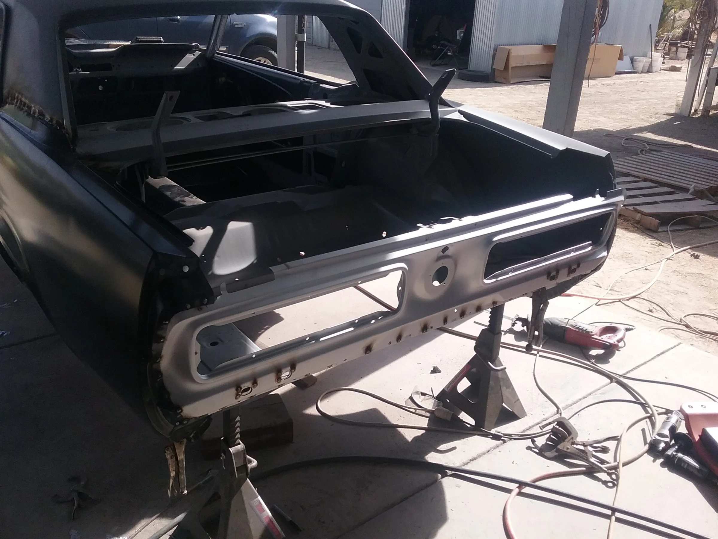

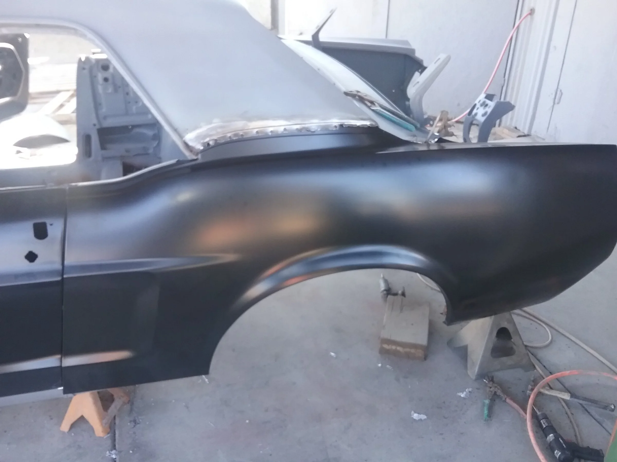

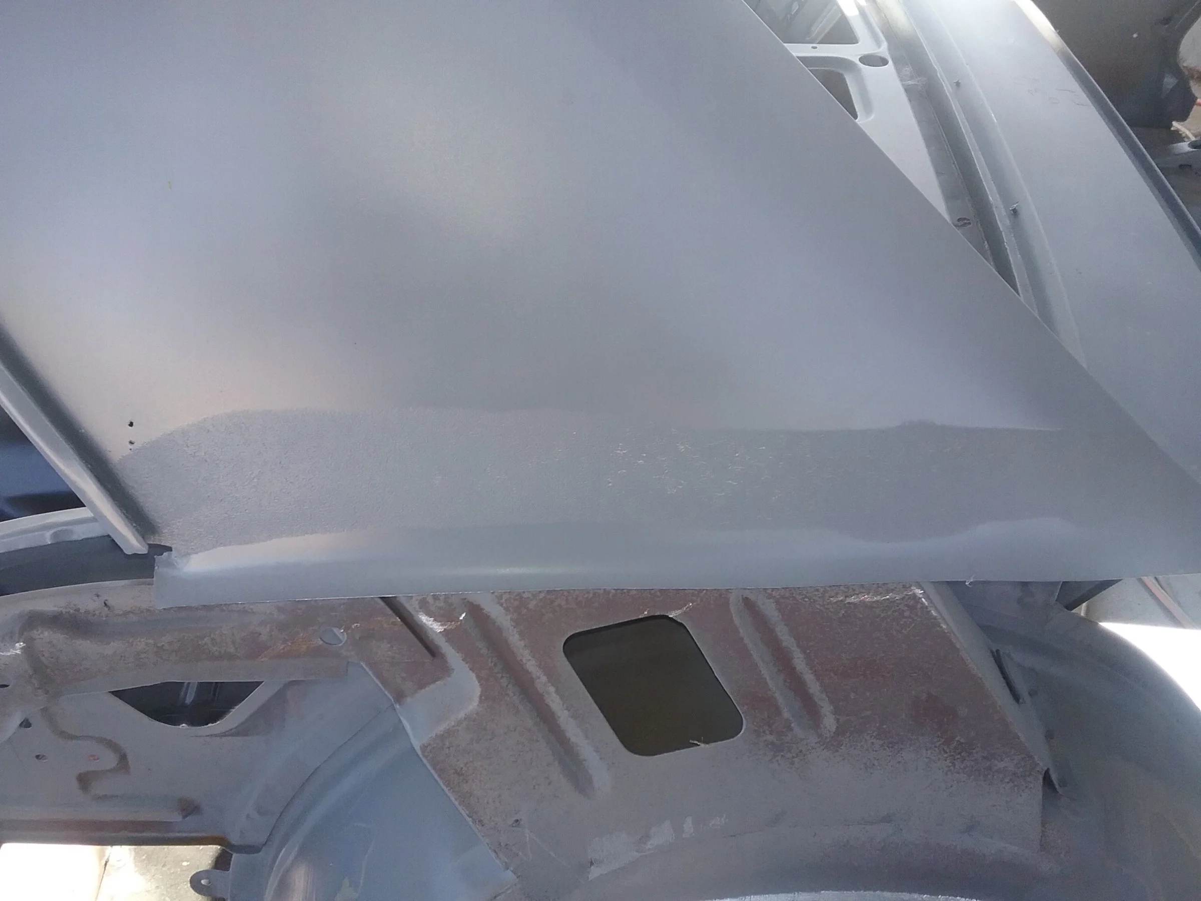

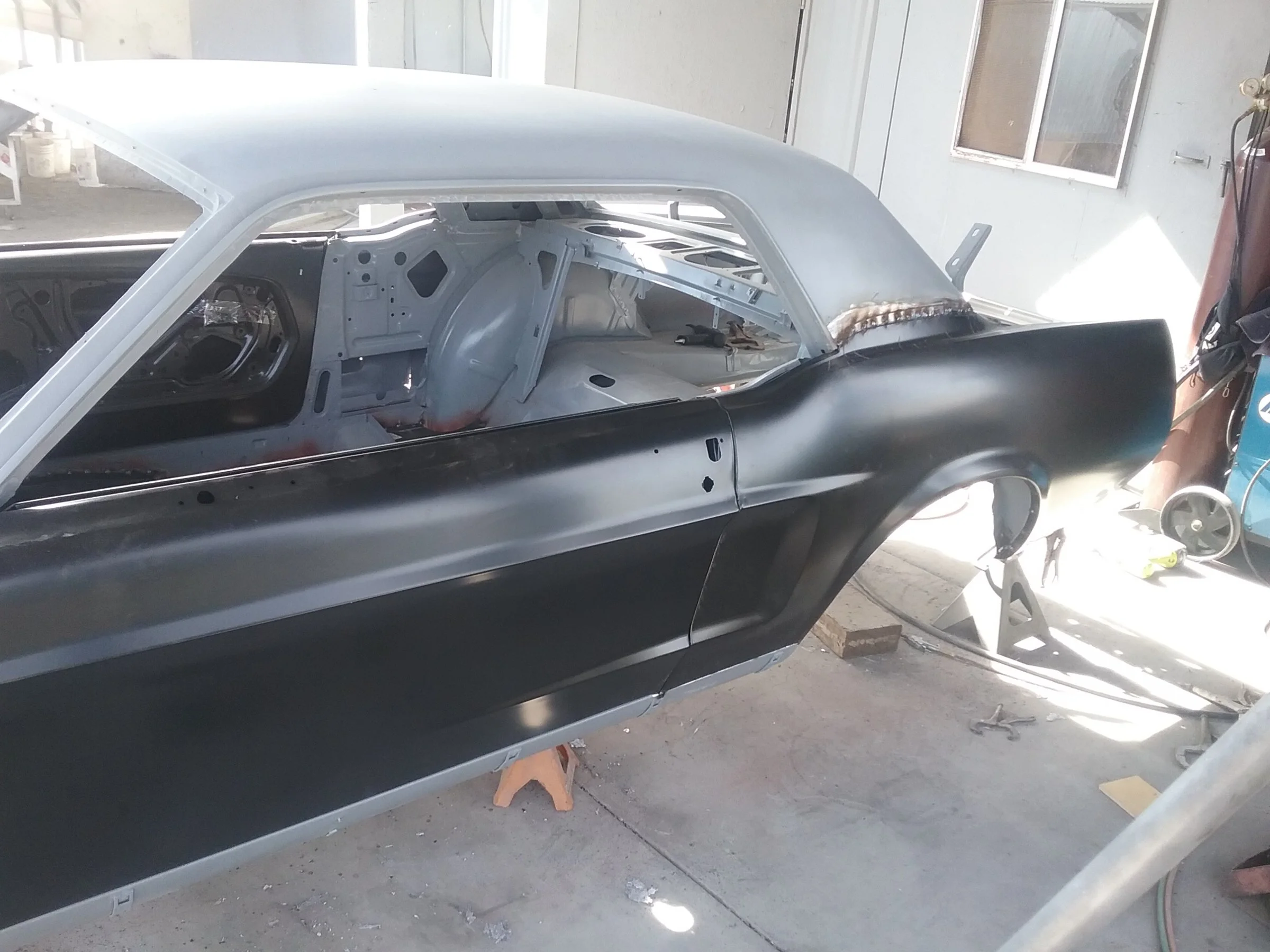

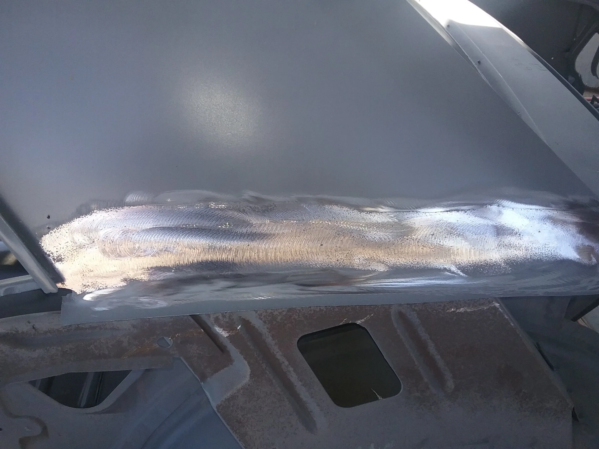

I had to pull off for a bit . Its time for the quarters. I melted the lead out of the quarter to roof joint ,keep the heat below the roof since this will stay . There is spot welds and tack welds to deal with.
I have to sand blast and prime inside but i did a quick test fit ,having a bit of trouble lifting the quarter in the rear but the scoop to door area is going to need some work
