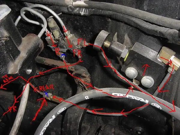

I’ve converted my 68 manual front drum setup to a power disk brake setup. I’m looking for an original 68 power brake proportioning valve/distribution block. Anyone have any ideas where I might could find one and in working condition?

The distribution block (all the lines going into and out of) does no proportioning, it simply reroutes the fluid and houses the brake warning light. The proportioning valve in question can be better acheived by using an adjustable one made by wilwood or whoever. They run $50 and you simply put in inline at any point between the distribution block and the rear "T" at the rear axle.
