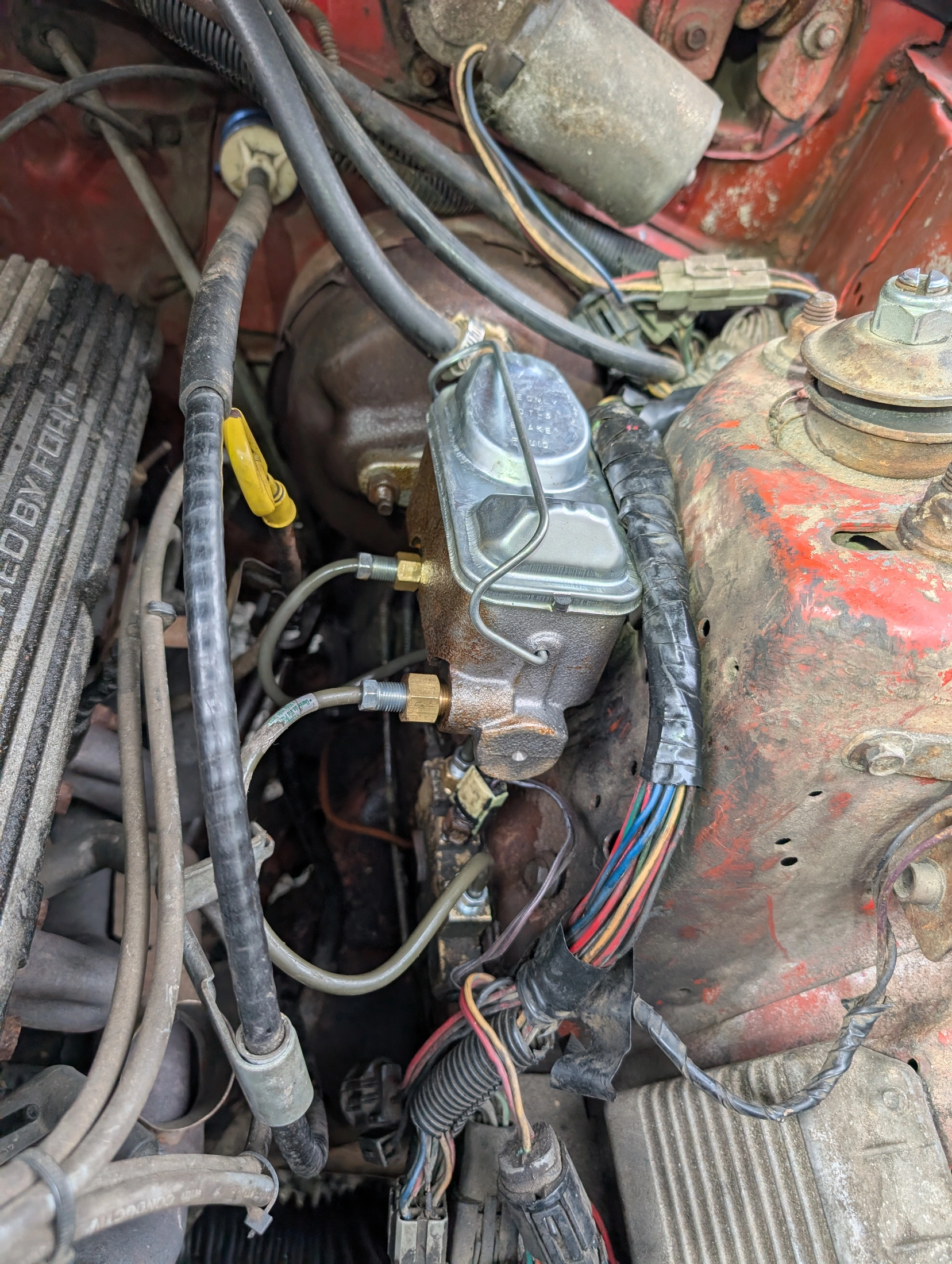

So I definitely think it's the master cylinder. Went to go change it and broke the brake lines going from the master cylinder to the proportioning valve block. I have gone to O'Reilly's and AutoZone and they both weren't able to get the correct fittings.
Does anyone know where I can get brake lines that will fit?
Thanks in advance,
Alex
Never seen them sold separately.
Are they part of this kit??
You may need to make them. Fitting sizes on the MC are 9/16-18 and 7/16-24 and both are inverted flares.
I agree the primary is 9/16-18.... but could the secondary be 1/2-20, not 7/16-24??
Reference:
SOLVED
So thanks everyone, it ended up being the brake master cylinder. I ended up finding a guy at an O'Reilly's that wanted to help piece together parts for new brake lines from the master cylinder to the brake distribution block. Ended up going with 1/4 lines and some adapters. It was the only way we could get it to work.
