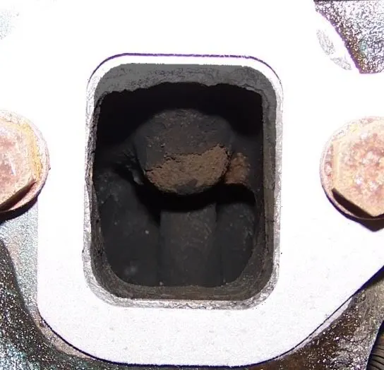

Must be a Chevy guy. As long as the crank, pistons, and rods are not worn out, they should be fine.
If you are doing this upgrade, and using the OE iron heads, half of you potential improvement will be lost unless you grind out the smog pump bumps in the exhaust ports, and port-match them to your exhaust manifolds/headers. Stock Ford SB exhaust port were horrible, even on the 289HP. This will add 2-3 hours to your upgrade. Well worth it.

I meant your mechanic buddy, not you.
With inspection and shot-peening, stock 289 rods with good bolts are good up to 7000 rpm.
As long as the bottom end is in good shape, your intake and cam will not be a problem, unless, of course, the new power causes you to drive the tar out of it.
I wasn't kidding about the port-matching, you'll be glad you did it.

stinger86 said:
Well in that case he is . what are OE iron heads. Anything to do with the iron forged or are they just normal heads?
Normal heads. And the ports are bad. Easily fixed, though.
The shaded area around the edge, and the smog "nose" inside the hole gotta go if you want performance.
OE stands for original equipment, otherwise known as factory heads. the factory heads are cast iron, same as the block. as indicated the exhaust ports are quite poor, but with a little time with a die grinder, you can open them up quite nicely and gain a lot of airflow through the ports, which will aid in power production, and improved efficiency overall.
