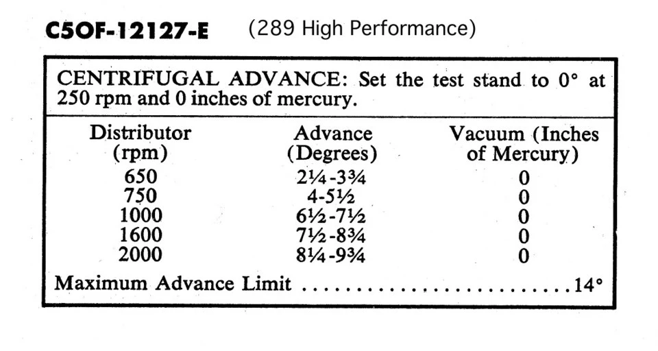

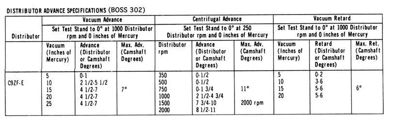

I have done many distributors, and I have never seen a distributor that was within factory limits. Never. Reman are usually worse than used ones, because they are put together from odd bits and pieces. Getting your distributor recurved is by far the best choice. If the wires are shot new OEM style wiring is cheap. If your distributor is way off, this will possibly give you more power than a 4V carb. Of course if you also get a 4V carb, you'll hardly know it's the same engine.
I became a believer early-on, when I did a 70 351C 4V distributor. Car was a dog. Guy did the whole tune-up. Dog. Got a "correct" carb, professionally built. Dog. Had 3.90 gears installed. Faster dog. I reset his distributor to factory spec curves, and he can lay down a double-streak of rubber whenever he stomps the gas. No other changes.
Everybody yaks about "total advance", but it is only a tiny part of distributor timing. It's really complex. I once did a 67 GT350 distributor that had the "total advance" thing nailed. Except the springs selected for the job produced the "correct total advance" at about 800 rpm. Car ran like crap. I recurved it to factory spec, car ran like a champ. No other changes.
Here's a sample of the complexity of distributor timing. The first is the relatively simple C5OF-E from that 67 GT350. The second is the C9ZF-E BOSS 302.

The BOSS specs are an excellent starting point if you are using a vac/cent advance distributor on an engine with an upgraded cam.
