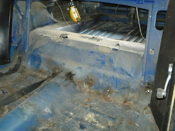

Got the old 302 out and all the interior except the dash support. Passenger side floor needs some help and the subframes don't look very good but other then that it's pretty decent for being 41 years old. I forgot to take my laptop so I will have to wait till Dad emails me the pics.

Some pics

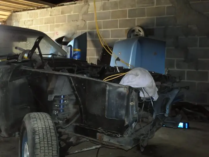

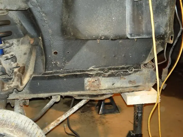

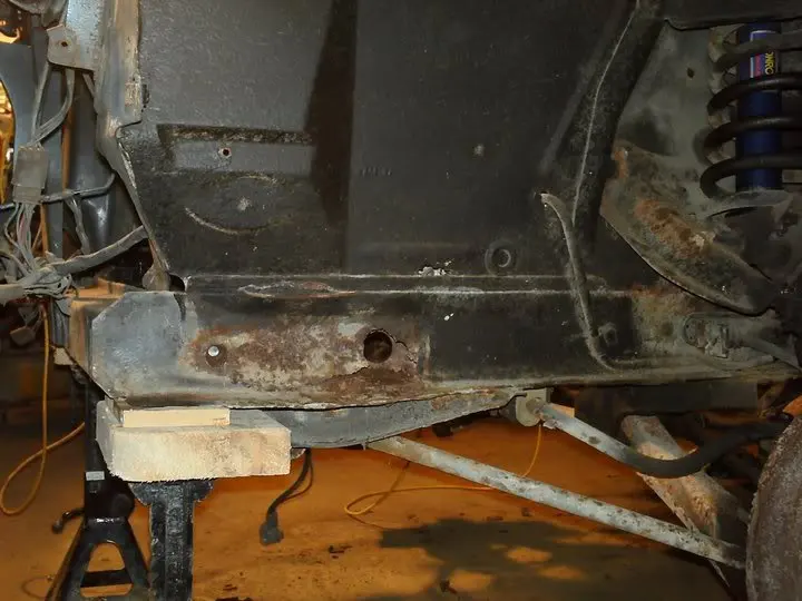

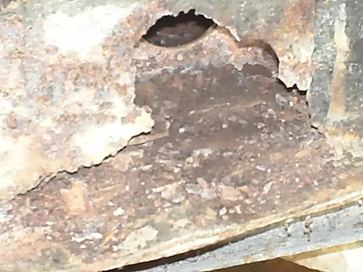

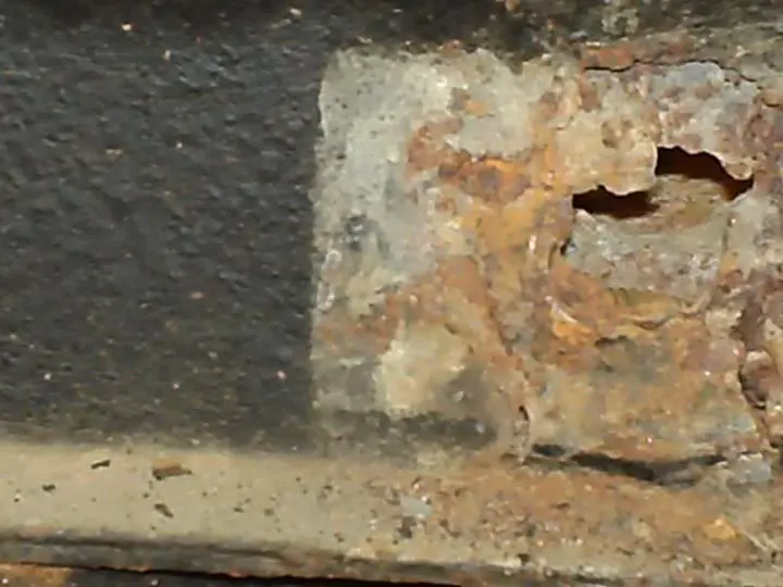

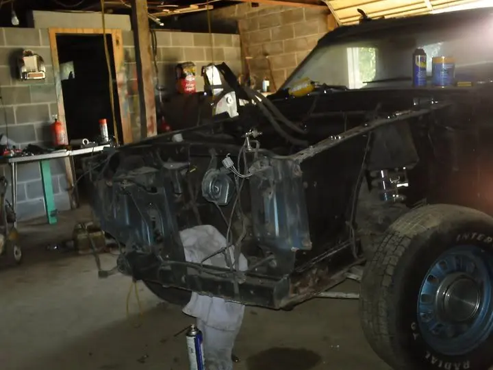

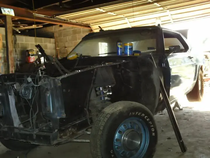

We took off the fenders and bumper and found out it was wrecked. Passenger-side shock tower is welded/bent and the bolts to the bumper bracket weren't factory(on the passenger-side). Hell the one bolt didn't even go the whole way thru the frame-rail. More bad news there too both sides are badly rusted were the bumper attaches to them. This is turning into a lot of work which is what I expected.:jaw:

this is the side that got hit, where the 2 bolts are it bulges out and the silver/unpainted part on the framerail is a welded on plate
the nice side
close up of the passenger-side framerail
close up of drivers framerail

We leveled the car and put it on jackstands. We only have Fridays to work on it so it is going to be a long slow process.
