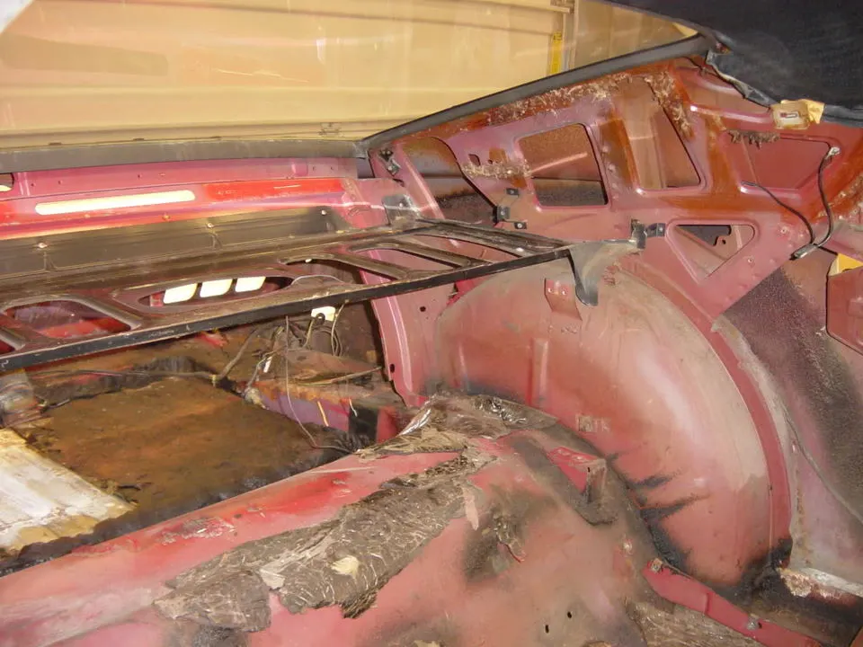

Thanks for the post Rumbles. My 69 FB was missing the sail panels when I got it. So ordered new ones. But cant find the hockey sticks that hold the bottom in. Anyone know the real name of the hockey sticks and where to get them.
I can't be sure, but I think Dynacorn makes a repro set, #M3548P, that includes the two pieces you describe, and the two rear corners. You can order them from Glazier Nolan, but GN might also have used originals.
