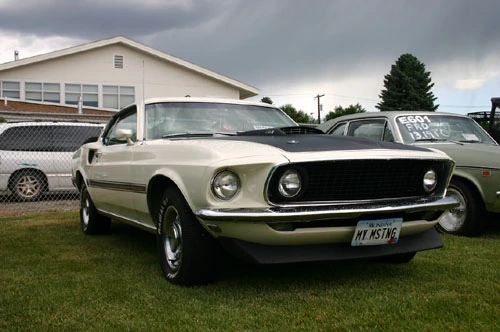

Hi all, great site you have here. Good tech resource except that I couldn't find an answer to my specific question in the archives. I'll give you all an intro before I get too carried away. The attached picture is my wife's 69 Mach 1, 351W A/T. It has been a great car and has been her daily driver in the past (soon to be again).
