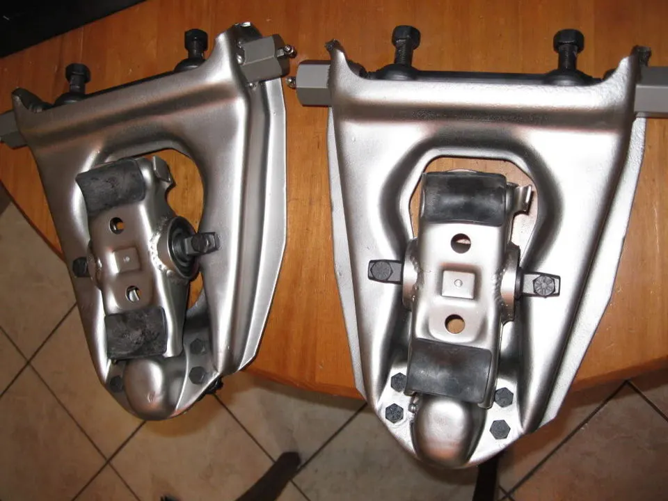

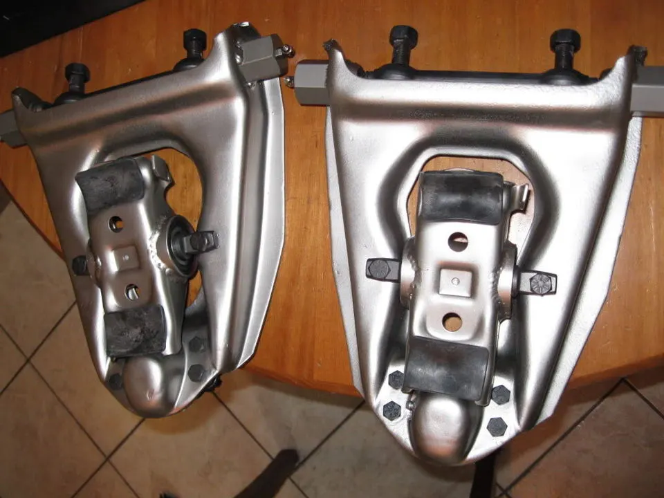

i rebuilt my uppers. i did some mods i had read about involving grind a slight groove through the threads of the control arm shaft (improved greasing) and welding the nuts to allow for no-binding through the range of motion.
i'll never really know if it made any improvement or not besides how free it felt moving it up and down.
also made the roller perches (not convinced those will really make a difference either).
