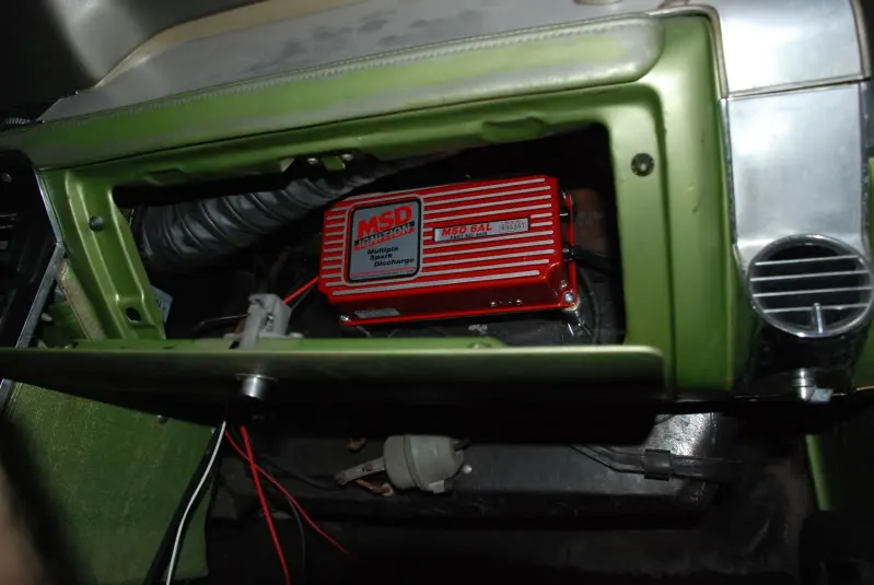

i mounted mine inside the car
P
pyroman
Jul 28, 2002
480
18
Ennis, Texas
May 24, 2009
  • May 24, 2009
Yup glovebox for me
