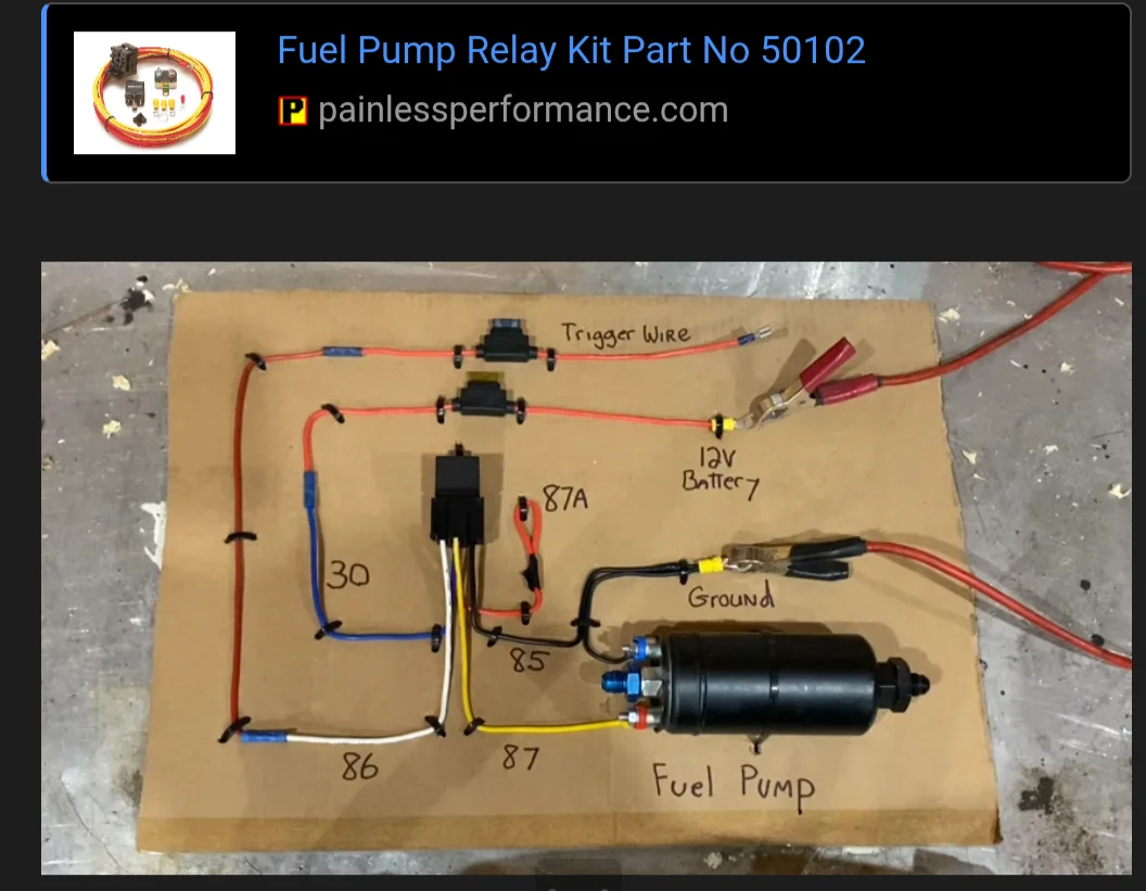

No as in the video I shared it mentioned you can run instead of putting a circuit breaker, you can put a fuse between the wire that's running from the battery to the relay.
Just looking at the picture he explains about four different ways it can be ran. So the way you described, everything that's in this photo is not necessary just so you don't think I'm talking about needing to run everything that's in this photo I was specifically asking about instead of a circuit breaker just to use a fuse. Maybe you mentioned putting a fuse on that wire.

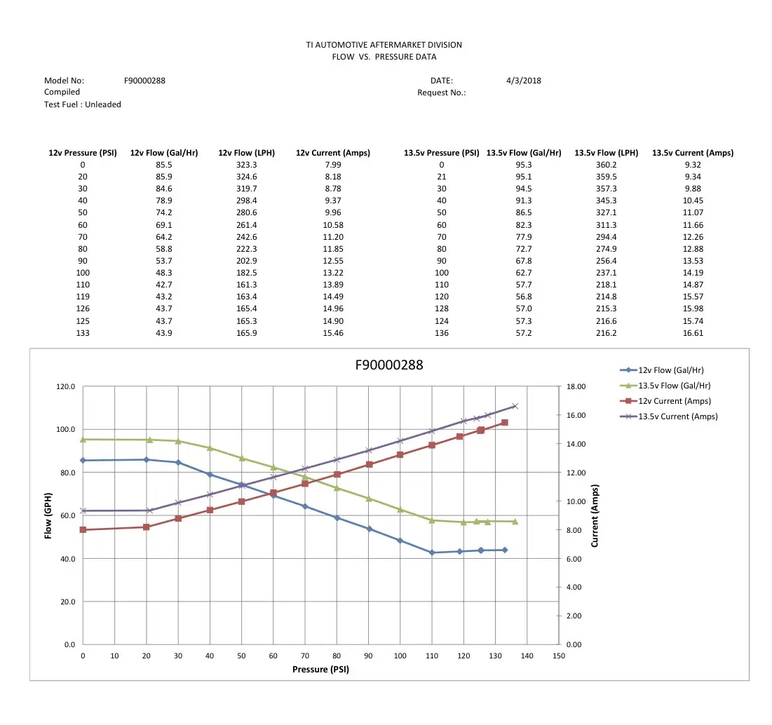

So if we are talking a Walbro pump here is the chart that shows output pressure, flow rate, and amperage draw. The values are shown at 12V and 13.5V.
Let’s just assume a 39 psi base fuel pressure and 15 psi of boost. The pump now needs to put up 54 psi of pressure to compensate for the additional manifold pressure from the boost. With that I would want to look at 60 psi and remember I’m an engineer by trade so I like safety factors and making things way more complicated than need be. I would also set the circuit up for a 13A maximum draw as the pump chart shows a maximum of a 11.66 amp draw at 60 psig at 13.5V.

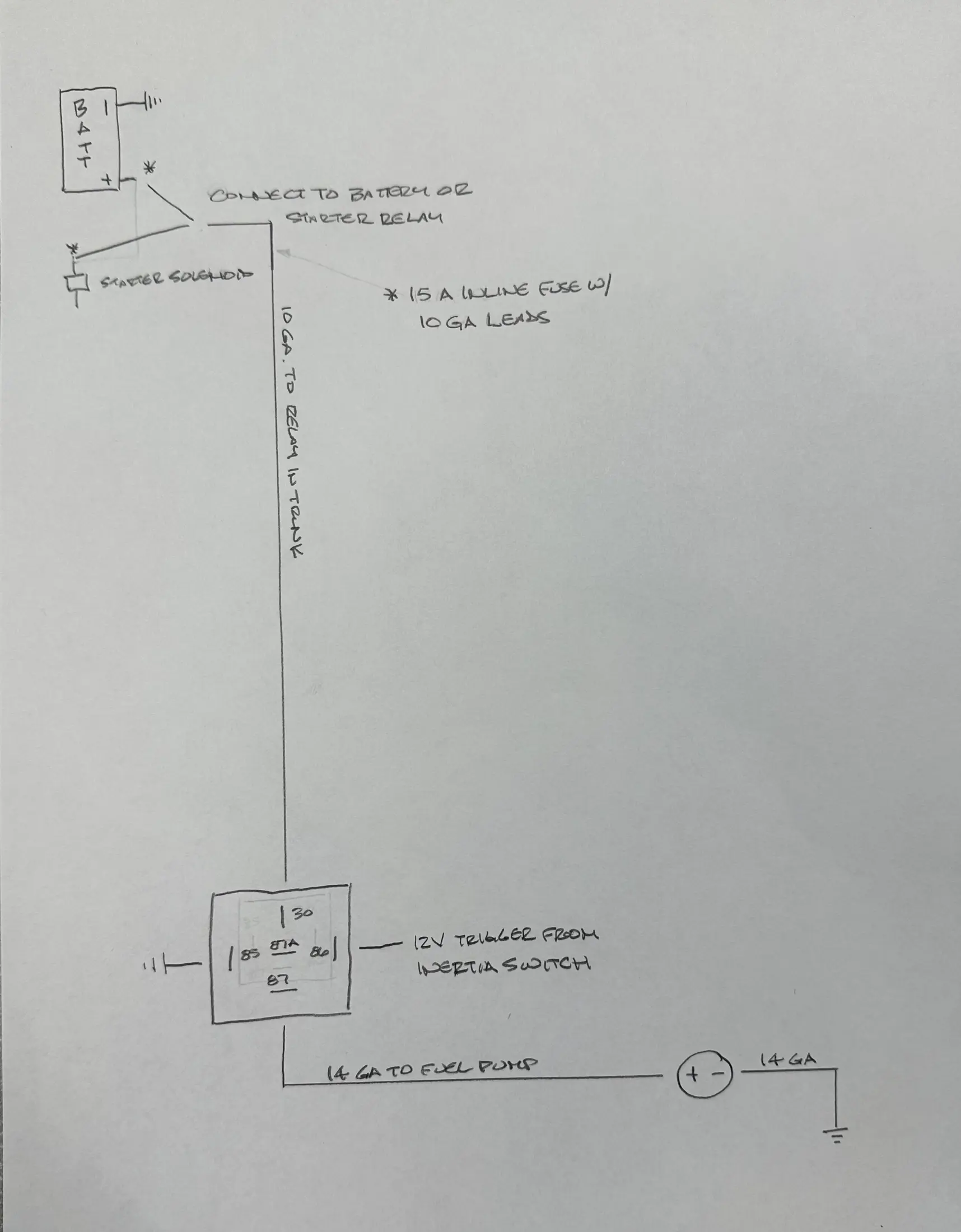

Assuming a 15’ run of 10 gauge (ga) power wire from the battery to the relay with an inline fuse holder (inline fuse wiring should be 10 ga wire as well) with a 15 amp fuse. From the relay to the pump would be around 5’ so you would need 14 ga wire for that run. You should also ground the pump with a 14 ga wire.
I ran 14 ga on all of mine as I already had 4 ga wire in the trunk for the car audio and it is way oversized for what I have so there was plenty there to power the pump.
Insert crappy wiring diagram here:

Appreciate the insight and taking the time to make a drawing.
I guess those saying 10 gauge all the way to the pump was not taking into account the inertia switch and it was probably Fox guys. Unless they were talking about going 10 gauge to the relay and then out of the relay to the pump with 10 gauge.

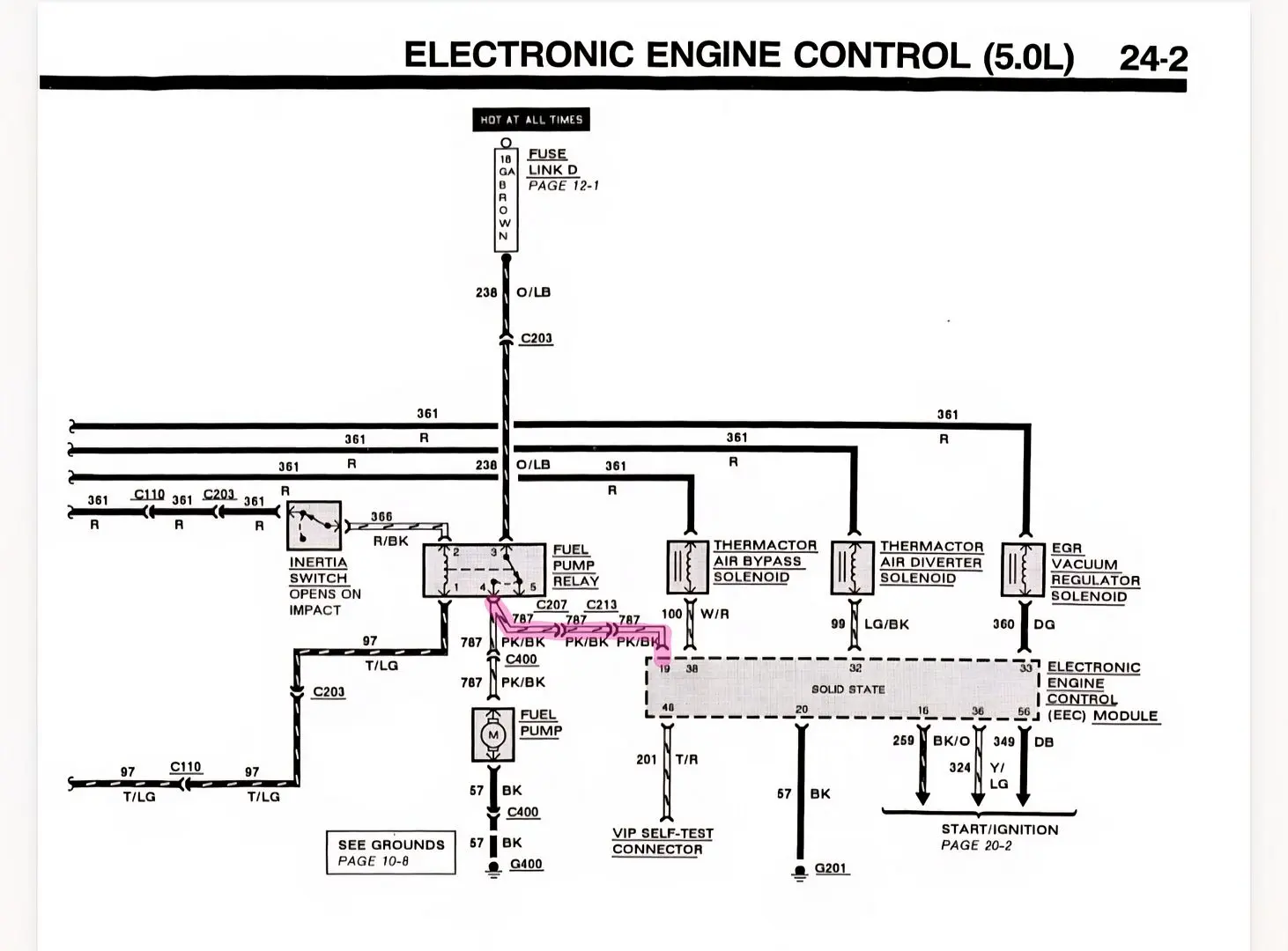

With the OEM hanger and grounding the pump with 14 gauge I would simply have to splice in to the harness connectors ground and reground it?
Some also believed to just bypass all of the Ford harness connectors as well but that would be definitely complicated for me to have to rerun all of those 4 wires that's in the harness connector. Maybe it's not that serious and most people's eyes to bypass those connectors but just to upgrade the wiring?
No... You saw the [new] relay above? That relay closes the circuit to send power right from the battery to the pump. The 12 Volts at the inertia switch now has the sole duty of triggering that relay. It doesn't need to support anything more than a few mili-amps.

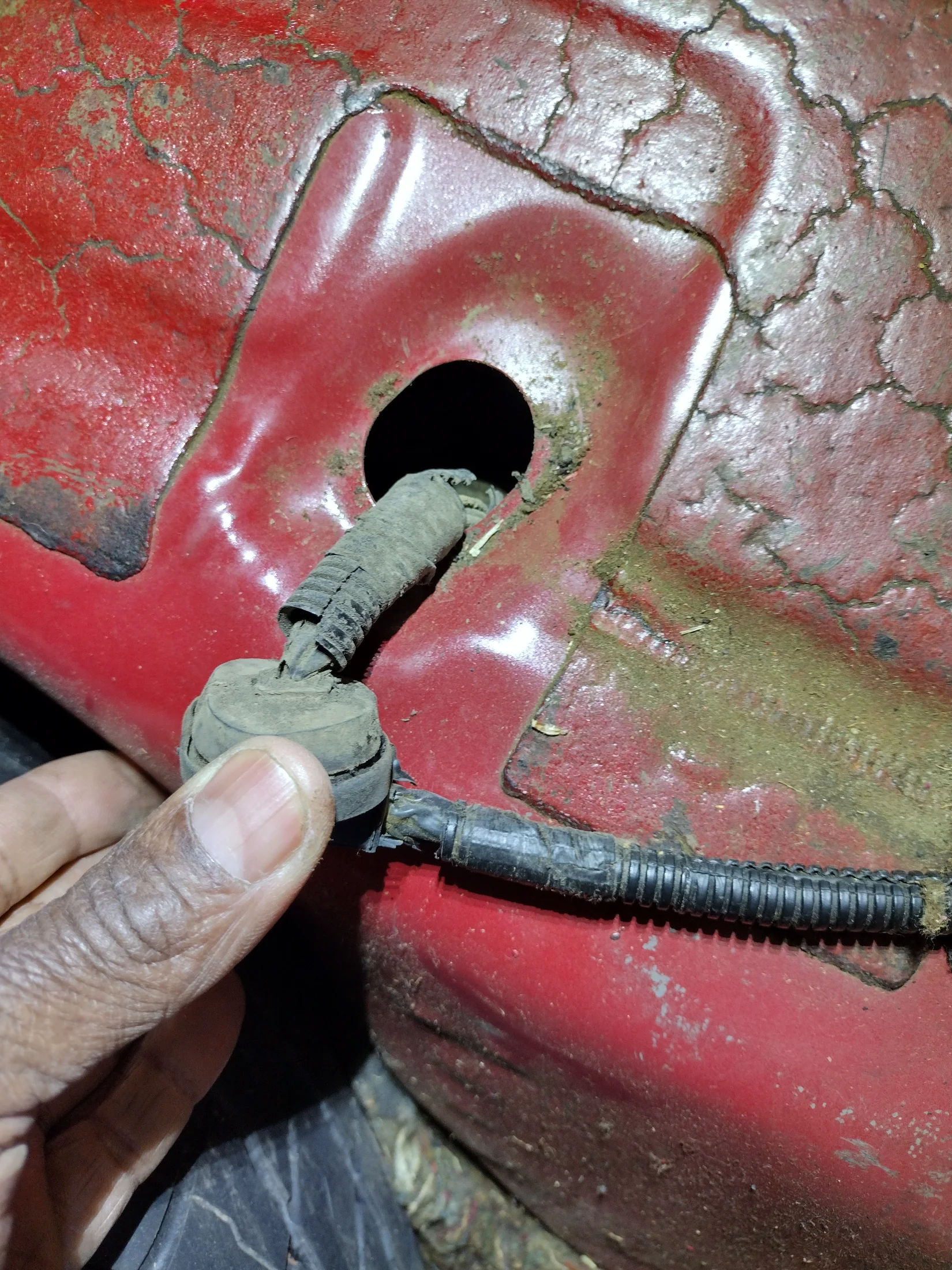

Did you say I can check volts at the inertia for WOT or does it have to be specifically a little bit lower down at the pump pigtail?
Up on further review taking a picture it looks like I have to go after that junction. Now upon a second review and I remember reading where the brown and purple connects to the black and purple wire. They connect at the pigtail connector of course and so do I need to go after the pigtail or does it matter?

By the way upon my test last week, I was able to confirm 12 volts at into and out of the Ccrm. It is very tricky to use the safety pin or something else that will fit in to back probe because you can't always get the probe of the meter in depending on angles and such of where you are probing. So it seems all of that stuff is functioning and the fuel pump is receiving 12 volts everywhere it is supposed to including at the pump.
I plan on dropping the tank this week to check and make sure I don't see anything glaring as to why the fp would be 8 psi lower after driving the car on a 20 minute trip. It's not like it is dropping suddenly all of a sudden either, there's no fuel leaking from the regulator, and the fp after the car is cut off is decreasing at a normal rate, not straight to zero. When the fuel pressure was at 22-23 ( At startup it's 30-32) I wanted to test WOT and see if the fp increased and it did by 10 psi and the A/F looked fine at 11 plus to 12. So I will see what I see at the pump when i remove it this week. I want to verify there is no issue inside the tank and eliminate that.
I've researched a lot on cavitation and fuel boiling and low voltage and such and it doesn't seem that the car is doing anything in a negative way reflective in what those things would cause or how the car would run as a result. The fuel filter was changed not long ago before the SC install and had to be less than 10k miles ago when I put the engine out of my other car in the '94. It seems if I had a filter issue it would be doing a whole lot worse than the little things it is doing which is initially when I take off for the first time it will hesitate and jerk a tad a few times before it levels out. It has a little miss in low mid and high rpms but it's not herky jerky the way it was prior to the most recent distributor swap. When I start it it starts fine but idles sort of like it wants to cut off sort of for about the first 30-45 seconds and as it warms up the tone increases and it sounds more like it should.
After I have verified the rest of the things on the list the last thing after I put new wires and dizzy cap and rotor, I will likely drive it to the tuner for him to check/change the cold start fuel tables/trim, ect as that might be all it is in that regard. The few new items just mentioned might be the slight missing, maybe. Overall the car is driving much better and I want to verify that the fuel pump and hose ect is fine. Get all of those things sorted and back to the tuner if need be after those things and it should be fine. I will do the wire upgrade at some point too but these things i must eliminate and make sure all these things are up to par.
Also from JRicher' quote, i remember the tuner saying somethign to the effect of that if the fuel pressure is showing a certain pressure on the gauge as long as it's not crazy crazy low and if it's increasing during WOT and the A/F is fine, I should be fine but I will ask him about all of that again a I update him after all of these things. He saif if he tuned the car and the fuel pressure was like that when he tuned it and which he had to back off fuel because it was getting plenty of fuel, that if it was tuned with those pressures then I should be fine.
Well it seems the brunt of my issues was the fuel pressure itself. I bought the fuel pressure up from about 26 to 31 and that's after I had already driven the car about 20 minutes. I knew the next day when I started it the fuel pressure would be higher and it was 43 44.
After the car warmed up and I took off driving it was about 39 and after about a 20 minute drive it was around 31 to 33. The lowest I've seen it was about 27 but the car drives a whole lot better and the missing is very minimal and tolerable as opposed to how it was when the fuel pressure was only around 34 to 36 at startup. I'd say the fuel pressure after the car is good and warm and driving it for a while seems to be on average around 31 32. Not sure I need to adjust it to where when it settles it will hold around 39 so that would mean that at startup it would probably be around 50.
I will call the tuner on Monday and see if he wants to tweak some things after all of the little changes that I have found and made and tested, etc. overall right now I'm just going to drive the car and enjoy it, button things back up and stuff put things away put tools away and just drive the car and enjoy it right now.
