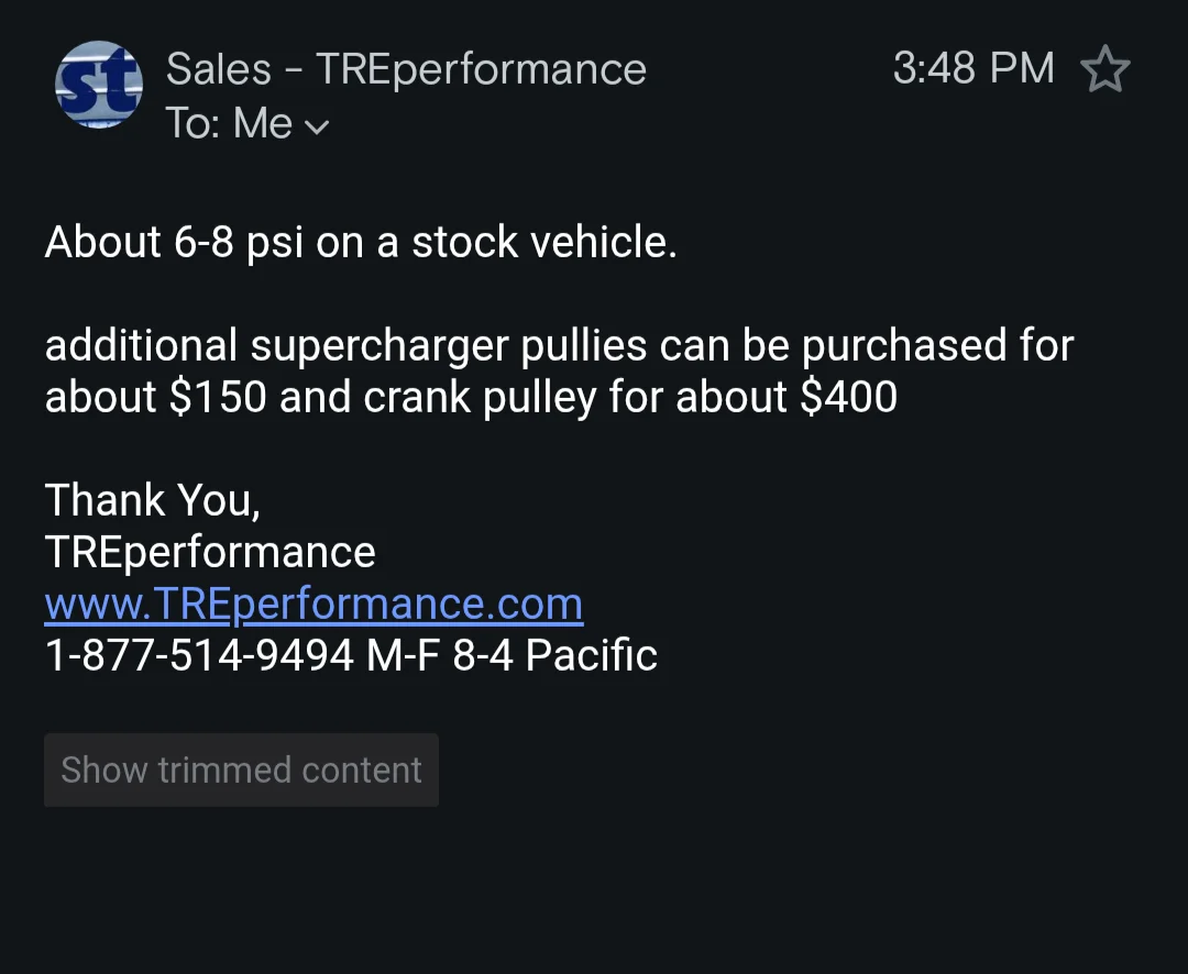

Quick google search shows 5-8 and I emailed Tre Performance to ask. I read one thing where someone said Vortech claims 10.5 so by the time I buy I i will confirm.

Dang. Pullies are that expensive?? Asked them the V3 psi
I might be fine with 6-8 :D
Is it more based on my car not being stock?

I sent tre performance an email asking if with my modded car if it will be more PSI and was told it would be less :oops:
Correct. Boost pressure is a side effect. The better your engine processes air, the less boost you get.
Even so, the HP on the better breathing engine will be higher than the lower breathing engine even though the P,S, and I's read higher.
It's that pesky pressure vs. volume thing that I refer to all the time. We had a similar conversation about fuel pumps. :stick:
