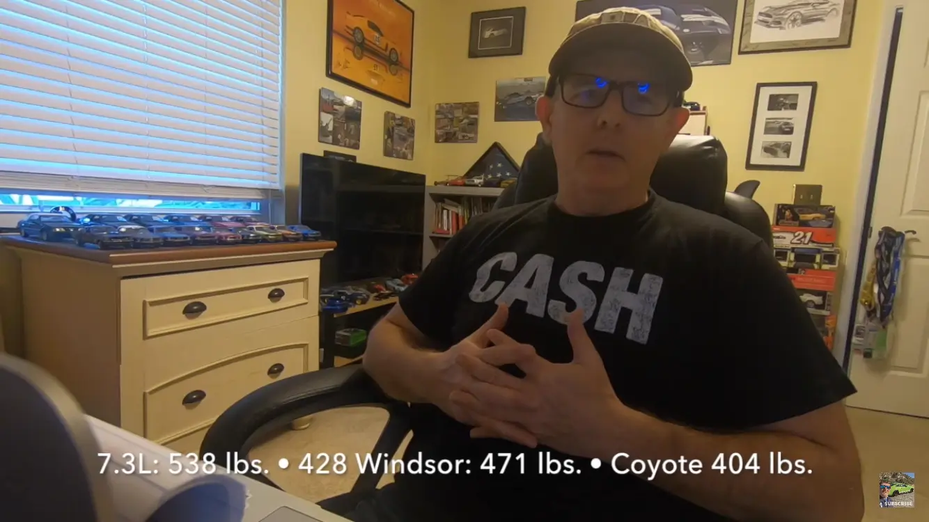

Well, here’s a negative for the 7.3
It’s heavy. Latest vid on YouTube from Evan smith
That's actually a littler heavier then I was thinking it would by about 40 lbs, but not surprising. That's why I have been looking at this engine as a drag race or street only motor compared to the coyote. On my 89' track build an additional 134 lbs would be a huge hit to weight balance.
