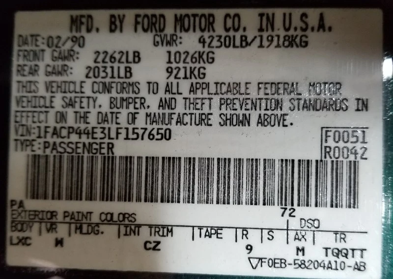

Production of these cars started in December of 1989, with only two cars being built. Full production began February 2, 1990 with the final car being built May 29, 1990 so your build date must be within this time frame for it to be a real 7UP. Here is my door tag. Build date 2/90

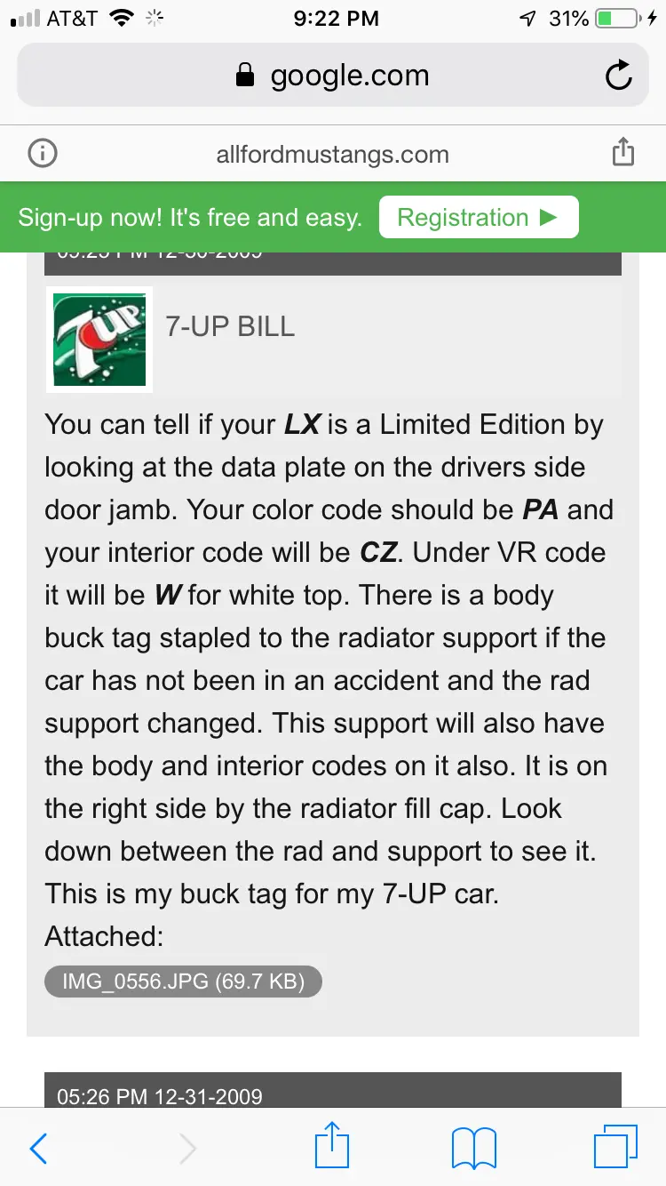

Does the VIN start with "1FACP44E_LF" (1990 5.0L LX convertible) and is the paint code on the door tag and buck tag "PA" (Deep Emerald Green Clearcoat Metallic)? Then it is a 'Limited Edition LX 5.0L Convertible' aka "7-UP".
