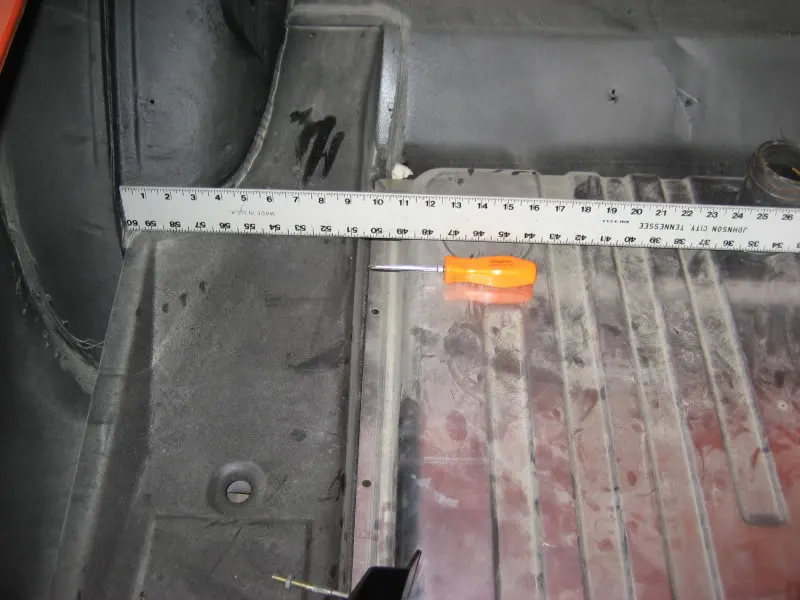

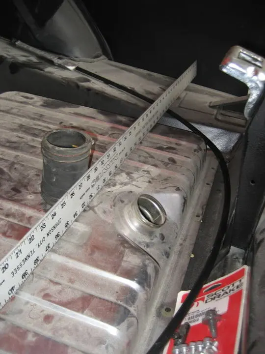

Here are pictures of my '70 tank in my '65:
That #1 phillips screwdriver will almost slide under the straight edge.
It's almost flat here, but I wouldn't call it flat.
When I had an IASCA competition stereo system in the late 1980's, I had installed a flat floor. The tank wouldn't of interefered with me doing it again, but that's a long way off right now.
I cut it down the stock neck the exact amount the tank was higher. It doesnt line up perfect, but it's close. I'm understand I can re-align the neck with two jack handles but I haven't done it yet.
