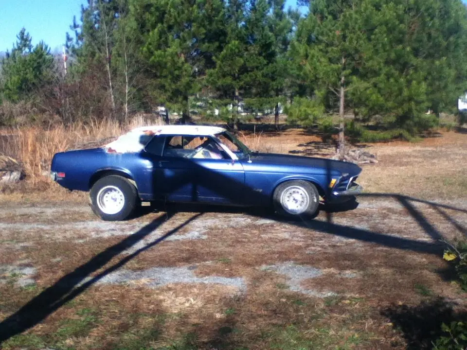

this is what she looks like now. Put new wheels on and washed her off. gonna strip the body and inside soon to get it sand blasted then prime and paint. and will hopefully get all that done soon.

I'd go with the 95 351W, more torque, and most of the 5.0 parts will work. Shouldn't be much of a problem getting the hp you're looking for. The only thing I'd recommend at this point is to take an honest look at what you will be doing with the car. A fun cruiser that will smoke the tires all over the place, and a drag race car are completely different builds. Mine is the cruiser, lots of torque, but built with gas mileage and dependability in mind. I learned long ago that driving on the freeway at 5000 rpm isn't a good time. But this is for you, and everything goes a lot smoother with a plan.
