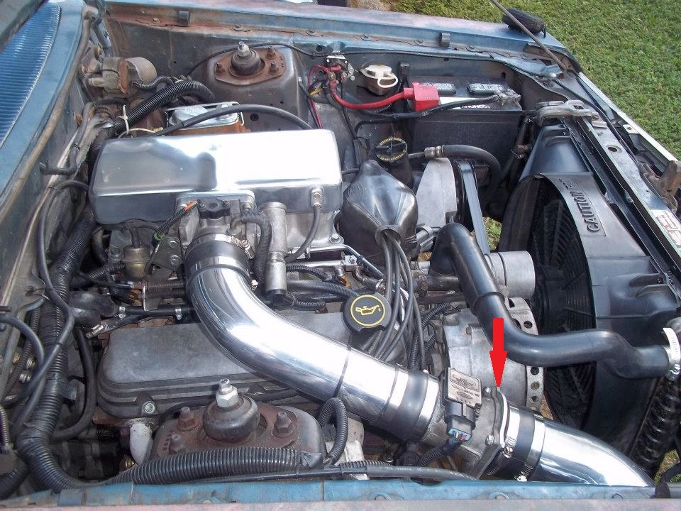

When we got our u-pull MAF, we also found an SN95 v6 (iirc) with a cold air kit, that had been wrecked in the front.
One of the parts of the cold air kit that wasn't damaged was a piece of aluminum tube with the flange that bolts to the MAF.
So we took that scrap of aluminum as well, and cut the tube off close to the flange, bolted it to the MAF, and used the little stub of tube left on the flange to put our intake hose over. I think you can buy adapters, but this was dirt cheap and easy for the exact same thing.
