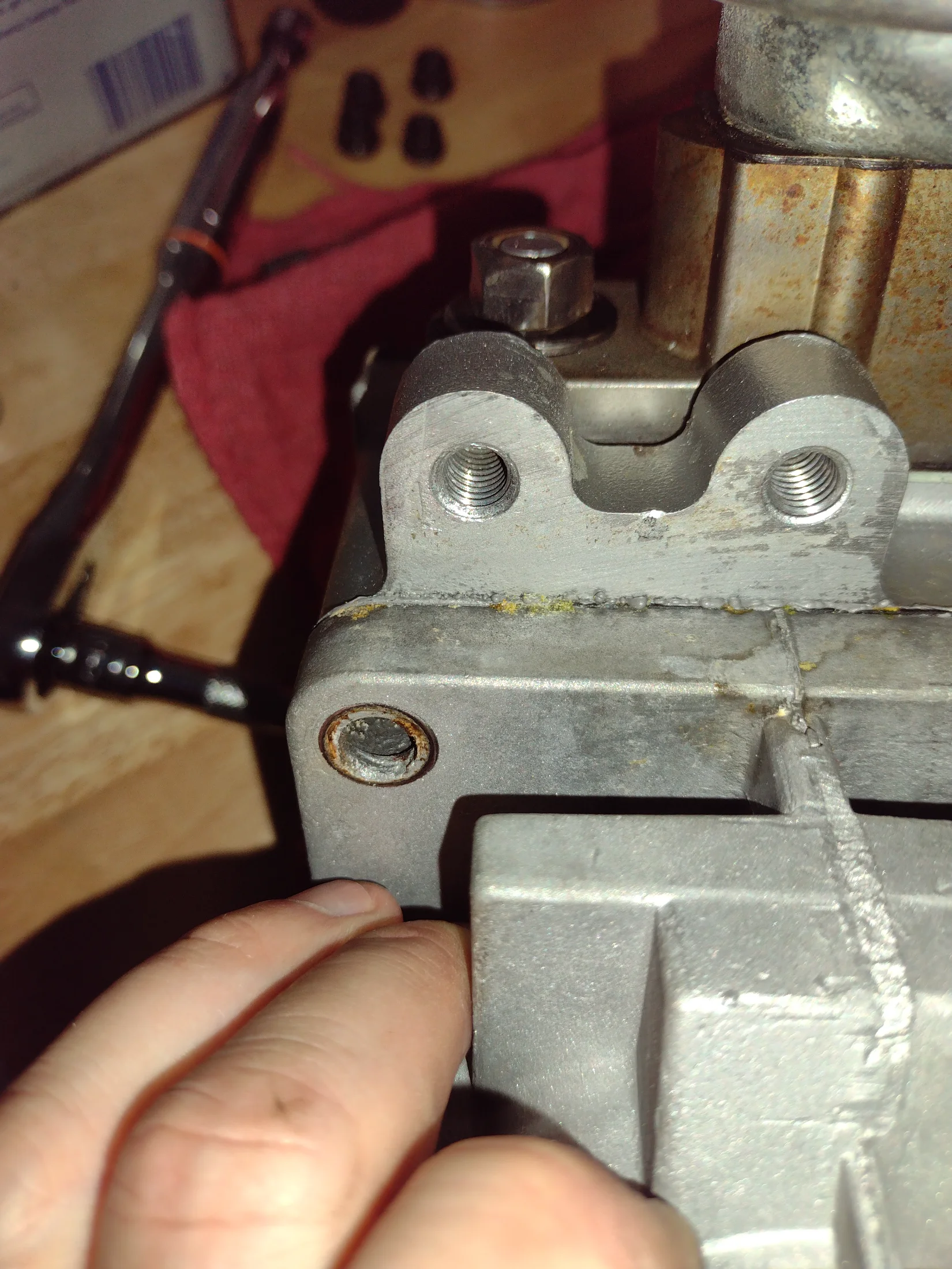

So I'm in the process of replacing a lot of stuff during the winter months on our 90 7 up convertible. The whole intake manifold is off the car right now.

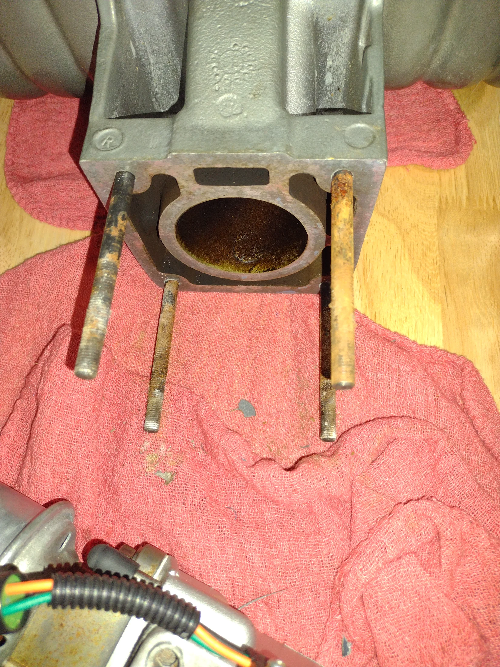

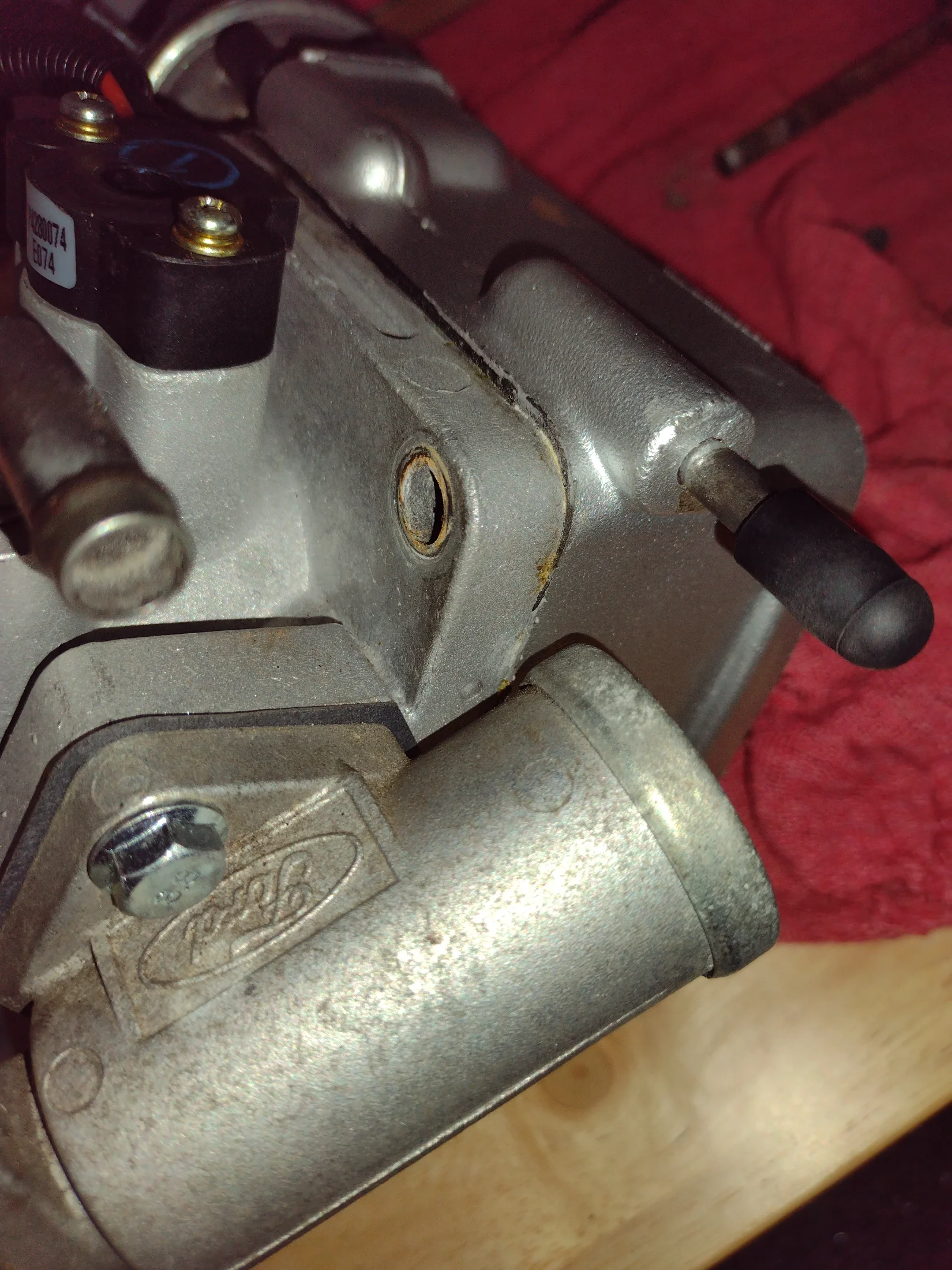

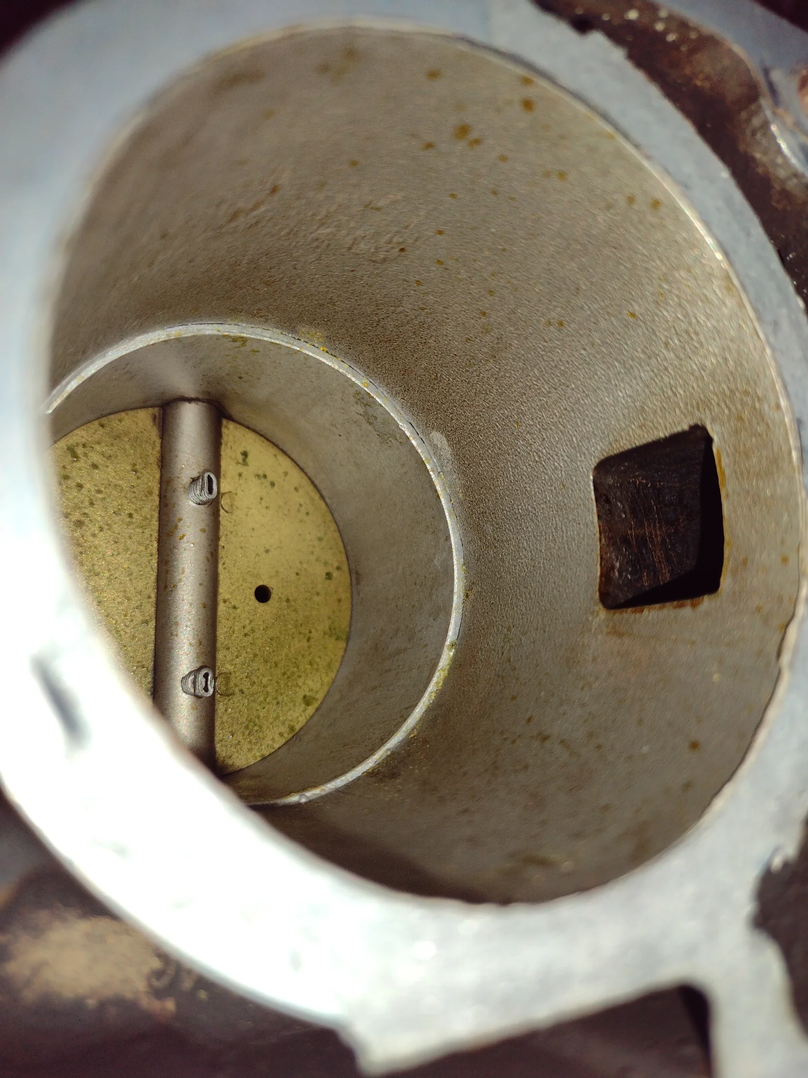

Ever since I ditched the bbk 70mm throttle body I've dealt with coolant leaking between the stock EGR spacer and throttle body. The parts I bought were used. I'm assuming something isn't square. These manifold studs are trick flow and I put these on less than 2 years ago. Assuming it's not normal for them to be rusty? Maybe put anti seize on them?
Either way, I'm seriously thinking about buying a accufab 65mm throttle body and a pro m MAF sensor. But seems like a waste on a otherwise stock car.
And I don't feel like ditching the EGR....
Thoughts?
Edit: you can kinda see some coolant on the outside of throttle body by gasket.

You need to run a straight edge over the TB, both sides of the spacer, and the upper intake and make sure it’s all flat.
You say you got rid of the BBK 70mm TB. Did you go back to a stock TB and continue to use the BBK 70mm spacer?
