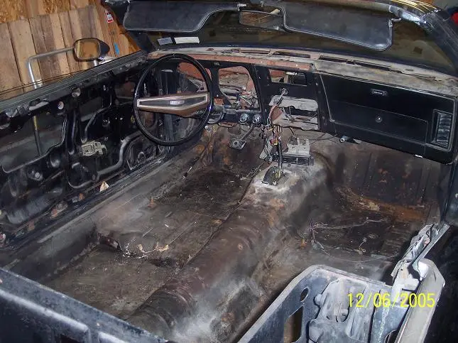

Did you think about painting it when it was right in there? I took out the dash pad, center guage thing, speedo/tach, and its trim peice. Then I just masked stuff off and painted it with Krylon Fusion satin black. I really really reccomend this stuff, it worked amazing. the dash looks brand new. Just mask off what you dont want painted obviously, and paint it just like you would a car. Really quite easy. Here is what i stripped it down to, when I can find a picture of what it looks like now I'll attach it
