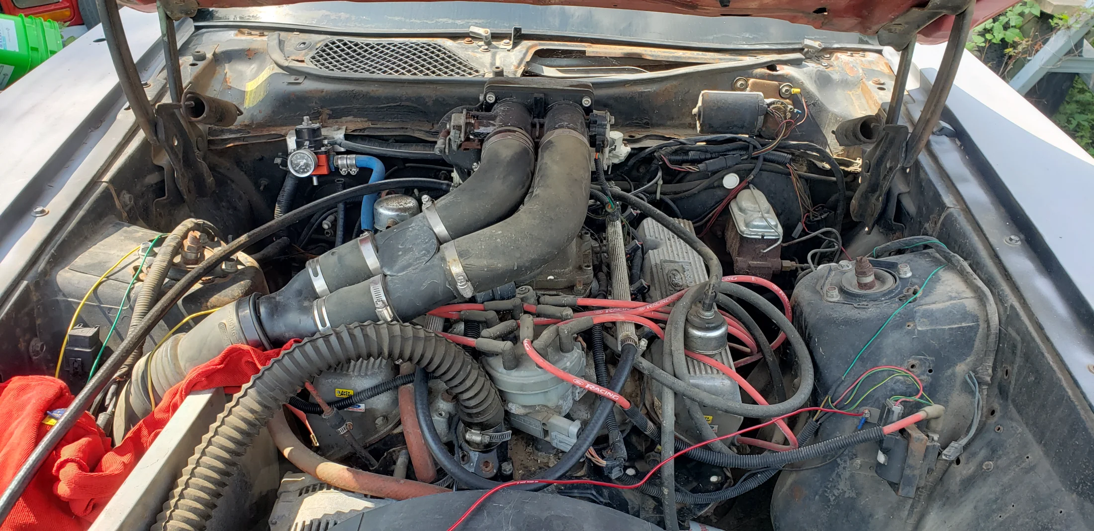

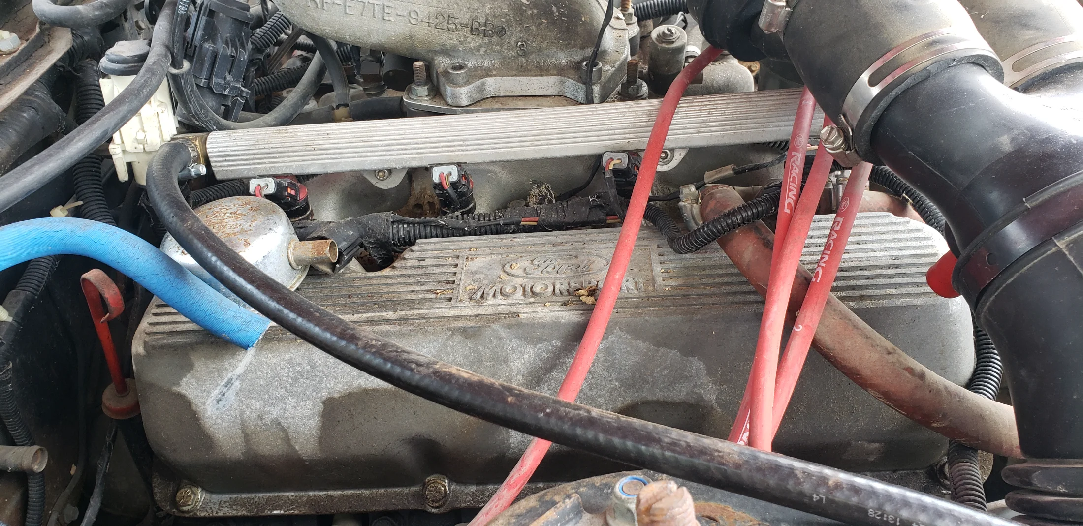

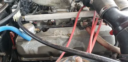

not sure where to post this but I have a 73 that someone other tan me have updated with A9 box along with a home made ( very well done ) port injection with and older truck snorkel is what I call it going in to 2 large throttle bodies down to a large single mass airflow ! that being said I am lost we had it running after new fuel lines and pump ,new brakes and hoses ,made lights work then drove it around a little then one day I backed it up and parked it later my son went to start it and no start just turns over . well I do not even have a signal to my test port , now the big kicker every wire is red that they ran so we have taken dash apart and traced what we could so far but I have no clue what powers A9 or what sends signals out also I have power at pump and injectors just nothing going out I guess you would say . if i can find out what I need out of the box I may can figure it out but if not I have a new manifold and carb waiting in the wings this is also a built 351C with a manual valve trans and double shot , tubbed, narrowed 9 inch with Art Morrison 3 link looks to have been built in late 90s and help wold be greatly appreciated also it has high volume mustang fuel pump in take so I will need to drop pressure to run carb somehow
Sounds like a 5.8l from a Ford Truck engine and intake. You might what to try and pull codes from the ECU. How to do so is all over the internet. I remember Autozone has a loaner code reader. That will make it easier. Otherwise, advise is just a shot in the dark. Good luck.
no its got a weiland excellerator with bungs welded in it
thanks but I can't read any codes because no power to port but at least
I have a direction to go with and I have a battery disconnect would that not work to clear ?
I shared the post as it has the wiring diagram for the ECU pin connector, that way you can chase what is powering the ECU to determine what the problem may be.
if I have power to my fuel pump would that come from pin 1 ?
Going from that diagram, pin 1 should power the ECU as well as the relay for the fuel pump. So when the key is turned, it should power both. If you have power to the pump relay but not the ECU, I'd say you have some kind of issue in that section of the circuit. Maybe a blown fuse if they installed one? Grounded wire? Someone can correct me if I'm wrong as I am not, by a long shot, an expert of wiring, but I think pin 19 would trigger the relay to power the pump. But I suppose it all depends on how the previous owner wired everything.
