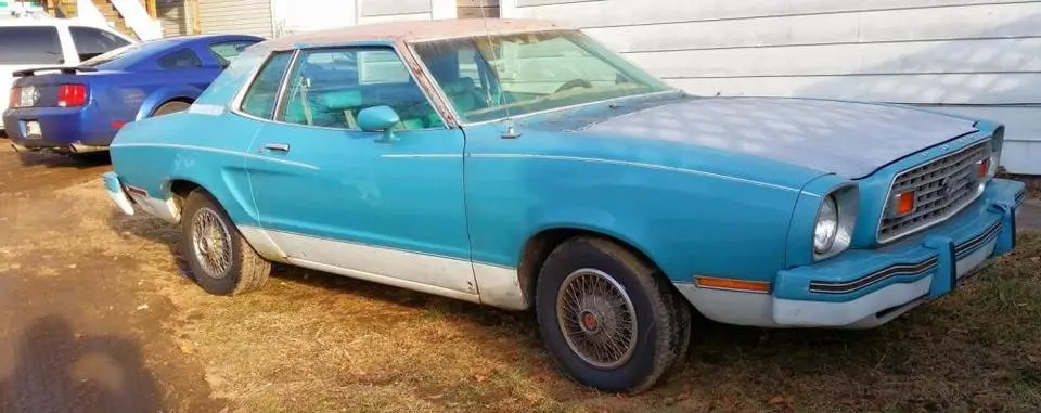

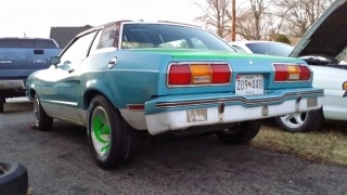

So I would hit craigslist and eBay on a regular basis now and one day I saw this 78 coupe, and thats what I wanted, a coupe, not a Gila, not a Hatch, but a plain old coupe, went to see it and bought it, I call her Pip Squeek.
And it starts, the front tires where dry rotted bad, so went to eBay and found a set of 15 inch wheels, got a pair of BFG white letters and the plan was put them on the back, move the good 13s to the front and drive it and play with for now, the car is at a buddys house cause I didn't want to drive the highway with those dry rotted tires, I needed to fix a knock that I thought was in the valves, unbenounced to me, there was a radiator leak, I replaced the radiator and started the car, ran it for a while and it started missing and carrying on and smoking like crazy, shut it down and realized it had run dry again, the temp gauge never moved, found the wire and it had been un hooked, plugged it and pegged the temp gauge, blown head gasket, OK already too much money in the 4 cylinder, time to accelerate the plan, time for the V8, oh by the way one of the front tires blew out setting in my buddies drive way, and I don't mean just went flat, it literally blew out, the hole is like 1/4 around of the tire LOL.
And yes I decided on in your face green for the car, you will see test spots on the car soon

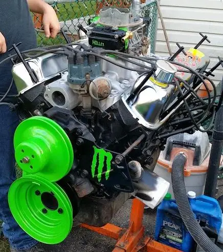

So the original plan was for a crate motor, but money went and got in the way, didn't get back what I thought I would from our good old Unk Sam LOL, so for now we throttle back a little, I found a good running 302 out of an 83 f150, according to the balancer it is a 50 balance, so I went online and got a 50 flex plate for it
cleaned it up and put a air gap aluminum manifold on it and a Holley 650 that I rebuilt for it and painted it up to match what the car WILL be when I'm done
that distributor is an old points and condenser setup {not sure why on an 83 motor} but it will be replaced with a new HEI distributor, and there are other engine parts setting in boxes just waiting for now

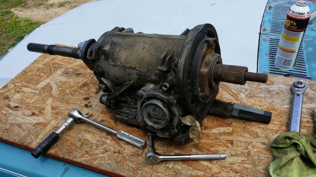

I found a 68 C4

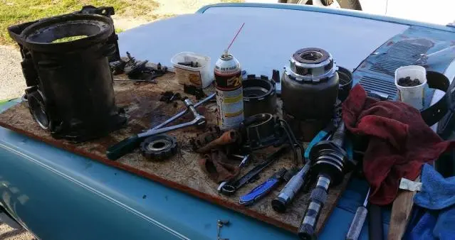

So I rebuilt the tranny
unknown to me a neighbor has a 68 stang and had extra parts but didn't know what as his car is a manual and he didn't think he had any automatic stuff, low and behold he had a 66 C4 that was all rusty and had a small bellhousing on it, I was having a fit finding one, nice guy, wouldn't take any money for it, Thanks Danny

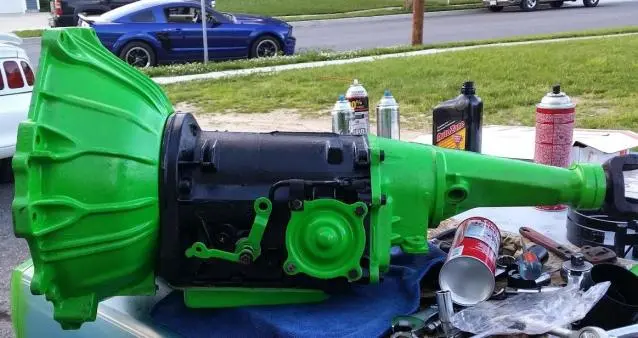

68 Trans rebuilt and ready to go in with the motor.

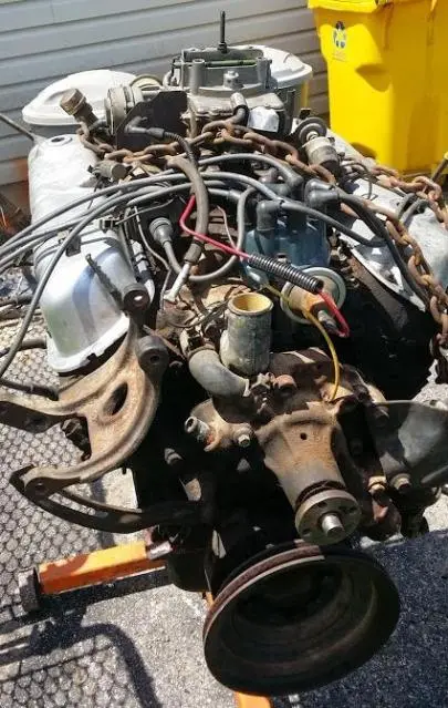

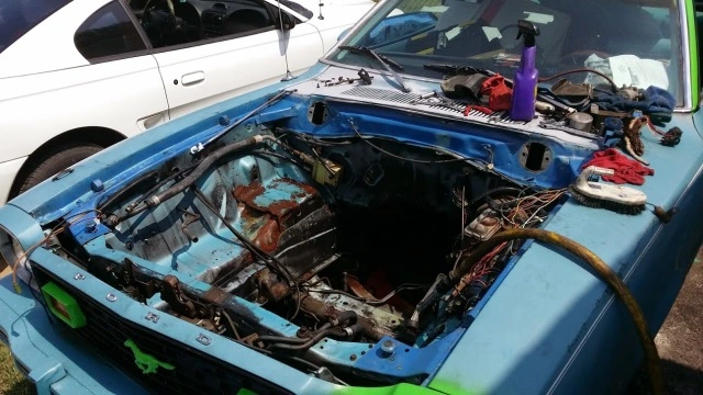

4 Banger gone, oh if anyone is restoring a 2.3, I have some good parts, I'm not sure about the motor, infact I have suspicions that it may have been frozen at some time some winter, but the trans is in top shape with only 53,000 miles on it, its a C3 so its no good to me, and the fluid is still quite red, I would change it and the filter and put it in a car and go, if it was usable to me, so if any wants anything let me know.

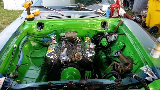

Now that looks better, we had it in and out 8 times but now its in
I did need to shim the motor 1/4 inch on both sides, and it fits perfect, you need only a small amount of room on the right side of the pan to clear the power steering, we are actually going to modify the oil pan next year when we get the crate engine and take out the shims.

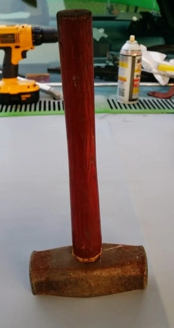

Oh by the way, if you cant get the M II bell and all that goes with it, you will need a Ford tool to gently massage the firewall LOL
Sometimes called a BFH.

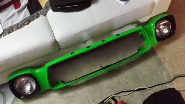

On a brighter note, to keep me feeling like I'm making progress I took the nose section home and restored it and painted it to match what will eventually be the rest of car, it turned out nice
New hardware and all
Looks a little different ha.
