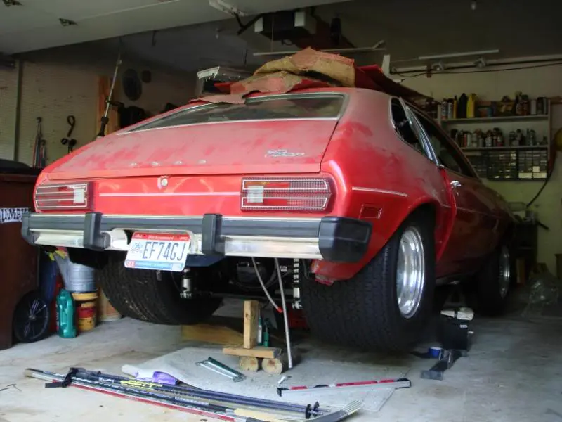

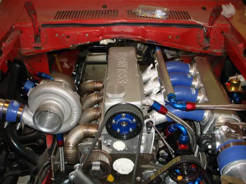

You can do a whole lot with that car. A buddy of mine locally is building a nasty (think 800hp/8-9 second) Pinto with the original stock block.
If you've got the skills/time/money, anything is possible.
