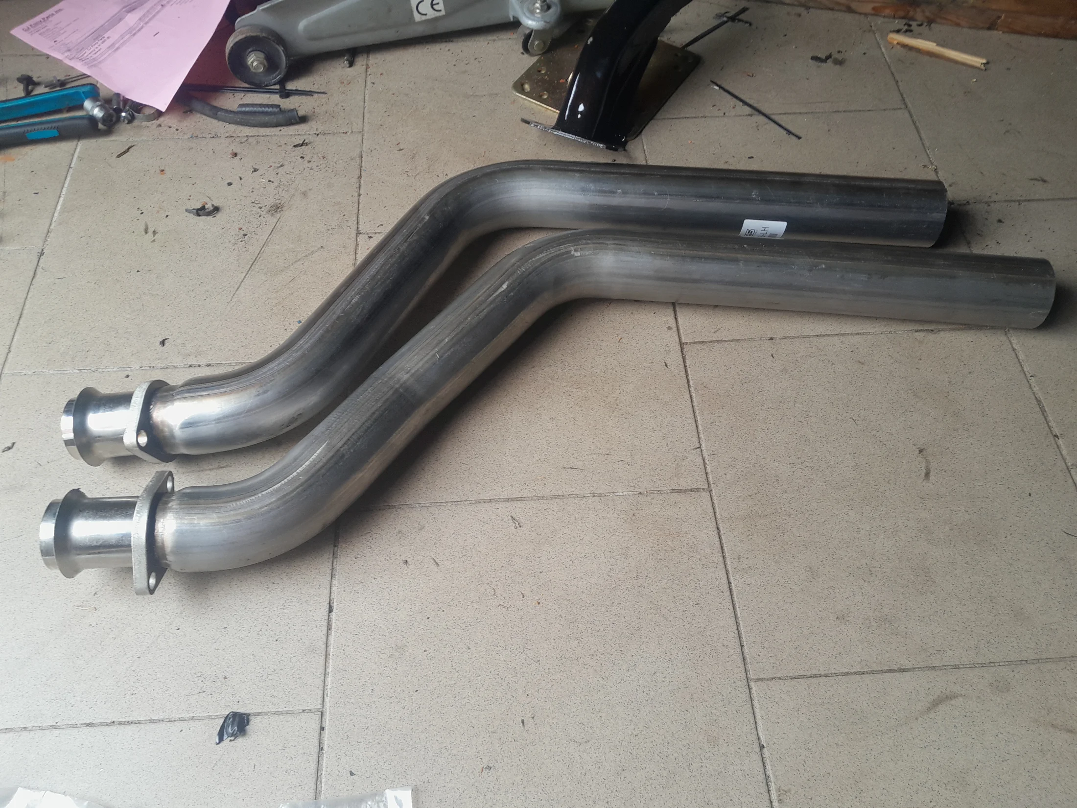

I used stock 66 Mustang exhaust manifolds because I had them already from a previous car (they are available as new part). I also used a 66 mustang downpipe from pypes and modified them:
The manifolds fit even with a T5 bellhousing and T5 transmission (but with custom hydraulic clutch). The car pulls strong, but its for sure restrictive at high RPM compared to a shorty header.
What I like is that you can use the stock securing sheet metal from the 66 manifolds, so the exhaust manifold bolts don't come loose. Beside that they are durable and quite down surface radiated noise in the engine compartment.

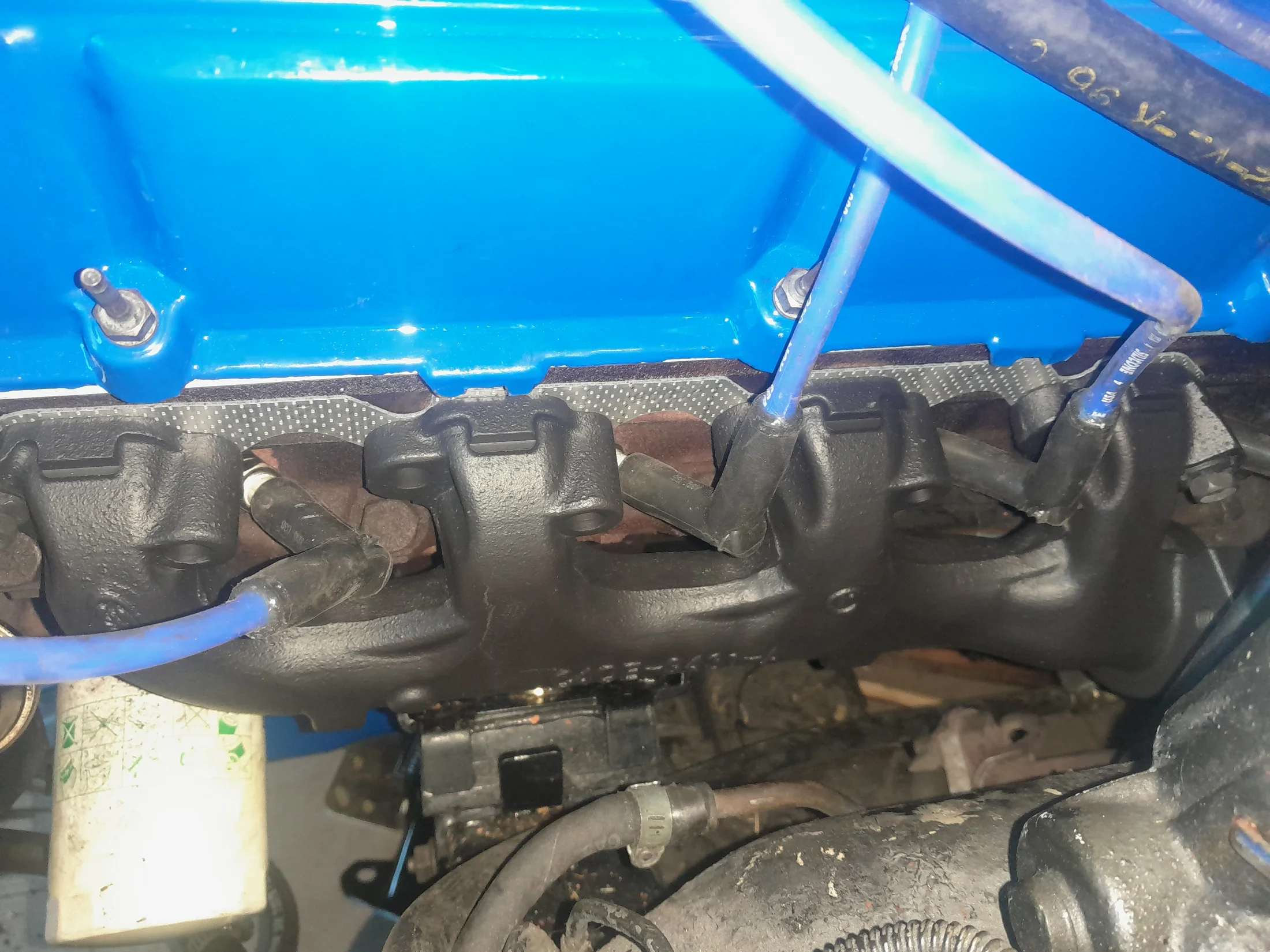

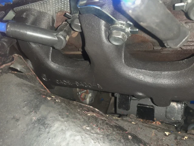

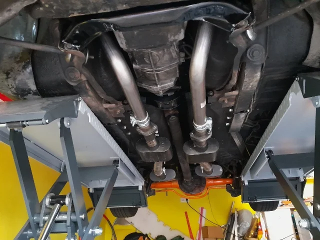

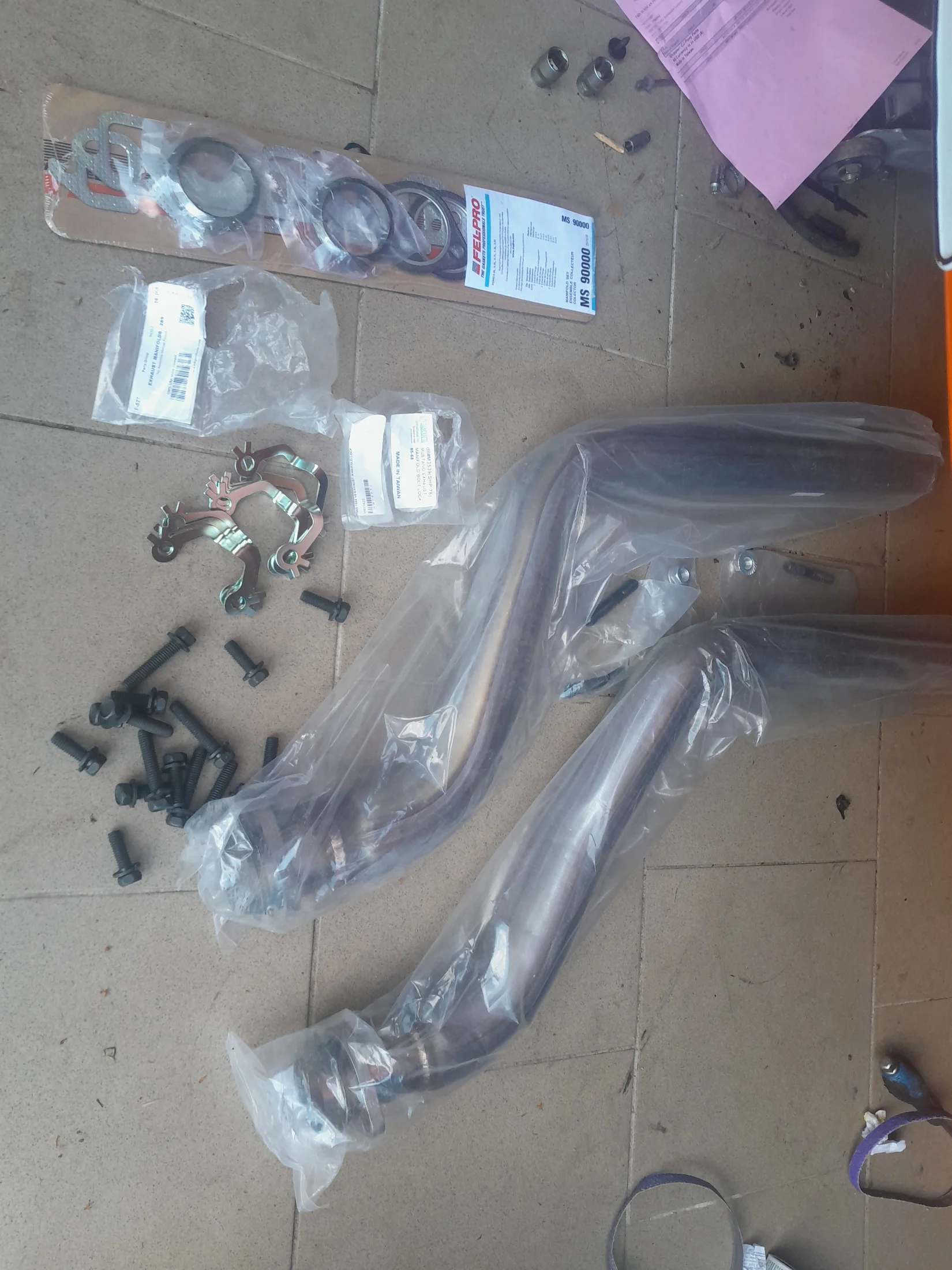

I got '66 headers to test and installed them. They look great and promise to fit.
I've now ordered these new '66 headers, complete with gaskets, downpipes, and new bolts.
I'll post pictures of the installation once I get the headers.
I'm glad I removed the Hedman.

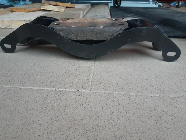

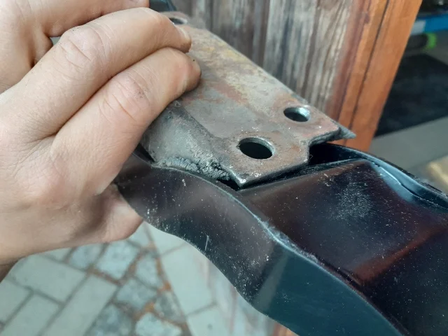

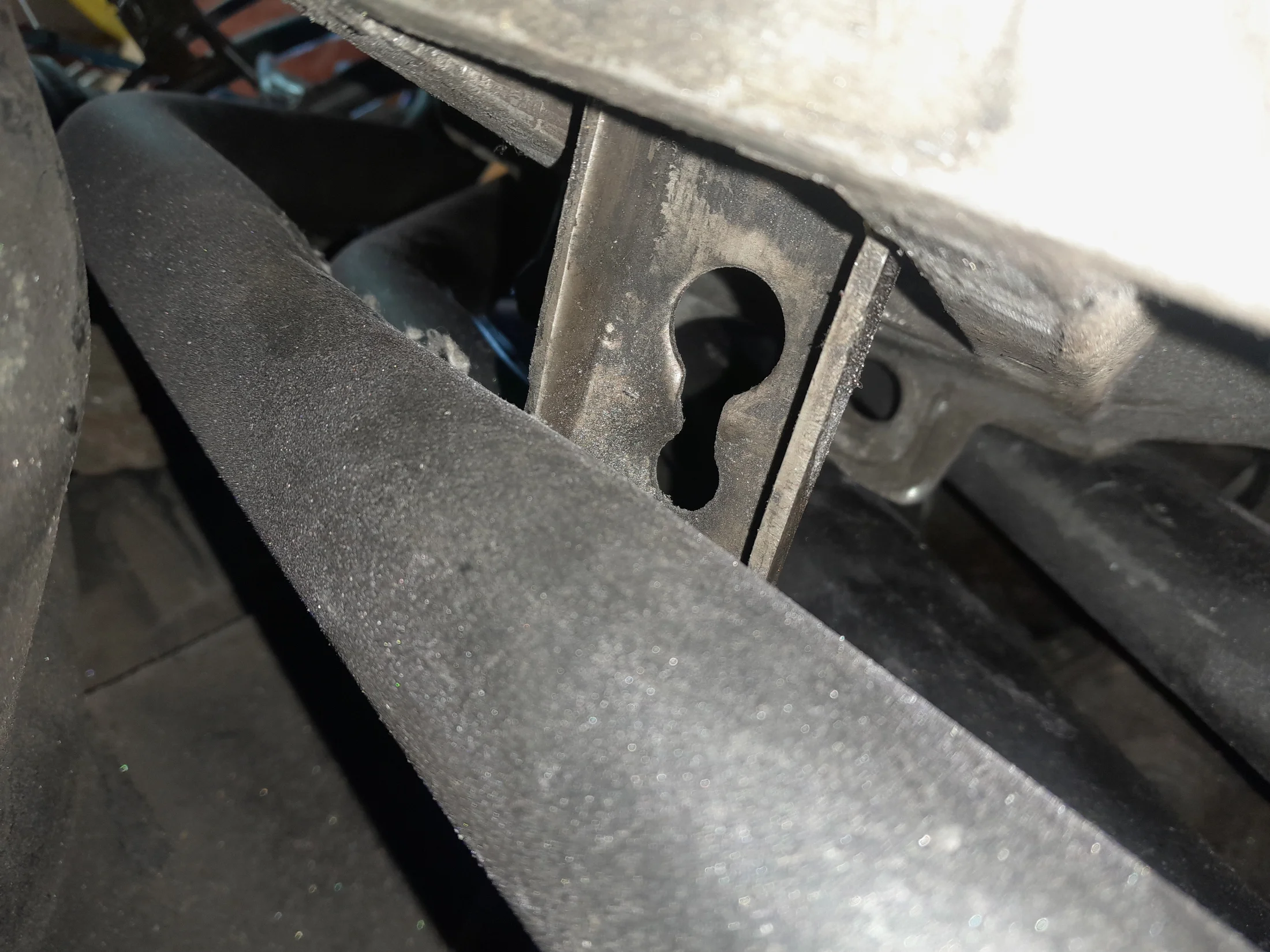

Problem 2 has already been solved.

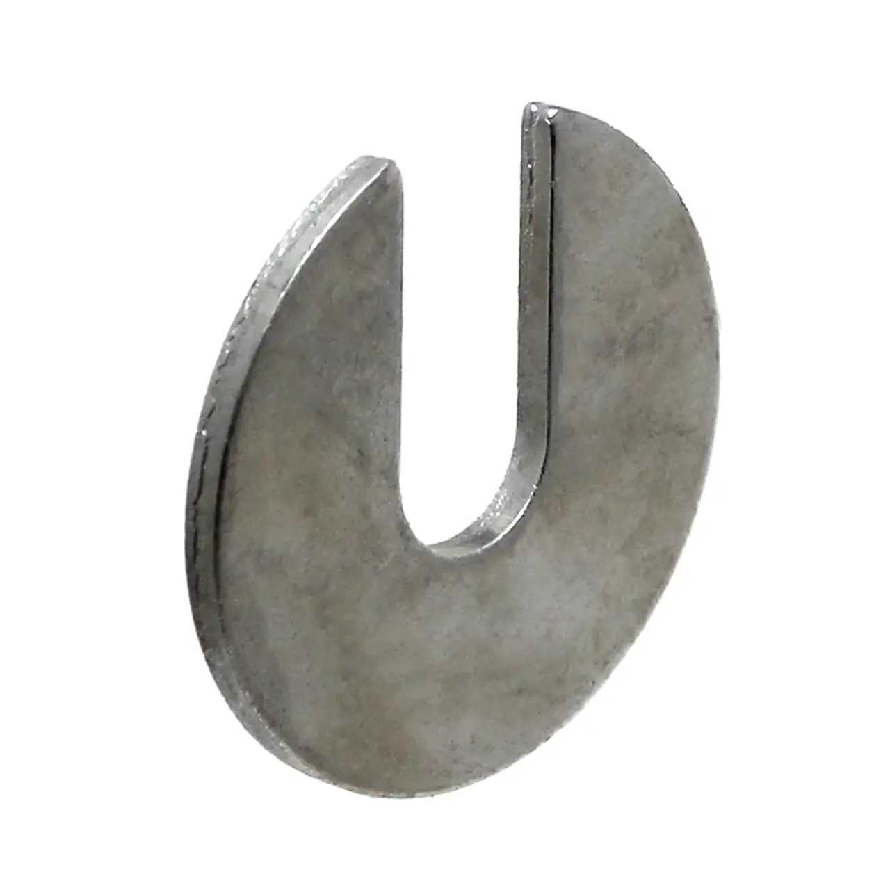

The new bridge under the transmission is great, but it's advisable to buy new transmission mounts.
Used bearings are already too compressed, even if they still look good.
They will cause noise and rattling.
Solution: Install new bearings and two washers underneath the bearings, which will create enough space.

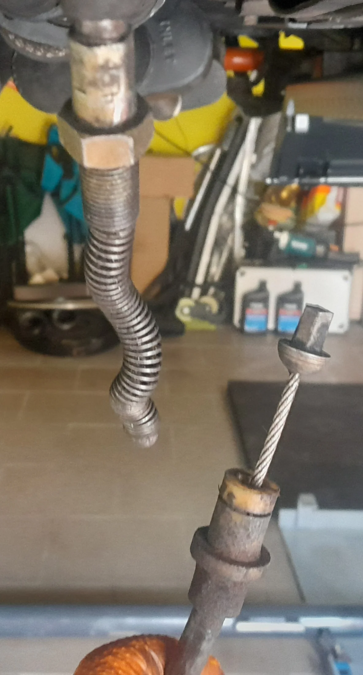

One problem I still have:
In most forums, you can read that the original Mustang II Bowden cable is still used with the T5 transmission.
This end piece of the Mustang II Bowden cable is very small and doesn't fit with the large hole in the T5 lever.
How did you solve it?

I still use the MII bell housing and clutch setup, but I'd take a stab at finding a washer that is large enough to close the hole yet small enough to engage the ball of the cable. If you're able to find something like that, use a grinder with a cut off wheel and cut a slot into it. Then you could weld it in place on the clutch fork before installing the cable. Imagine something like this:

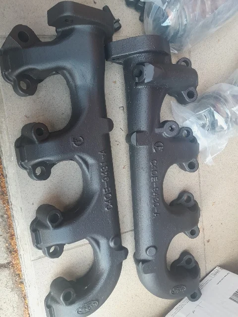

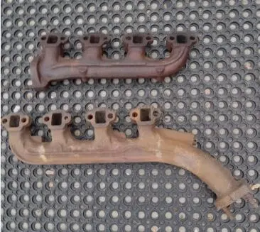

Did you work out your exhaust manifold situation? Here is an Ebay link to a pair of manifolds, stateside.
1975 to 1978 V-8 302 exhaust manifolds USED
Good luck with your project. FoMoCo has made several variations of the small block engine. There are several different sets of pulleys and brackets.
